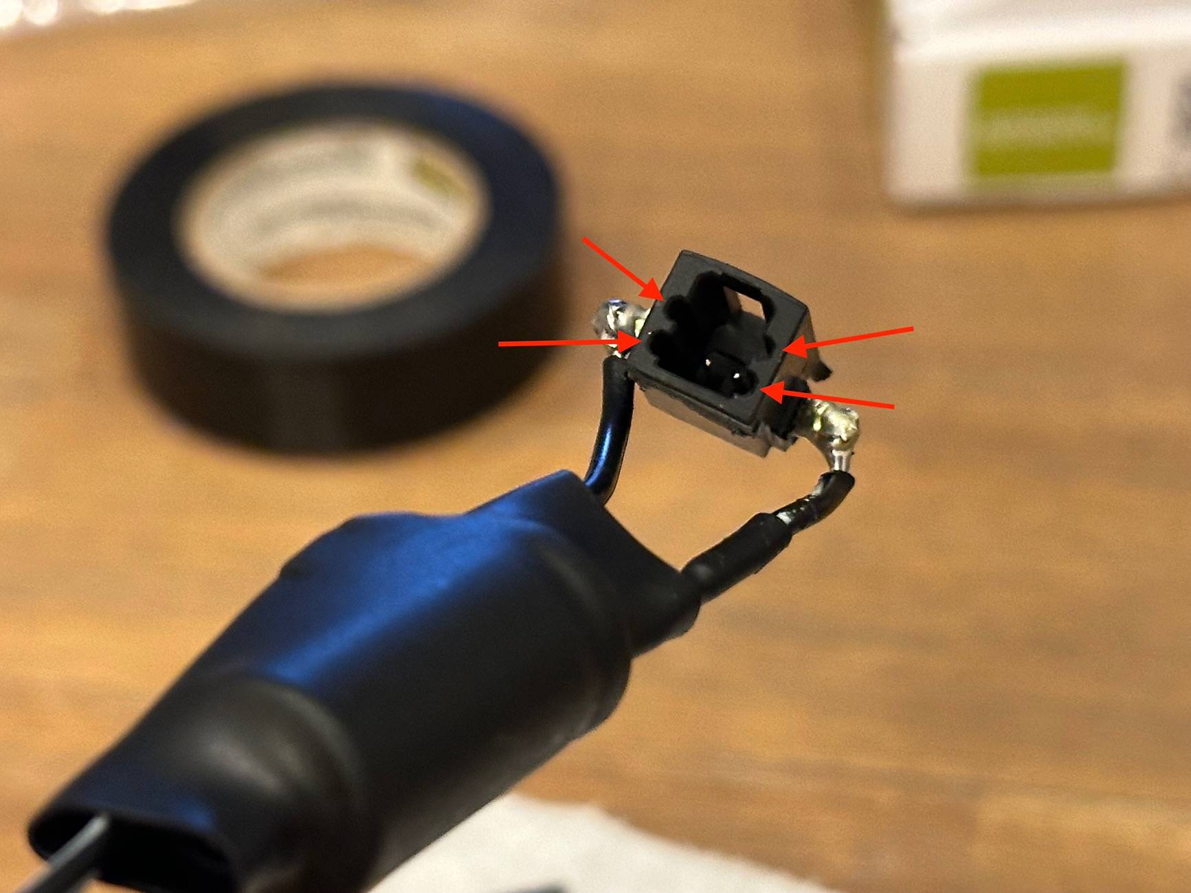

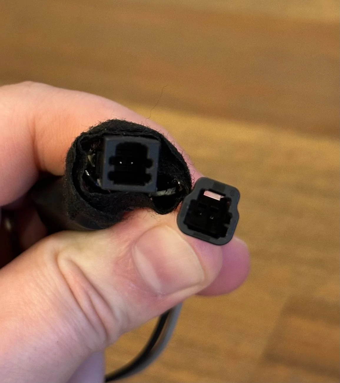

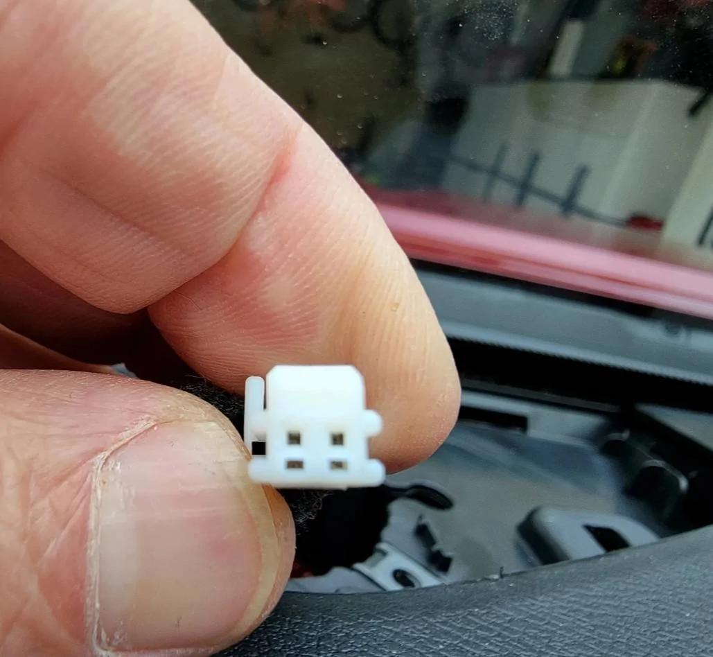

Sorry for the gap between replies. I got super frustrated and had to walk away for a few days. The B08VJ7NZYY harness did NOT fit my dash plug. The plug on my car's harness has two little rails on either side (see the picture of the OEM speaker female plug below to see what I'm talking about), which the aftermarket harness plug didn't have. I tried to cut out the sides of the Red Wolf plug so the car's harness plug would have room to slide in, but I had to remove so much material that the plug was on the brink of falling apart so I gave up. And I accidentally scratched my speaker cover taking it off. So I got pissed off and gave up for a few days.
The Red Wolf harness doesn't have these slots (as a reminder, this picture is of the plug on the OEM dash speaker that I sawed off to rig up a temporary adapter harness):
This is what the B08VJ7NZYY plug looks like:

The black plug in pic #1 is the OEM plug that was originally attached to the speaker. I cut it off to make my own sub-harness to install the aftermarket speaker.
The white plug in pic #2 is the Red Wolf harness(B08VJ7NZYY), which doesn’t have the four ā€œslotsā€ cutout for the tiny rails of the OEM dash speaker harness plug.
It would be much easier to understand if I had an actual picture of the OEM harness male plug. The next time I have the speaker out, I’ll get a pic.
The fact that I’m having so much more trouble than anyone else makes me think they changed the speaker harness for ā€˜24 model year. Is yours a ā€˜23 or ā€˜24?

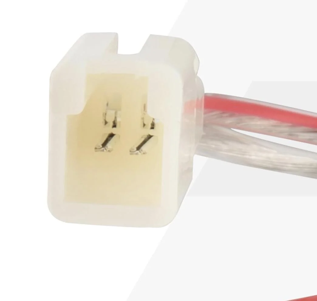

Alright, after searching for hours, I finally found good info on the dash speaker harness connector.
Random Google searching landed me on this OWC connector page here. There is a vehicle list on the page that specifies which vehicles use which harnesses, but it unfortunately only lists the Performance Z, no Sport. ? However, just by looking at the plugs, it looked like the TH02MW was what I was looking for. I referenced the vehicle list to see which use the TH02MW and saw the ā€˜22+ Frontier with Fender audio listed. A search for that yielded this Frontier forum thread here. That user posted a bunch of great pictures of the front speakers and harness. I stole one of his pictures of the harness plug below. That is the same connector I have in my dash. Unfortunately, the user goes on to say that the Metra harness Crutchfield recommends doesn’t fit. He says he will follow up when he finds the correct harness, but that was three years ago. Sounds like he ran into the same roadblock as me!
Anyways, all that to say, I believe the OWC TH02MW is the correct harness. I’ve ordered it and will report back.
For reference, here is a picture of the Frontier dash speaker plug (matches my ā€˜24 Sport dash speaker plug):
