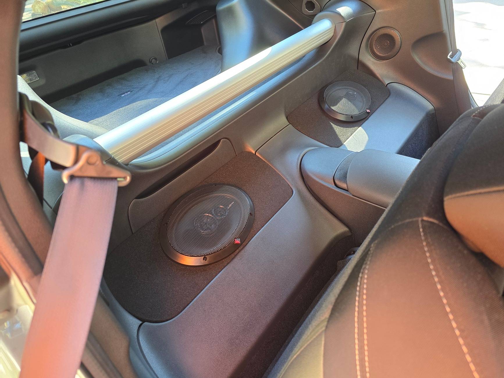

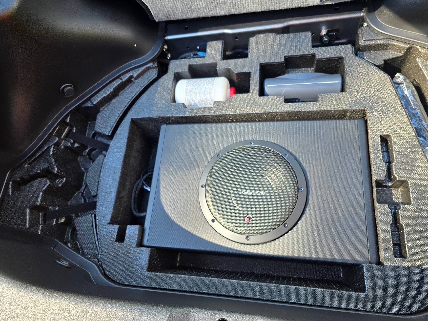

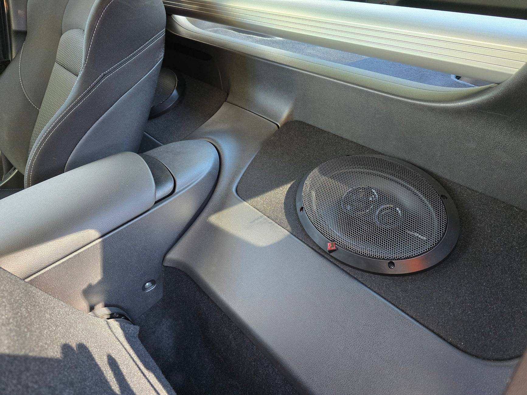

I think everyone feels the same regarding the sound system in the Z. However, it can amazing without spending too much if you are willing to do the work yourself. It took me a little trial and error to get it right. Even after replacing the rear speakers I was still underwhelmed with the sound quality. There just isn't enough room behind the panel, even with modifications, to fit anything larger than a slim 3.5 speaker. I decided to fabricate 2 small enclosures that fit in the shelf spaces behind the seats. This completely fixed the rear sound problem with the car. I know that most people won't like the look of them and you do give up storage space, but the sound quality is unbelievable. I also changed out the door and dash tweeters with focal components, threw an RF amplified sub in the back under the carpet, and wired in a DSP kicker amp. Total investment was only $900 and I can't belive how good it sounds!

No, I ran the rear 6x9's off of the Kicker DSP amp as a completely separate rear channel.

Honestly, the dash speakers made the biggest bang for the buck, followed by the door speakers, followed by the sub to fill in the low end.

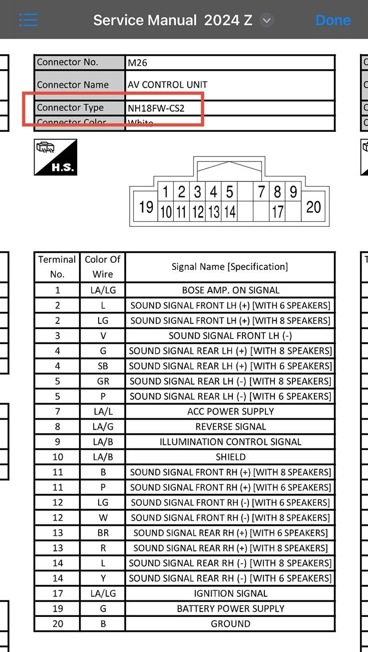

Does anyone know if there is a separate amp somewhere in the Sport? Or is it built into the head unit? I was hoping I could tap into the system and grab the clean signal before the amp like the Performance people can do, but I can’t find any info on where the amp might be. I read through the service manual and it shows the amp location for the Performance, but not the Sport. I’ve peeked under the rear carpet and didn’t see anything in the location where the Bose amp usually lives. My goal would be to insert a DSP at the factory amp location so I can have full control of the audio without having to rewire anything.

No amp in the Sport.

Before you completely chop out the rear speakers, the ones I added DO add sound. Just not a lot.
If I had to do it over again, I would use 3.5" speakers that I wouldn't have had to chop out so much of the grid on the speaker grill.
There IS enough room where the 3.5" speakers are depth-wise to add 5.25" speakers there. (Cut a hole, mount the speakers, mount their grills.)

I’m curious, do you know for sure that the rears have a crossover, or is that speculation based on them sounding so anemic? I was thinking about testing the signal of the rear speaker wires to confirm if they are full range or not.

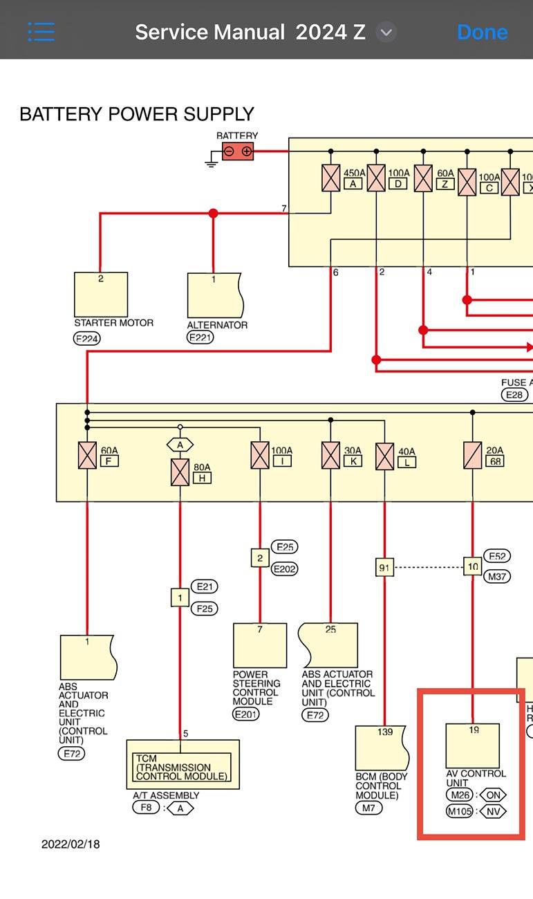

On another note, I was digging through the service manual looking for amp info and I found the pinout for the A/V control unit:

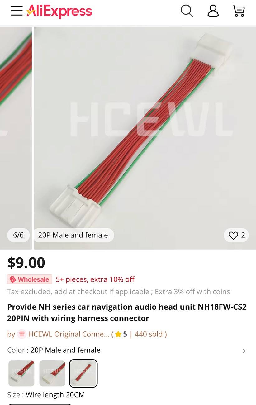

I searched online for the connector code and found this:
I’m thinking I can plug this between the
factory harness and the A/V unit and then splice in a sub-harness for a DSP and/or amp, without modifying any factory wiring. Not a bad experiment for only $15 shipped. Now, to figure out how to get to the rear of the A/V unit… ?

Only speculation.
Good find on the harness. Not sure if the Sport head unit will be sending any signal to those other pins. (Subwoofer, extra speakers.)
