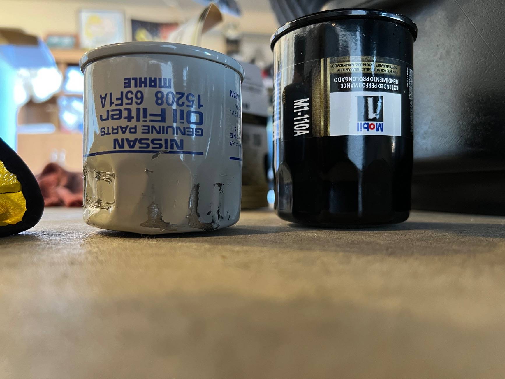

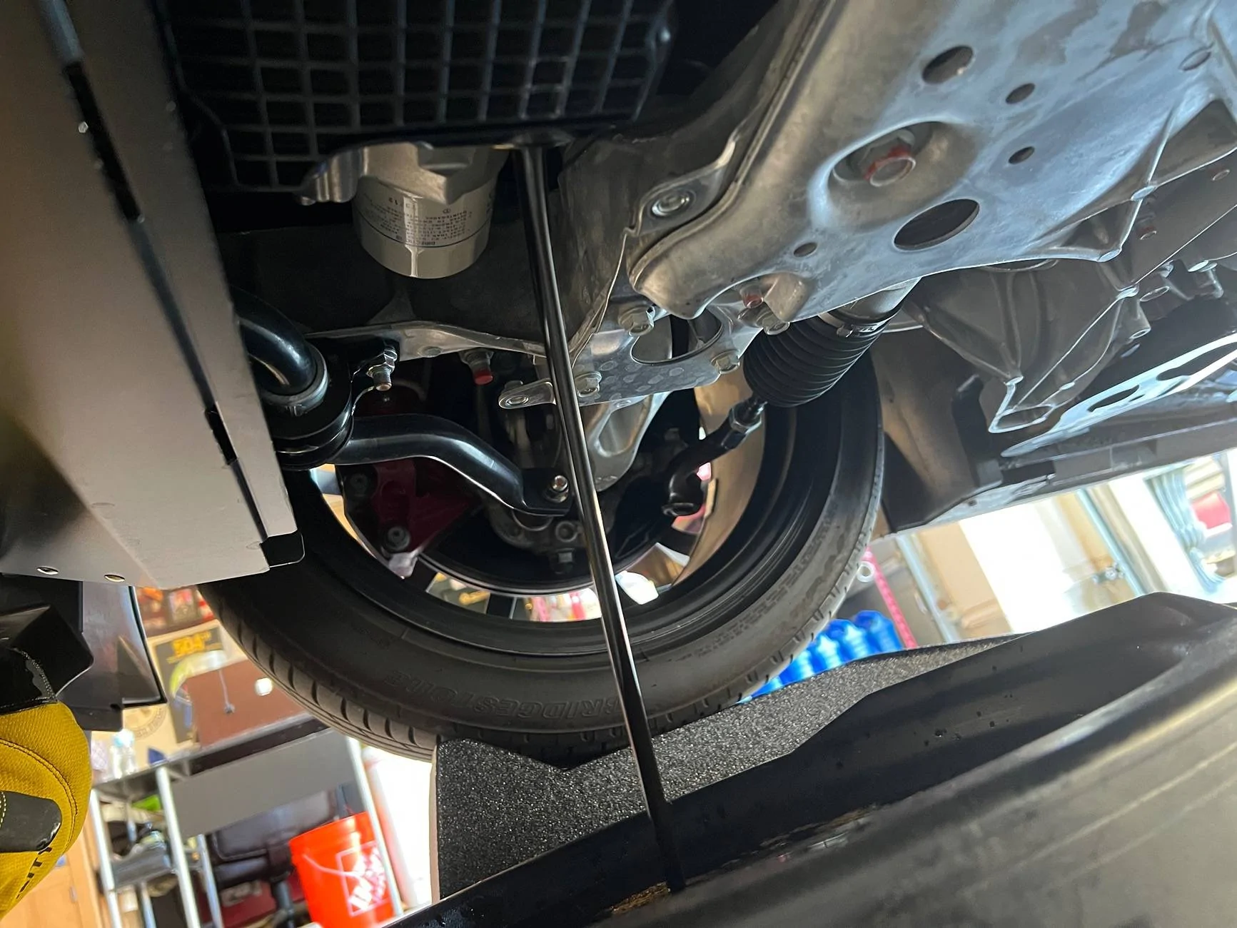

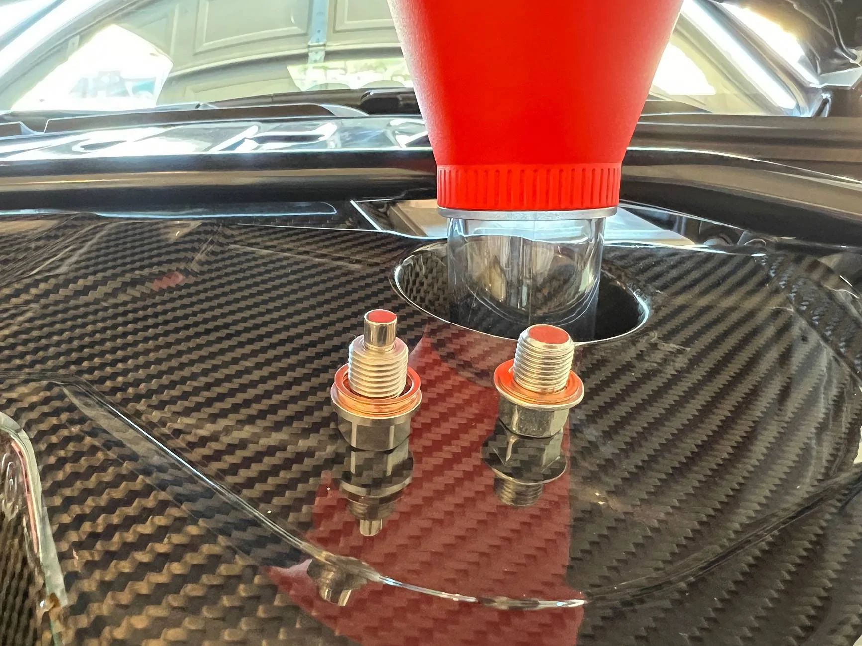

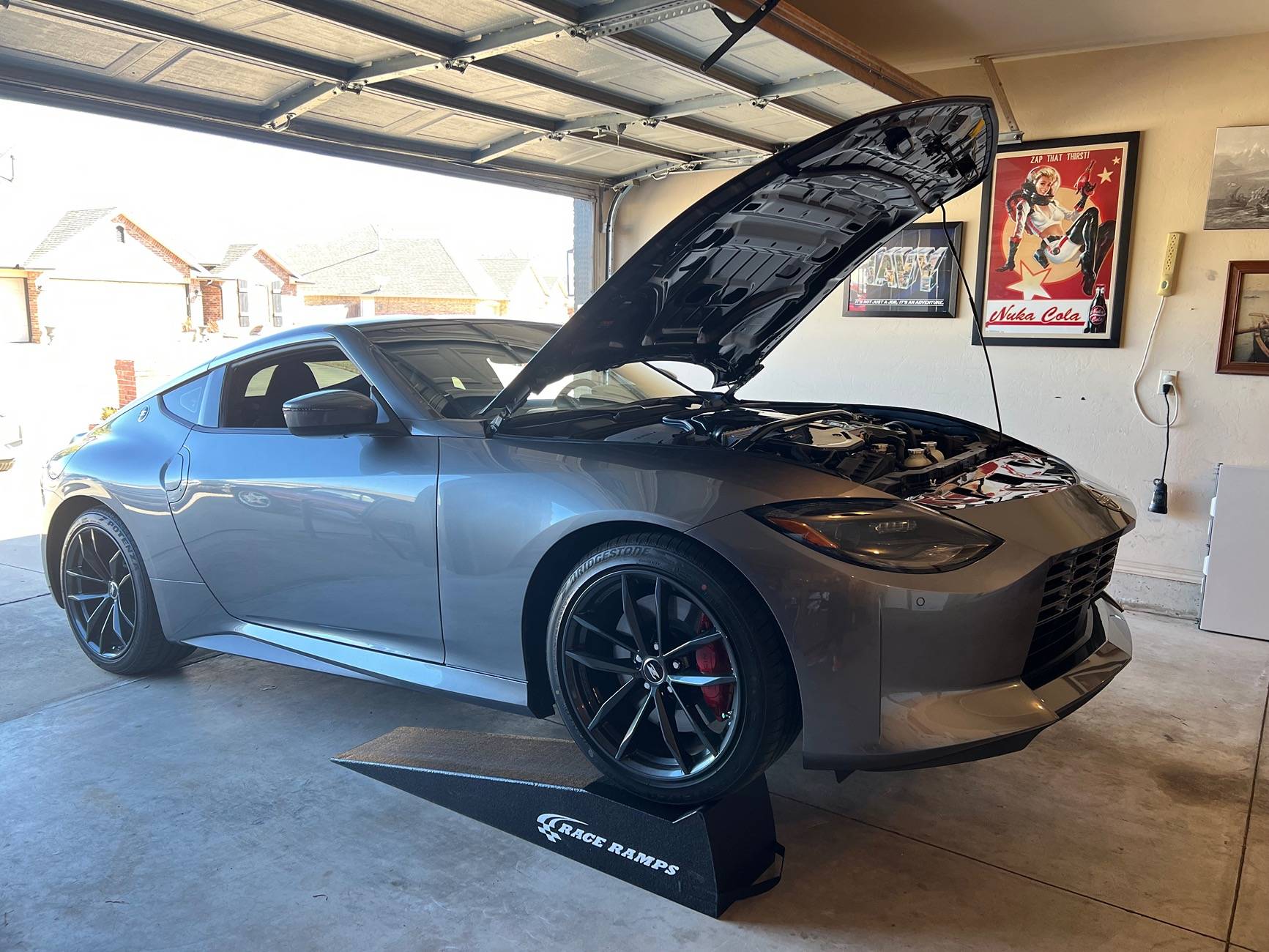

1st oil change, 1,480 miles. Added Z1 magnetic oil drain bolt. Mobile1 filter. Z1 under shroud service panel is the best thing ever and the race ramps are nice and wide and make being under the vehicle worry free. Whoever Nissan tasked with tightening the oil filter really enjoys his job. The drain bolt was not bad at all. I had to use channel locks to break the filter free.

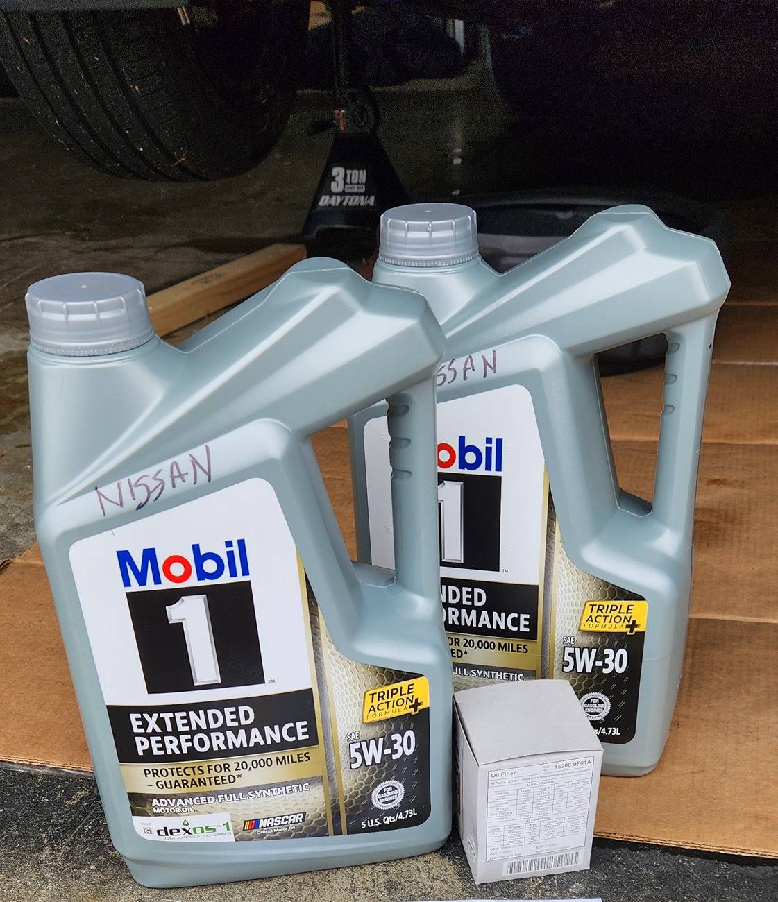

What oil did you use? I'm thinking I'll use Mobil 1 since that's my go-to, but I was thinking of using 5-30. That would be convenient since my wife's Bronco uses that weight but I've seen where tuners recommend that weight for tuned Z's. Mine's not tuned yet but hopefully soon, but I do tend to drive my car a bit harder than most...
5w-30 tuned or not. The recommended 0w-20 is IMO too thin, and burns hella fast. It's only recommended to improve gas efficiency. Top it off, HIGHLY suggest getting an oil catch can, The amount of Oil my can catches every 2500km is surprising
That's what I was thinking. I'll look into the oil catch can...
I used super tech 0/20 full synthetic. I will most likely start using 5/30 on my next change and I am also thinking about doing the catch can. Someone on here even said there is a tech bulletin with Nissan that says 5/30 should be used at Australia dealerships.
I know some people hate on super tech oil but I've been using it on all our vehicles for years and years and we've never had any issues whatsoever.

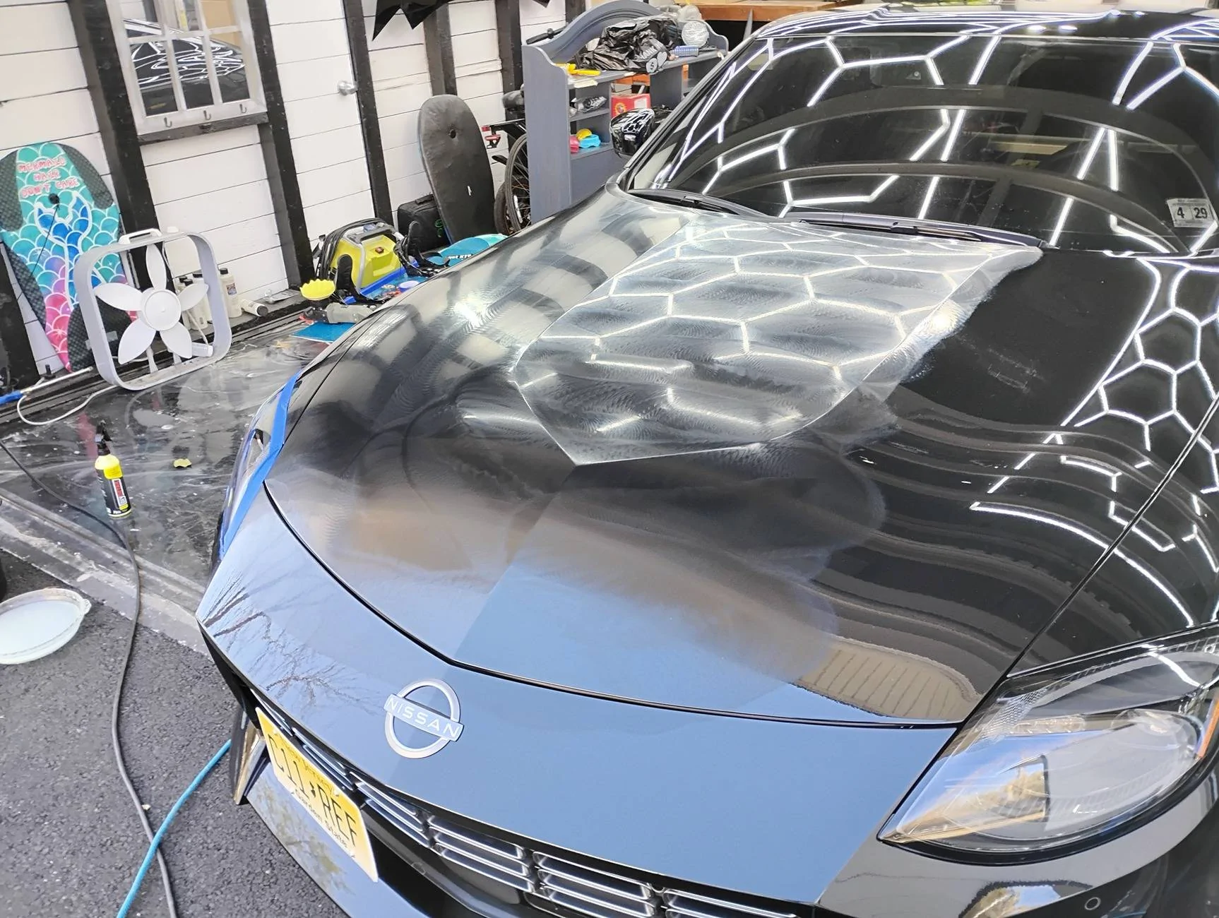

The continuing saga. Buffed the paint with a waffle pad and DIY Detail's gold standard. Got rid of the "haze" and a pre-purchase swirl some open-mouth-breather put in the paint. (Someone rubbed the paint and scratched a swirl-ball in).
Anyways, after buffing, I would use a wet microfiber cloth with rinseless wash on it, then a dry microfiber to dry and remove residue.
Will rinseless wash the whole thing, and do another "surface prep" wipedown before ceramic.
Adams Polishes ceramic is the next big step. Probably Wednesday.
Note: I found TWO defects in the paint. When I go to a new panel, I still hit each spot again.

Have you tested the depth of the paint before correction? Curious what the numbers are from factory
Nope. I am not doing a paint "correction", per se. Just a polishing buffing. My compound and pad won't cut that much. Only way to really f up would be to heat the paint up badly, or slip and have the pad mounting plate slap off the side of the car.

What model of RR are people using?

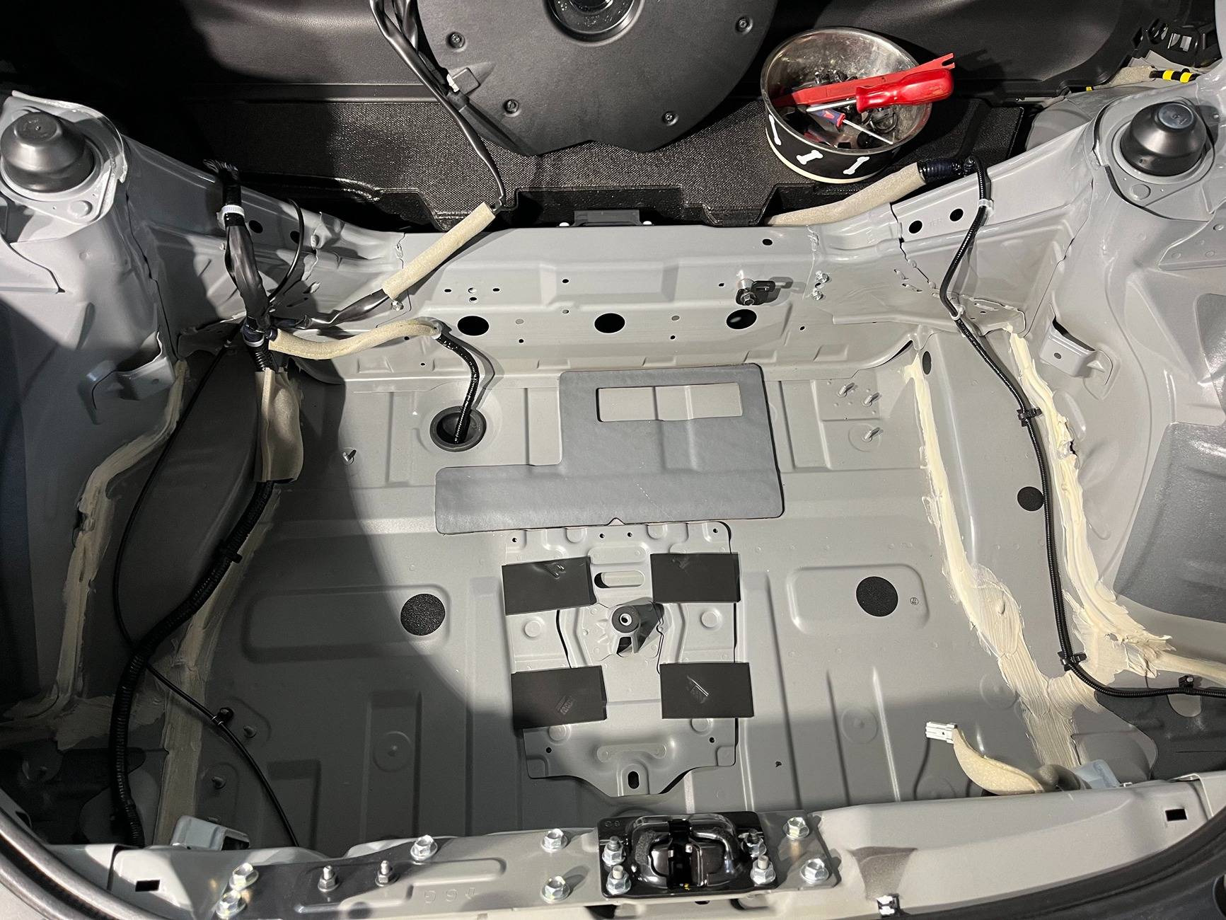

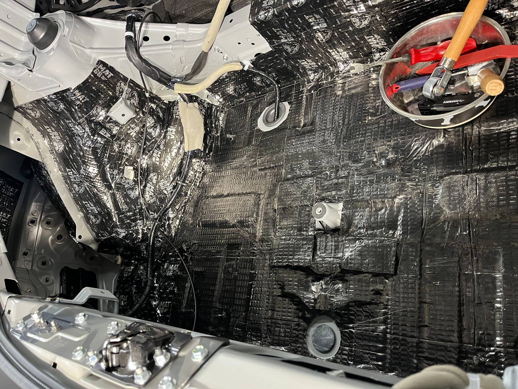

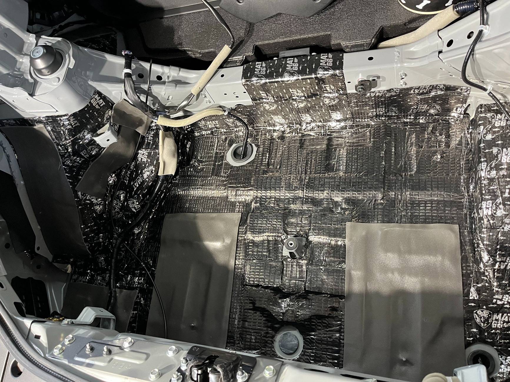

Hit the trunk with butyl aluminum backed mat and closed cell foam to dampen down the road noise and prepare for a speaker upgrade down the road. I use this stuff on everything including our home appliances. Disassembly was really straight forward, no broken clips. That weather-seal on the rearmost plastic panel takes awhile to reseat over the plastic lip, spent 20 minutes on that alone. The rest flew. I could tell the moment I closed the trunk that it made a big difference.
Not very well caught in the pics is the hidden wheel well area that I spent a fair amount of time on. You have to be inside the trunk to access it but your entire arm can fit enitrely on the left side behind the sheetmetal baffle, the right side is a little more limited but I'd suspect about 4 sq/ft of total deadener is back there between butyl and closed cell foam. I'm running 305s in the rear which are a bit chatty.
The difference is immediately noticed when idling, driving and/or playing music. I can't wait to do the doors later on. I suspect I used about $30 in deadener between excess butyl mat and foam that I had laying around. All in all it took under 2 hours. Most of that was rolling (invest in a $5 deadener roller if you don't have one, well worth it) though, not a very technical trunk to deaden.
