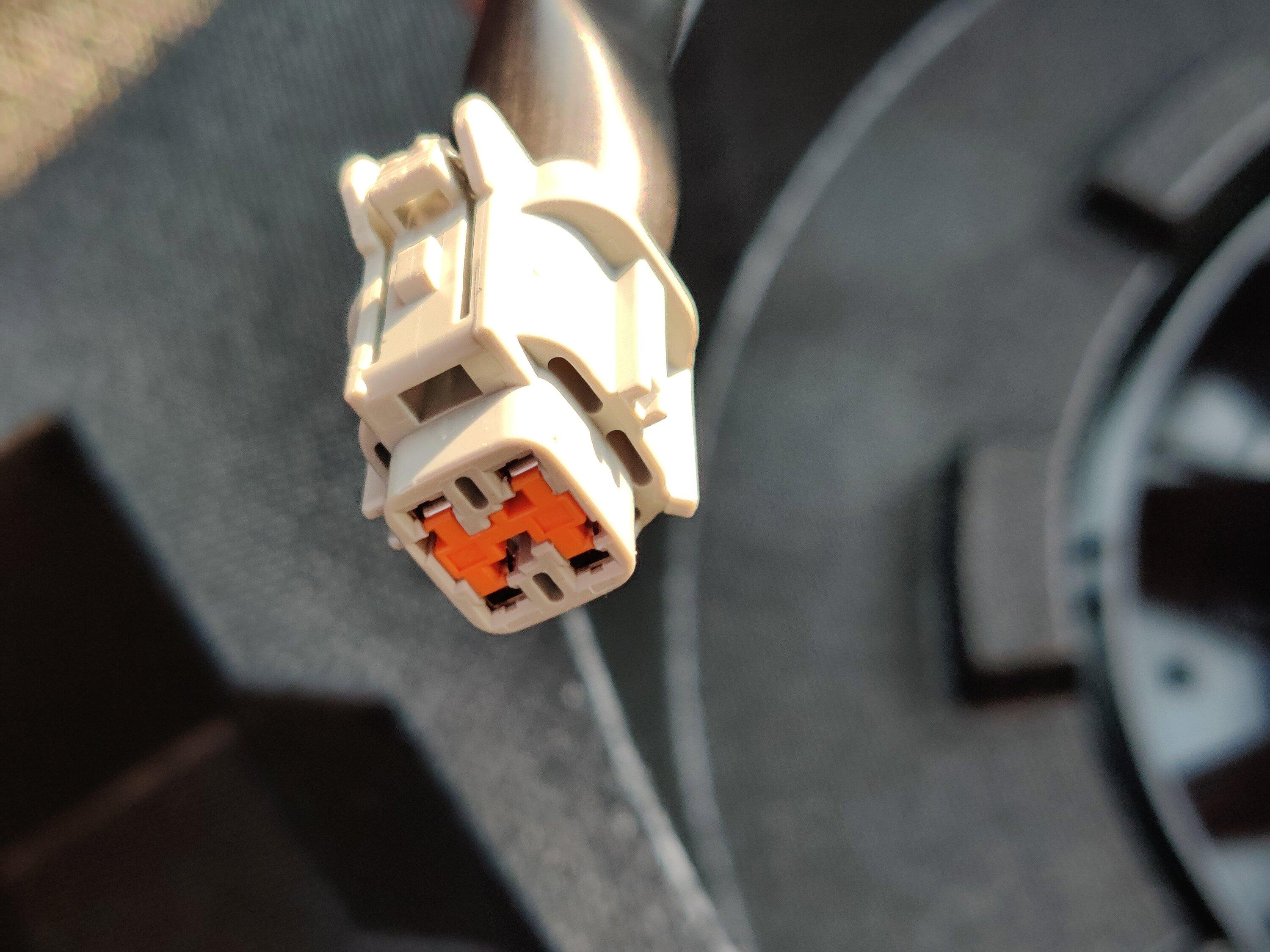

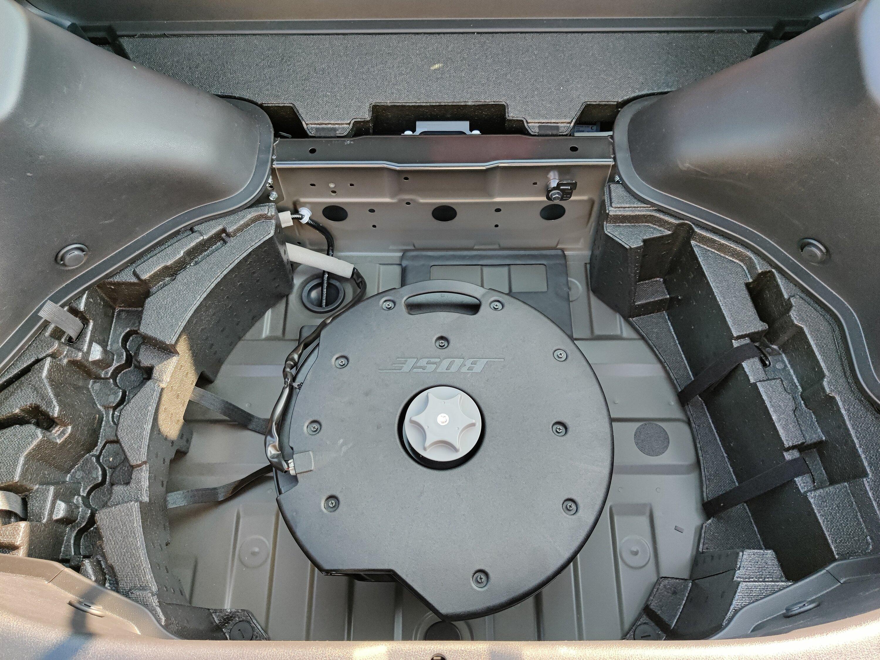

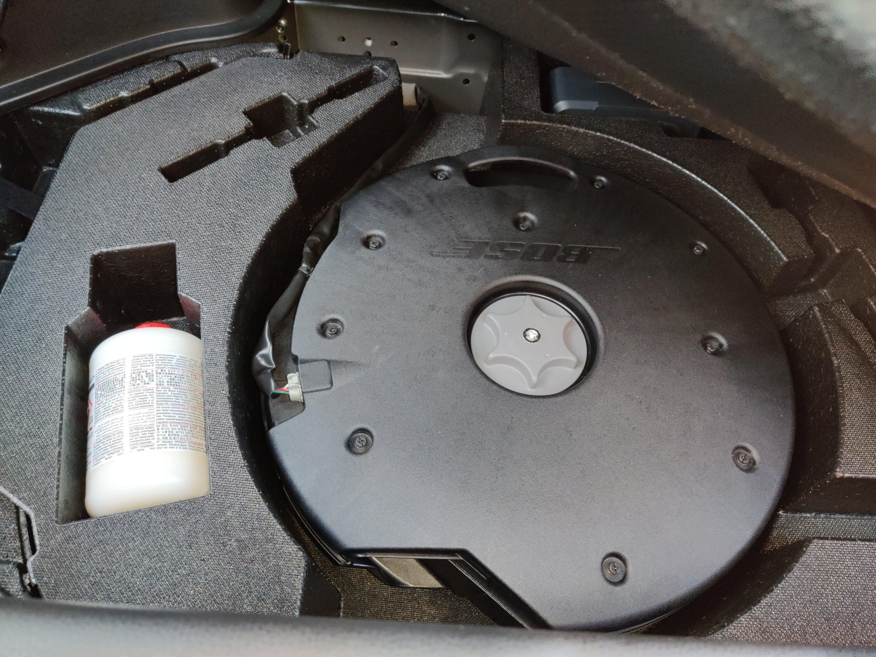

Posted this in a FB Z group.
Found the culprit for the horrid sound. It's the 2 speakers behind the seats. They are a massive 4.5". I bought the spare tire JBL sub and it fits inside that space perfectly. Left the two little 4 and a halfs disconnected. And just like that, I have a respectable sound system.
It isn't going to win audio championships, but for $300 the whole system is sounds much better.

Did this upgrade on mine with the factory Bose system. Made a huge improvement. Also I had the dealer turn off the ASC and ANC.
