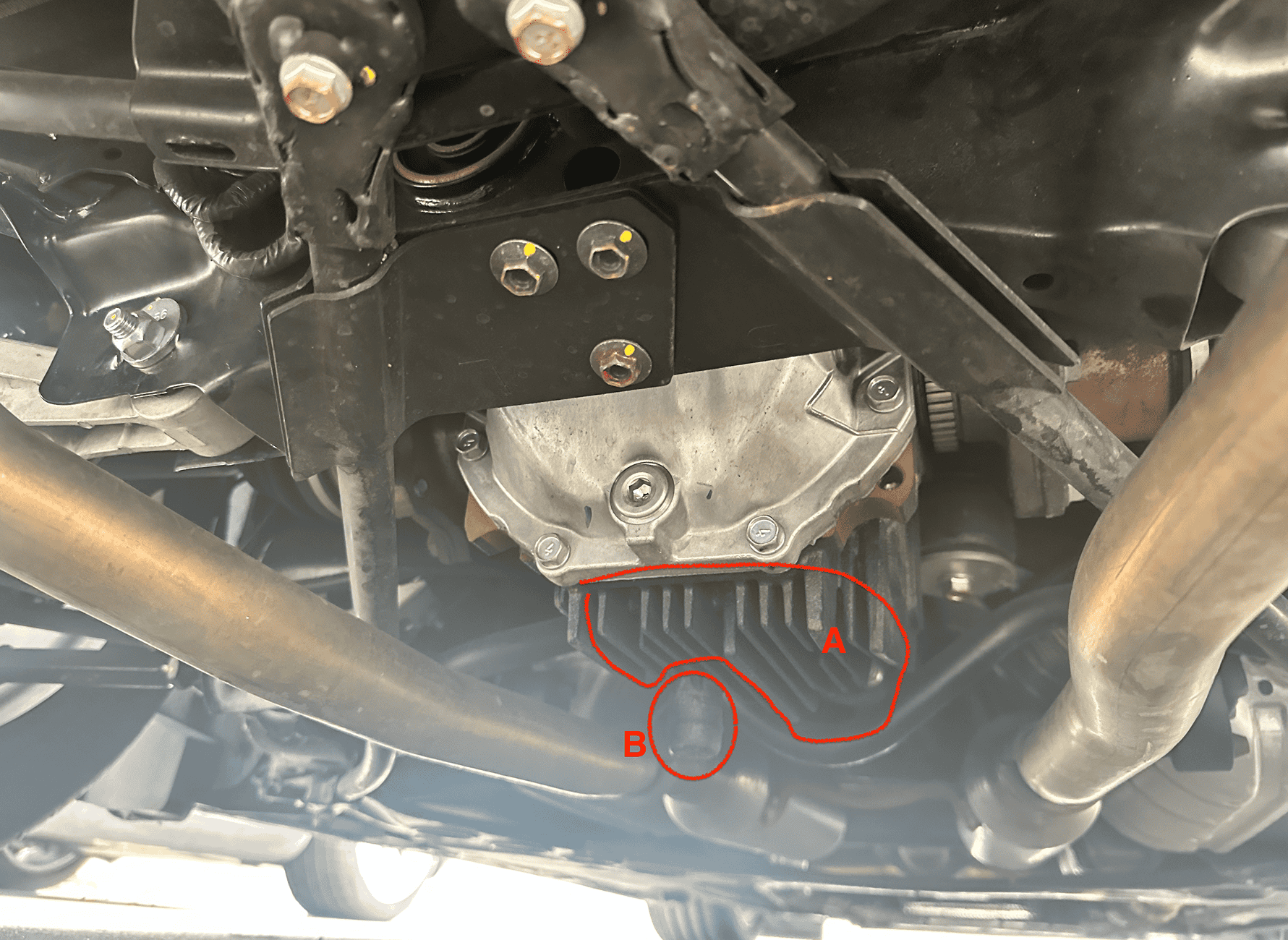

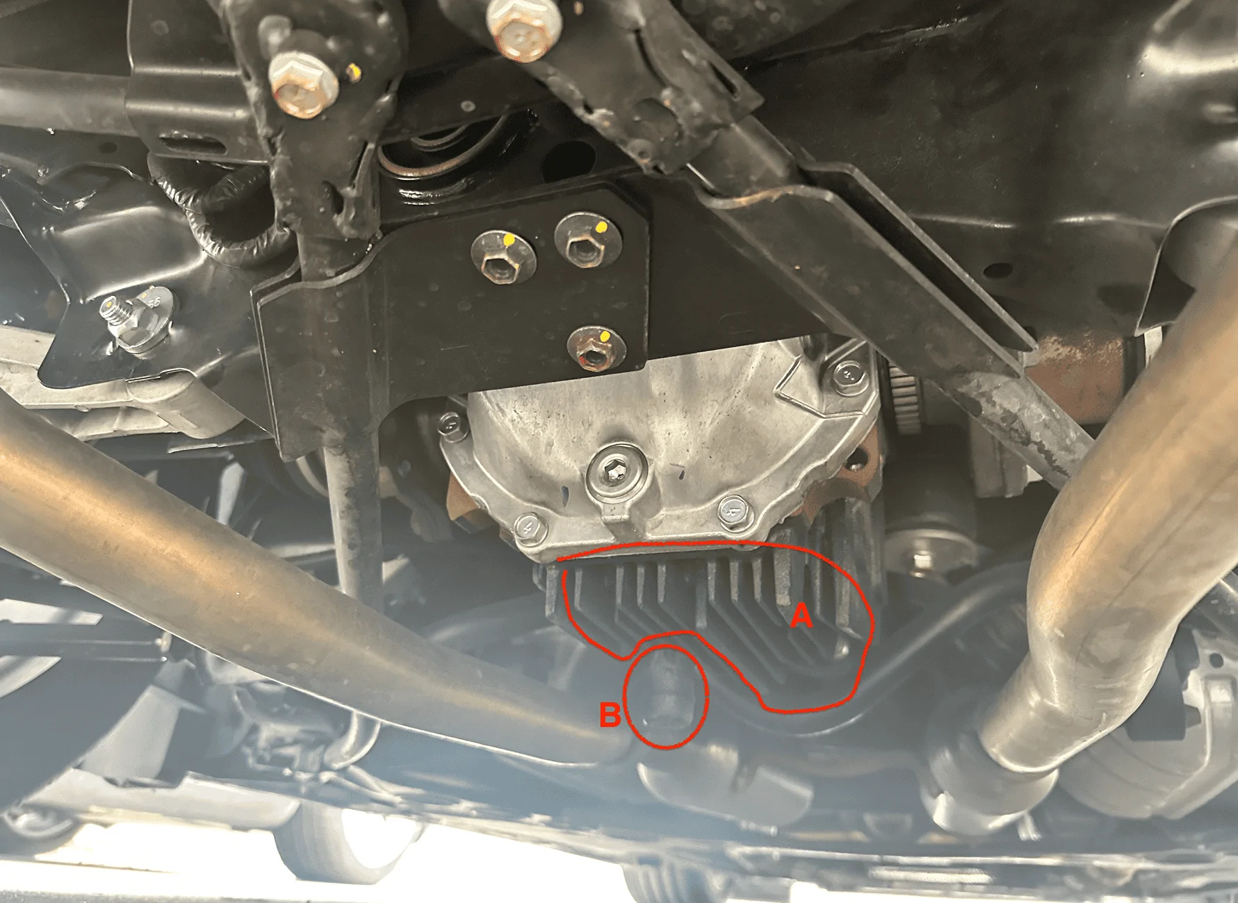

I wonder is that right to jack up from the portion where I circled with "A"? Also anyone knows what is "B" for?
Definitely don't jack up from anywhere in that A section. B is actually the designed spot just for that.

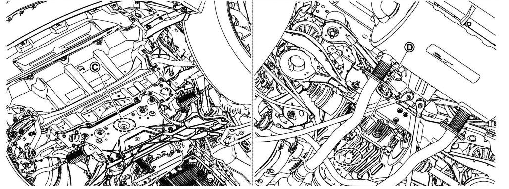

Here you go. They are the same for the Regular Z as well. I prefer a scissor lift with pads for these Z cars. There is a spot along the frame seams with 2 notches front and back. Look at those tiny exhaust pipes? ugh

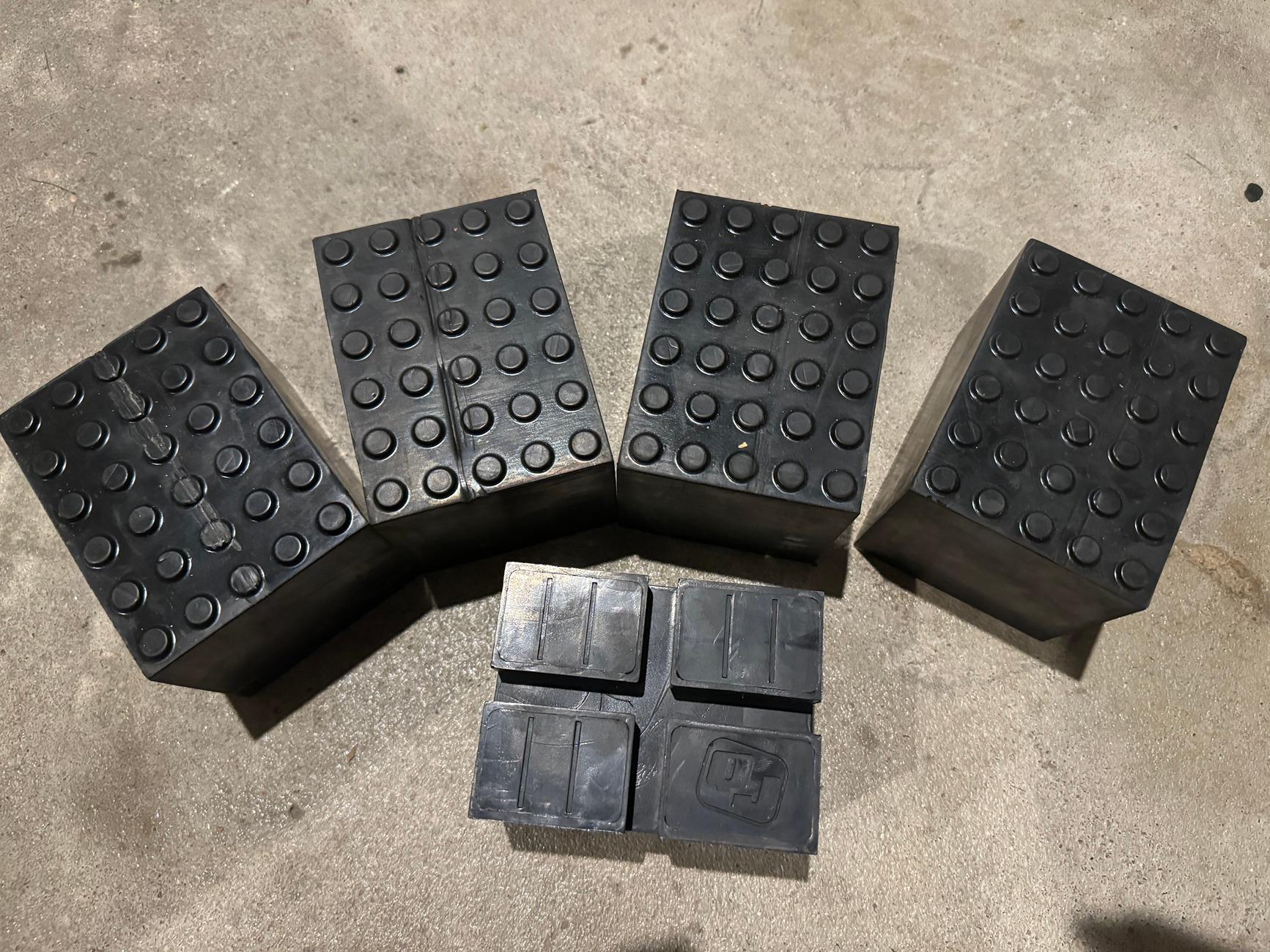

This is what I did with my QuickJacks and the blocks I have got kind of "dented" you can see on the left two that were on the front but it seemed pretty darn stable (I put actual jacks under my QuickJacks just in case). The one on the bottom is an example of thepinch-weld adapters for the QJ's but the slot is too deep on the block (hard to tell in the pic) and the block is too wide it would hit the body on the outside. I wish they were skinnier. So I just used the normal blocks. Hopefully they hold up for some more lifts of the car.
