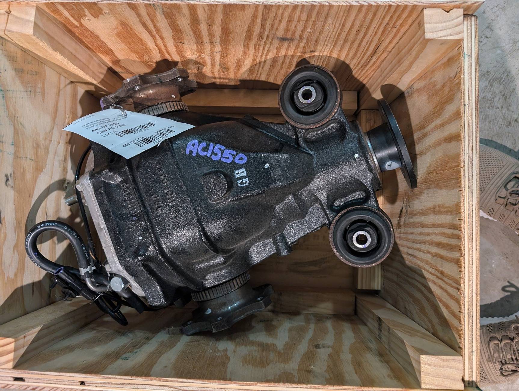

Yup, direct swap minus the gear oil sensor. Now what to do with a complete MT rear diff carrier. Only has 190 miles on it. Maybe I can sell it to someone that wants to build their own LSD?

Didn't need the extra parts I ordered. The performance rear carrier was almost new (about 1900 miles on it). Bought the parts for no reason. I'm no mechanic, just a straight swap.
