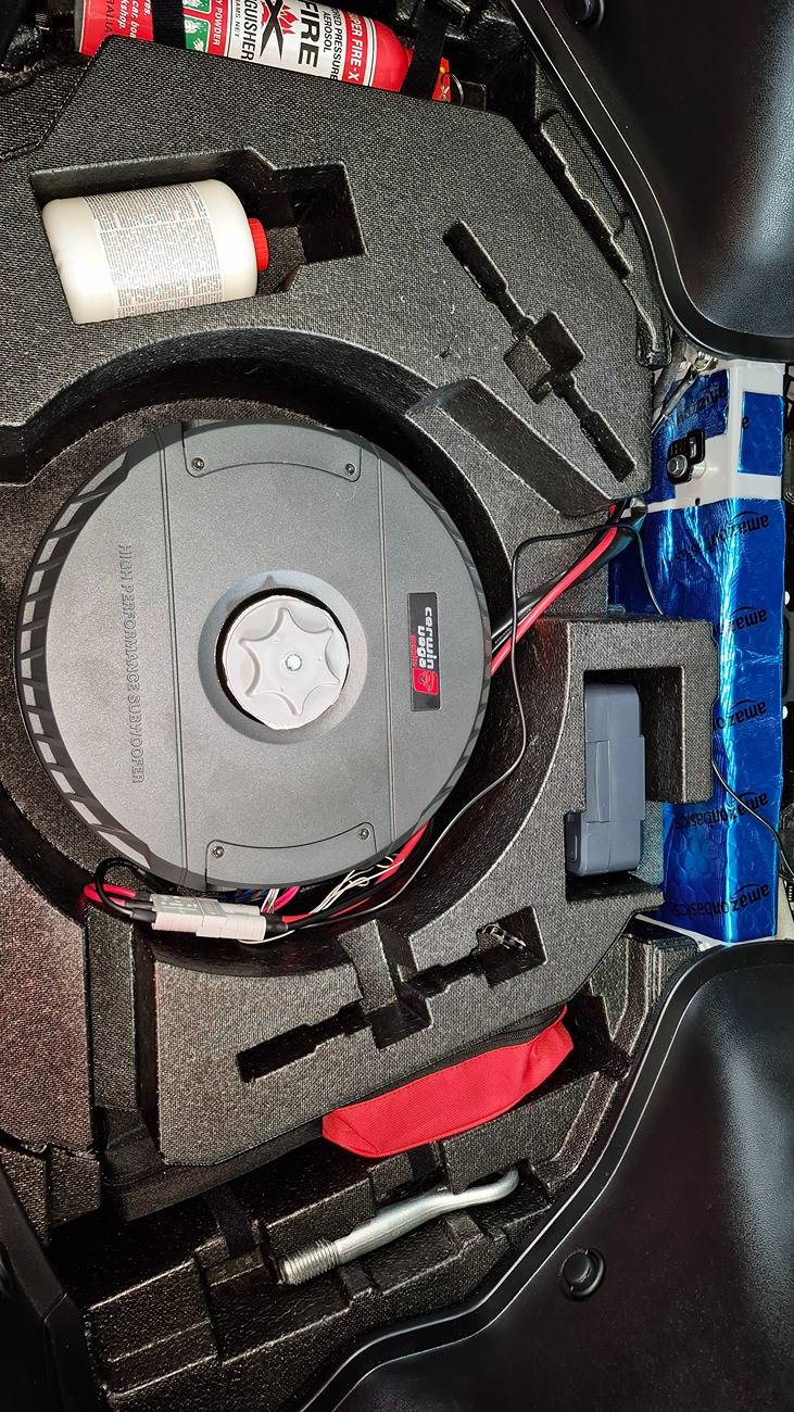

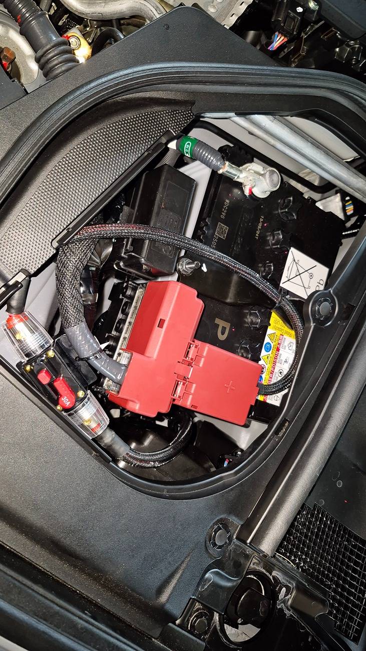

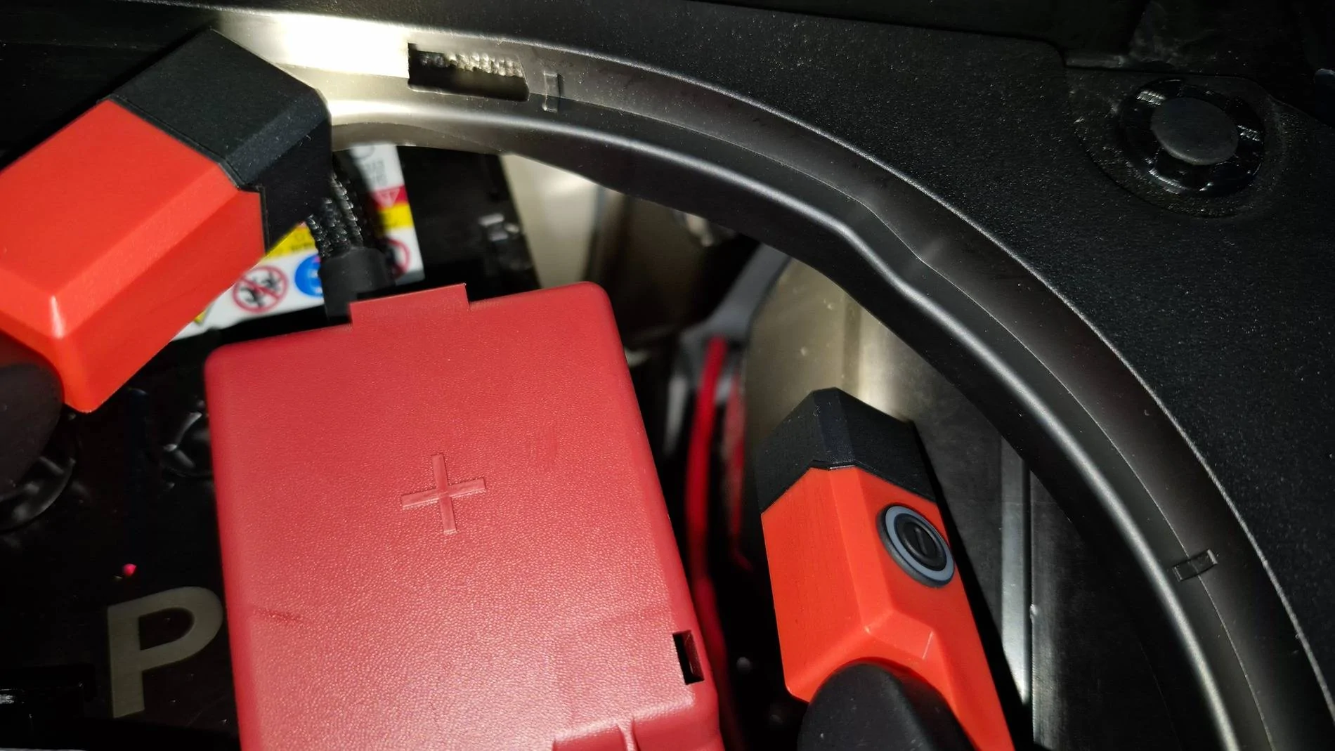

Anyway, I took a chance, and it all worked out perfectly. I used an 8-gauge fused wire from the battery to the boot, threading it through the grommet located right behind the battery (see the third picture). My battery is on the left side of the car since I'm in Australia—I'm not sure if lefthand drive cars have this grommet. I connected the high-level inputs from the Bose sub to the new sub. The entire process took 2.5 hours, including putting away all the tools and reassembling the car.
The sound is amazing at any volume, especially between 10 and 20, which is where I usually have it. The Bose unit had very little bass unless it was played loud, but this new setup has bass at any volume—mirror-shaking, clothes moving bass.
I couldn't be happier. 😊
