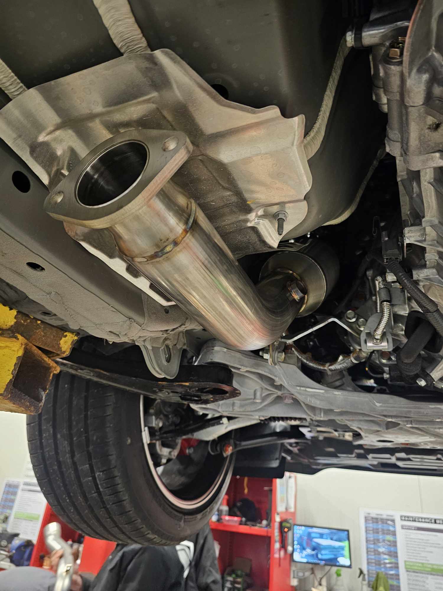

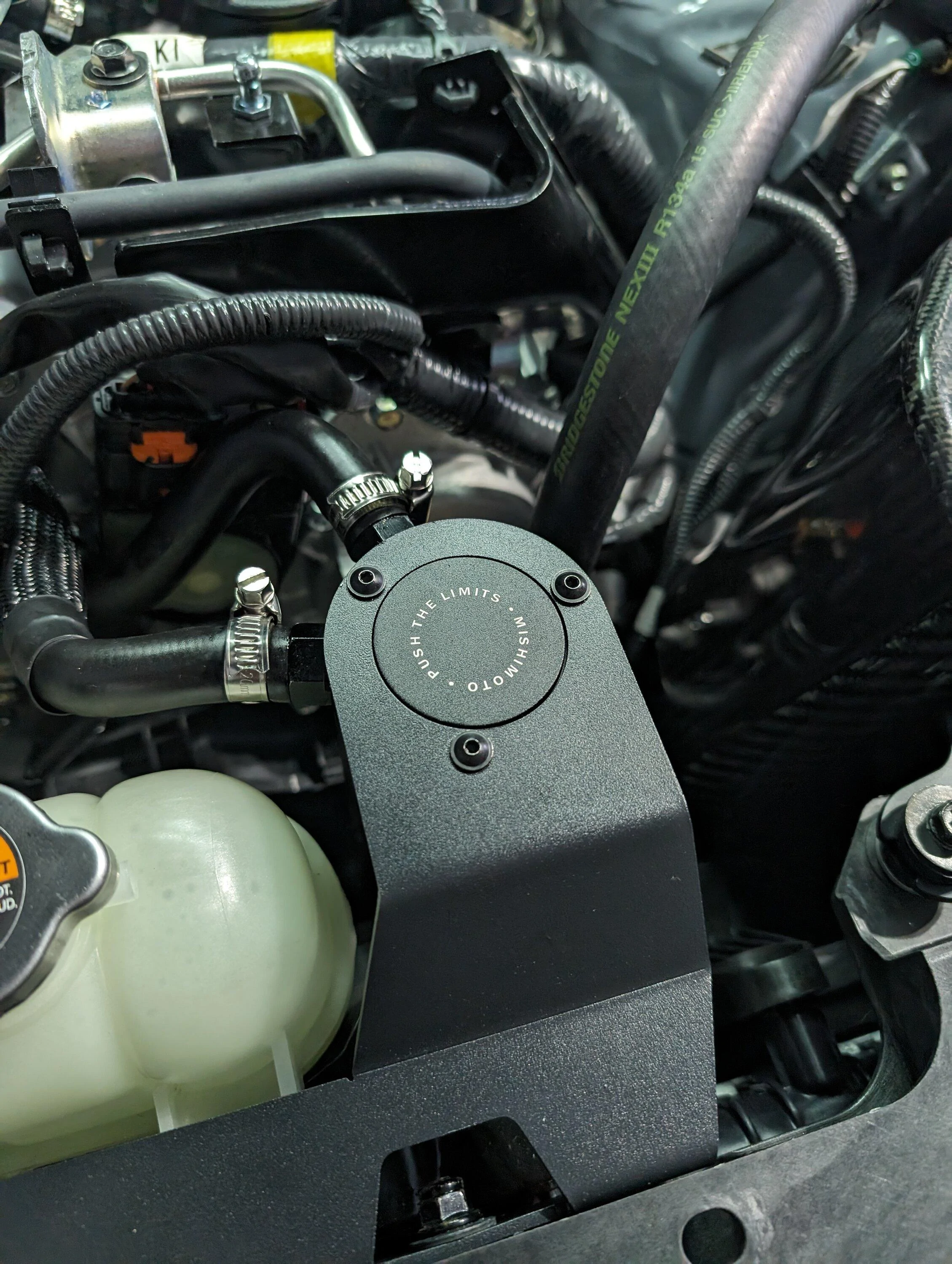

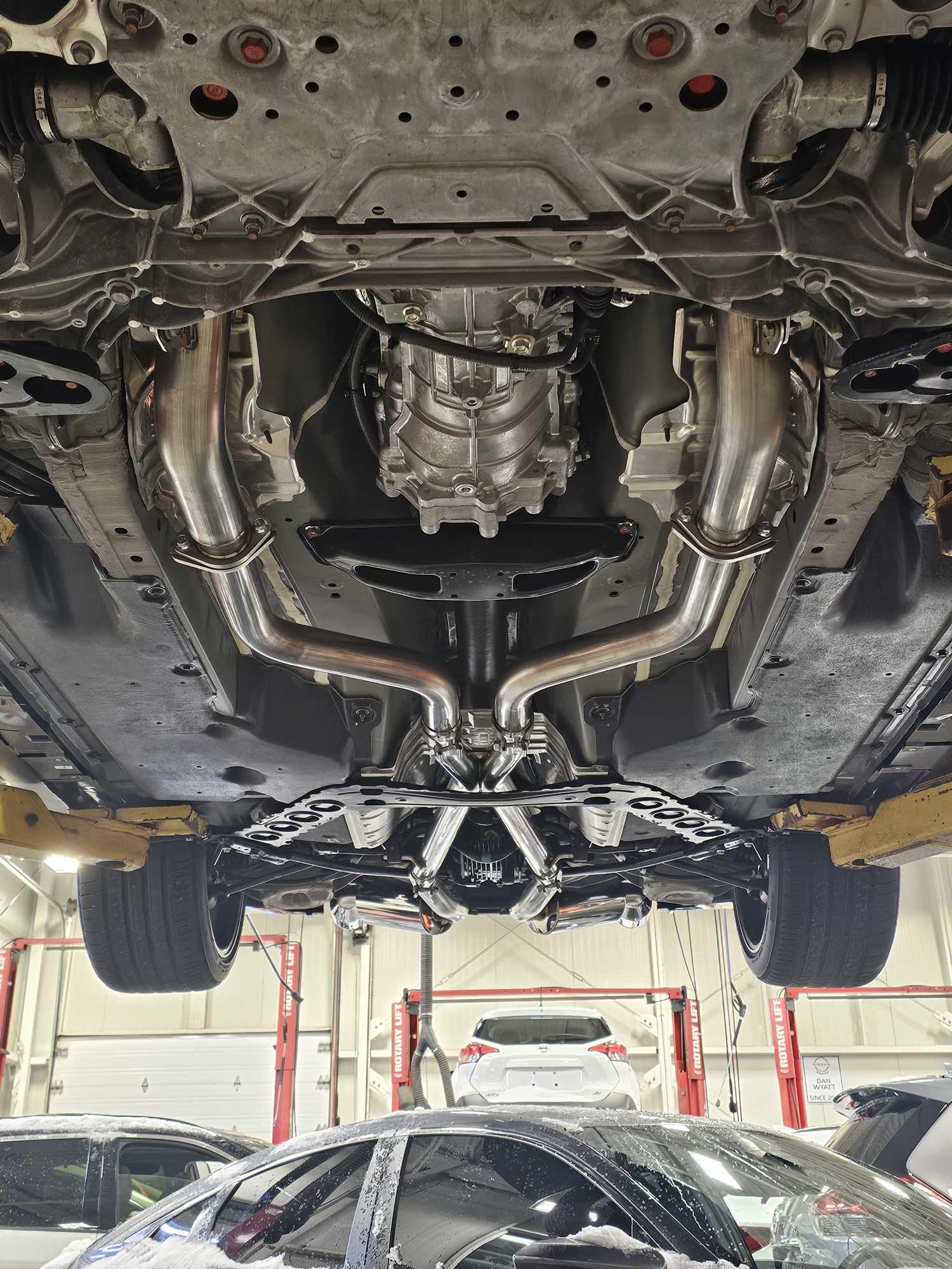

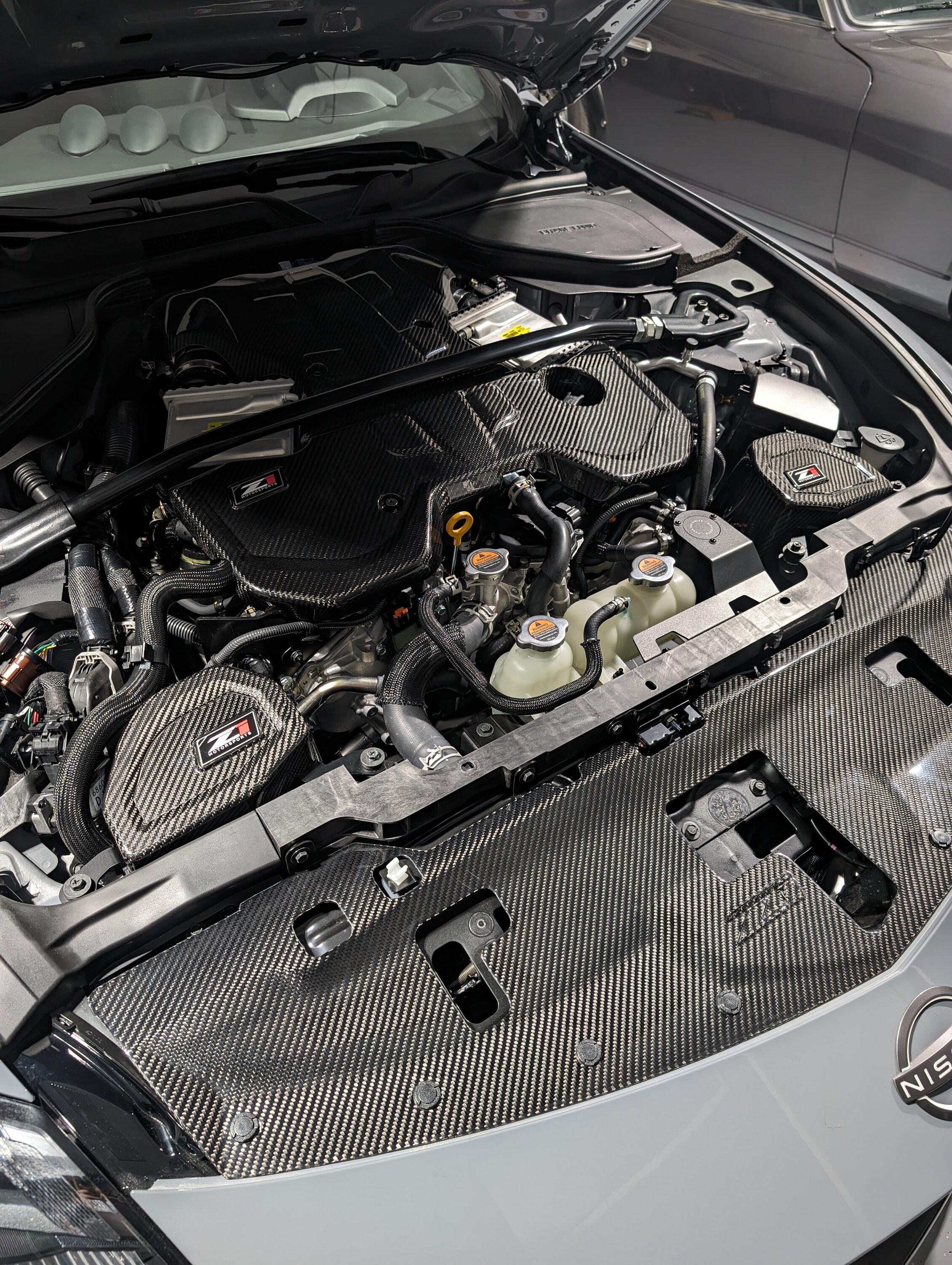

Got the intakes buttoned up yesterday and installed the Mishimoto oil catch can. The intakes were a bit of a fun time. Like others. Unclipping the stock boxes from the tube was a bit of a fun time. Only other issue I had was on the passenger side I had a bit of trouble with the provided intake tube and the angle of the crankcase breather tube. It kept wanting to kink the rubber line, and it's no fun wiggling things around down there haha. Other than that fairly smooth install. Also throwing up a couple photos of the exhaust install my dealer sent me.
nice and pimped out! tons of CF lol. are u gonna do a full CF interior as well?

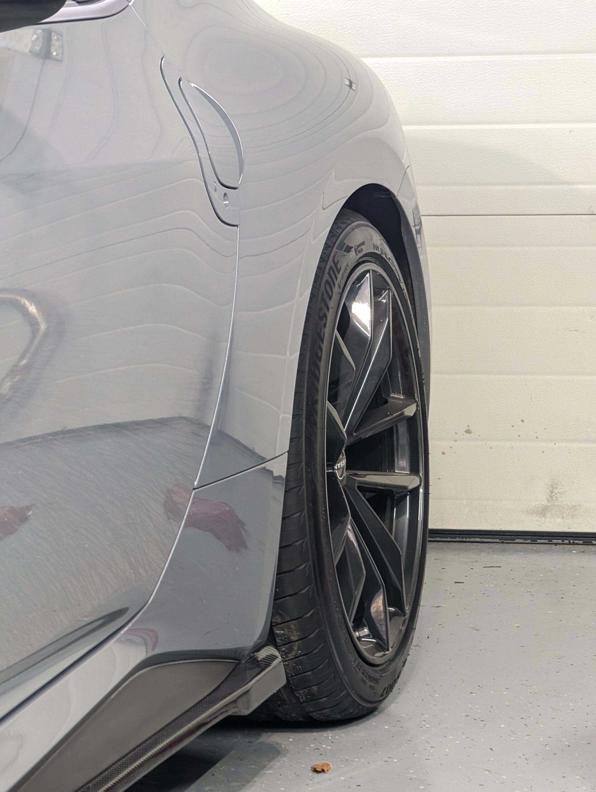

To be honest, that's prob it for now. Once I get the springs and spacers installed I just need some seat time, and drive the car for a bit! Got a full titanium dressup kit coming from Z Spec Design(Had some store points to use from MAPerformance when I ordered the downpipes) to kind of complete the look, and something to tinker with until the driving season. For now it's kind of where I want it to be. Got the rear springs done yesterday. Later today I want to get it back on the ground with the rear spacers, then work on the front springs/struts this weekend.

That'll be nice! Saving money is nice lmao. I got the rears done today, weekend I'll deal with the front struts. Bit of a Carolina squat goin on right now lmao
