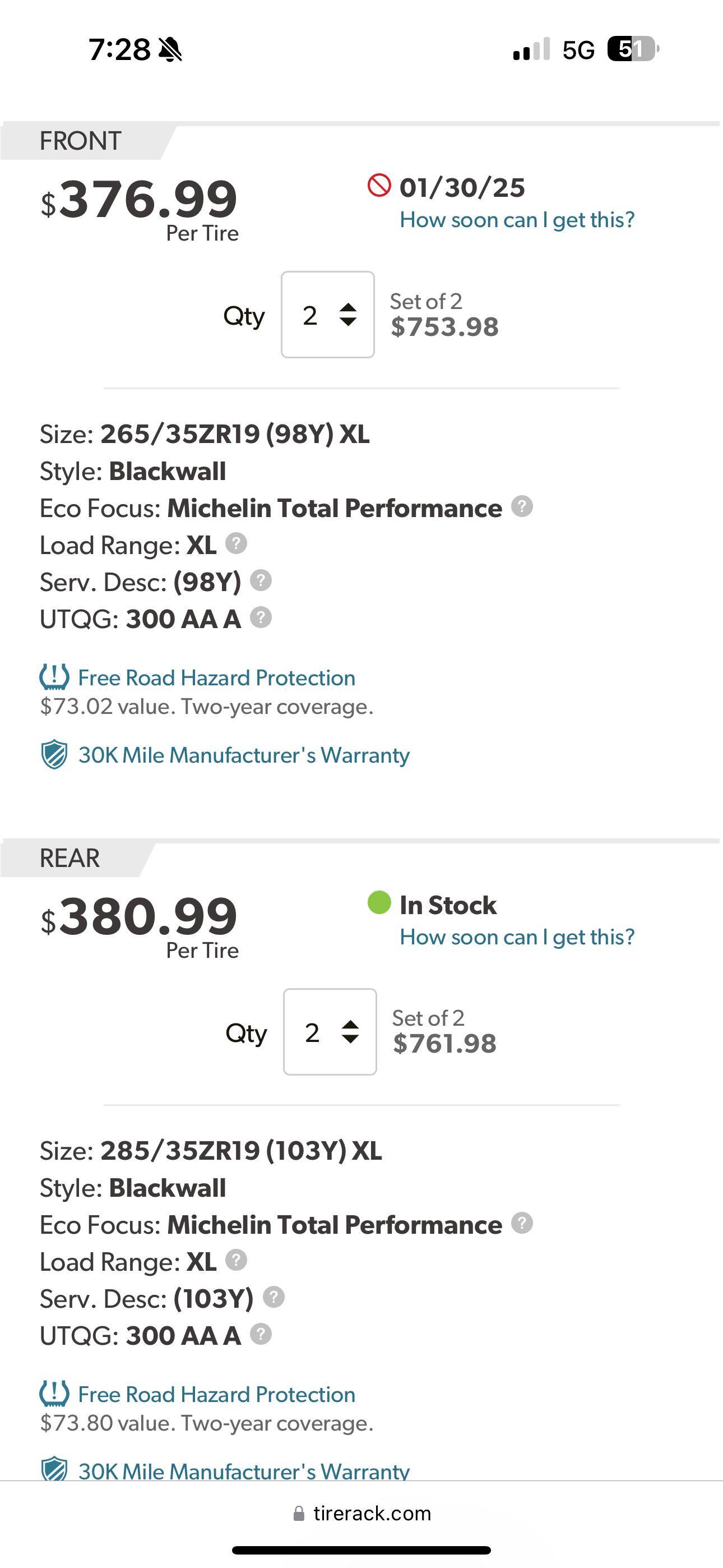

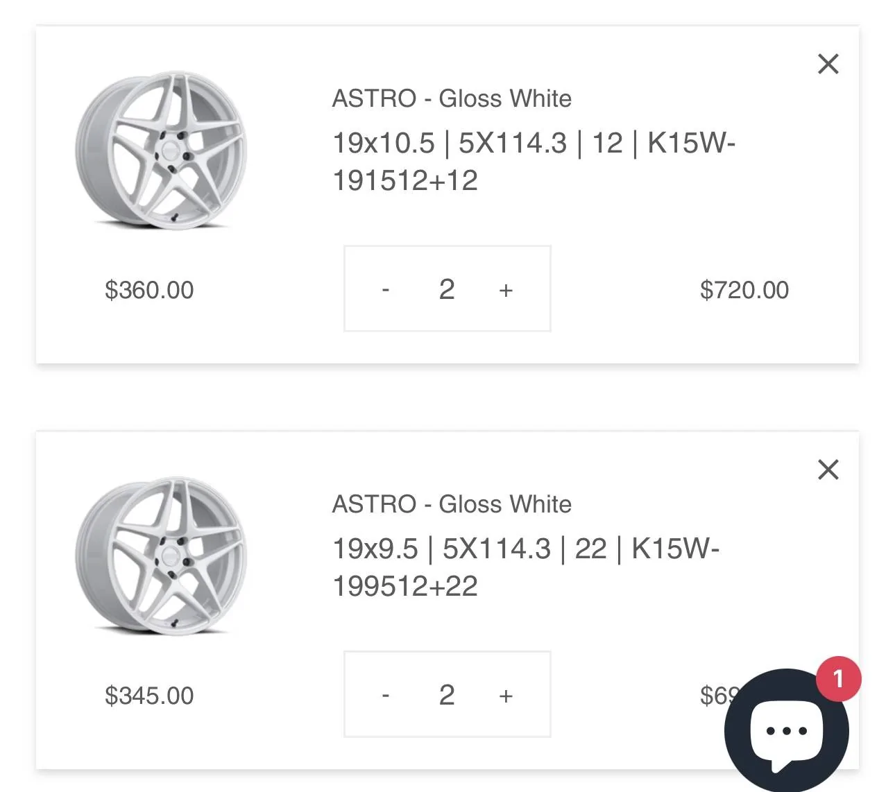

I am getting ready to pull the trigger and order my wheels and tires and I am not sure this is a good set up. Before I spend 3 grand and get the wrong stuff I wanted to see what your thoughts were. This is what I am looking at. The tires are MPS4. Thank you for your input.

As far as fitment its fine. Tire Rack sells fitment on the conservative side. Don't forget, you will need new TPMS sensors or have them transferred over from your OE wheels.

Thank you for your input. And yes I plan on getting new sensors. My OEM wheels will become my winter set.

tires may poke out past fenders.
my current rear setup 19x11 +15 sticks past fenders by 3mm. if you put square setup, tires might poke past fenders.
my fronts are 19x9.5 +15. these poke 4mm past fenders.
my tires are stage 3 stretch. 225/40r19 and 245/35r19. they would tuck in if i lowered the car.
i use this for my calculations https://www.wheel-size.com/calc/
Ok I have to ask the question. Why the smaller tire? Sorry I am a noob when it comes to this.
its my personal style choice.
stretched tires to fit under the fender when i install my coilovers. other wise, tires would poke past fenders. im one of those guys that get wide wheels and crazy offset.
i know i lose out on contact patch. but im not racing the car.

I should elaborate on willtheyfit.com. You enter your current wheel and tire spec, then enter your desired wheel and tire specs then press calculate. It will show all the measurements and also a visual representation of what the old and new setups look like.

Ok got it. I’m not racing either. More show than go. I would like nice and flush with the fender and maybe a tiny bit of negative camber.
