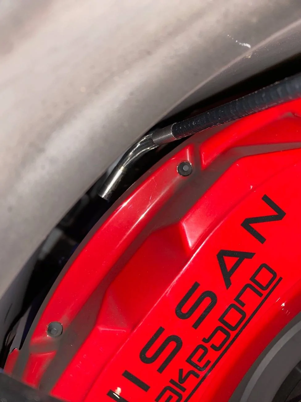

Agreed, its a pita as the bottom of the caliper is closed so you cant see the pads. I use this to check brake wear on everything, works great.
https://www.vevor.com/pipe-inspecti...camera-for-automotive-plumbing-p_010921210736
I have a few inspection cameras, but I didn't think that I could bend it into position between the wheel and caliper, to look into the edge of the caliper. Are you able to see the pads on the Nismo with that camera?
That would be amazing if I can figure out a way to look in without removing the wheels. These pads wear so fast, I have to check them every track day. Maybe I can wait 2 max before checking them.

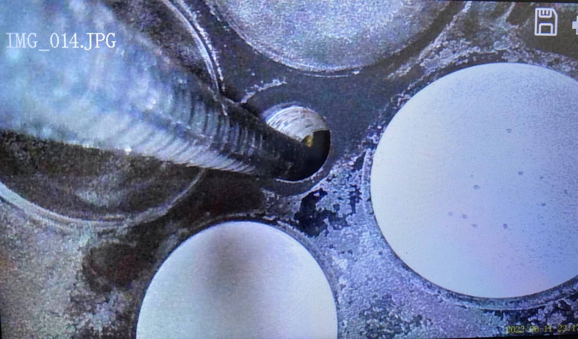

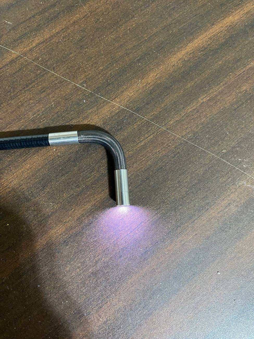

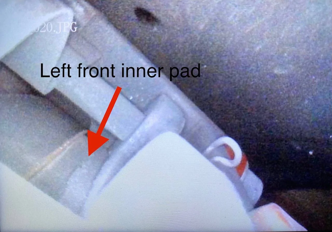

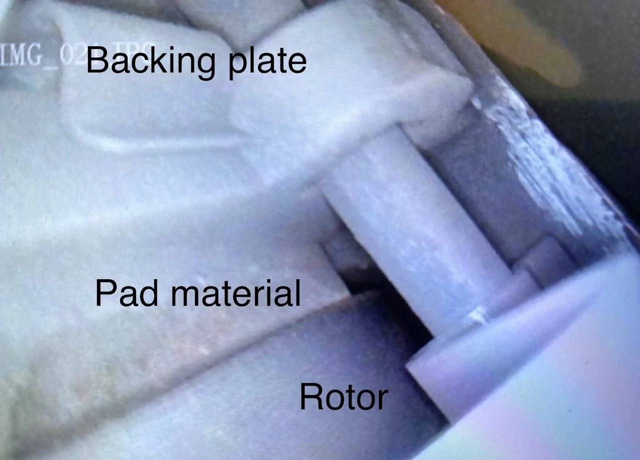

It fits in there perfectly, the camera is tiny, here are some examples. These are pictures of pictures, the actual resolution is a lot better. I'm at 8500 street miles and looks like %50 pad life left.
This is cool as you can put the camera in through the spark plug hole and rotate it up to look at the combustion chamber. This is not the Z btw.
That is so cool that the camera can be rotated up!! I didn't know that they do that nowadays. I have 2 older cameras. One is used for plumbing and it has way too big of a head on it. My other one links to the phone, and has a smaller head, so it may work. I'll let you know if it works. But none of mine have a "steerable head"! If I can't see the pads with my camera, I will buy the same one that you have, that's perfect.
