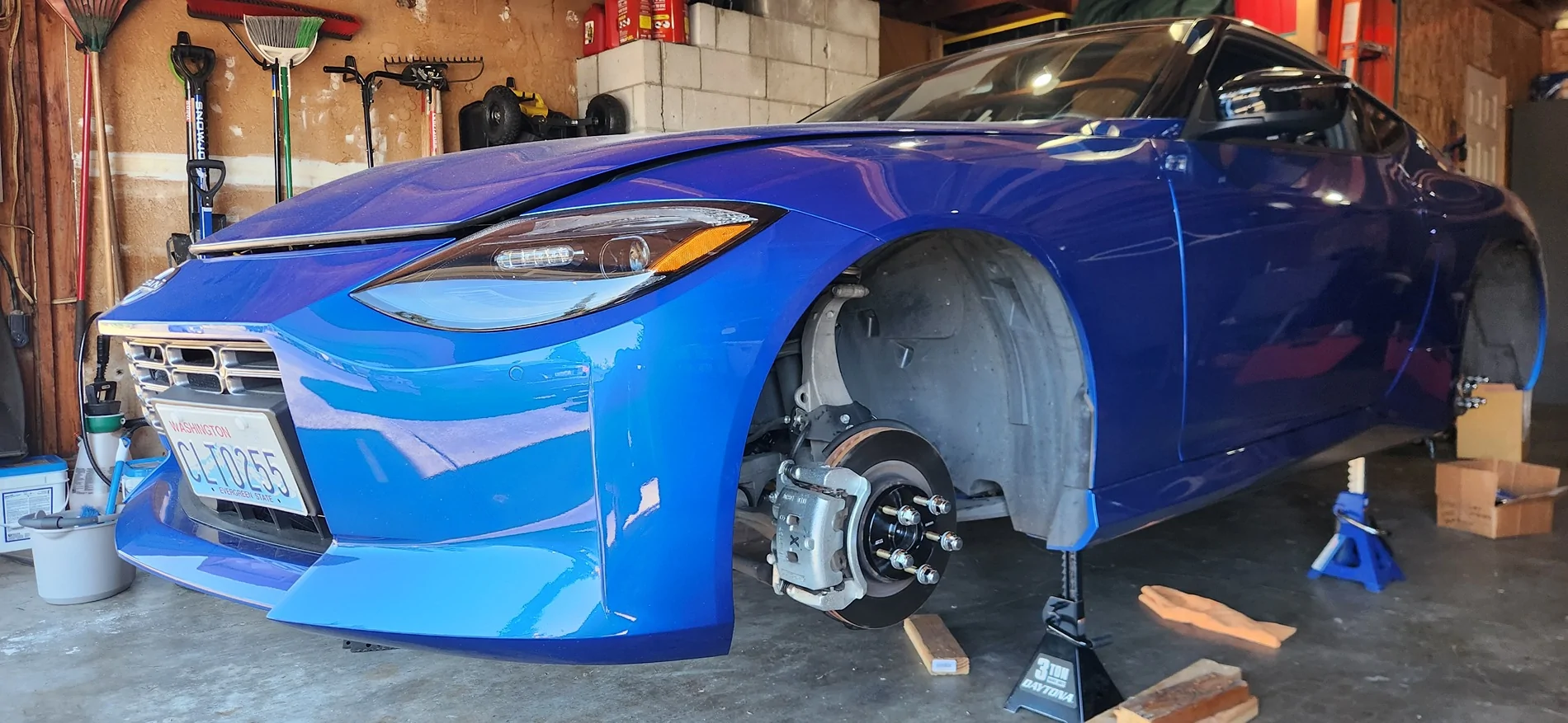

I hope that A is viable as I feel it would be a more stable lift. I am fine doing B for now though but my blocks are getting indents in them. Better the blocks getting indented than the metal pinch welds bending so I am fine with it.
I personally will never use method A. I'm too afraid of bending that pinch weld.

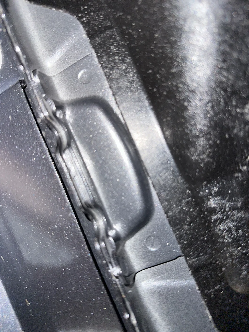

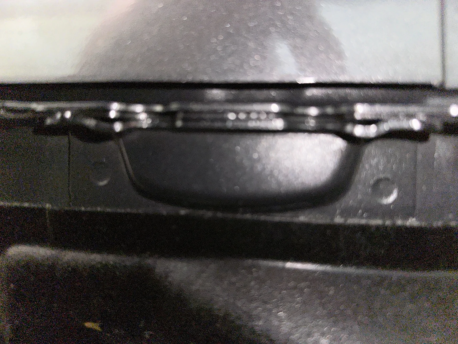

The pinch weld is just a locator and notch to keep the jack in position. It’s not intended to lift / support the vehicle. There is a pad on the inside of the pinch weld that is lower than the outside area of the pinch. The pad is the area for lifting and since the pad is lower the jack or jack stand does not touch the plastic trim on the outside of the pinch weld. So you need for the notch in the lift to be deep enough to clear the pinch weld.

I would say just use the jack point in the middle of the car, but I believe the stupid plastic shroud is covering it. I could be wrong. I just drove mine up on ramps to change the oil, which is not at all preferred. I need to figure out what I’m doing with the low profile floor jack and lift it up to rest on my 12” race blocks.

When you look underneath the Z from the front. You will see a metal nipple. That's where you jack it up. I drive up on two 2x4s stacked under 1 wheel and drive on it. Or, jack front corner pinch weld and get the tire off the ground to slide the 2x4s under the tire. This will give you enough clearance to slide the jack from the front to reach the nipple.
EDIT: If you have 2 floor jacks, you can skip the 2x4 method
