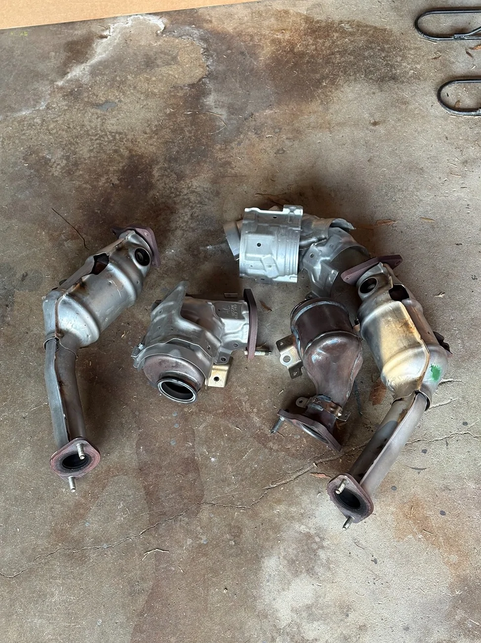

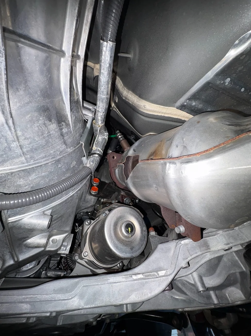

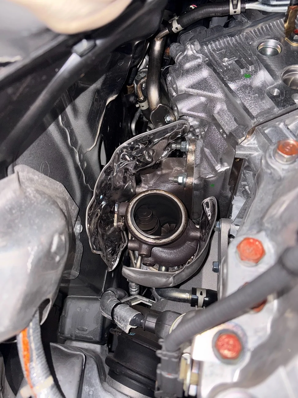

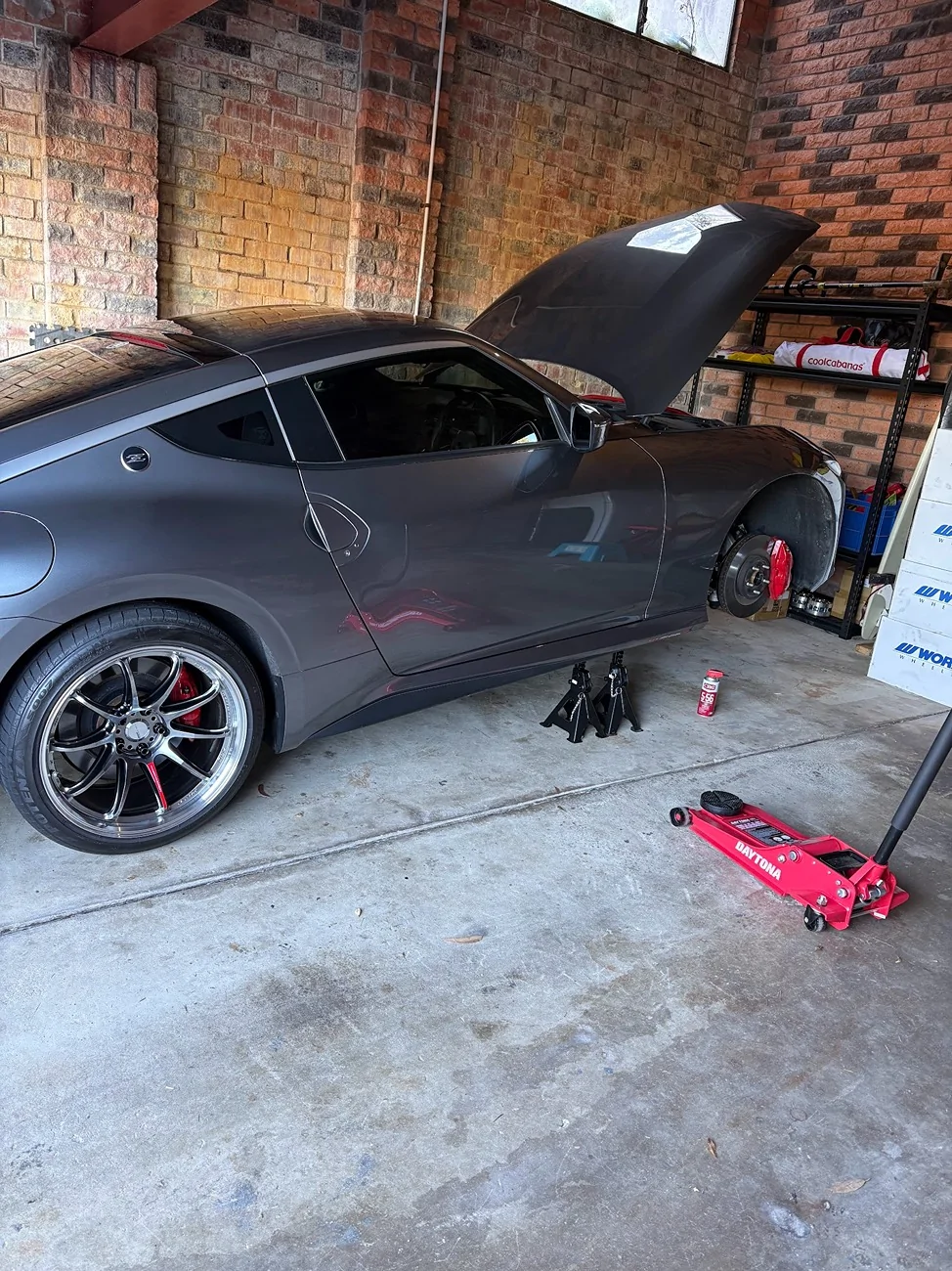

Today I locked horns with the full MAPerformance downpipe installation, and came away victorious. I was expecting this to be bad, and it was... but it wasn't impossible even on the garage floor.
A few tips if you attempt this yourself:
1. A lift would make life easier.
2. Spray your nuts - even on a pretty new car I needed a pry bar for the LDPs.
3. The heat shields are tedious, expect to lose some blood.
4. I used a 10mm ratcheting wrench on every heat shield nut apart from one that is recessed into the side of the turbo. I would not attempt this job without this tool.
5. For the other nut I used a tiny 1/4 ratchet, and for the v-band I used the same 1/4 inch ratchet with an extension and an elbow.
6. Just generally you need a big selection of extensions and elbows in every size.
7. I took a few goes to get the v-bands installed correctly. I found the trick is to bolt the DP to the bracket and make sure it's seated on the turbo, then pop the v-band around the pipe and wiggle it into position. I then got a cable tie around it to hold it while I put the screw in - very fiddly.
8. I did this in my garage so I could take my time with it, whenever I got frustrated I just took a break.

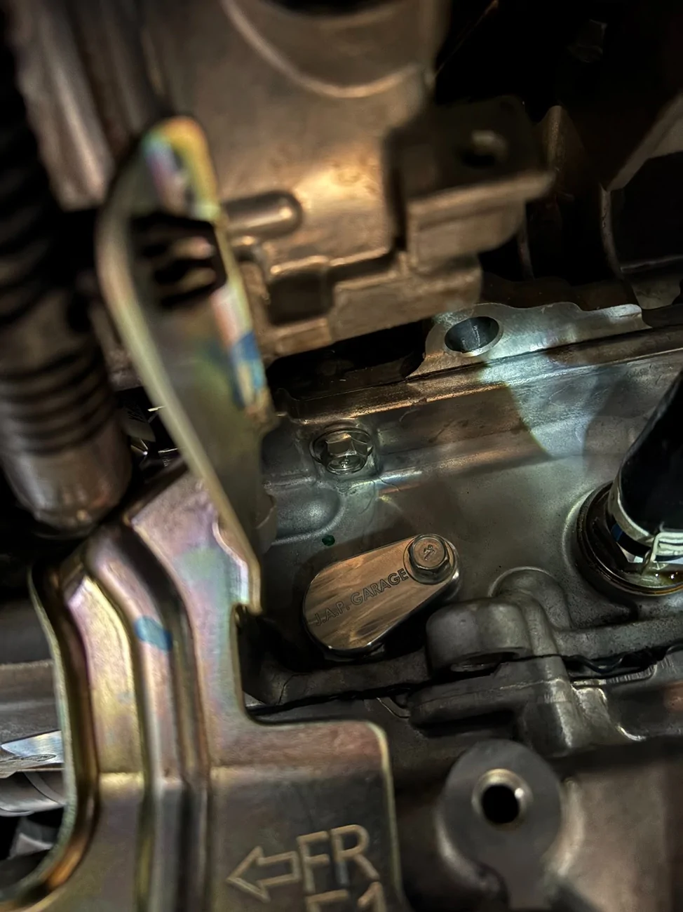

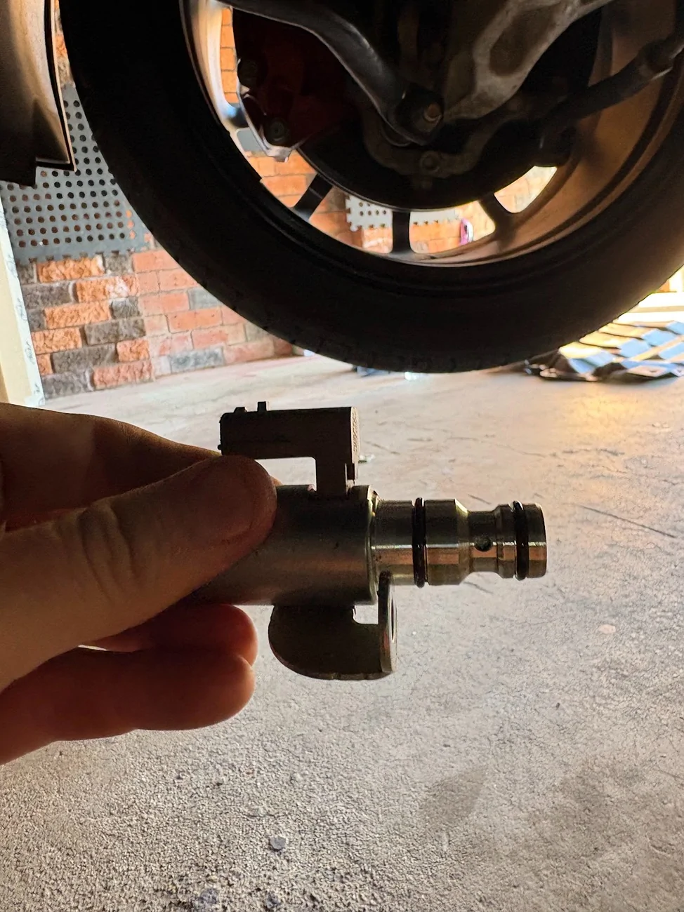

Finally, my ecutek kit turned up from Sonic Tuned along with the oil solenoid blockoff. The blockoff was a super easy install, and I'm about halfway through my tune with Sonic. I was a little worried about doing a remote tune with someone half a planet away, but it's been so easy and I'm glad that I went with someone that knows the platform so well.

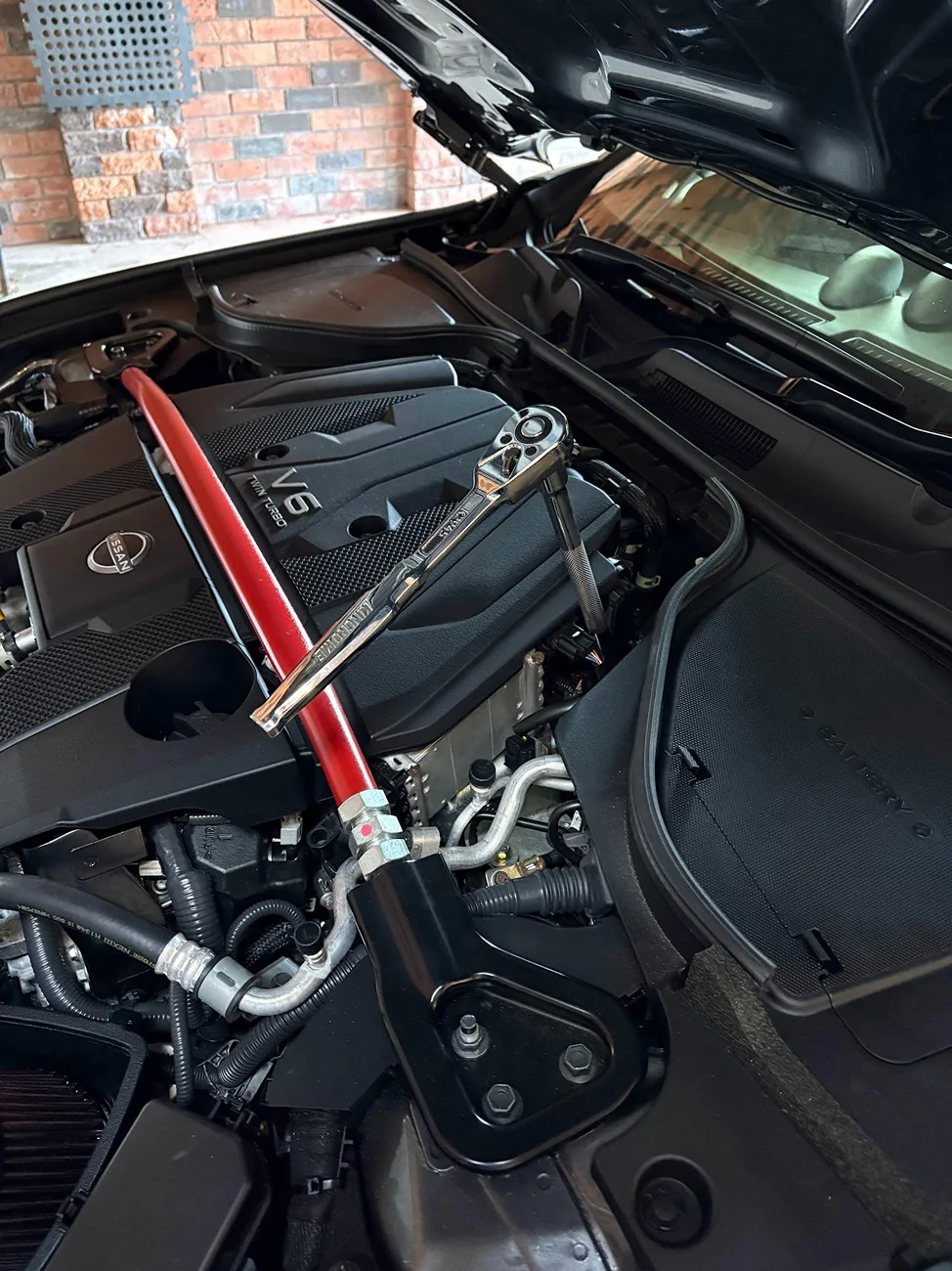

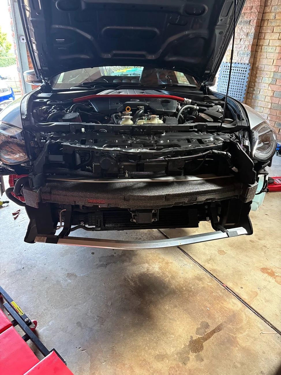

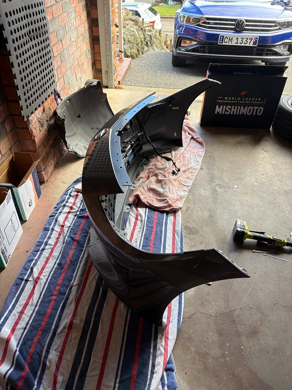

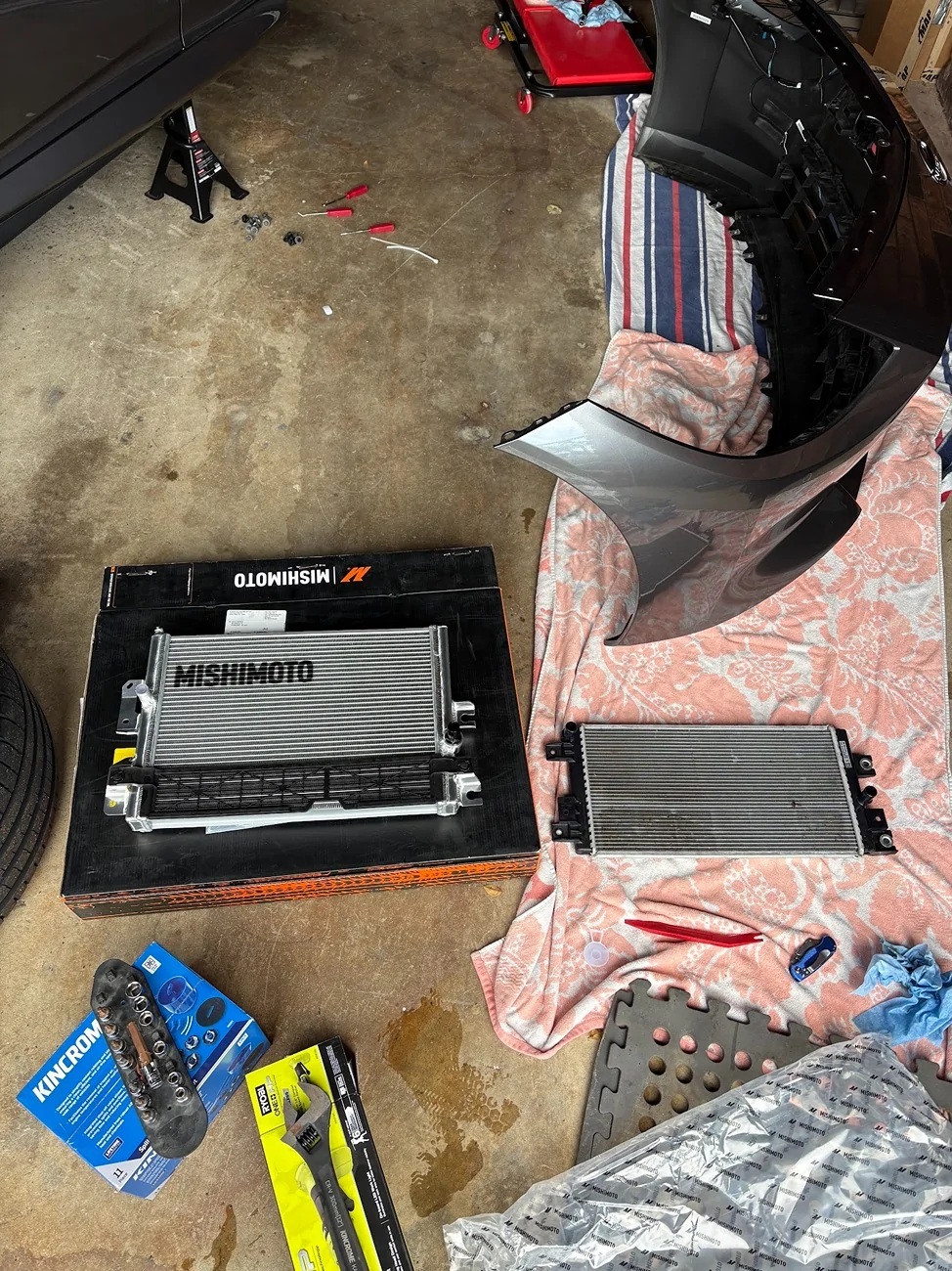

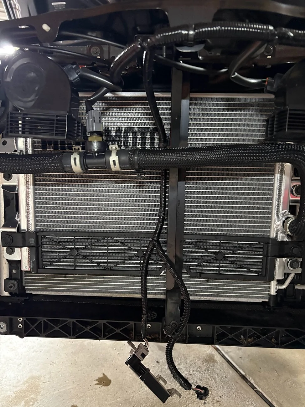

Basically all of the mods I had planned were now done, but I still had the heat exchanger to install so that was todays job. I was a bit worried about pulling the bumper off, and also concerned about bleeding the system when I was done, but most of the work was just removing clips and 10mm screws so I gave it a go.
Here we go again:
Bumper off 😌
I should not be in here:
Old vs. new. The new one is also 2-3 times as thicc.
Shame you can't see this with the grill on

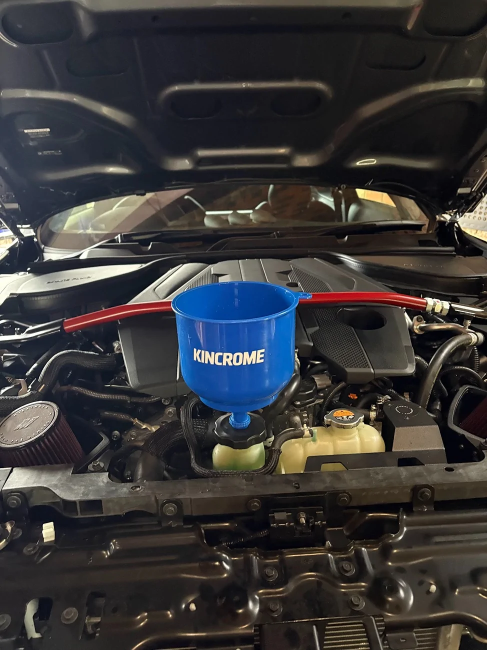

I didn't have a vacuum bleed kit, but I clamped the lines when I disconnected them and used a coolant funnel to burp the system. I ran it for a good 5 minutes and repeatedly cracked the bleed screw on the heat exchanger, so hopefully it's good to go now. I'll monitor coolant levels next drive.

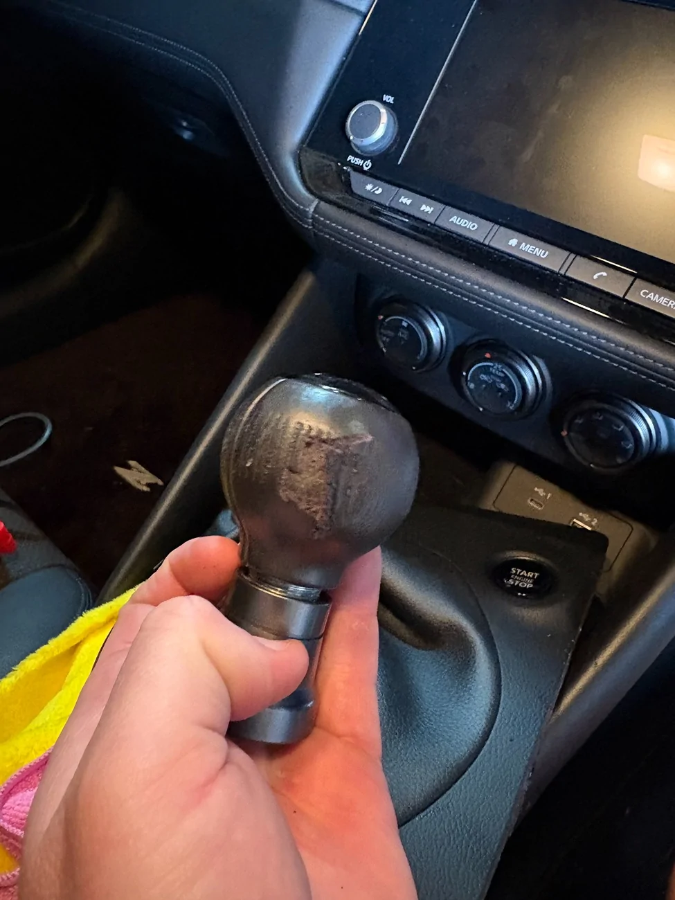

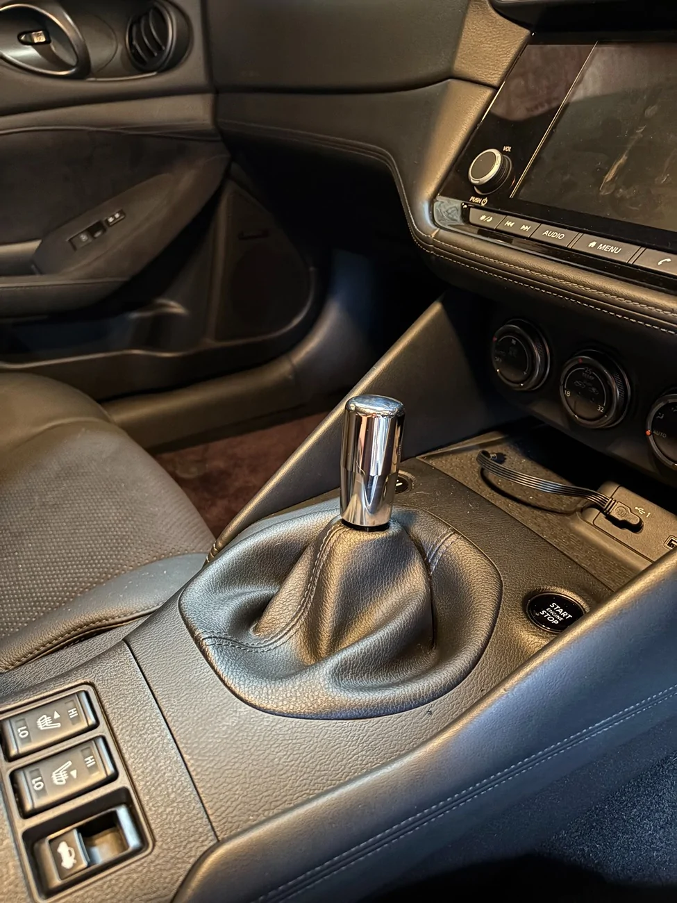

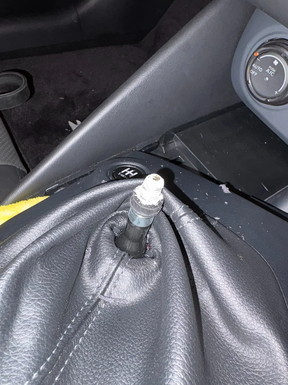

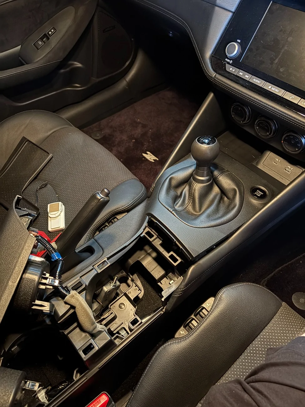

The worst mod of all, gear knob! TBH it wasn't that bad, just forget about trying to keep the original knob in tact. I put a lot of heat on this thing and tried and tried with the strap wrench, but I couldn't get it to budge without clamping it.
Very easy to unclip the centre console:
Commitment pays off:
IDK why they are so worried about these things coming loose:
Nismo shiny boi. A lot shorter and nice weight:

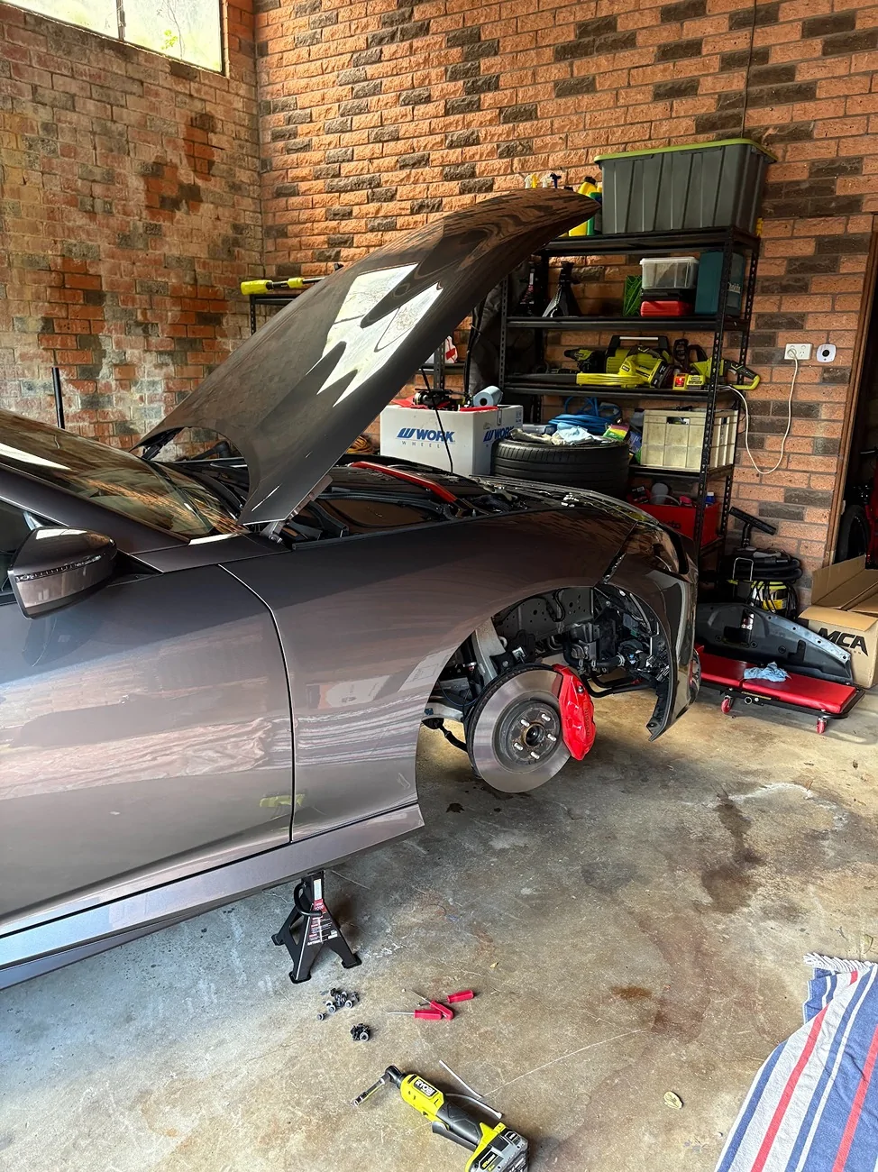

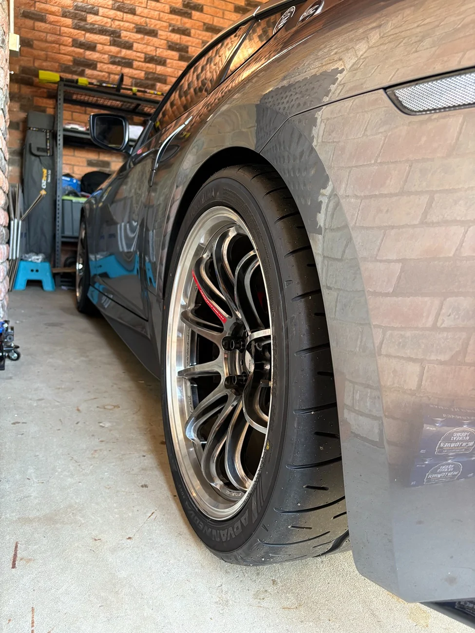

I decided to make my car more trackable. First up was a set of semi slicks, I went with Yokohama AD09s since I got a good deal on them.
Sizes are:
275/35 front
305/30 rear
Bit of a different look compared to the v107s in the taller profile, but I'm happy with the meatyness, and the grip.

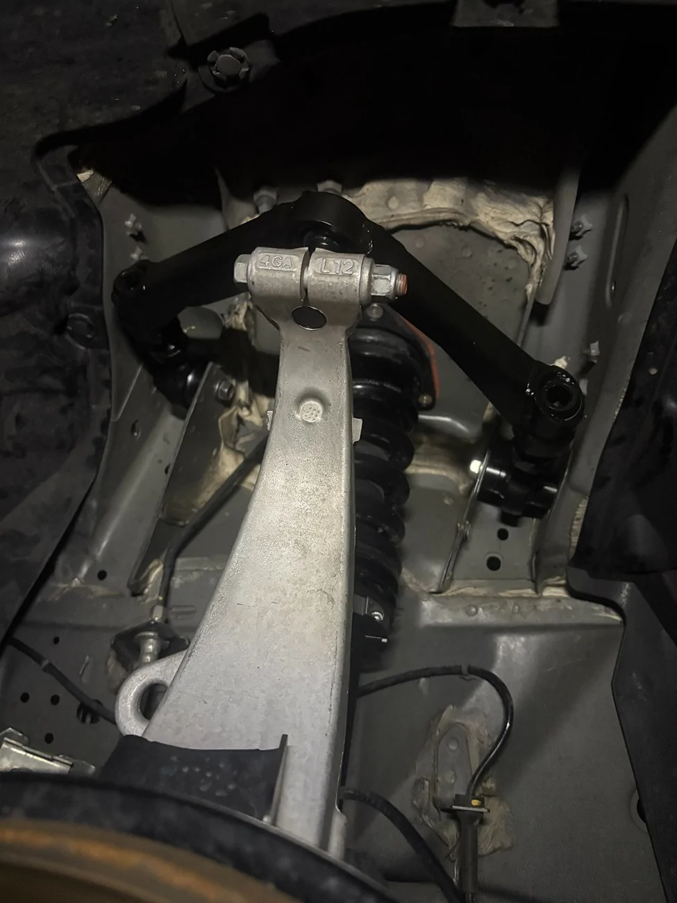

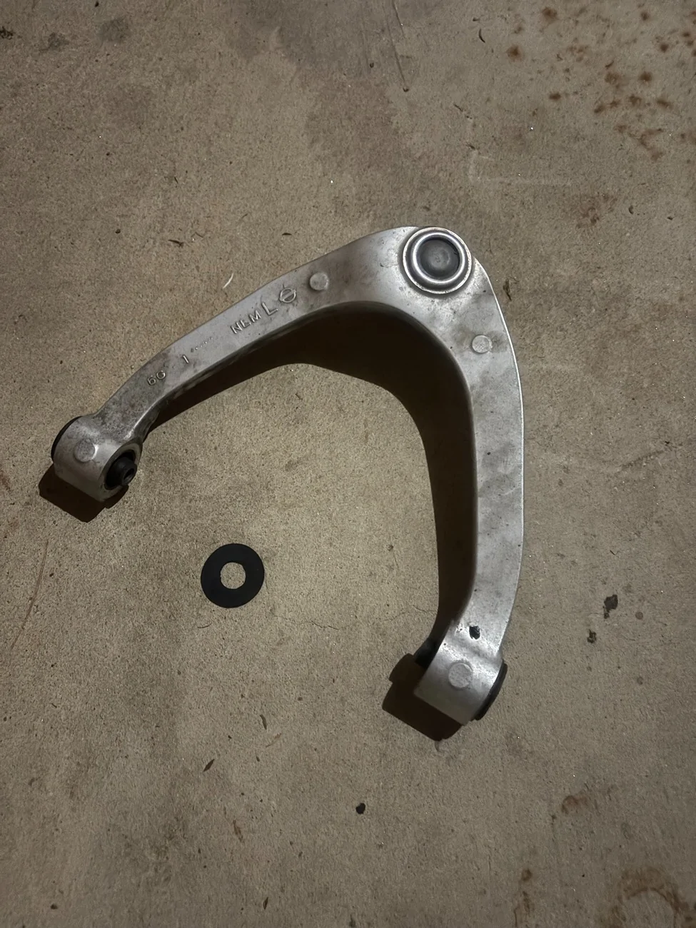

Next item was FUCAs and high misalignment tie rods with bump correction. Both are from GKtech and they made a HUGE different to how the car steers. I think I went a bit aggressive with the bumpsteer, so I'll go to a more inbetween setting next alignment.
I've gone a little more camber than stock now, but not excessive as to wear the tyres, since I mostly do mountain pass/touge driving.

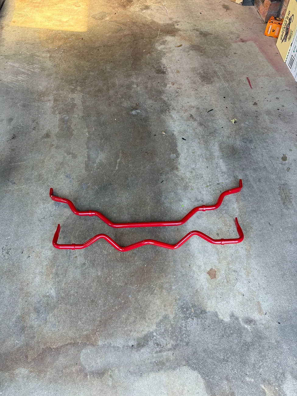

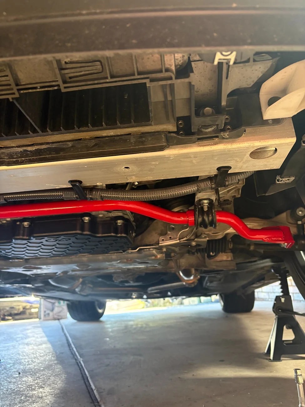

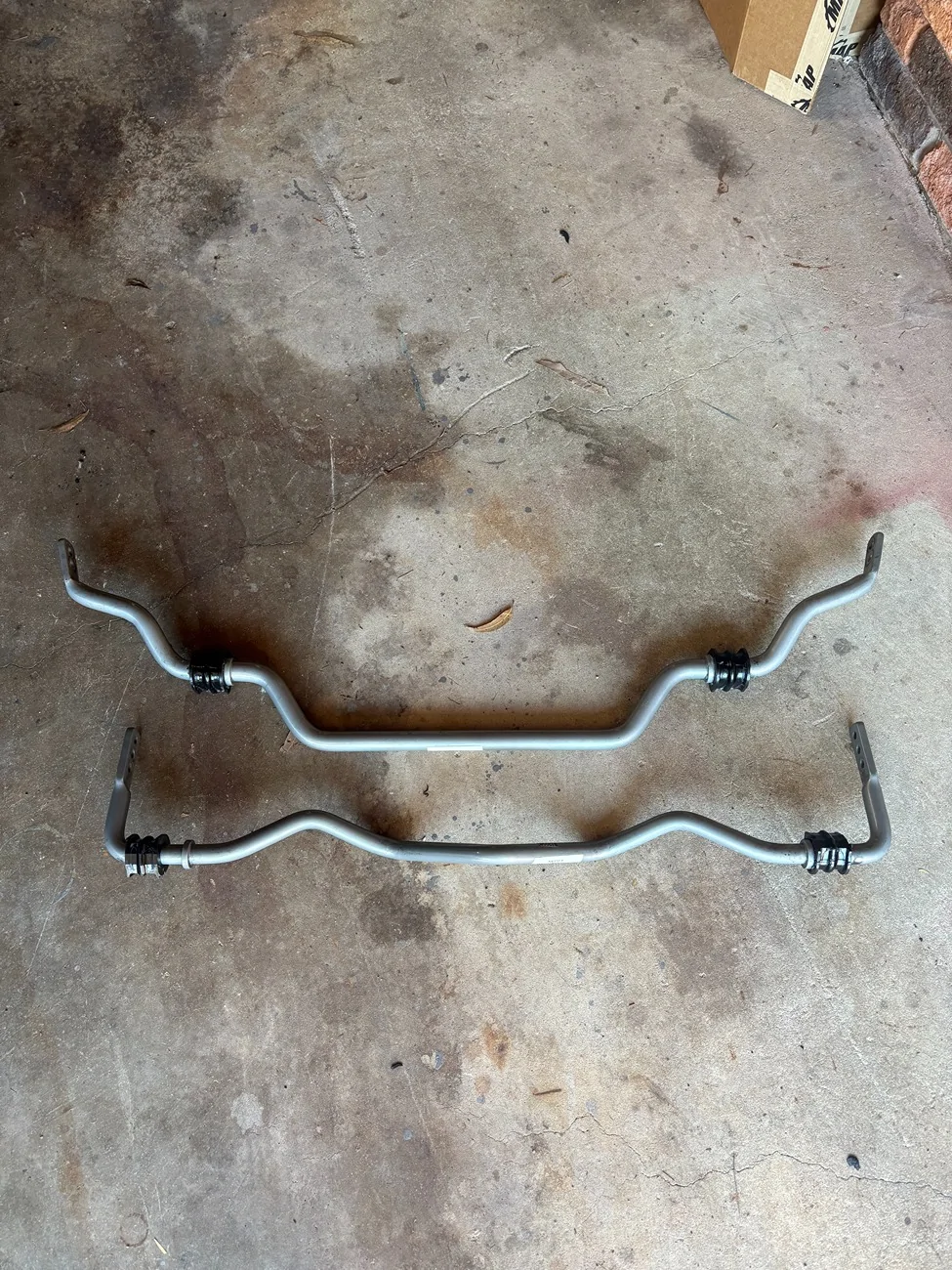

Last up and I swapped the whiteline sway bars for some stillen, to give me some stiffer settings. You can read my post about my testing here. If nothing else, they look a lot nicer on my car - just a shame you need to cover the front one up with the undershroud.
The FUCAs and the tie rods were some of the last parts on my list, so the car is pretty much "done" now as far as everything I had planned. I'm mostly focussed on getting a better setup now, so a bit more experimentation with settings and pressures for the next little while, and then I'm sure there will be more things to buy.
