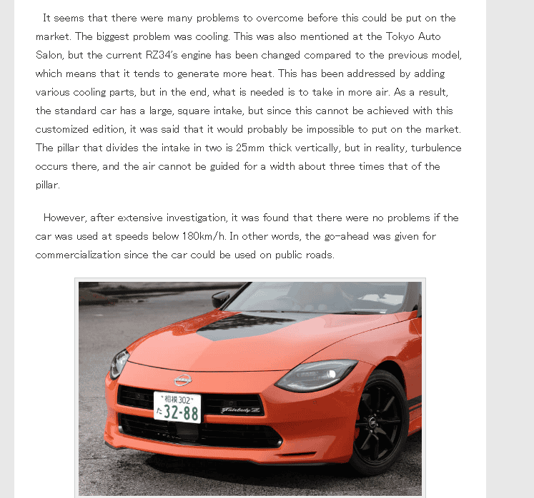

here is an article from japan talking about it. Anything Do it yourself or even that speed forme grill add on will most likely cause varying degrees of added temps. I would say in commuter situations probably negligible but on hot days when there is a lot of idling or spirited driving it could potentially be something to keep an eye on. Nissan has tested this new bumper at their Arizona testing facility. Ive got pics of it on my phone I cant share
I was thinking about this recently. Do you think it wouldnt be as bad without the license plate? Would it be more in line with our stock bumper + license plate? Wonder if big US license plates make a difference?
Id say it looks better without that plate. Just in some angles it looks great but most angles id prefer the oem bumper we have now
I dislike front plates haha, I was wondering more about cooling issues that he mentioned.
