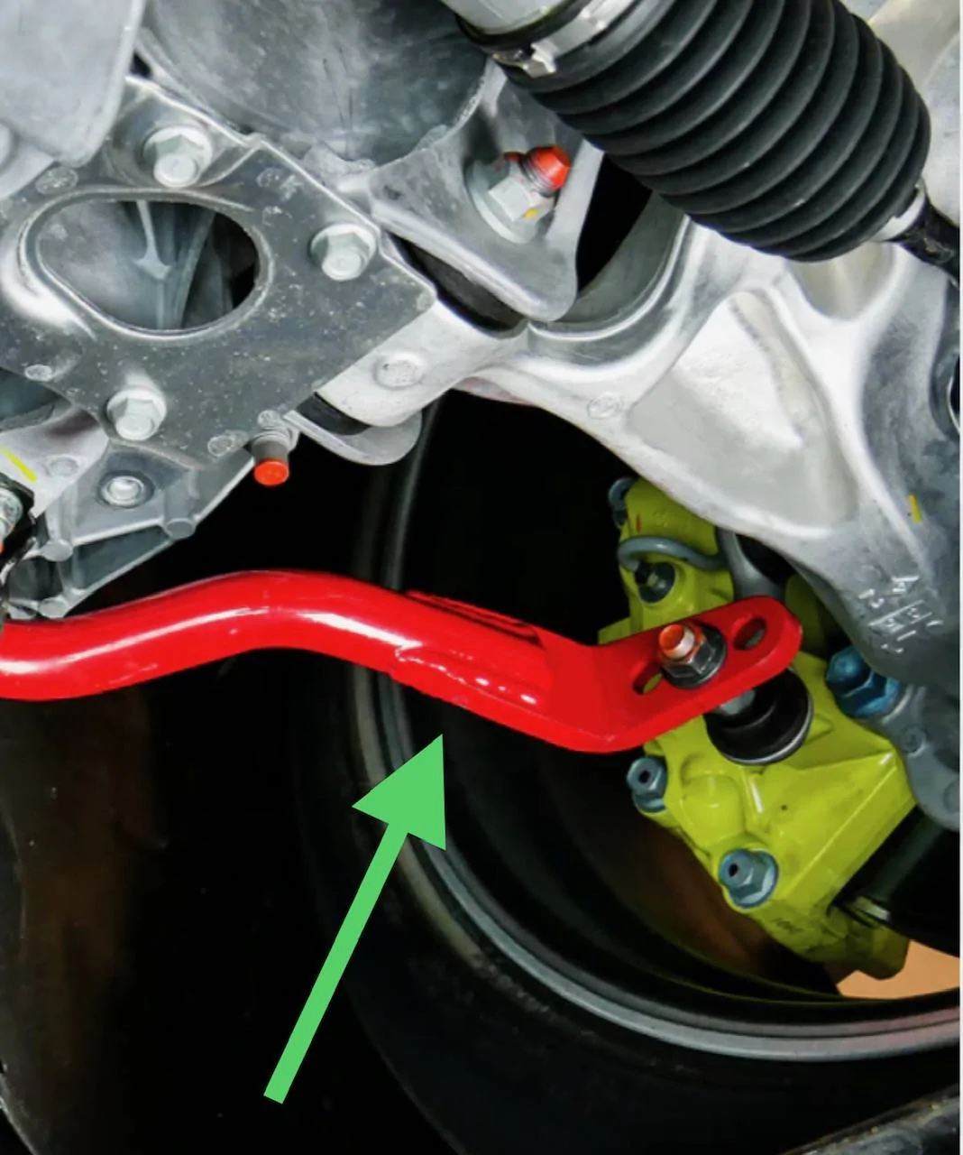

The OEM sway bars for the Z NISMO are slightly different than the performance they are 2 millimeters thicker have bigger bushings and have air guides for the brakes on them.
These are different than the NISMO USA sways you but from a dealer. Those are red and a bit thicker than the OEM but have had some quality control issues

Ive been looking for a set of sway bars for my Nismo but the compromise is that you loose the brake air deflectors if you go to an aftermarket bar. The deflectors make a HUGE difference in brake temperature and wear if you track your car.

The Stillen bars wont work with the Nismo air deflectors because they have the outer adjustment ends welded on to the main bar and that's exactly where the outer mount is for the air deflector. Its a U clamp type mount so it needs to be a round bar for it to work. I think the best bet for Nismo owners or those wanting to retro the Nismo air deflectors is Whiteline at the moment. The WL is 27mm vs oem 28mm so its a very small difference to make up in the clamp if you have to, it may even just bolt up tight as is. I will order a set and see for myself.

The Stillen bars wont work with the Nismo air deflectors because they have the outer adjustment rends welded on to the main bar and that's exactly where the outer mount is for the air deflector. Its a U clamp type mount so it needs to be a round bar for it to work. I think the best bet for Nismo owners or those wanting to retro the Nismo air deflectors is Whiteline at the moment. The WL is 27mm vs oem 28mm so its a very small difference to make up in the clamp if you have to, it may even just bolt up tight as is. I will order a set and see for myself.
oof, that sucks. Hopefully over the next year or so we will start seeing some aftermarket stuff which works with the NISMO. Finding parts between the Z and the NISMO isn't exactly easy.
