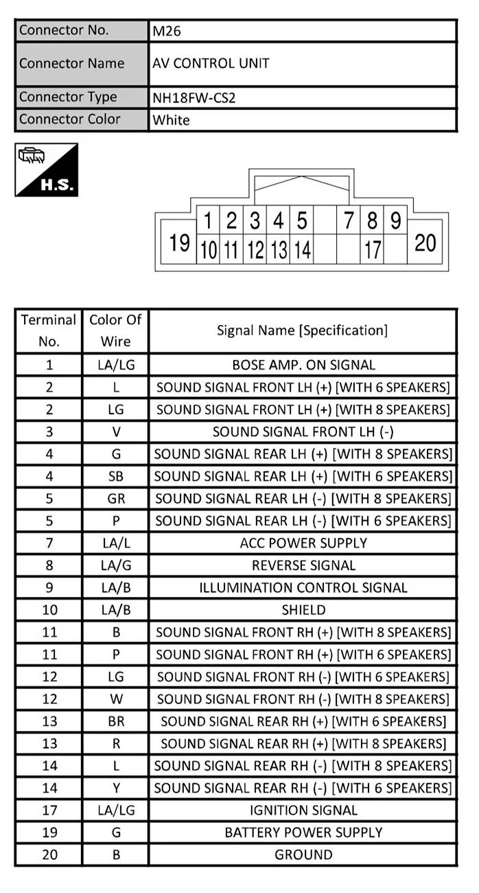

Steps 25-27 are the key steps. If you want to run amps/DSP in the Z Sport, you have to pull the head unit to tap into the harness. Performance guys have it much easier; they can just tap in before the Bose amp in the hatch. Anyways, I documented the process of pulling the head unit to help out anyone who may need it since I hadn’t seen it documented anywhere else yet.

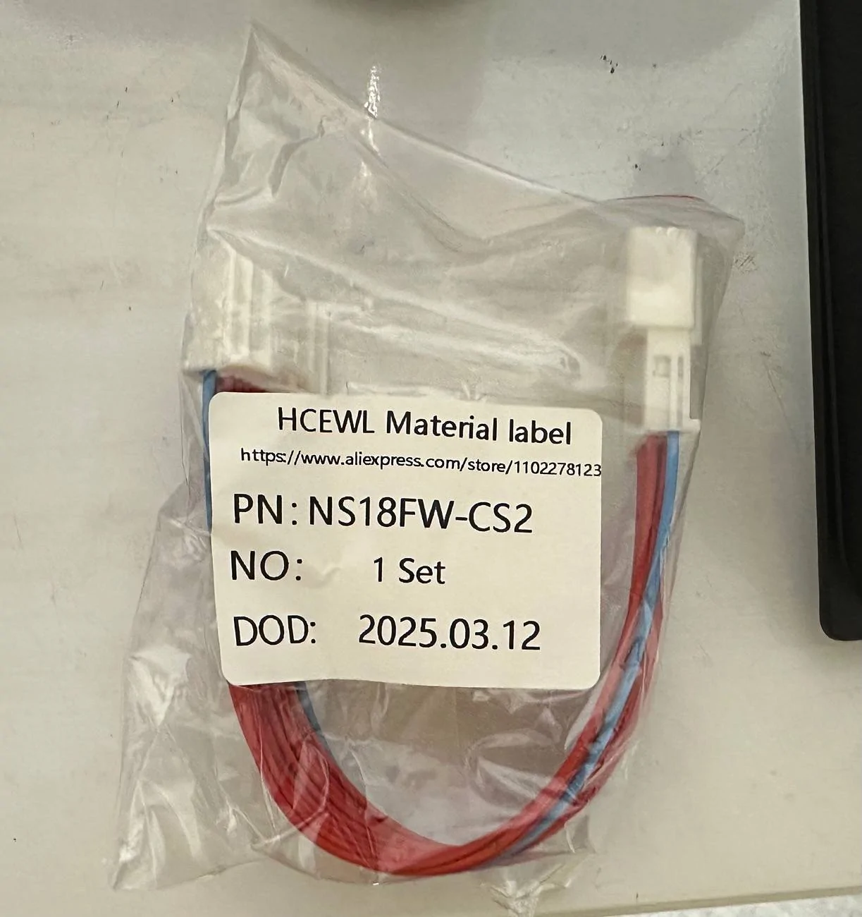

Here is the link to the one I bought: Link
I don’t really trust AliExpress but I was desperate and in a hurry so I chanced it. If you want to try to find something more local, the connector type you’re looking for is an NH18FW-CS2. Make sure you get a harness that’s male on one end and female on the other.
Hey bud, apologies but the link shows what looks like the harness for one second then says not available. I google searched for NH18FW-CS2 but the results coming back don't look right to me. If you have a moment would you be able to share where I could look to find the harness? If not, no issues, I'll try to figure it out lol.
Thanks again
I’m getting the same result. It was working a couple weeks ago when I posted the link. They must have taken it down for some reason.

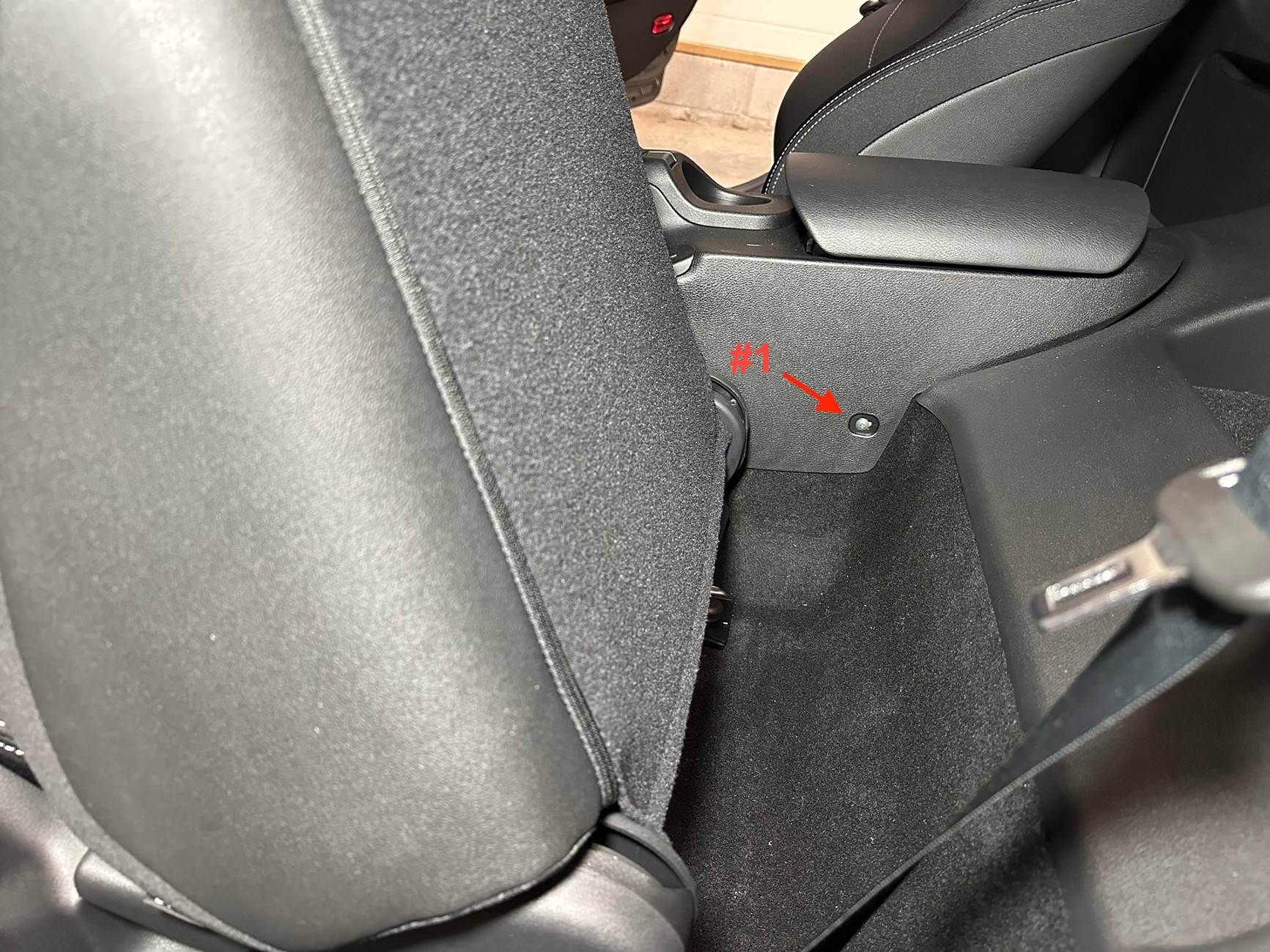

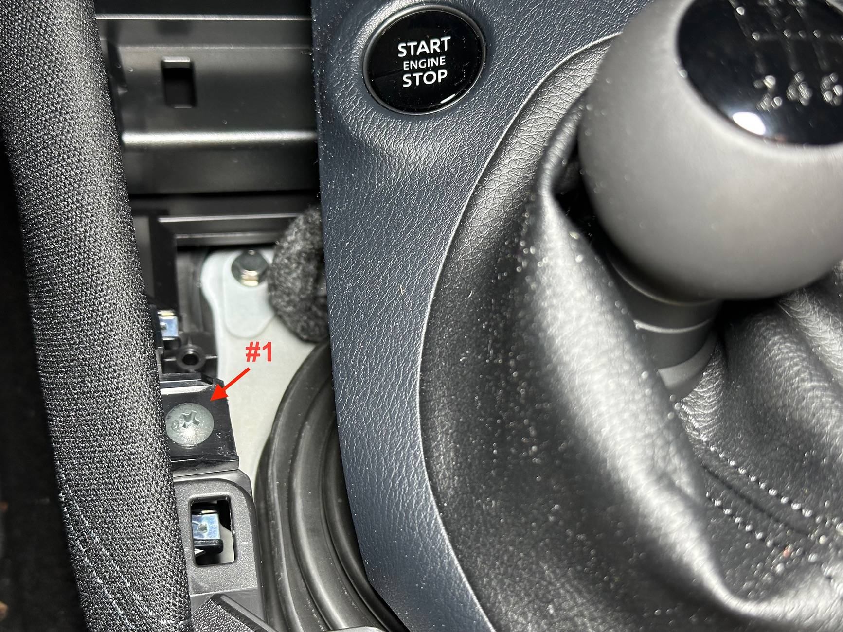

1. Slide the seats forward and remove the screws (#1) on either side of the center console (driver side pictured). This isn’t 100% necessary to remove the head unit, but it you plan on running any wiring to the rear as part of the process, this will give you a little more wiggle room.

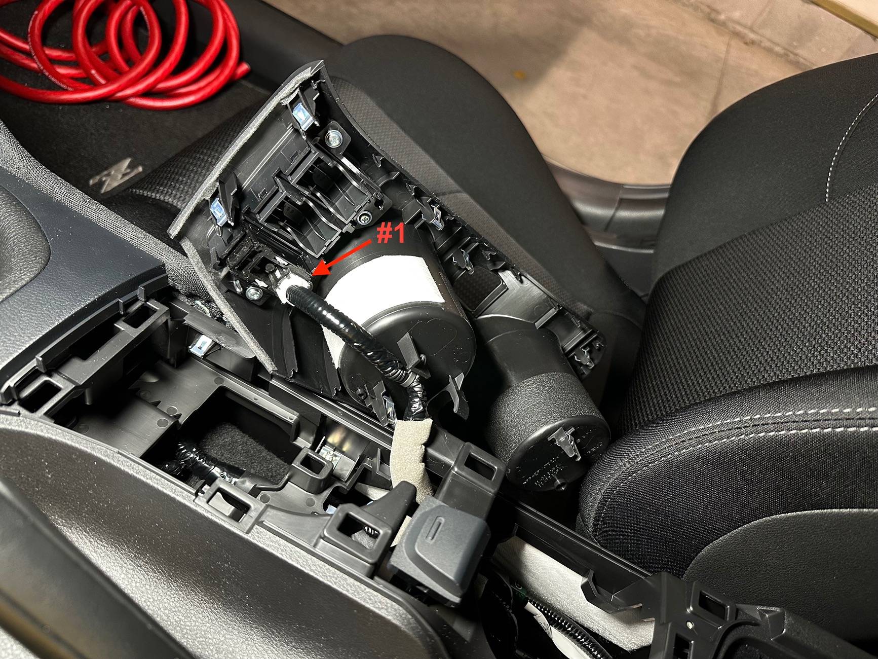

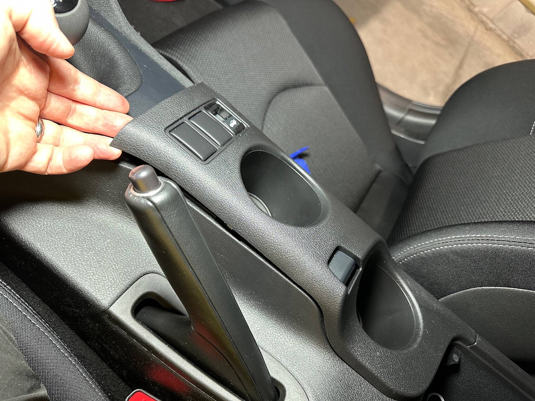

2. Remove the cup holder assembly by lifting straight up to disengage the clips. I found that it was easier to start at the front and work towards the rear.
3. Disconnect the plug for the trunk release (#1) and set the cup holder assembly aside.

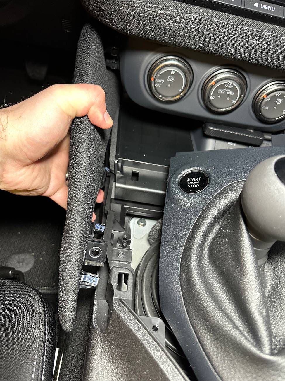

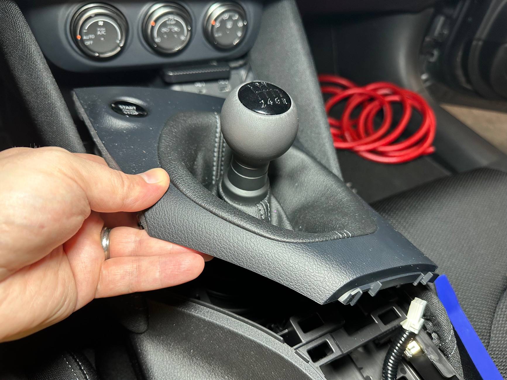

4. Remove the shifter finisher by lifting straight up to disengage the clips. Start from the front and work towards the rear, alternating clip release from left to right (you don’t want to pull up on one side more than the other or you could stress the piece). I chose not to fully remove this piece because I didn’t want to deal with disconnecting the boot from the finisher; I just let it dangle for the rest of the job. You can complete the rest of the job by pulling the shifter finisher to the side, but it can get annoyingly in the way at times.
5. Remove the two screws for the two knee pads (#1 & #2).
6. Remove the knee pads by pulling straight out from the center console to disengage the clips (driver side pictured). Set the knee pads aside.

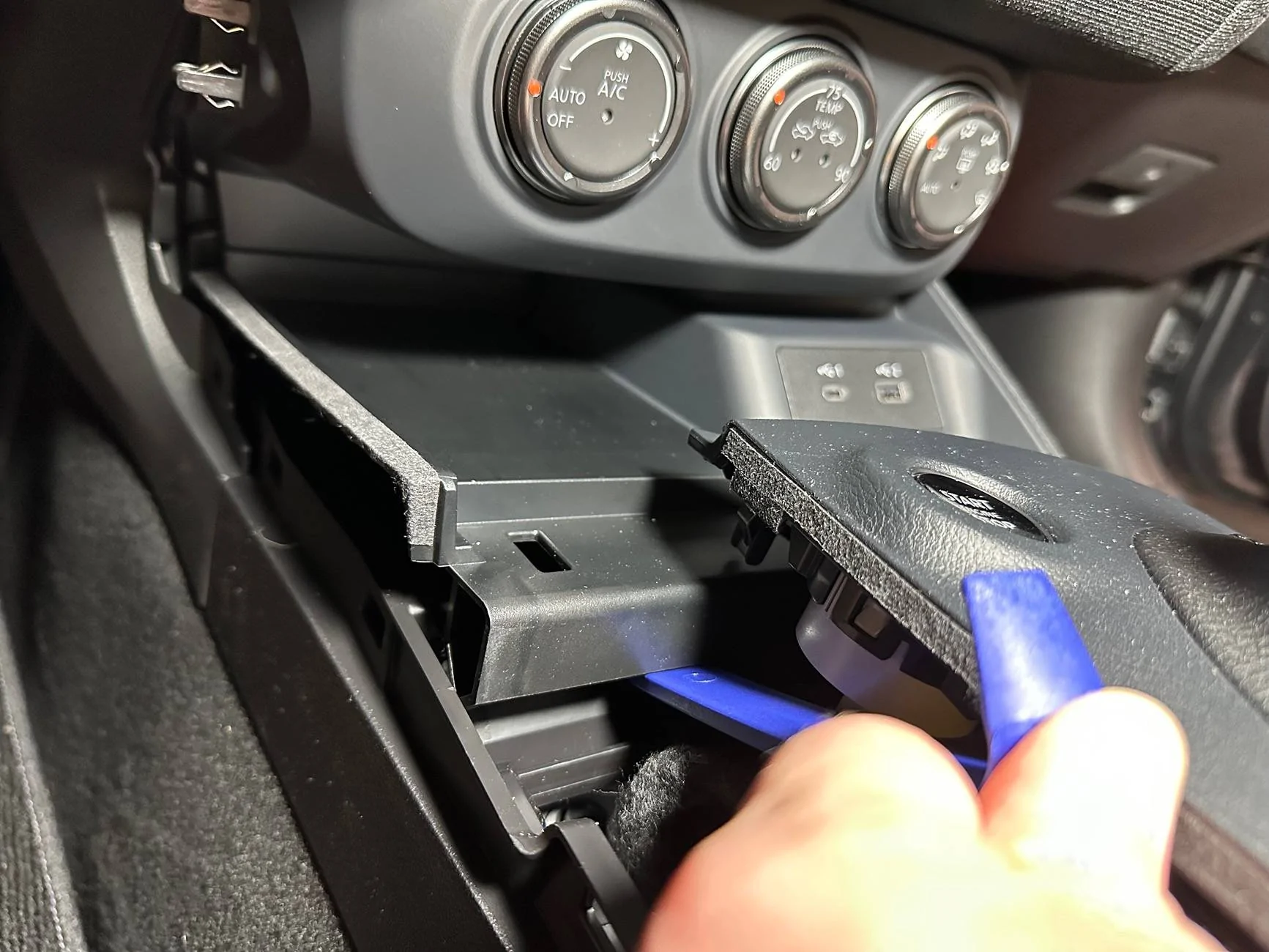

8. Pull the USB finisher straight out from the console to disengage the clips. This is a little bit of a pain because there’s not a good pry point or a way to get a good grip on it.

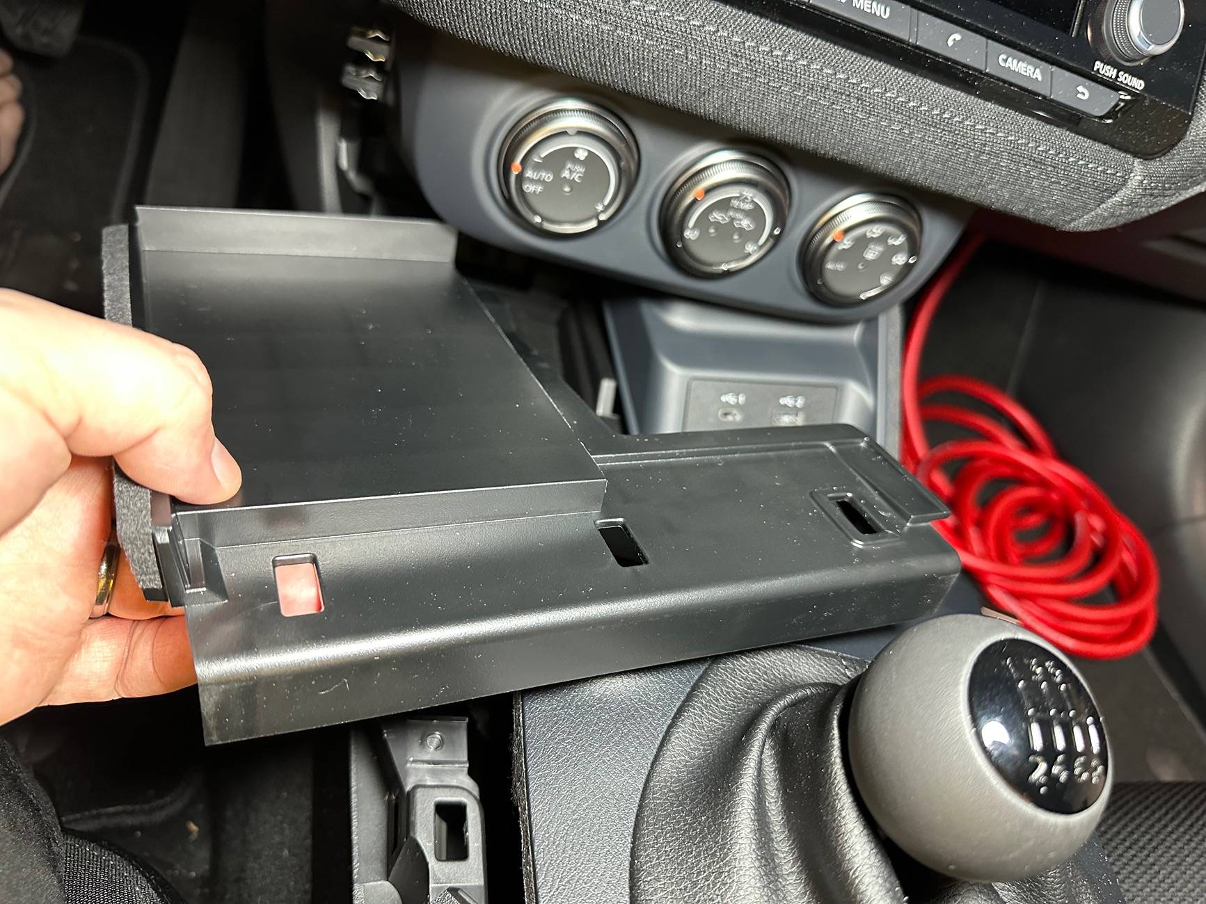

9. Set the rubber tray finisher aside and then remove the phone tray by lifting up on the front and then working towards the rear to disengage the clips. You can use a pry tool more aggressively on this piece on the front side because this is not an exposed surface once the console is reassembled. Lift the tray up and out and then set it aside.

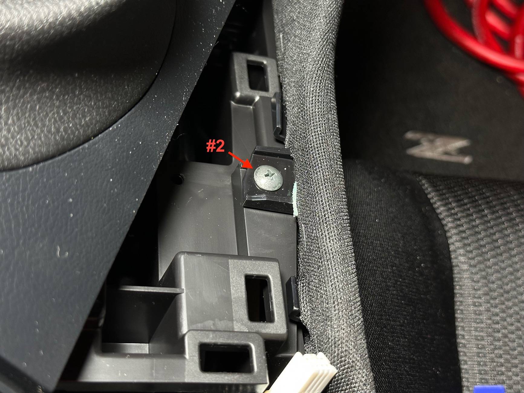

11. Remove the two screws (#1 & #2) from the front of the console. This is not necessary to remove the head unit, but it will give you more wiggle room if you are running wiring.

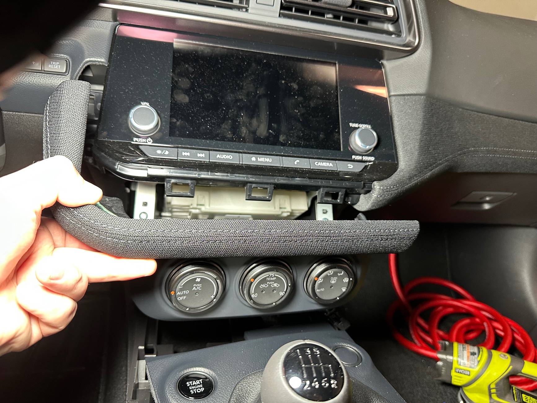

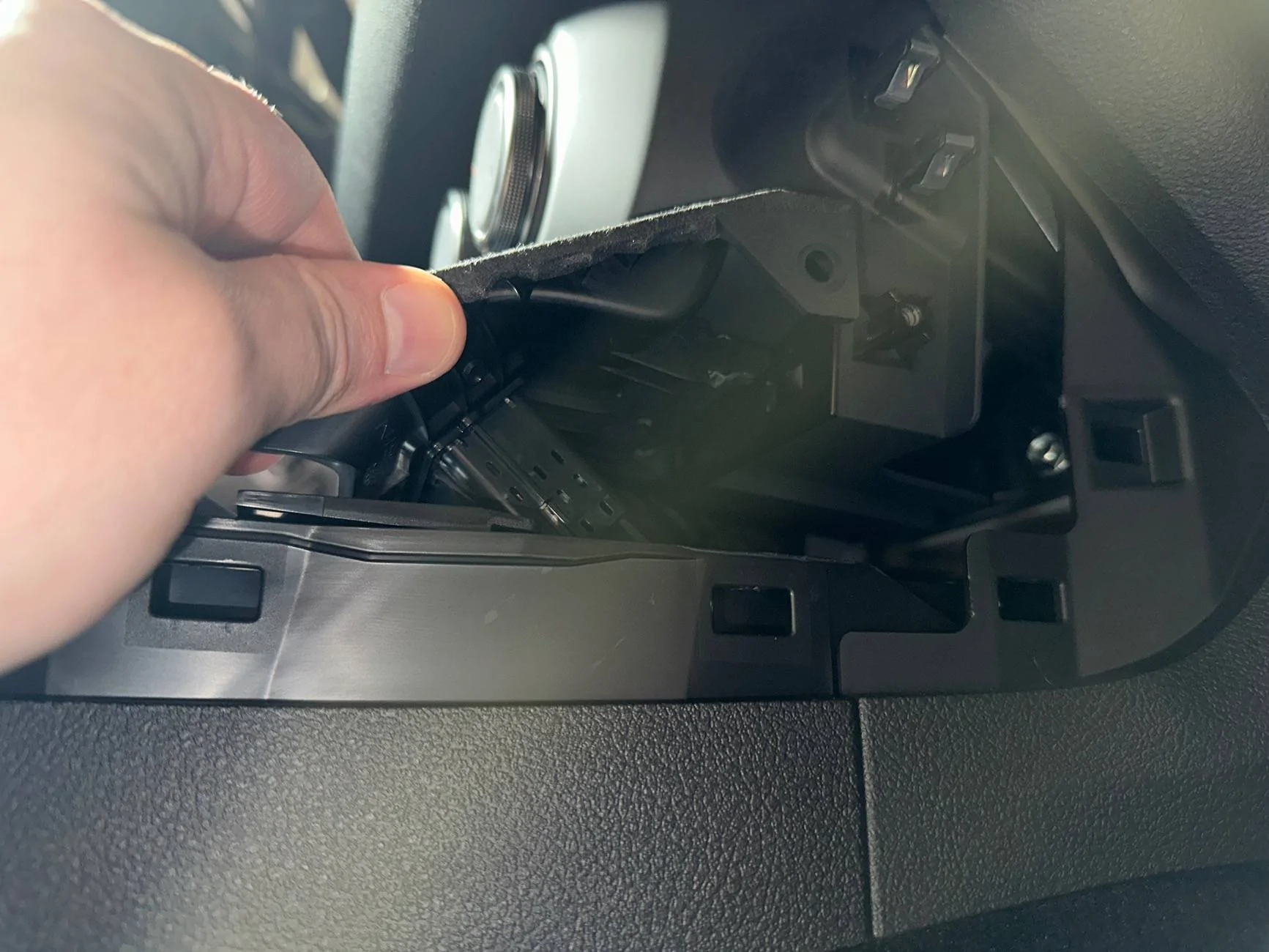

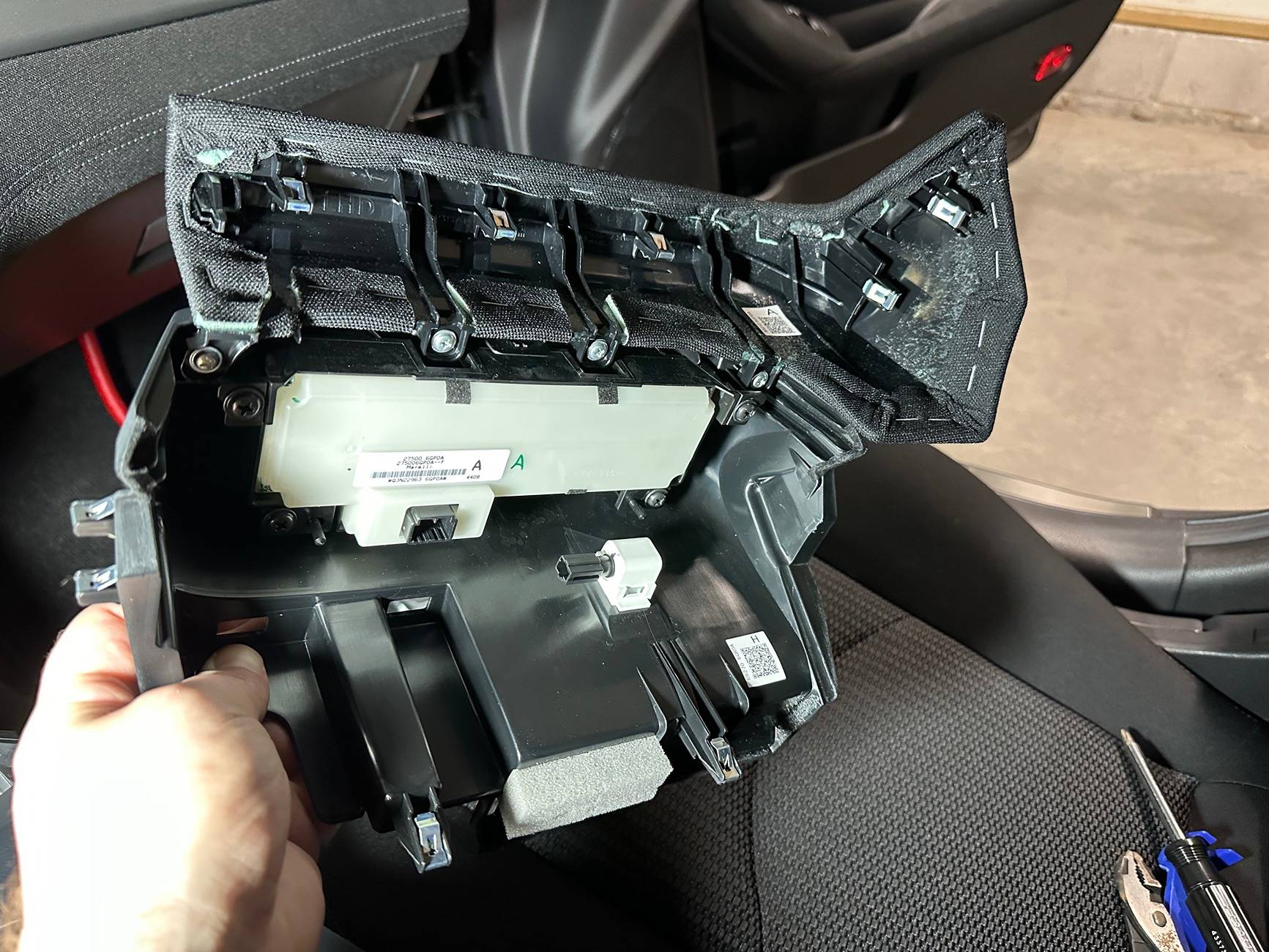

12. The lower radio finisher and A/C controls are a single piece. Remove the piece by pulling straight out from the dash to disengage the clips.

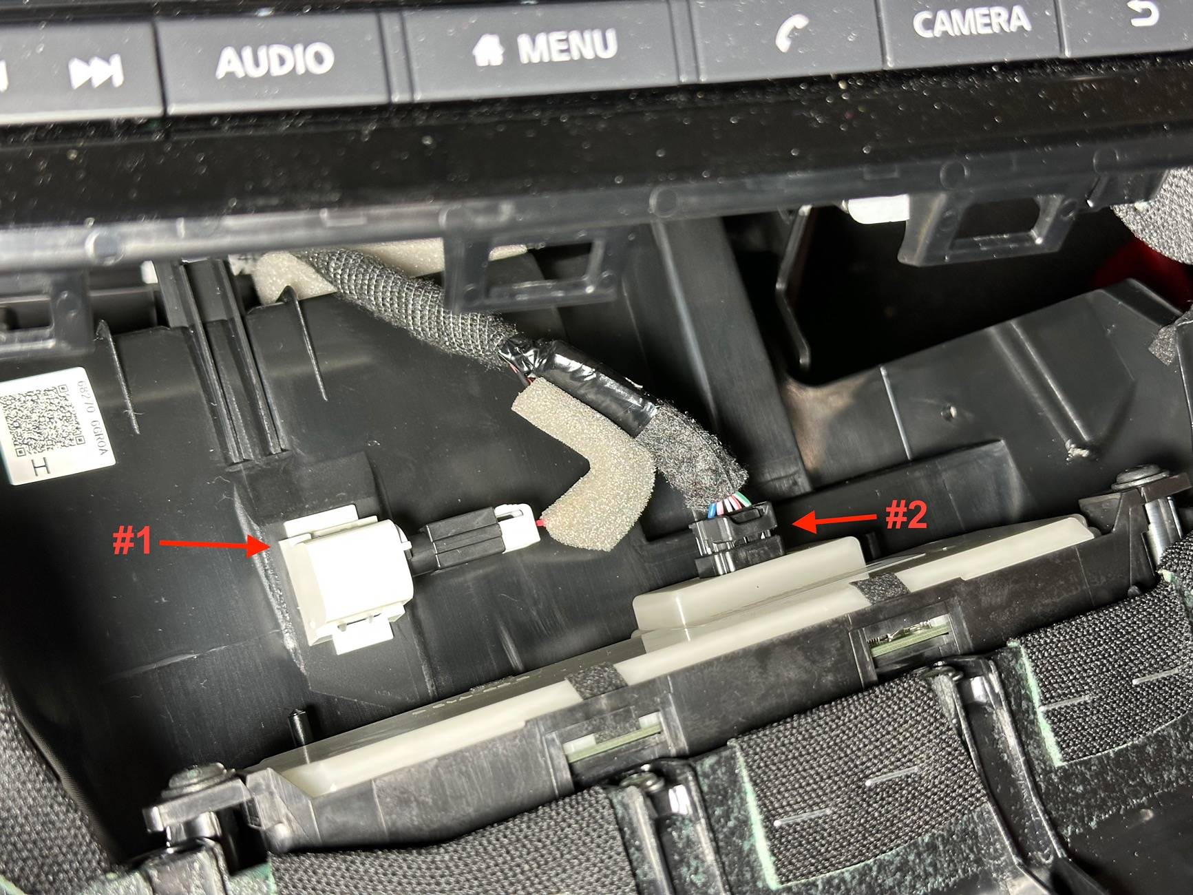

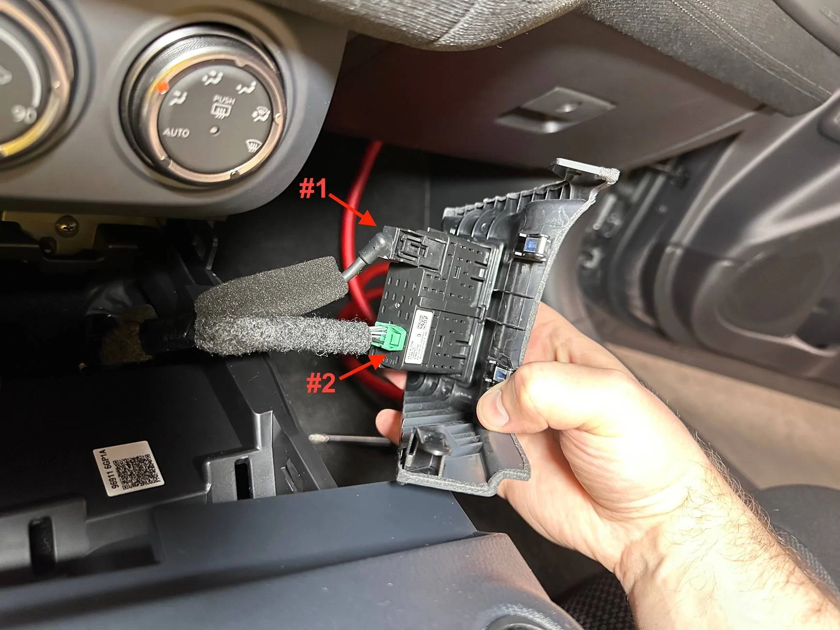

13. Remove the plugs for the lamp (#1) and A/C controls (#2).
14. Here is a picture of the lower radio finisher and A/C control assembly clip locations for reference.

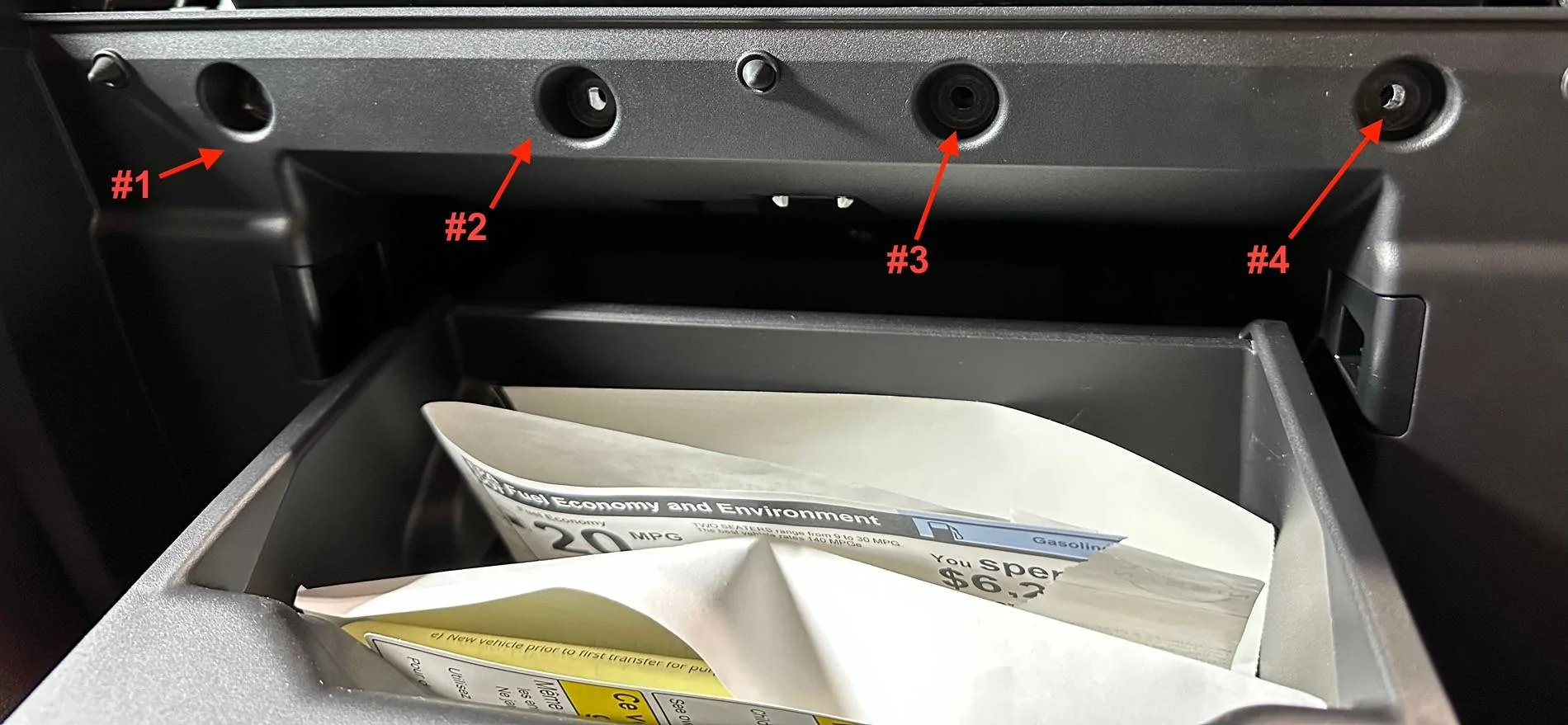

15. Remove the four screws (#1 - #4) from the upper glove box assembly.

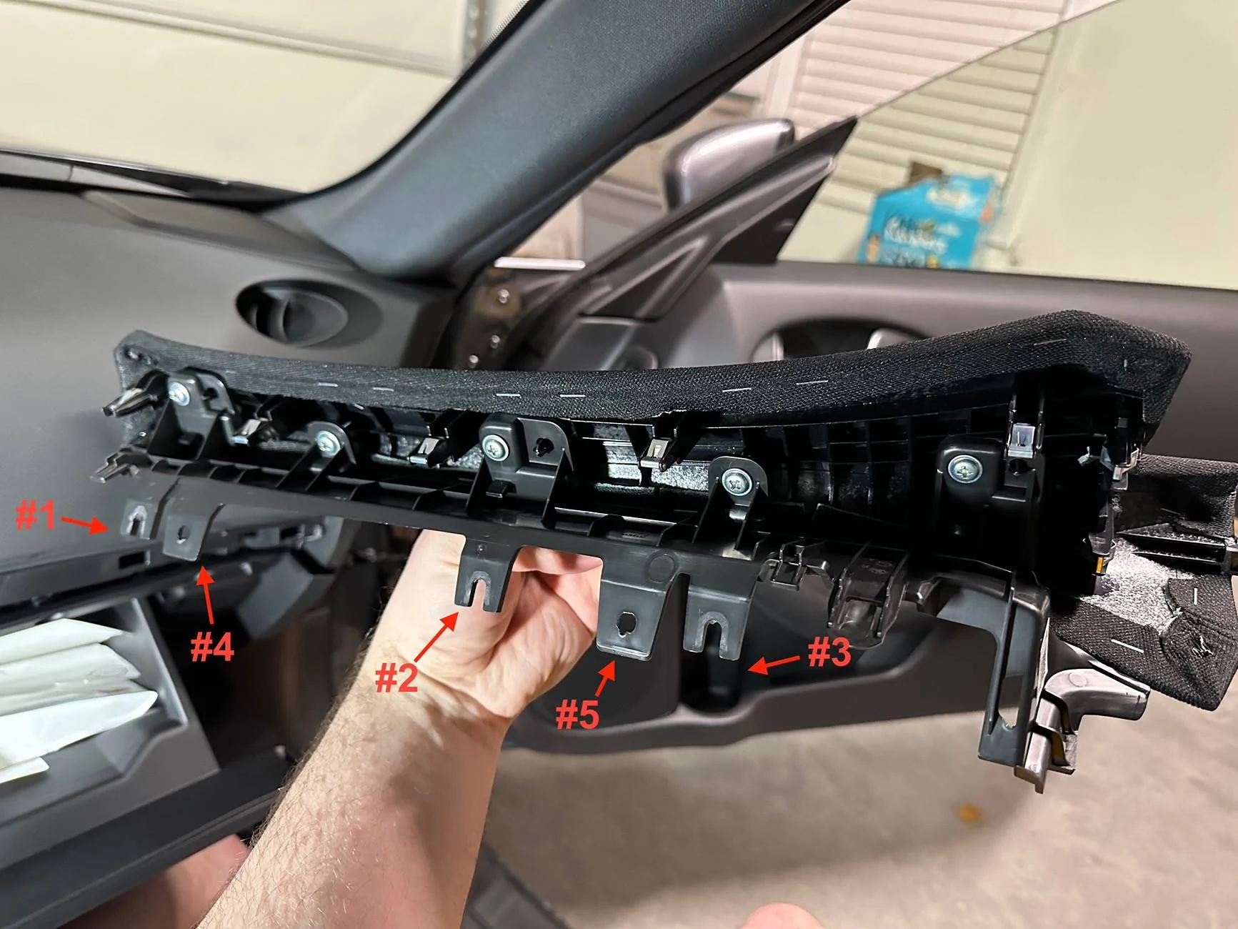

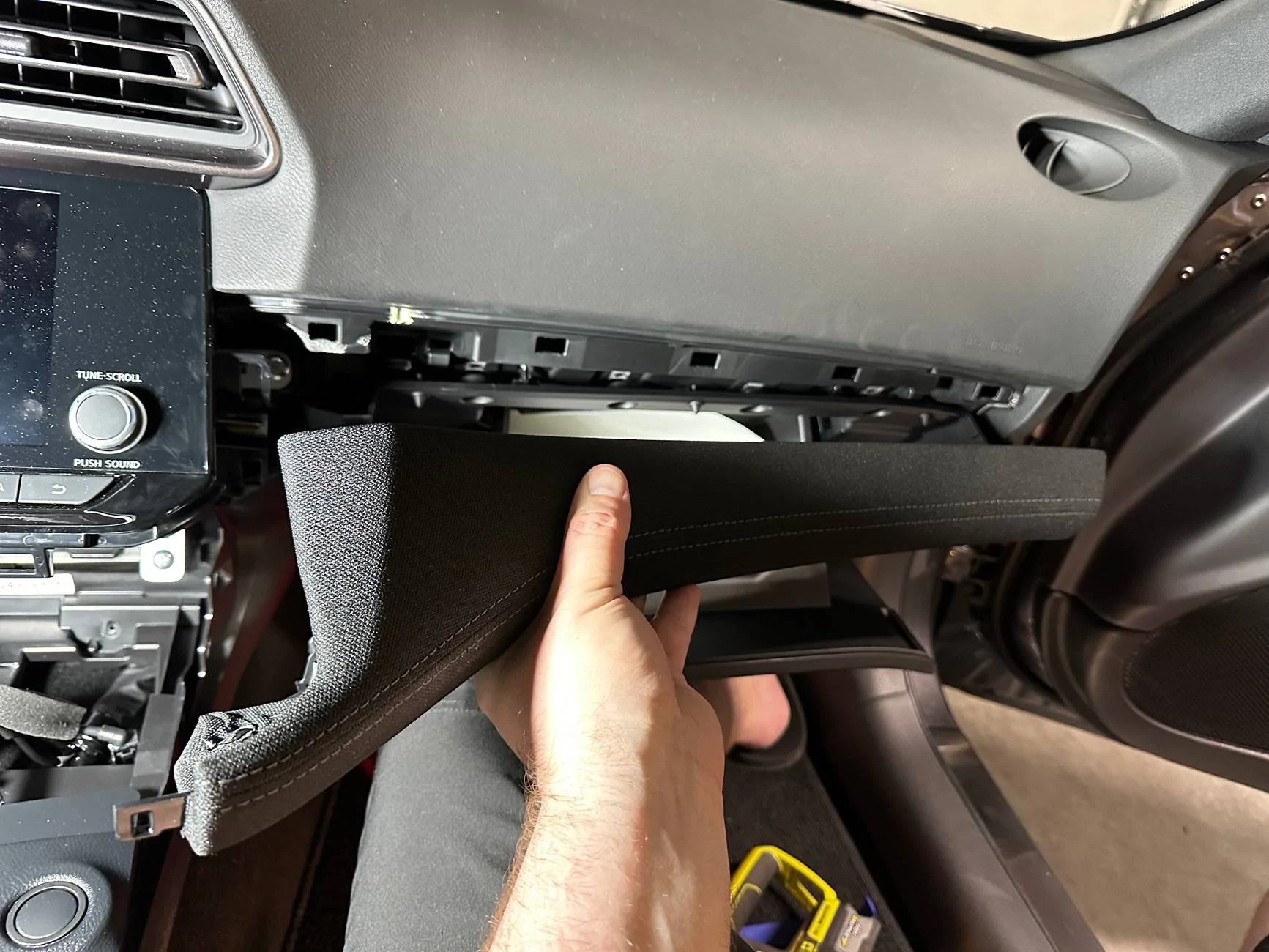

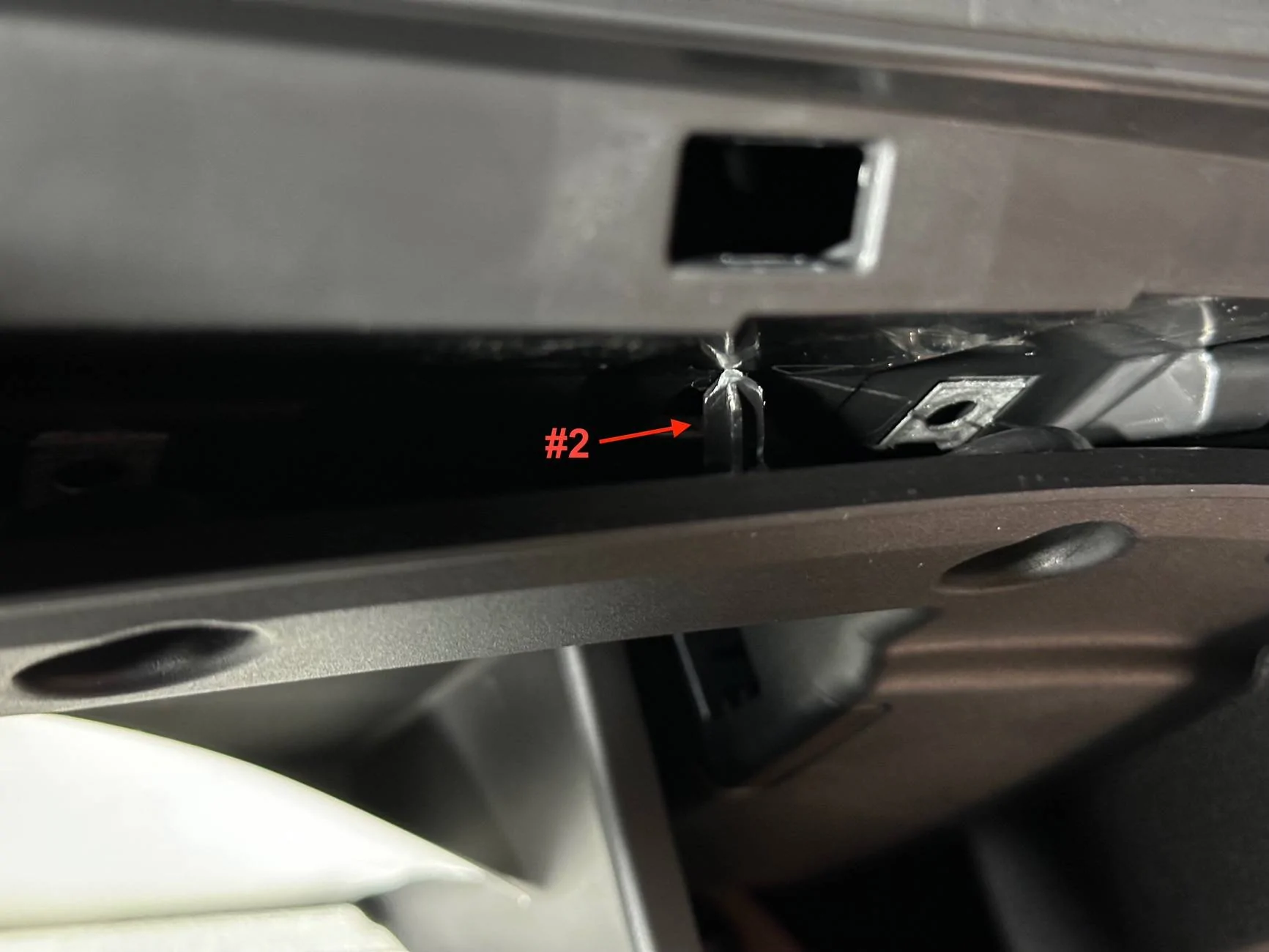

16. This is where I made my first mistake. To remove the right-side dash finisher the correct way, you would need to first remove the glove box completely. This is because there are two pins on the back of the glovebox that go through the dash finisher and then into the dash (#1 & #2). I forced the dash finisher out while pulling down on the glovebox. I thought all I needed was some wiggle room because the finisher was sandwiched between the glovebox and dash, but it’s not possible to get the finisher out without bending the pins if the glovebox is in place. Unfortunately, I couldn’t figure out how to get the glovebox out for proper re-install of the finisher. I took out additional screws on either side of the glovebox but couldn’t get it to come out. So I re-installed the dash finisher with the pins bent to shit.
17. Assuming you have removed the glove box, remove the right-side dash finisher by pulling straight out from the dash to disengage the clips. If the glovebox is still in place, you will need to simultaneously pull the finisher out while pulling down on the glovebox so it flexes enough to remove the finisher from the glovebox/dash “sandwich”. But if you do it this way, you WILL bend the pins! Set the right-side dash finisher aside.
18. Here is a picture of the right-side dash finisher clip locations for reference. Note the passthrough points of the glovebox/finisher/dash sandwich; the screws pass through holes #1 - #3, and the pins pass through holes #4 & #5.

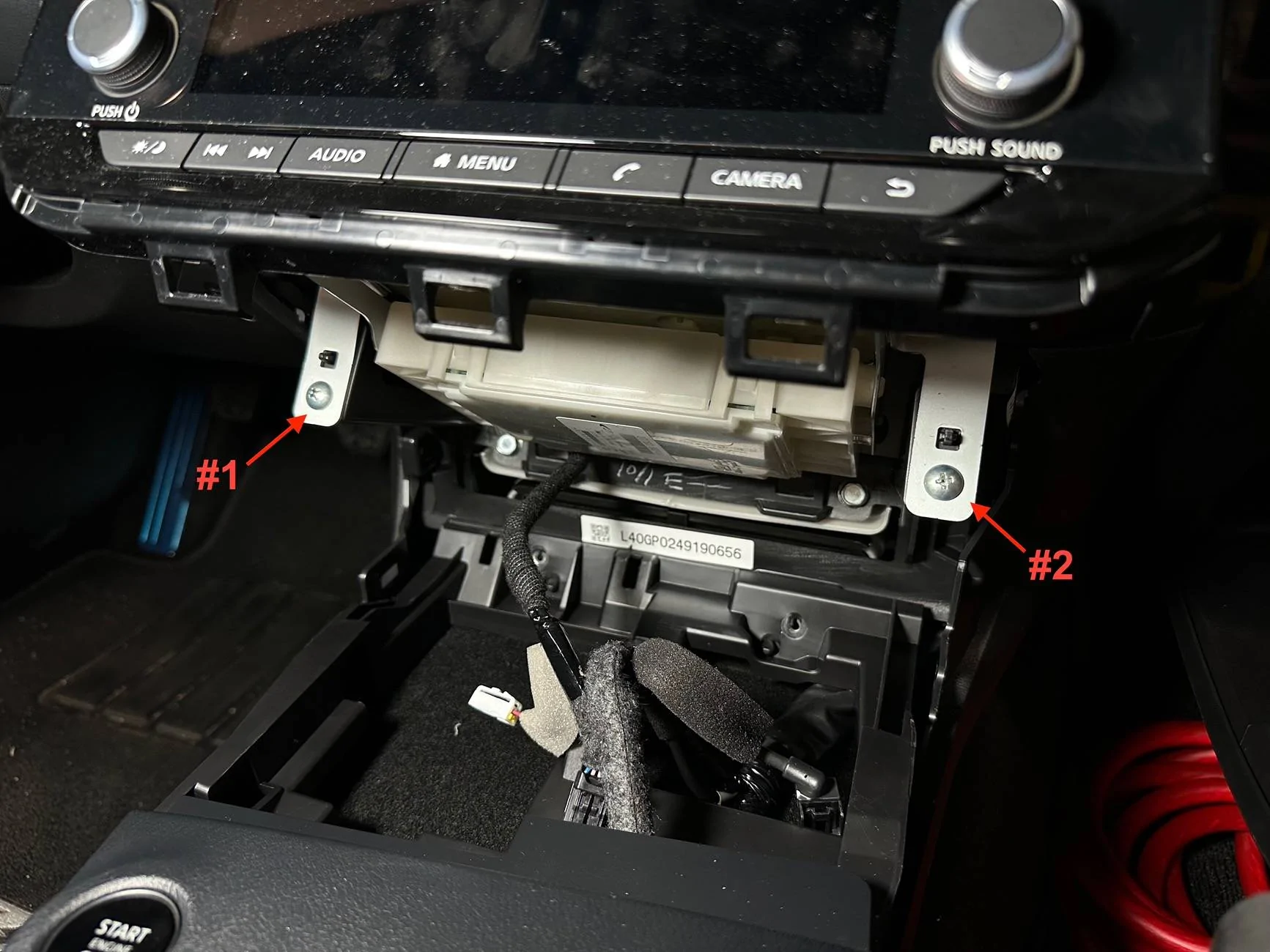

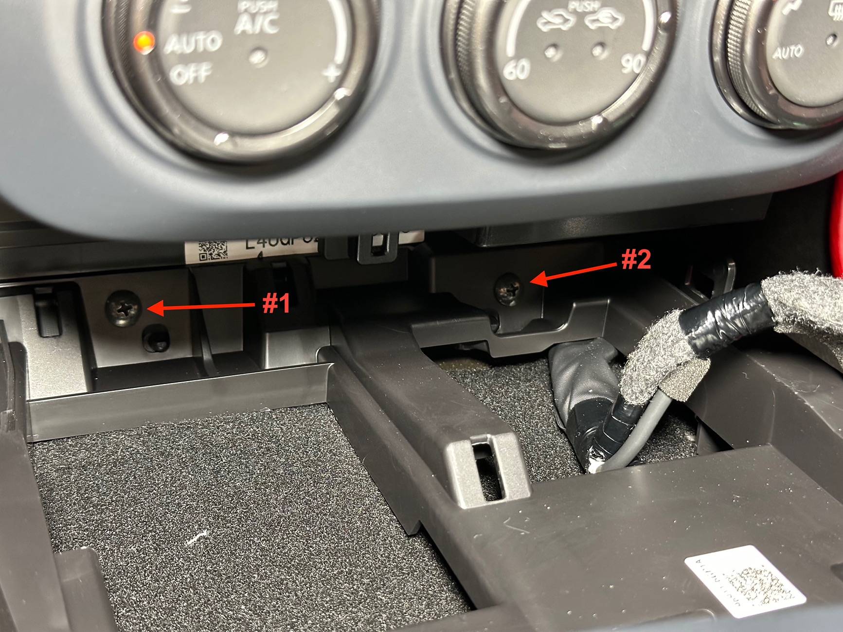

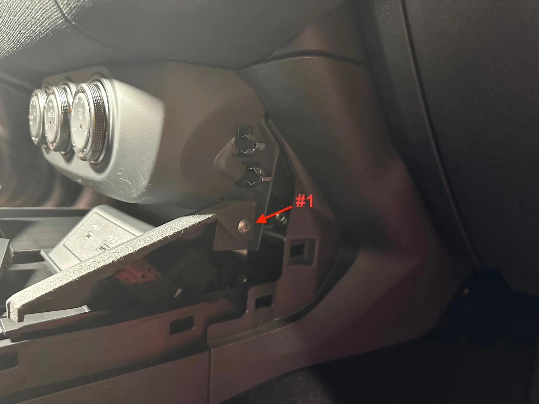

19. Remove the screws (#1 & #2) from the lower head unit bracket.

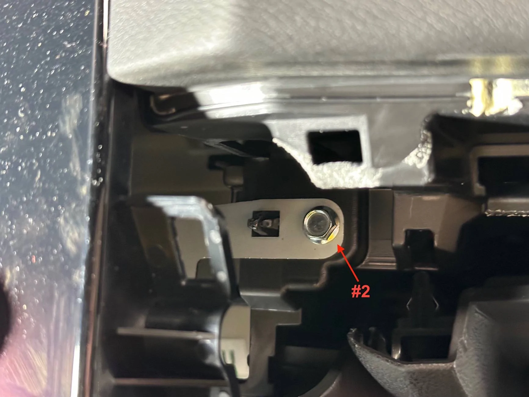

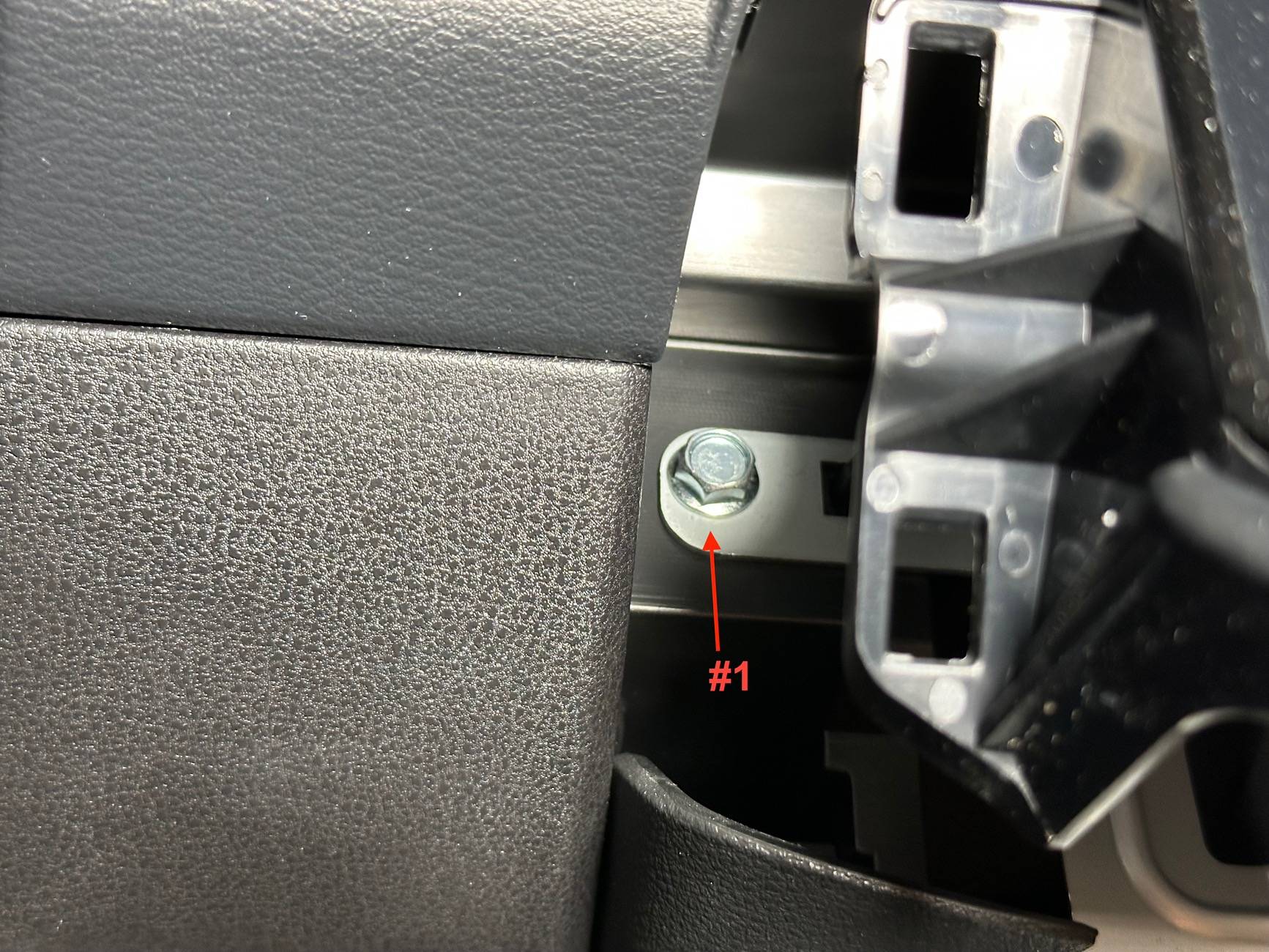

20. Remove the LH bolt (#1) and RH bolt (#2) from the upper head unit bracket.

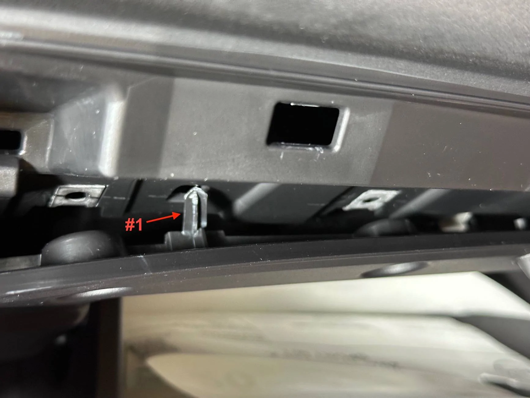

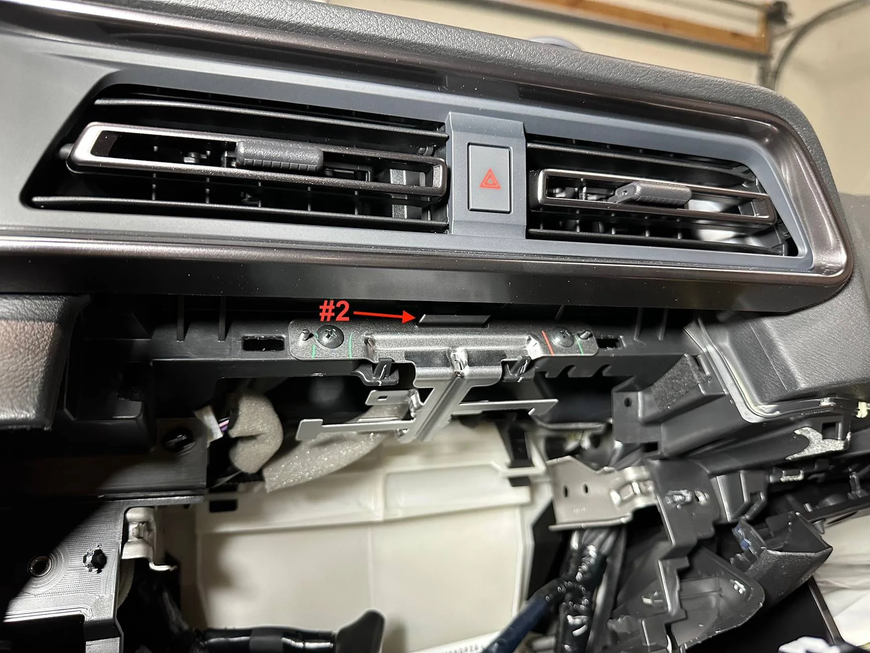

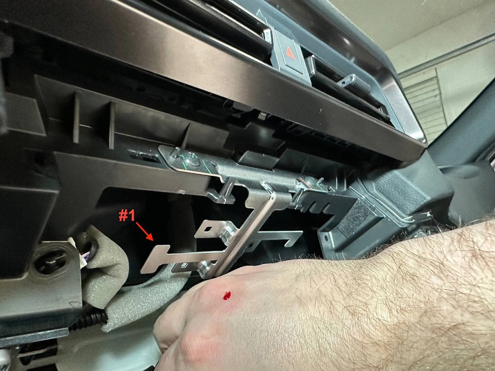

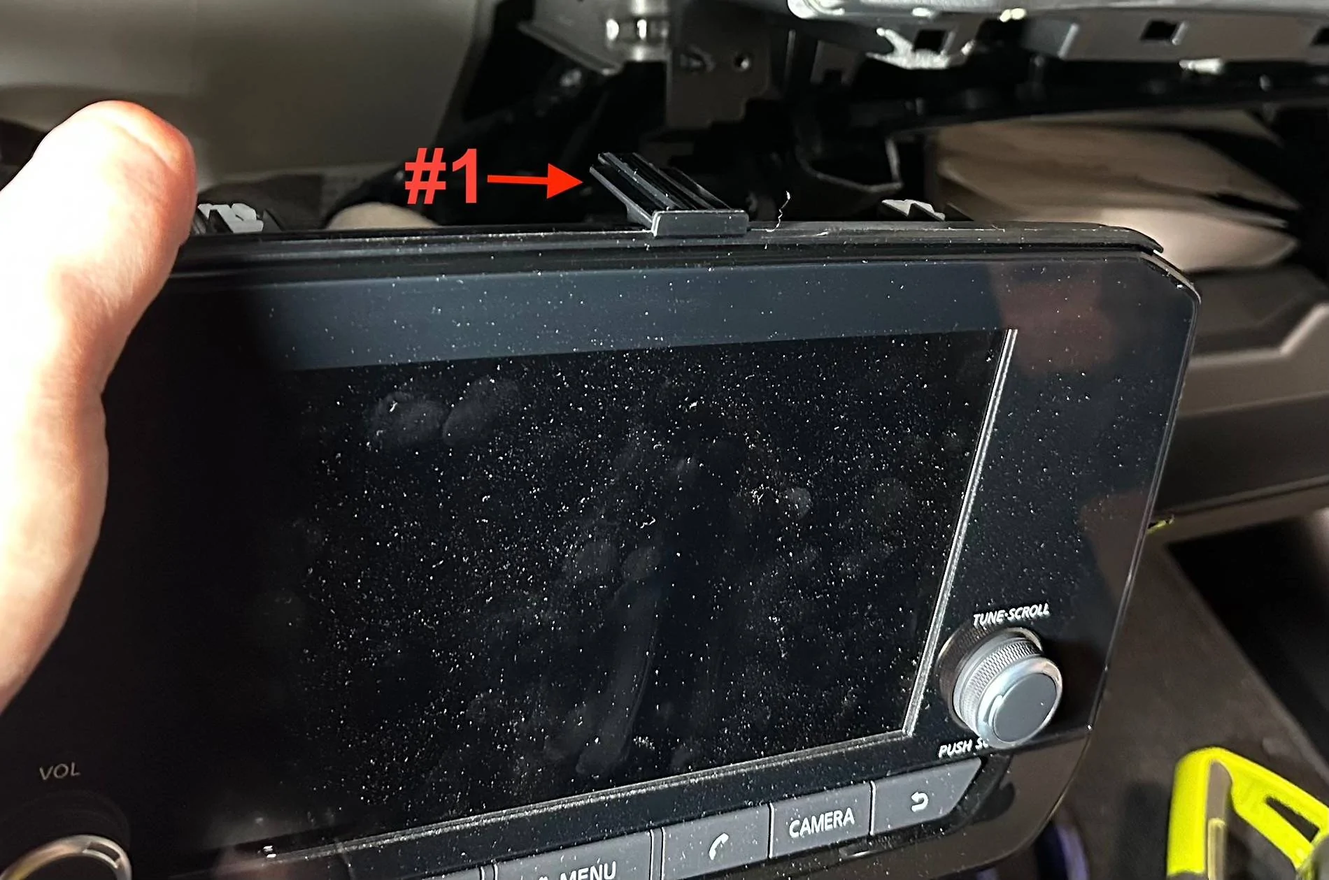

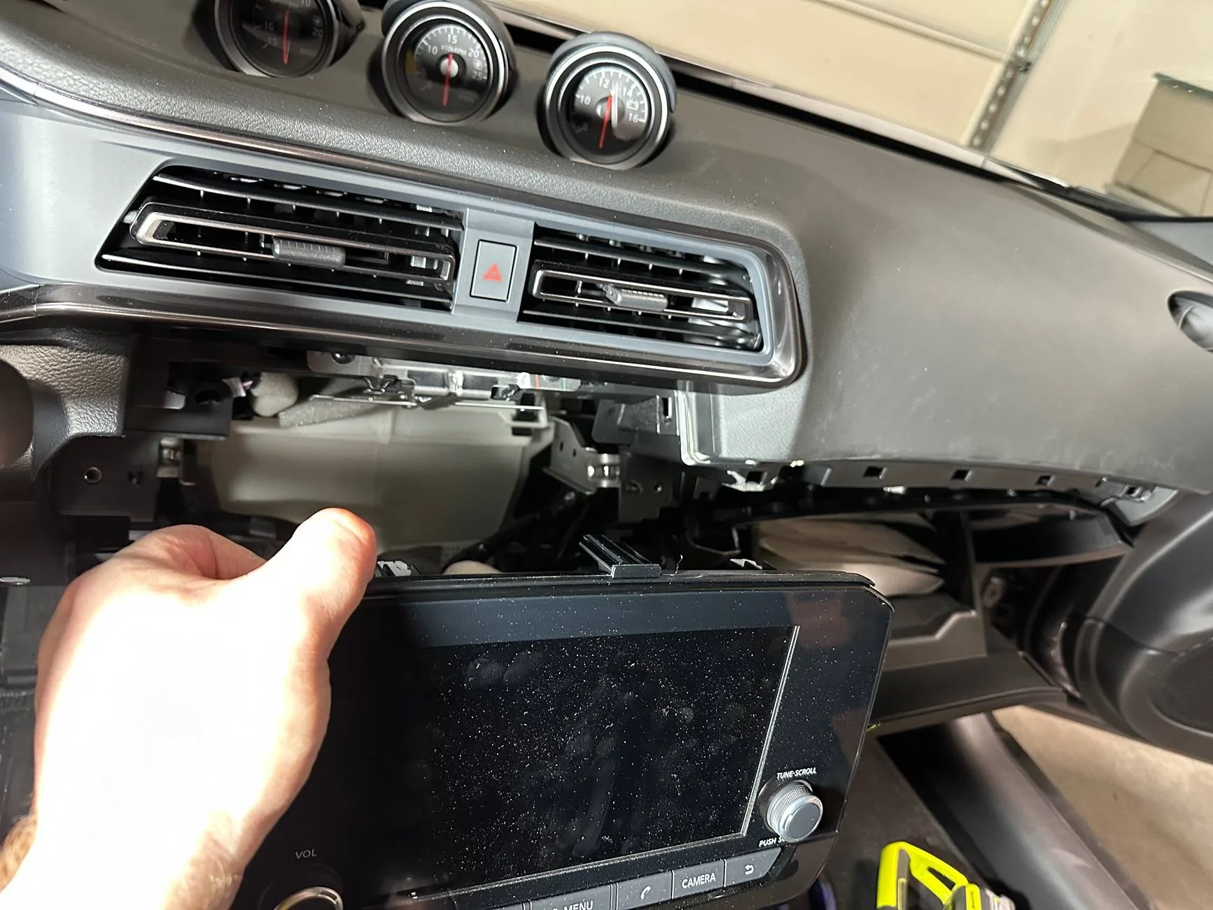

21. This is my second big screw up. At this point, you CAN pull the radio out from the dash. However, the correct order of operations would be to first remove the A/C vent housing directly above the radio. This is because there is a center flat “pin” on top of the radio (#1) that goes into a slot behind the A/C vent housing (#2). You can pull the A/C vent housing out and twist the radio down just enough to get the radio to pop out from behind the A/C vent housing. But you will NEVER get that pin back into the slot with the A/C vent housing still in place. Unfortunately, I was not able to figure out how to remove the A/C vent housing. I pried to the point I felt like it was going to break, and I didn’t see any screws, so I gave up. I was terrified I was going to crack this piece that is front and center on the dash. So I ended up hacking the flat pin off of the top of the radio to get it back in. There are multiple other clips, screws, and bolts to keep it in place, so I don’t think it’s a problem. It must be there for alignment purposes at the factory. But be warned, if you want to maintain this flat pin on the radio, you’ll need to figure out how to remove the A/C vent housing.
22. Assuming the A/C vent housing has been removed, pull straight out on the radio away from the dash to disengage the clips.
23. Be careful around this silver bracket (#1), it is razor sharp.

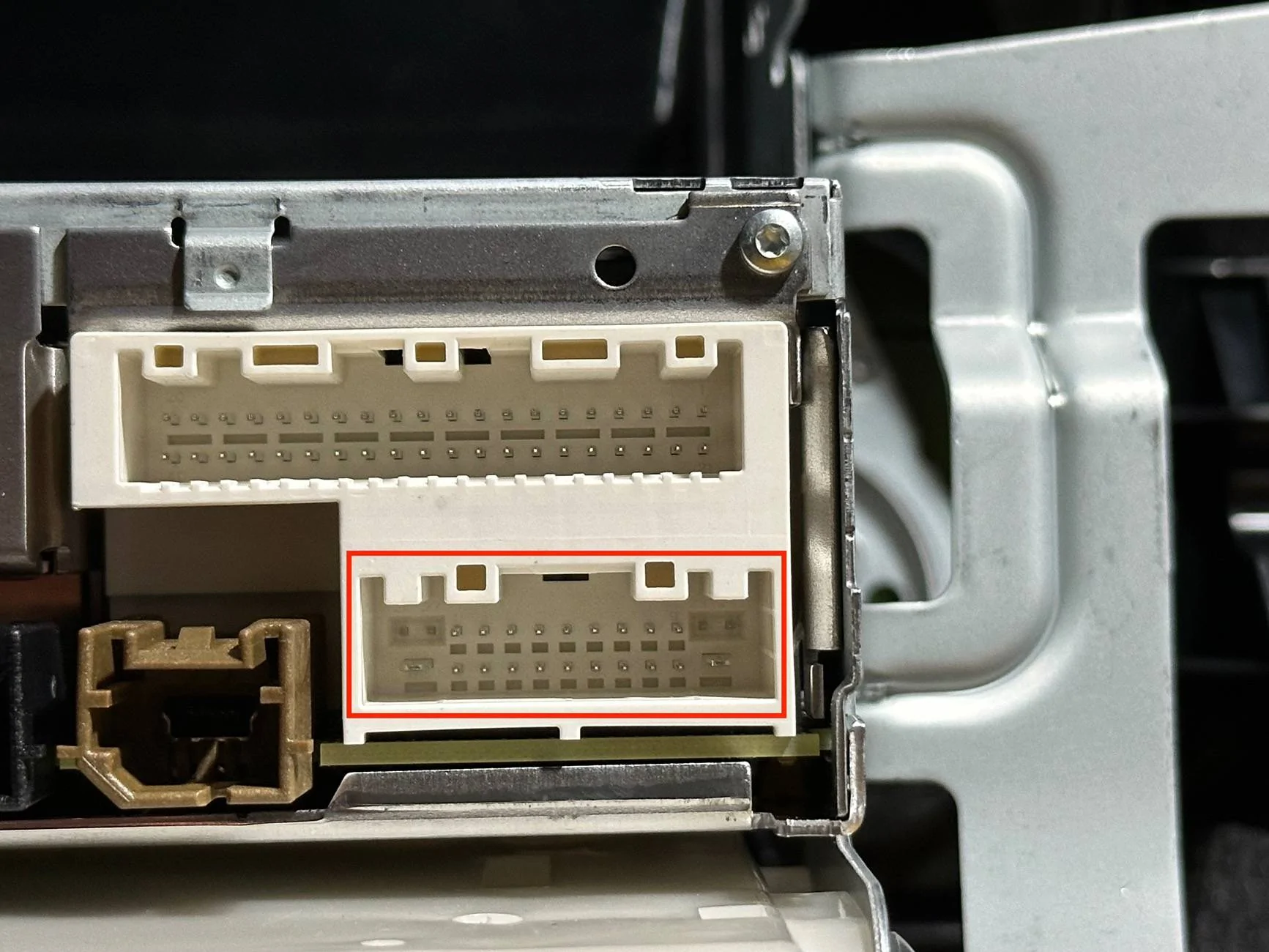

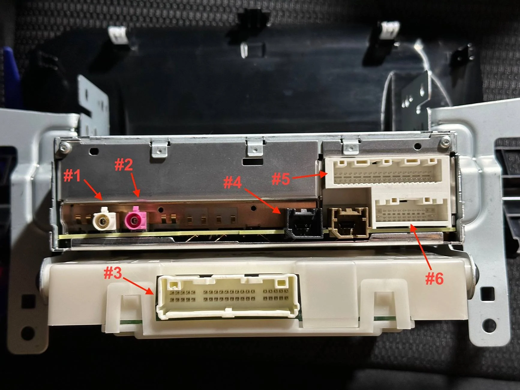

24. Remove the plugs from the rear of the radio. There are 6 plugs total (#1 - #6). Note that only one of the USB plugs are utilized; one seems to be a throwaway plug, possibly used in different assembly?
25. This is the important plug if you plan to tap into the factory signal. See the pinout from the service manual below.

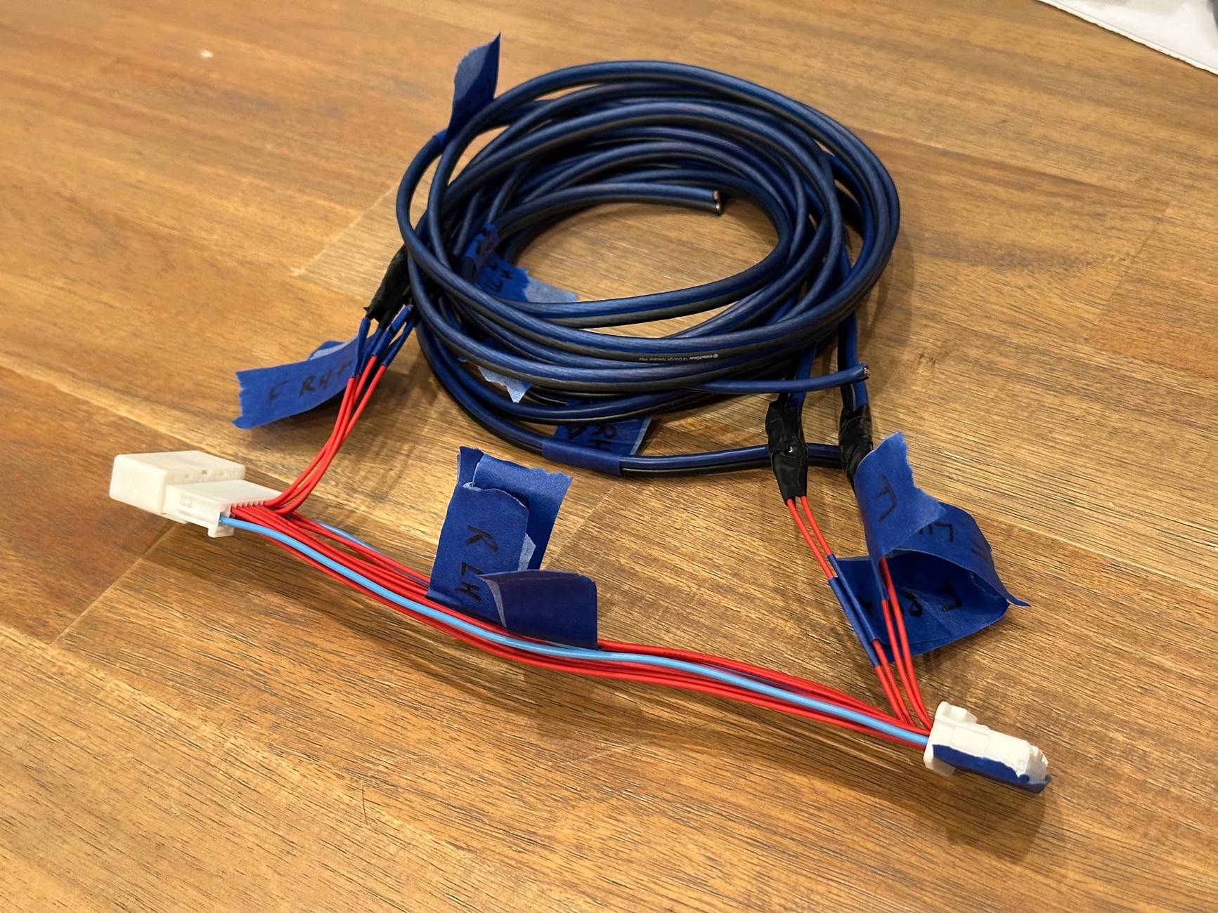

26. I used a sub-harness that goes between the radio and the factory harness plug. I would highly recommend doing this rather than tapping into your factory wiring. There is not a lot of slack in the factory harness and it would be a nightmare trying to cut and splice it.
27. This picture shows how I modified the sub-harness for my install. I intercepted the front speaker signal on the radio side of the harness to send to my DSP unit, and then tapped into the front speaker wires on the harness side to send the signal from my amp.

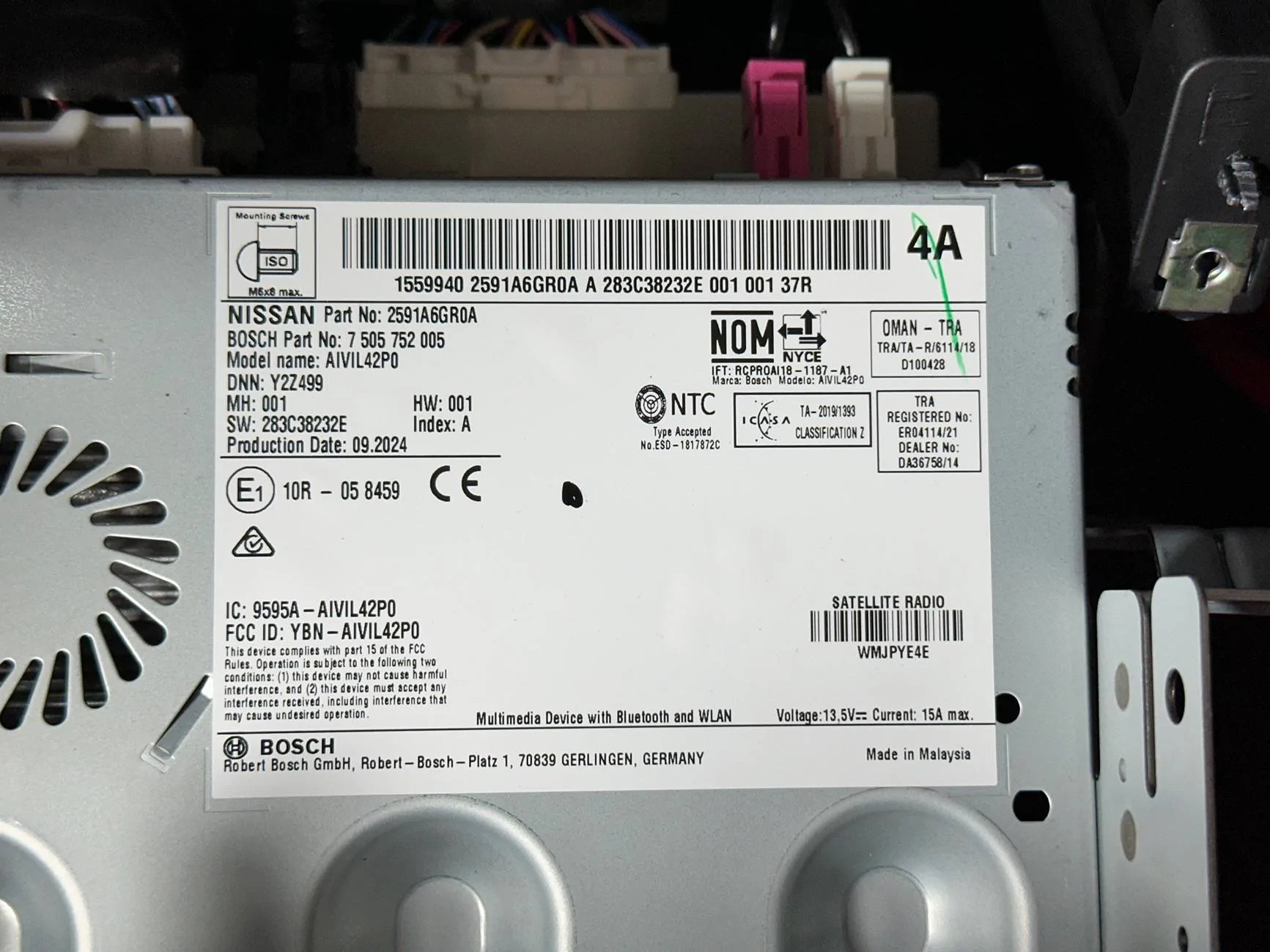

28. Here is the radio info sticker for reference.

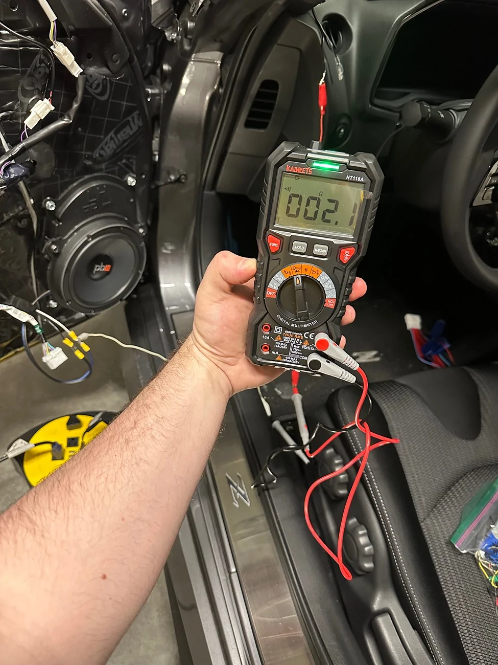

E_R, you said the following:
  • The Sport head unit does NOT have individual outputs for the front dash and door speakers; the L/H door and dash speakers are bridged together from a single amp output (same for R/H).
So what you are saying is, there are speakers with different resistance values in the front left and front right leg?!
(Door speakers are 2 ohm. Dash speakers are 4 ohm). If so, this is some of the most shadetree mechanic / Kentucky windage BS ever.
That’s right, see the pic below of me ohming out the contacts of the dash and door speaker plugs to show continuity. Kind of hard to see, but the red lead is alligator clipped to the dash speaker wire and the black lead is alligator clipped to the door wire. I checked and re-checked this like three times to be sure because I couldn’t believe it, lol.
