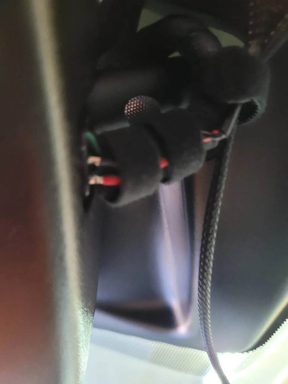

I only have 3 wires and even the cell phone cam can't see a difference between the two greens.
Small paper clips will work, took a lazy day since this is the 4th.

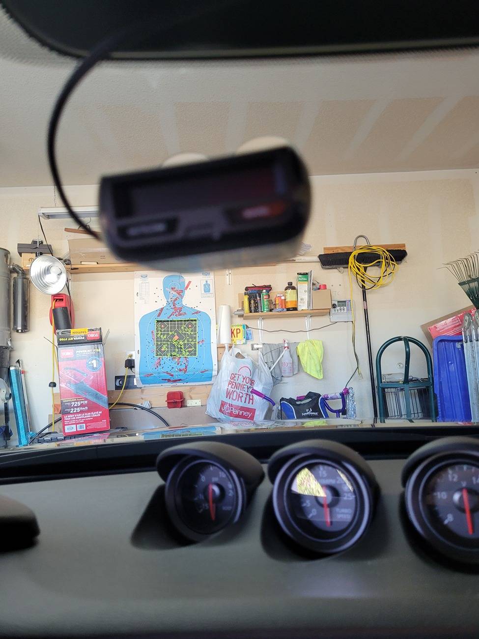

Picture is a little fuzzy - looks like u your running a R3?

R3 and I am blind as hell up close. But I am anal when I install anything. The details matter. I only used velcro, not the wire ties. I am happy with the install, but I want to put a bracket on too.

I’m using a blendmount mount - love it because i can cover the detector with the sun shade to keep the sun off it.
If you want to keep it like you have it, i would do the ”permanent“ mount bracket. These little babies work good. Some folks will just replace the suction cups with 3m tape. But for <$10 the “permanent” mounts are worth the money. I had to use one for my wife’s suv because there’s no space to mount a blendmount to the rv mirror.
