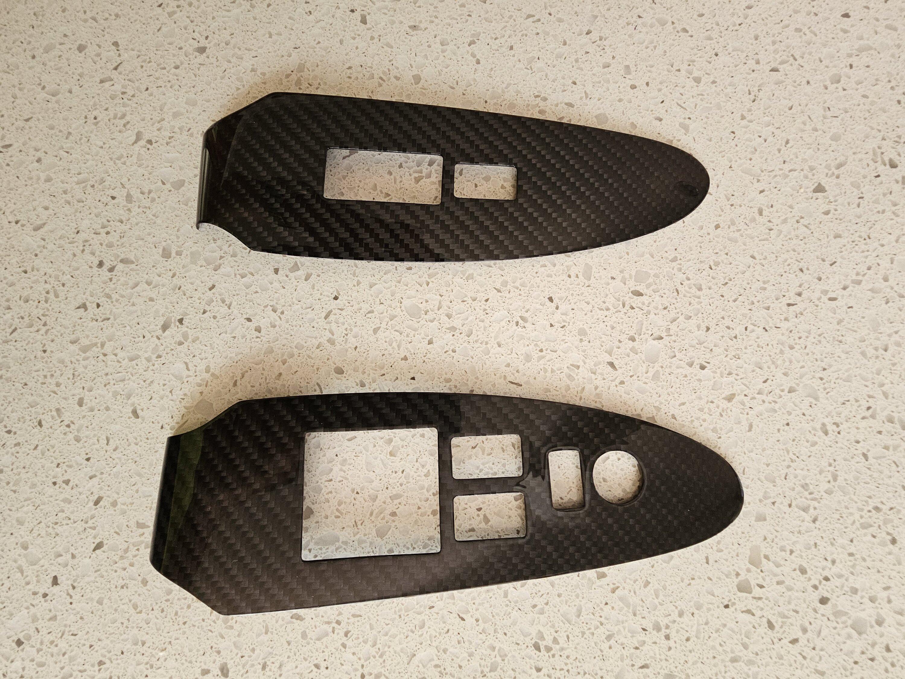

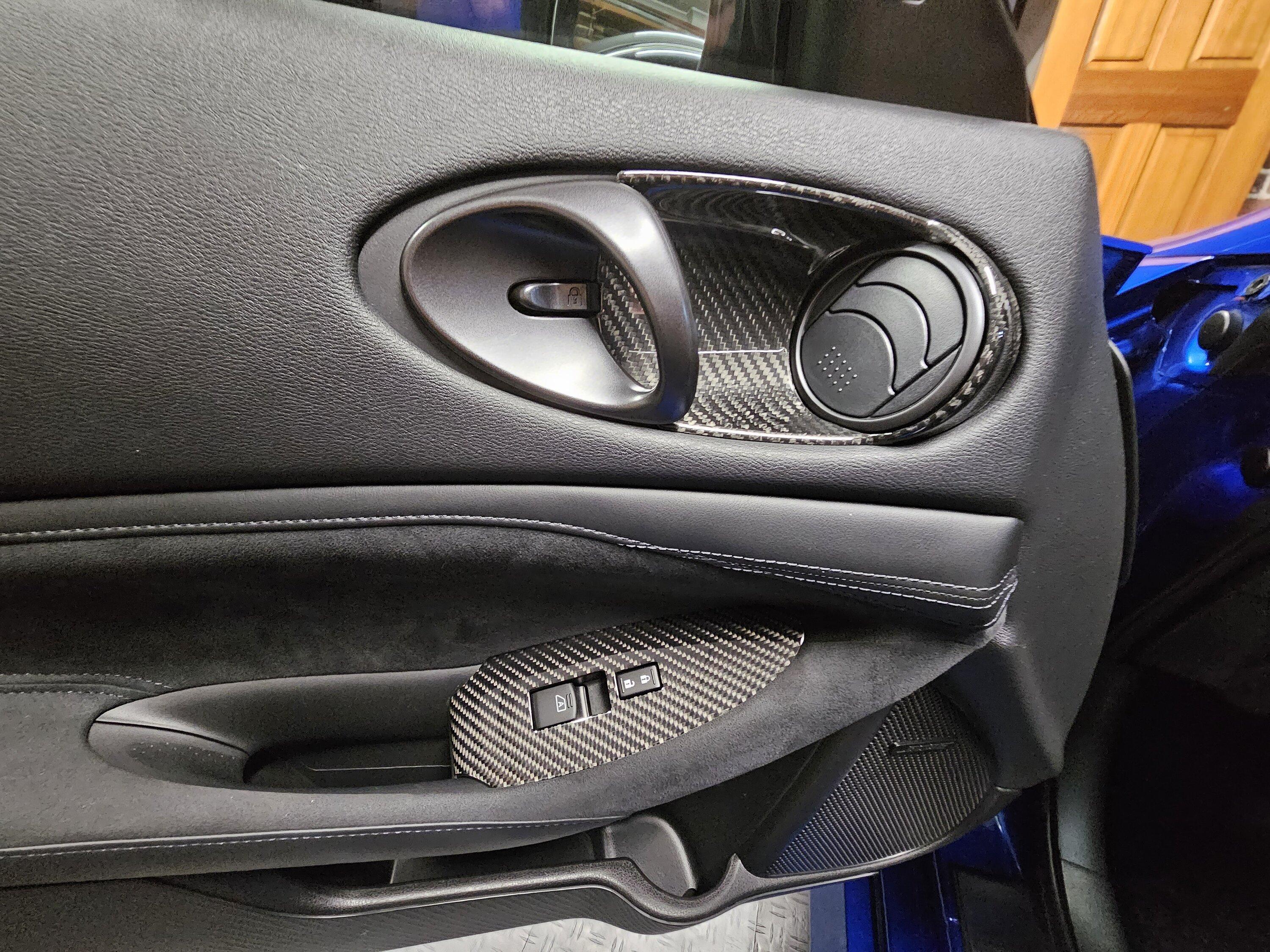

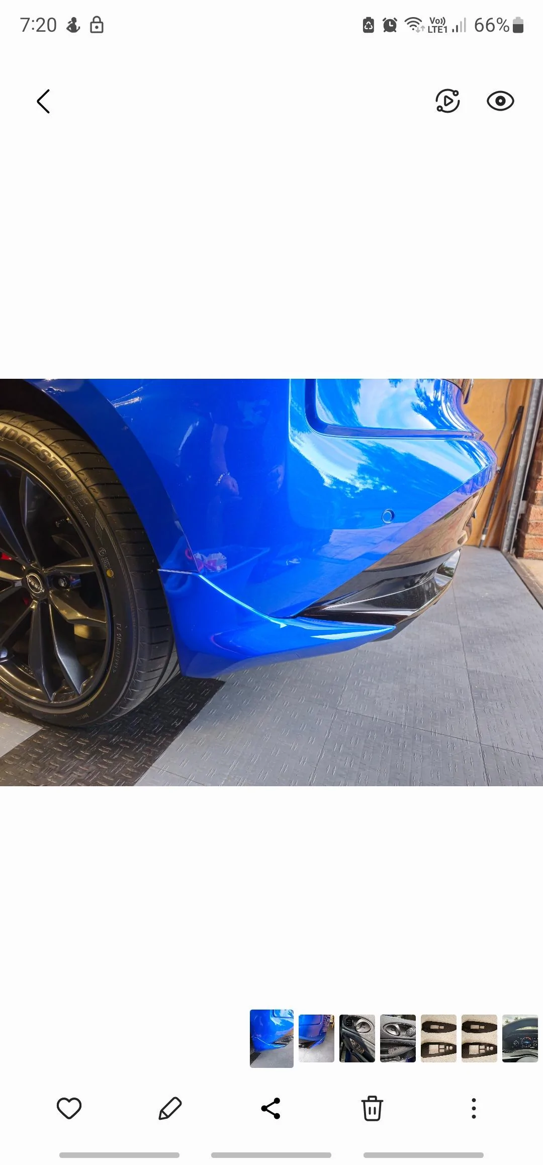

Just put on the rear splash guards, also got some carbon fiber trim to add to the carry over 370Z Door card, door barrel and switch gear covers

Where from the splash guards?

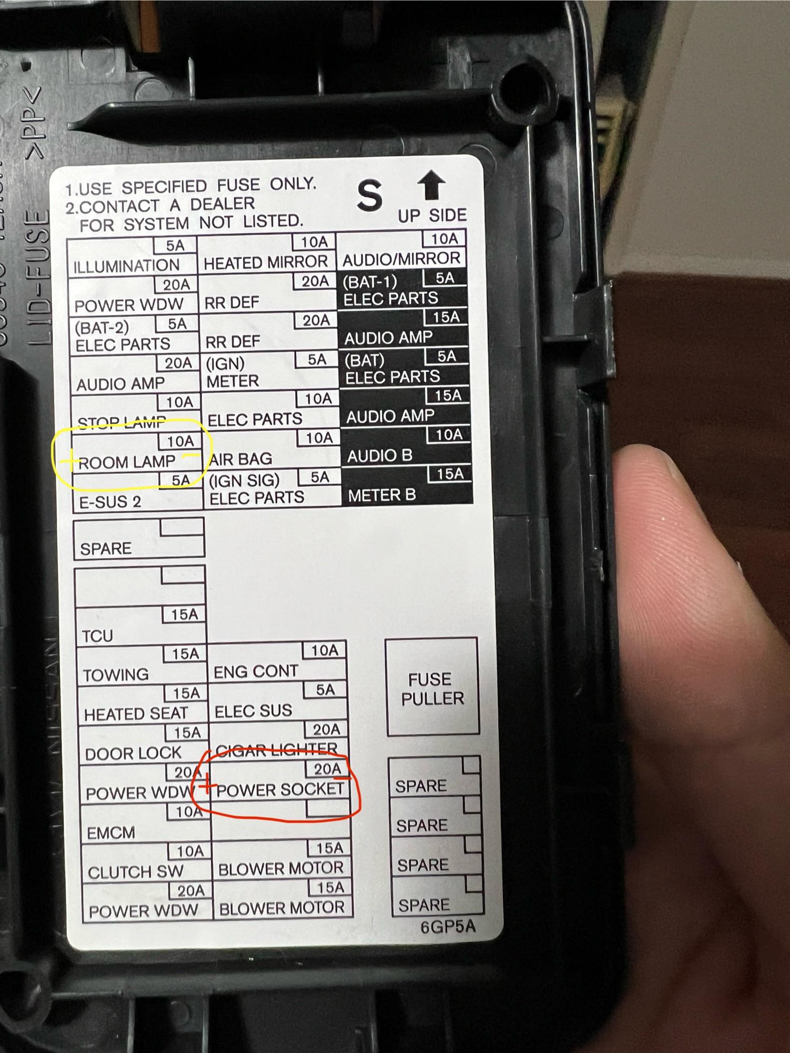

I am using the ROOM LAMP for constant power and POWER SOCKET for ACC power. The +/- sides are shown in the pictures.
There are 2 spare slots. The one above TCU is constant, but I can’t plug in a fuse tap as the Transport Mode switch gets in the way?. The one below POWER SOCKET has no power even the car is turned on.?

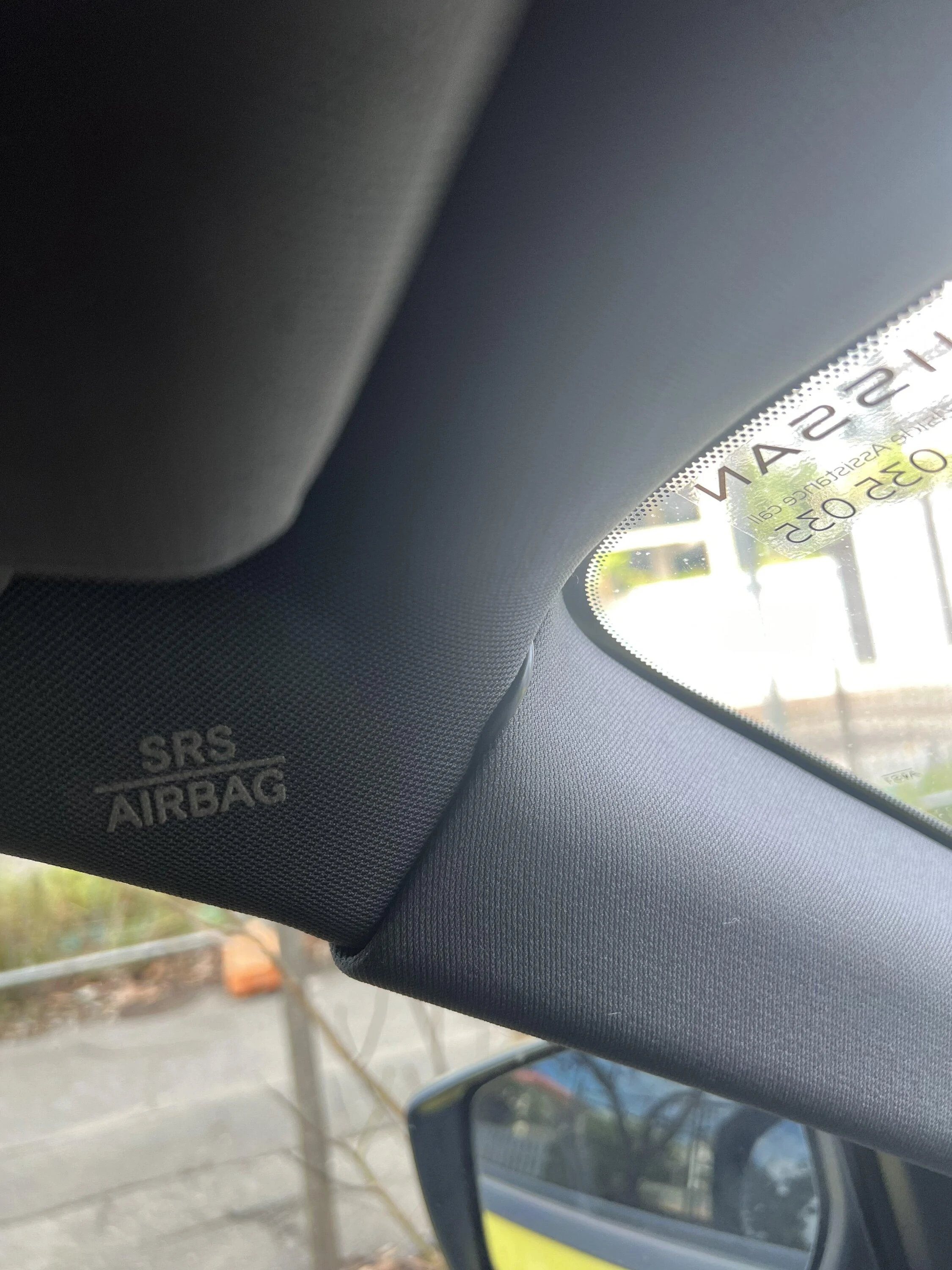

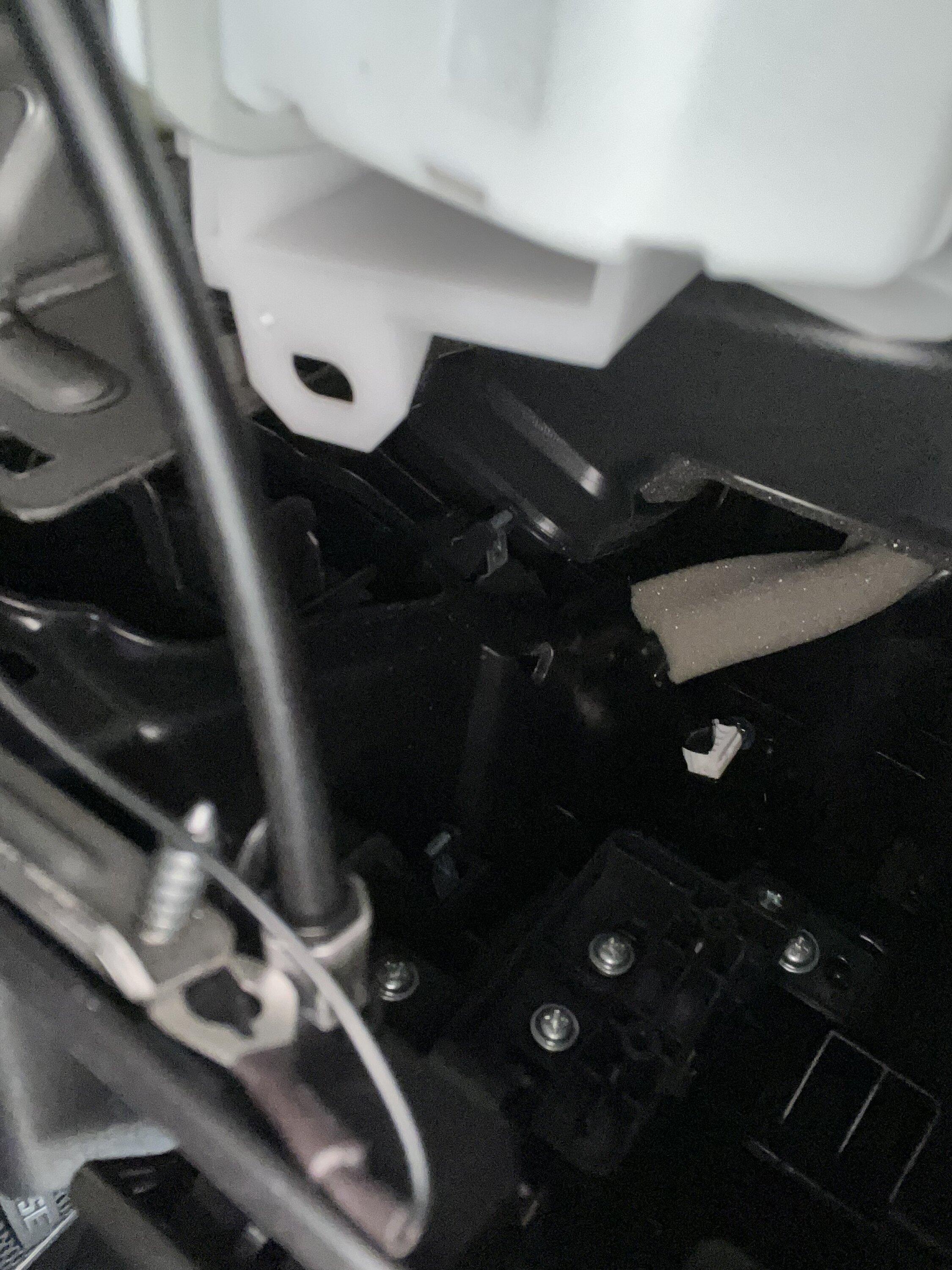

How did you hide the wires? I'm stuck at the A pillar ?
and where did you put the ground wire?

I'm guessing that was on sale, but would still love a link?
As black Friday is comming up in the US good time to buy, that's when I most of my stuff, most of the US nissan dealers will have an online parts dep, join their VIP programme for bigger discounts.
The biggest problem is shipping, I set up a US address a while ago and used this, all up was a lot cheaper than buying in OZ, but our dollar has since dived.
I hid the wires with the airbag. The ground wire is attached to somewhere near the hood handle.
