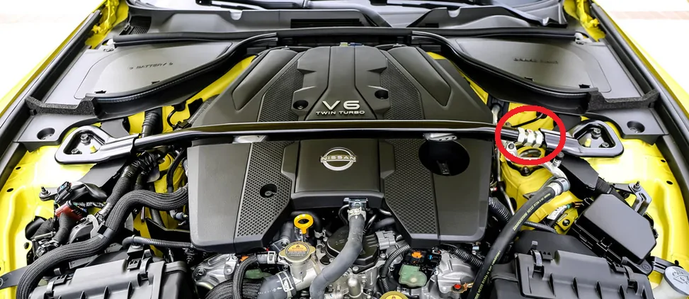

Mounting hardware is self-explanatory, two screws and one nut on each side.
The adjuster and hardware are circled below.
In the image you see three nuts, however the outer two are actually separate/loose nuts ("jam nuts") where the center one is part of the adjustment screw.

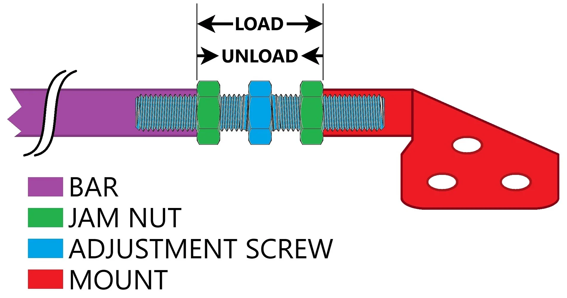

Illustration below shows the individual pieces (quick and dirty, but it gets the point across).
The blue adjustment screw is all one piece.
- When tightening or loosening the jam nuts always hold the center adjuster with another wrench to keep it from rotating.
- The adjustment screw is threaded left-hand on one side and right-hand on the other, so the lefty-loosey/righty-tighty rule only works on one side. Fortunately you can see the threads to determine which is which.
- Preload is adjusting the bar out (to be longer) not in (shorter).
To unload or remove the bar:
- Hold the center adjustment screw nut in place while loosening the jam nuts on either side. Spin them so there's a little space between the jam nut and bar, and jam nut and mount.
- Turn the center adjuster until it feels loose and you can spin it by hand. It's not going to turn very much with both mounts attached/tight, but if you can move it a little by hand, it's unloaded.
Install and preload:
*This is assuming the jam nuts on the bar itself are loose*
- Place the bar so that the mounts line up with the holes and fit over the studs on both ends. If the bar doesn't fit over both sides don't spin the bar or mount, turn the adjustment screw to shorten or widen the assembly so both sides fit.
- Center the mount on one side of the bar over the holes/stud, install and tighten the hardware.
- Twist the adjustment screw so the holes in the other mount are relatively centered on the stud and holes.
- Tighten the hardware.
- Twist the adjustment screw by hand (LOAD direction) until it gets tight. At this point the loading is neutral. EDIT: Stop here and tighten everything back up if you want a neutral setup.
- Turn the adjuster screw with a wrench the same direction to add preload. I do not know degrees of rotation, so up to what others feel is suitable. Maybe 1/2 turn, maybe more, maybe less. It doesn't take much. You may be able to see the center of the bar over the engine cover raise slightly when preloading.
- Once you're happy with the preload, hold the center adjuster screw nut stationary with a wrench and tighten both jam nuts, one against the bar and the other against the mount.

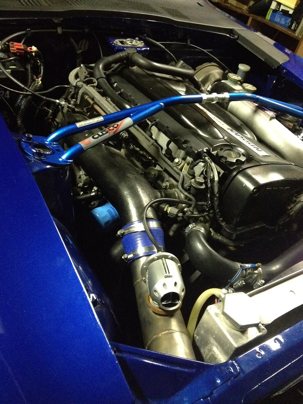

One key thing is, similar to my Cusco bar on the 240Z, when removing ensure the jam nuts are loose and adjuster turns easily. Don't force the bar off!. Since over time the strut towers may have shifted even just a micro millimeter. You don't want to strip the softer tower nuts or bolt threads.

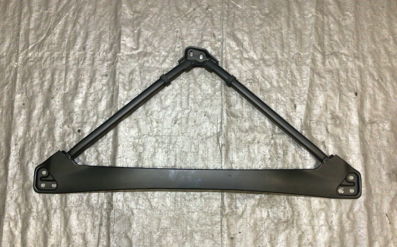

Tip: 370Z front strut tower brace tower fits the new Z. And the OEM one has 3 points contact and looks nicer IMO. (center cowl removal/modification required)
