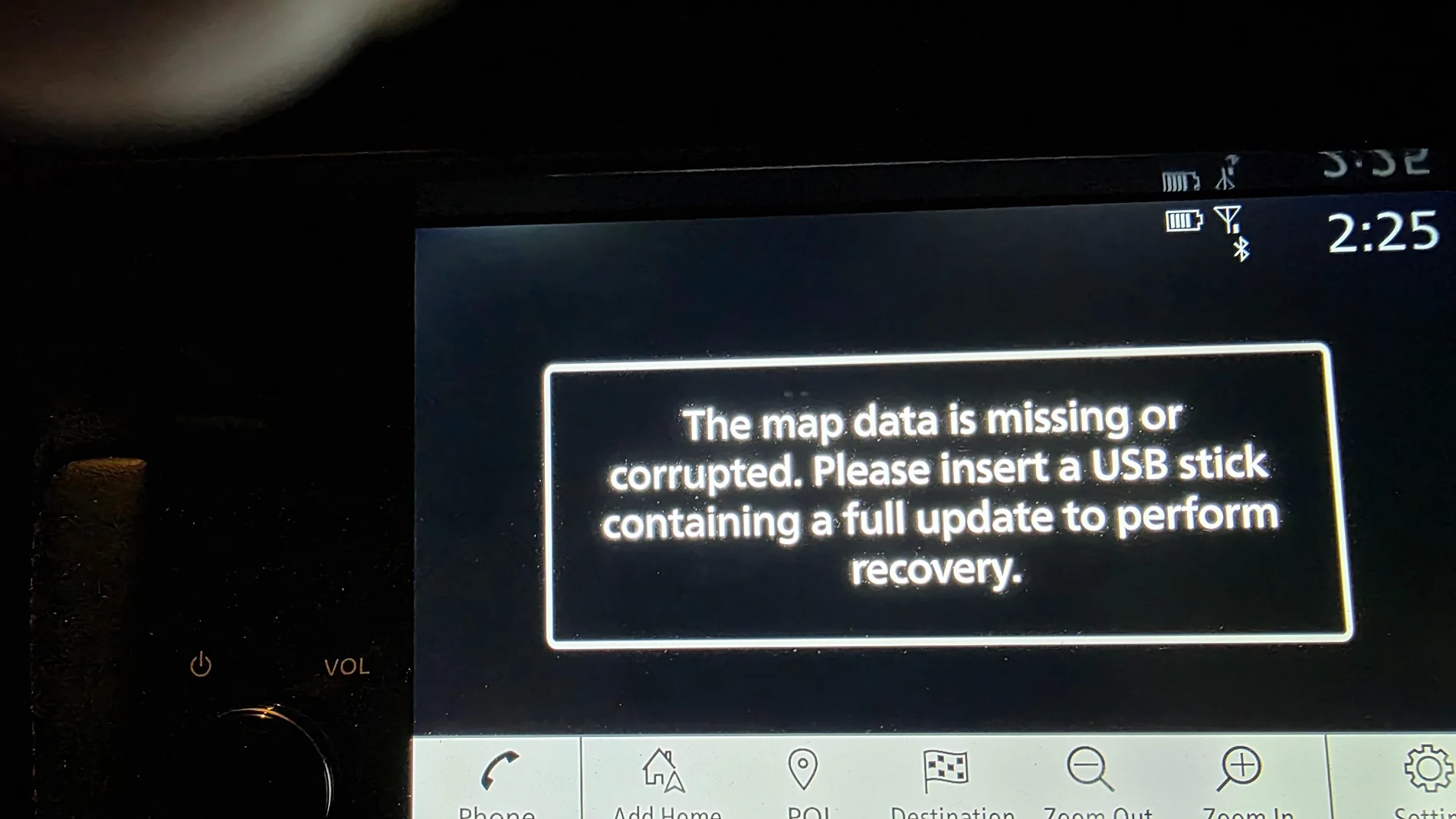

This is fun.
It needs a recovery via a USB stick.
The procedure calls for saving the existing map data to a USB stick, then using the Map Update Tool to download a map update that is then loaded into the nav system.
Unfortunately, the Z won't save any current map data to the USB drive, presumably because what's there is corrupted, so the Map Update Tool refuses to work.
I scheduled an appointment with the dealer to fix this. Meanwhile, Android Auto is a good substitute.

The map data problem started when an OTA map update was completed. Car was shut off and restarted and the error message appeared.
This was the dealer said:
Primary Concerns Analysis
  • Concern
    Critical
    My Car Has A Problem Map Data Was Corrupted During Update. Attempts To Recover Using The Map Update Tool Are Unsuccessful Because The Current Map Data Won'T Save To A Usb Stick. The Dealer Needs To Load New Map Data Via The Usb Recovery Process With A Master Usb Or Something.
    Cause
    VERIFIED CONCERN. INSPECTED AND THERE ARE NO AV UNIT SOFTWARE UPDATES AVAILABLE TO DOWNLOAD. MULTIPLE TECHLINE CASES FOR CONCERN AS WELL. ALL RECOMMENDING AV UNIT REPLACEMENT. CREATED VCAT CASE FOR AV UNIT REPLACEMENT APPROVAL
    Correction
    RECOMMEND AV UNIT. VCAT CASE CREATED FOR APPROVAL
So they are filing an AV unit replacement with Nissan and if approved, they will put in a new AV unit.
Not really the expected solution, but as long as it works. I figured they would just save the map data from another Z and then load it into mine.

AV unit was replaced today under warranty.
I did a Map Data Save to USB and was able to successfully use the Map Update Tool to update my local file and Canada. Everything was at the 2022.06 level and now the ones I updated are at the 2024.12 level.
I did have to re-pair my smartphone and the in-car WiFi
I caught the repair cost ($149), which Nissan will pay for.
Going forward, I will decline any OTA map updates and go with the USB method if any are offered.
