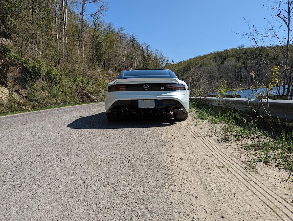

Issues with the exhaust:
damn alignment...... it took about 1.5hours total from the moment I pulled onto the lift to be raised and then driving out. This was done with a garage who have experience with JDM and specifically the q60. All in all, the first visit was flawless, get aligned well.
It was fresh metal, so i did expect some warping/shift after i pass extreme heat via pulls and this was the case. It did happen rather quick... a few days and less them 100km of driving, the driver side tip shifted about an inch and was nearly touching the plastic diffuser.
Brought her in, realign just by torquing the bolts and positioning. Same thing... after about 50km this time, driver tip again shifted and nearly touching plastic diffuser.
At this point, I started to get under the car myself and tinker myself (couldn't driver her out of fear of burning the plastic diffuser with the exhaust nearly touching!)
The OEM Hangars..... it kept allowing the rubber piece that hangs on the metal to shift around...
Went back to the garage, mechanic noticed and we put 4 clamps/donuts on the hangars (two in the rear near the tips and two right after the midpipe) Took her around the block with aggressive pulls and everything as firm without shift.
Then this past weekend, I logged 250kms and the exhaust is still rock solid!
My advice: for those doing it with a garage, be ready to spend ample time and multiple trials to ensure everything settles. If i can do it again, I'd book a half day with the garage and go on and off the lift a few times after some pulls after each iteration.
All in all, the CBE was more then worth it (and cmon, 4 inch tips?! make it look agro as hellllll)
