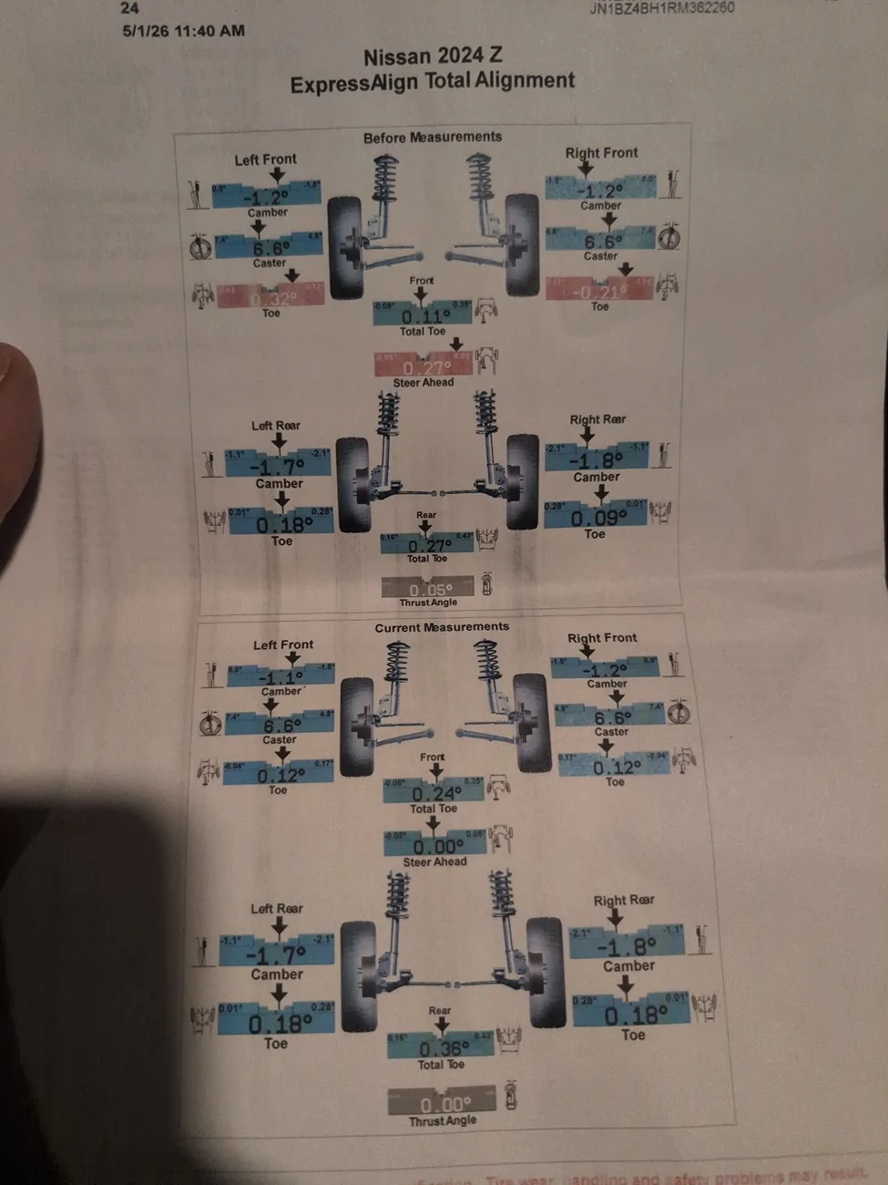

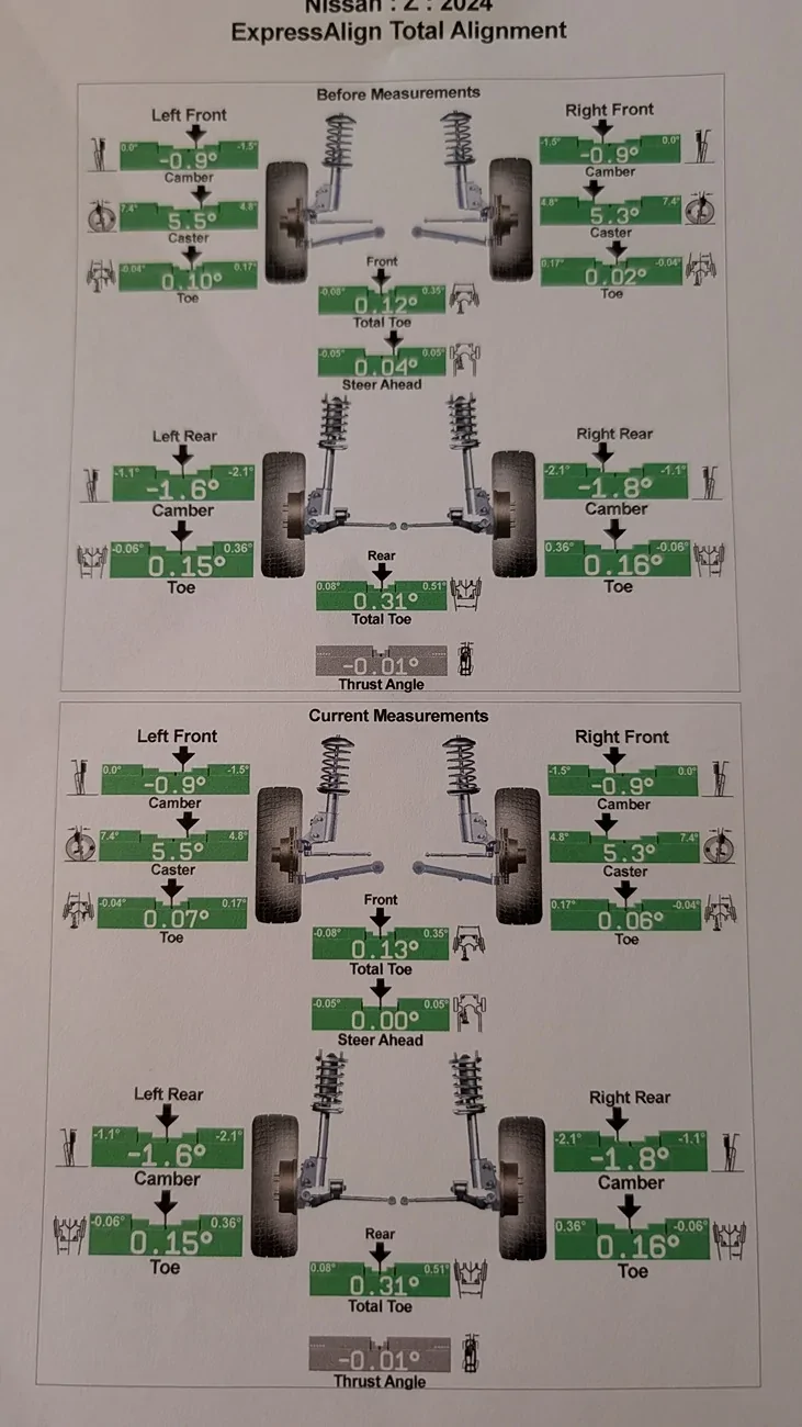

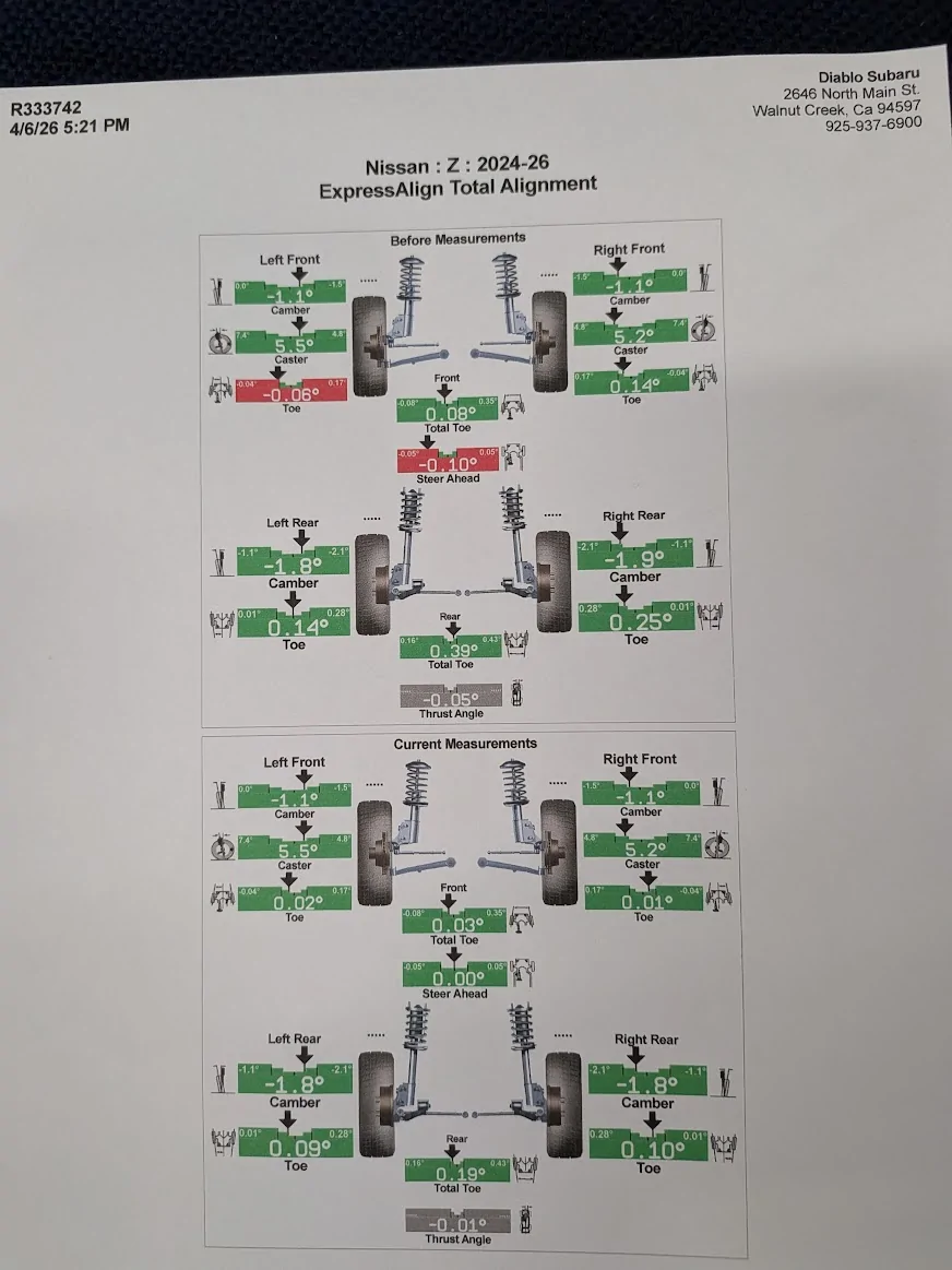

Does anyone know or know where I can find the factory alignment specs for the '24 Z performance?

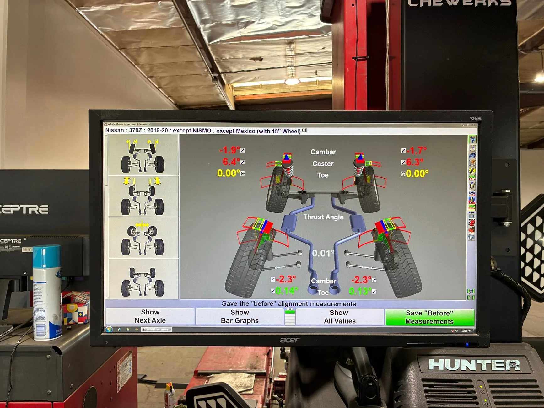

Front camber is non-adjustable, rear can be to certain limits of the camber bolts. Here is mine after lowered on Swift springs about 1.2", nothing else added. Rear can be more negative but the shop recommended these settings to balance out the front.
-1.8f and -2.3r is a perfect street aggressive setting. I considered front camber arm just to get more negative camber. This is stock suspension.
