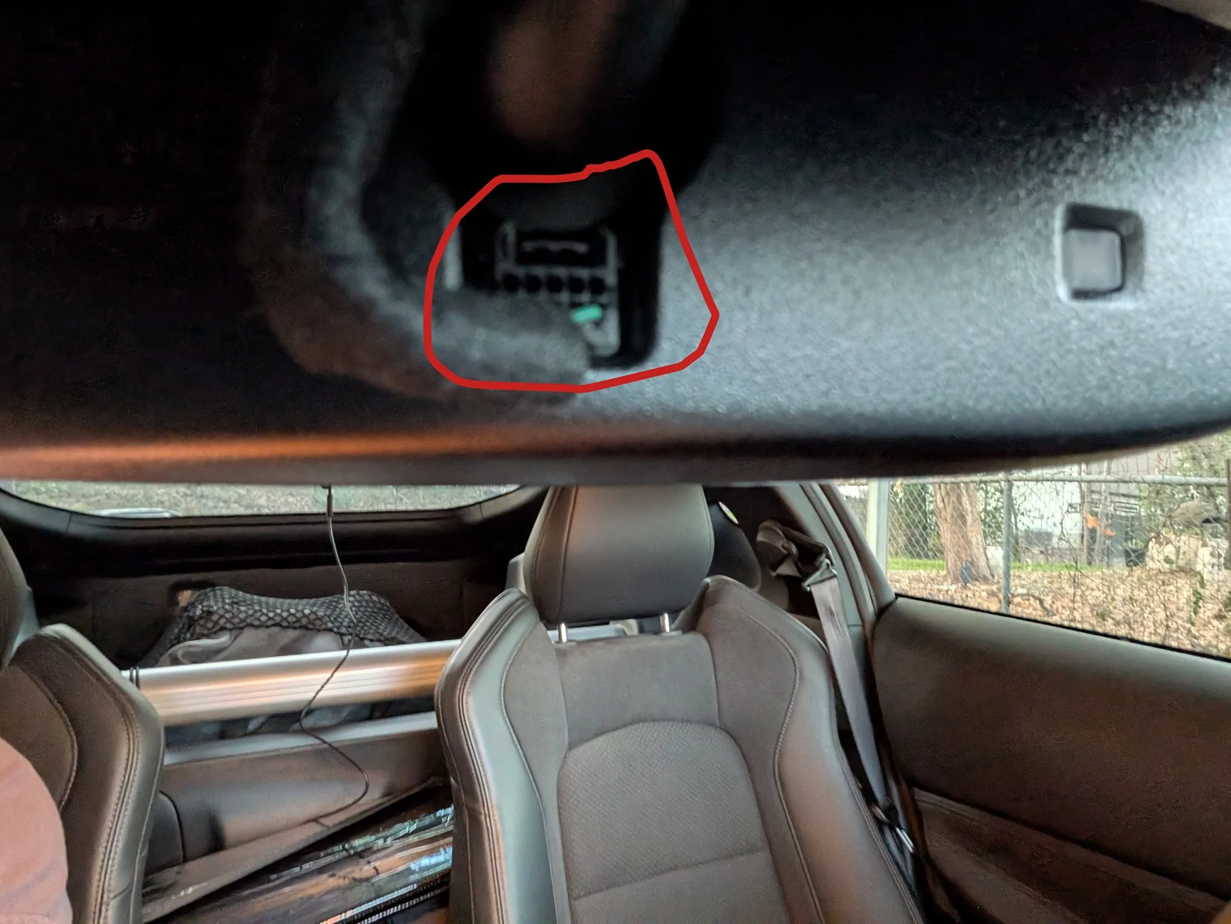

Thanks for the replies, but I think you've overestimated me!!!
I was planning to use that Dongar device based on other threads here. Is there literally an exposed plug in the front-facing part of the mirror housing that I just can't see from inside? I had assumed that you need to remove a cover or housing or something at the base of the to get access to the port/plug. Now that I looked with my phone, I can see this plug back there. I thought other folks talked about hiding extra wiring under the cover, so I'm still curious about how to get that off.

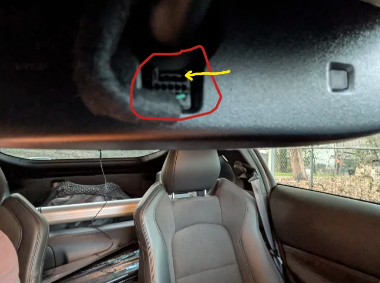

Our mirrors/plugs are different in Australia, but from what I can see, I think you just squeeze down on that horizontal tab (highlighted with yellow arrow), and pull the plug outwards.
https://dongar.tech/cdn/shop/videos...5f514da5243.HD-1080p-2.5Mbps-26123062.mp4?v=0
The above link is a video from the Dongar website.
And the video below isn't on a Z, but should give you a rough idea on how to tuck the cable to the rear dash cam:
Both those videos were super helpful to me. Looks like the wire hiding thing really isn't that bad. And thanks for the pointer about the tab on the wiring harness. It's so hard to see anything inside this tiny little car...

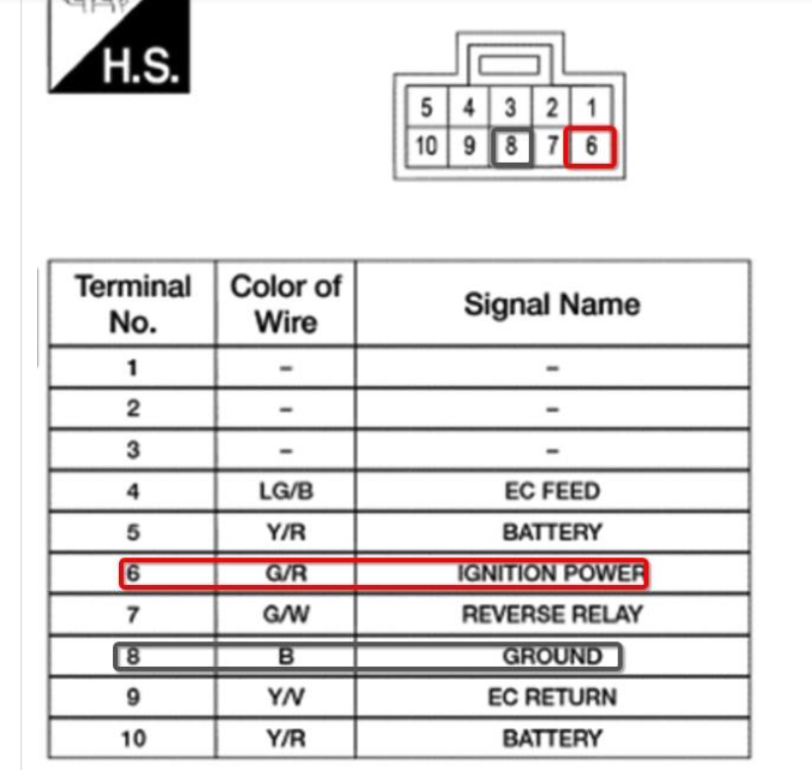

Pinout for Nissan10 pin rear view dimmer connecter. Double check with a voltmeter or an LED light.
Thanks! Exactly what I needed...
