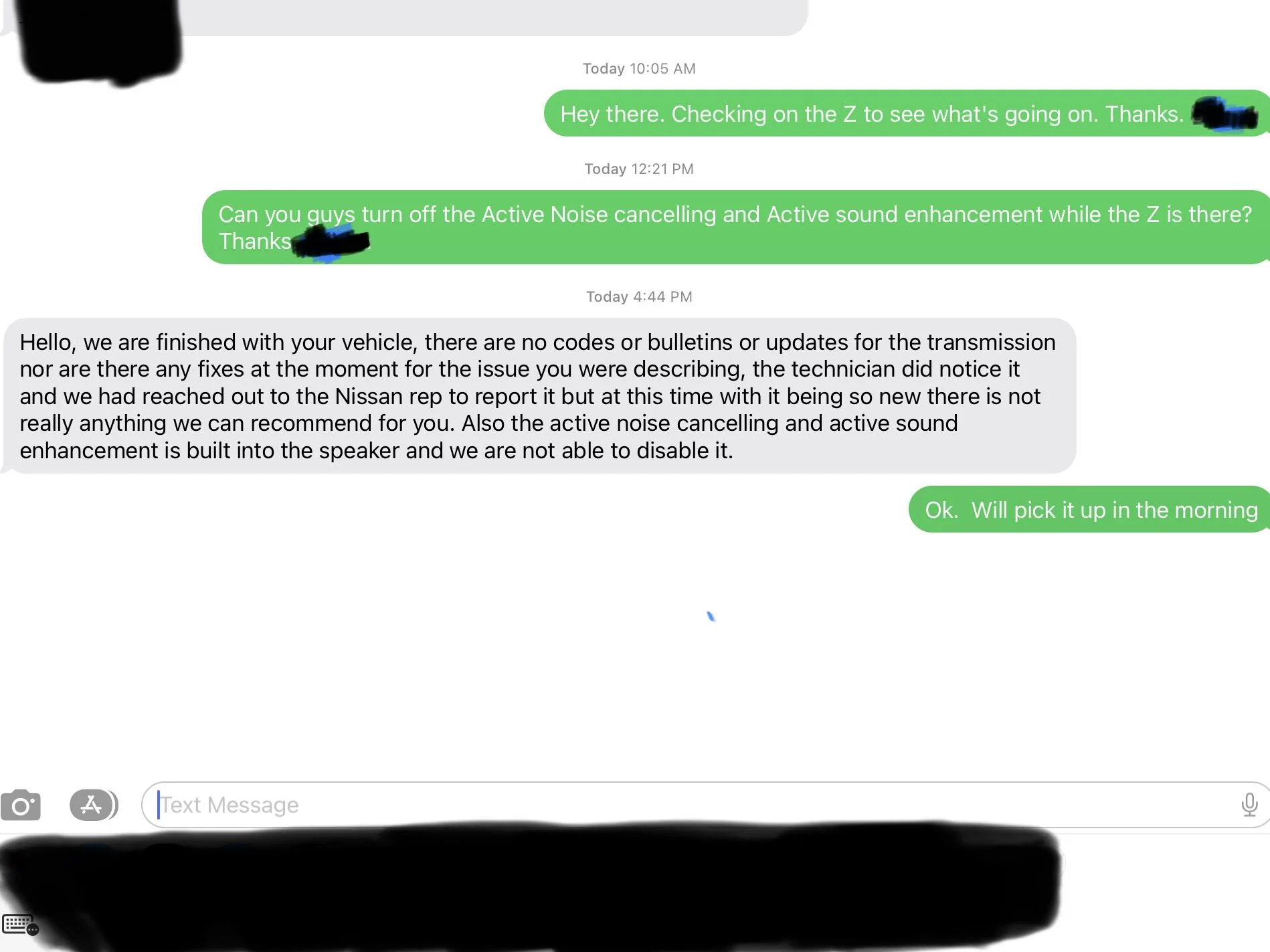

I missed the fact the Z had ANC/ASE! Mine is at the dealer now for AT lurching issue. I just texted them and asked them to disable those features while it is there.
Let us know what they say or find out about the lurching. It is quite annoying.

I picked up my Z this morning and showed the service advisor the screenshot of the Consult. We agreed to address turning the functions off again at the first oil change in a couple of months.
