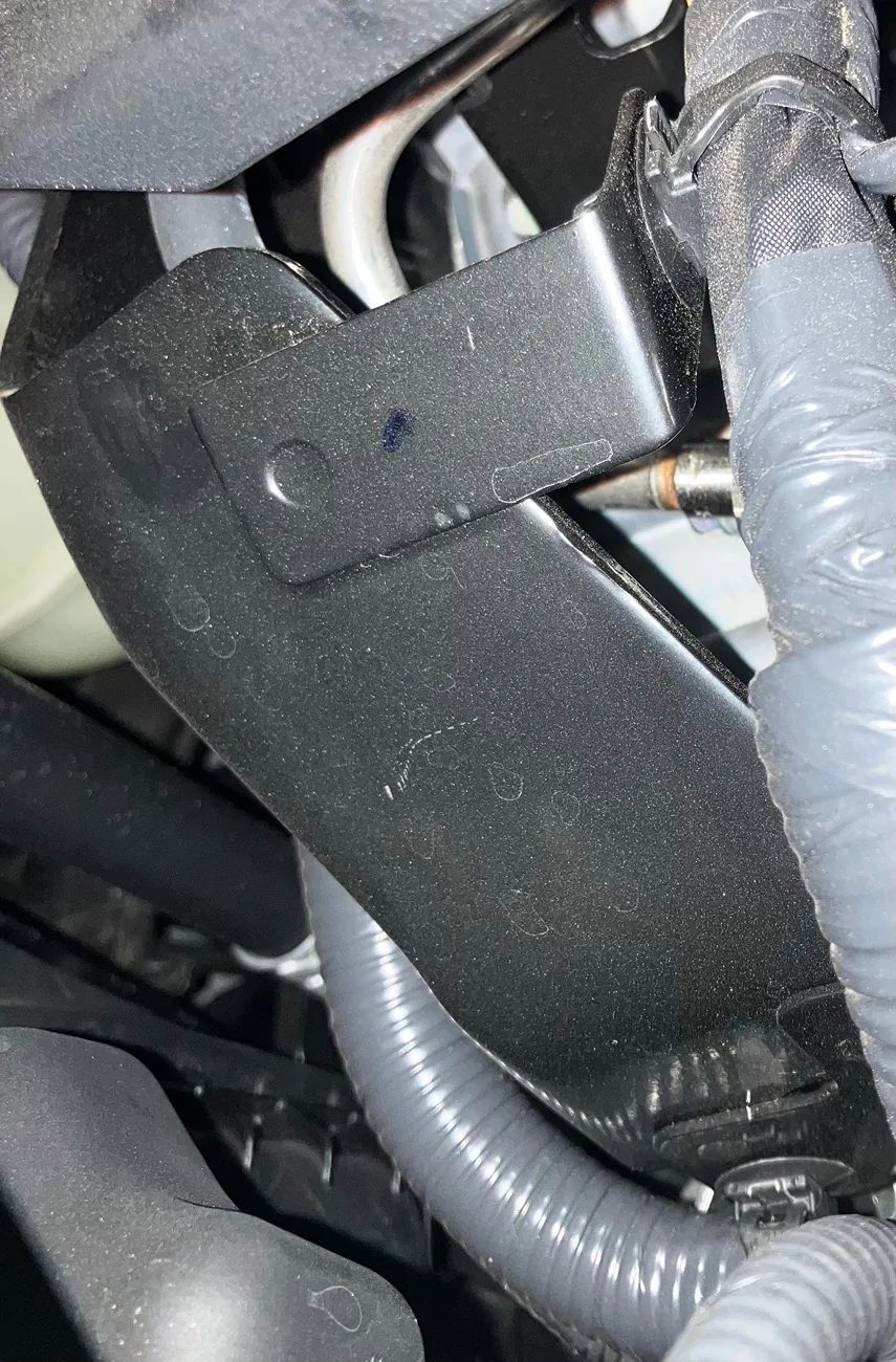

Out of curiosity, I tried looking in that area, without taking off the cover. It appears you can see the connection in question, at least where it looks to be spraying from in the video above, if you shine some light in the area under the cover from the driver’s side. No problem noted with mine, for now. Something you can keep an eye on, when you’re checking the oil, as a minimum.

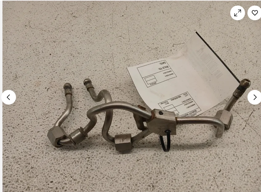

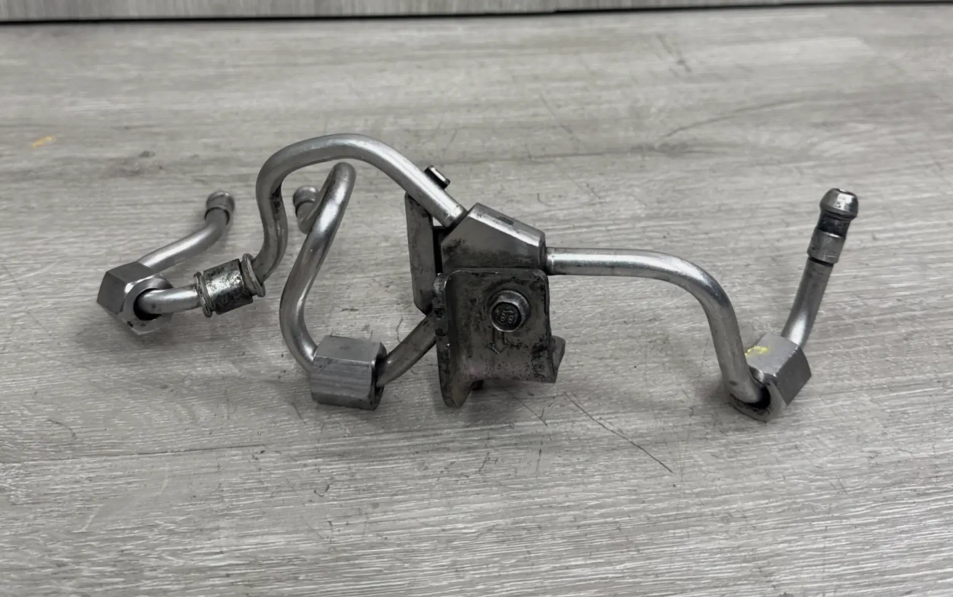

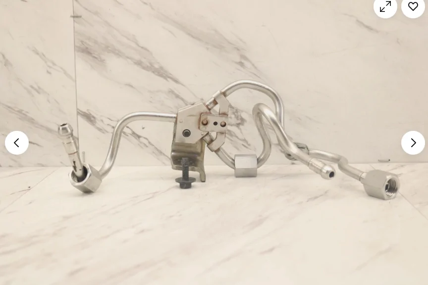

It looks like their(q50) part number was 17520-5CA0A, which looks like an identical part.
Photos of the Q50 part from fleabay:
If the current parts are experiencing some sort of quality issue, perhaps you can buy one of these 100k mile veterans from ebay to fix your car until Nissan gets their manufacturing in line.
