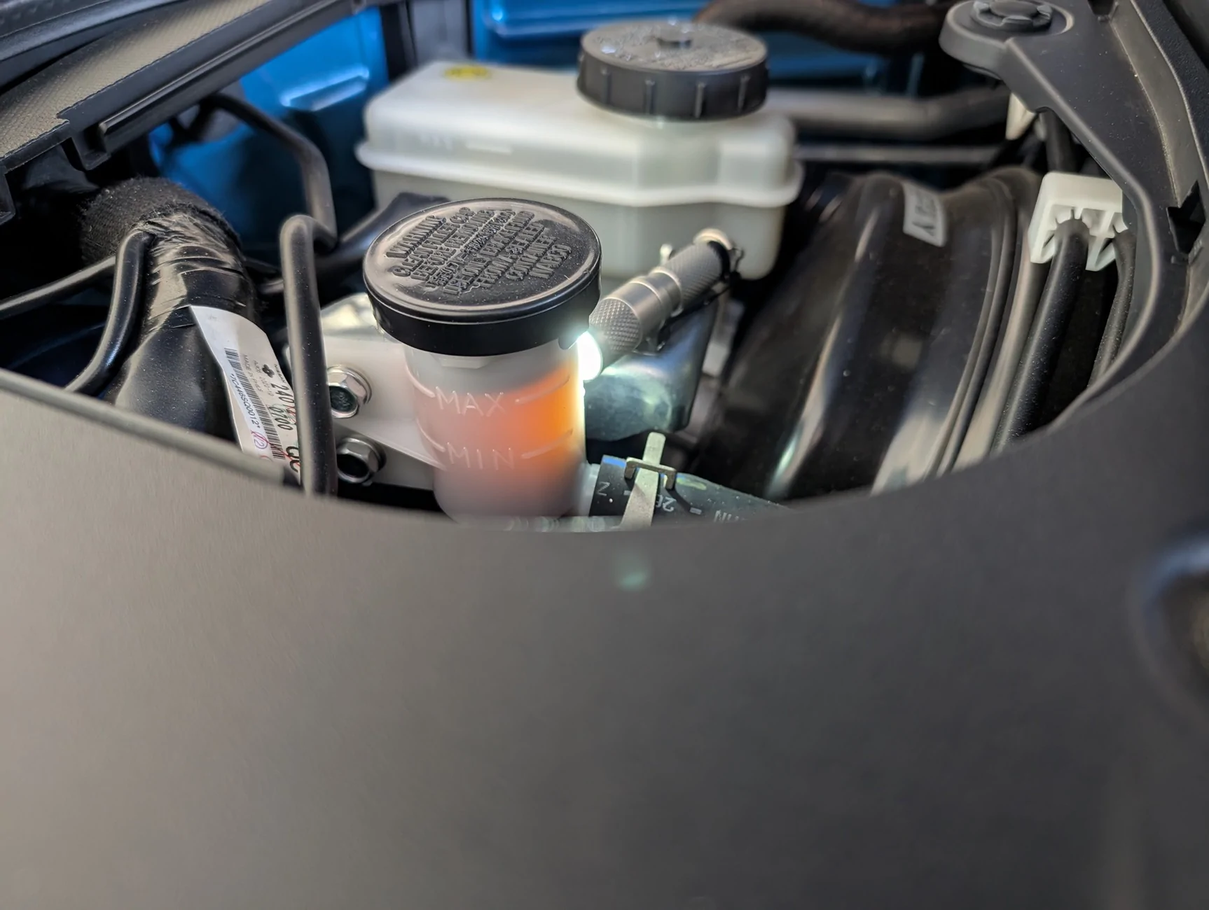

What color is the clutch fluid supposed to be? I seem to recall earlier checks where it was basically clear, but am I remembering correctly? I was checking everything yesterday and this thread was stuck in my mind. My clutch fluid is slightly brown as well. Flashlight providing illumination.
Suppose to be light yellow. Nearly clear.
Mine's a 2023, built in December 2022 and purchased in April 2023. I've never serviced the clutch fluid so far, maybe next oil change I'll have them replace it.
