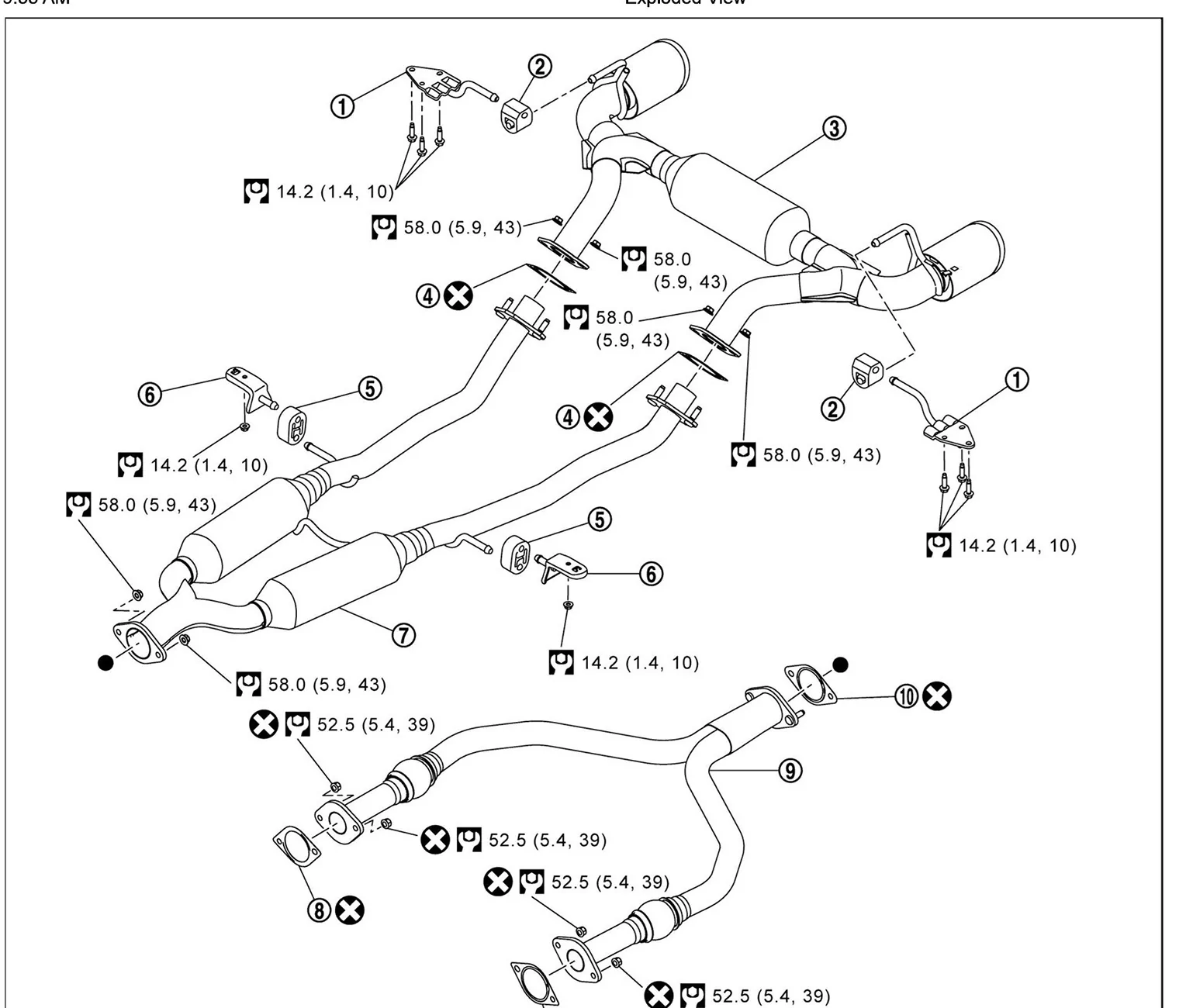

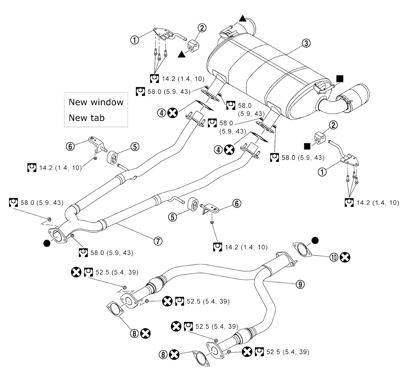

So you have a manual and kept your mid-pipe, but swapped to the auto exhaust?
From the service manual if anyone's interested, manual and auto:
Yes exactly. The least muffled factory parts combo. It sounds so good. There must be someone on the engine team that meant for it to be a thing.
