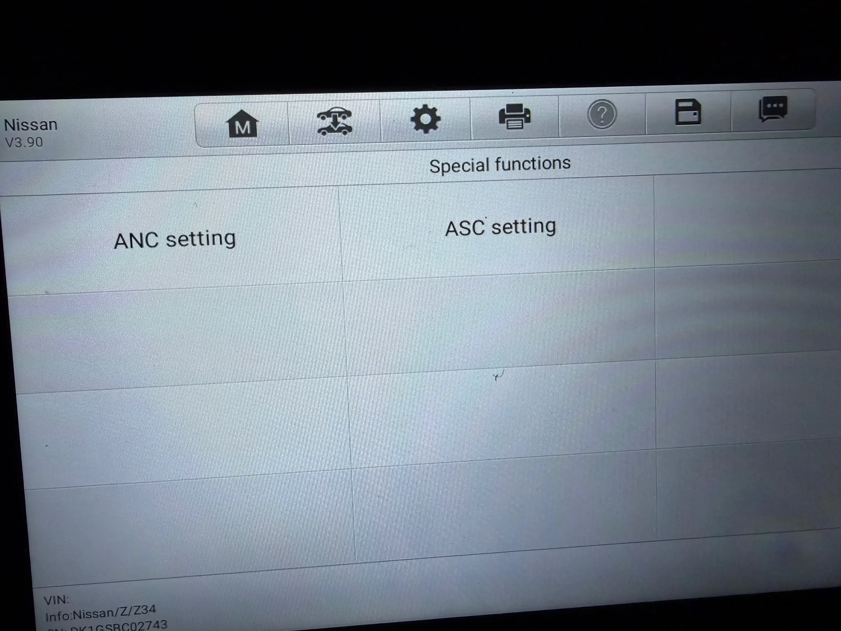

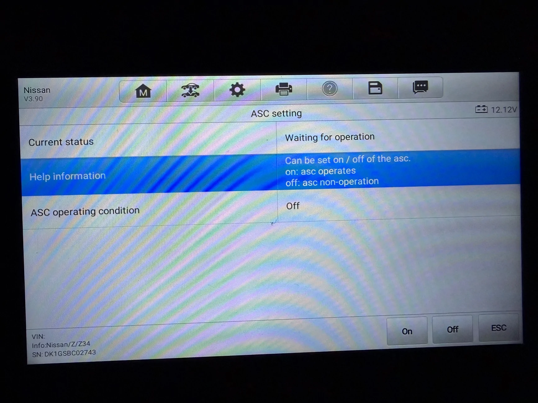

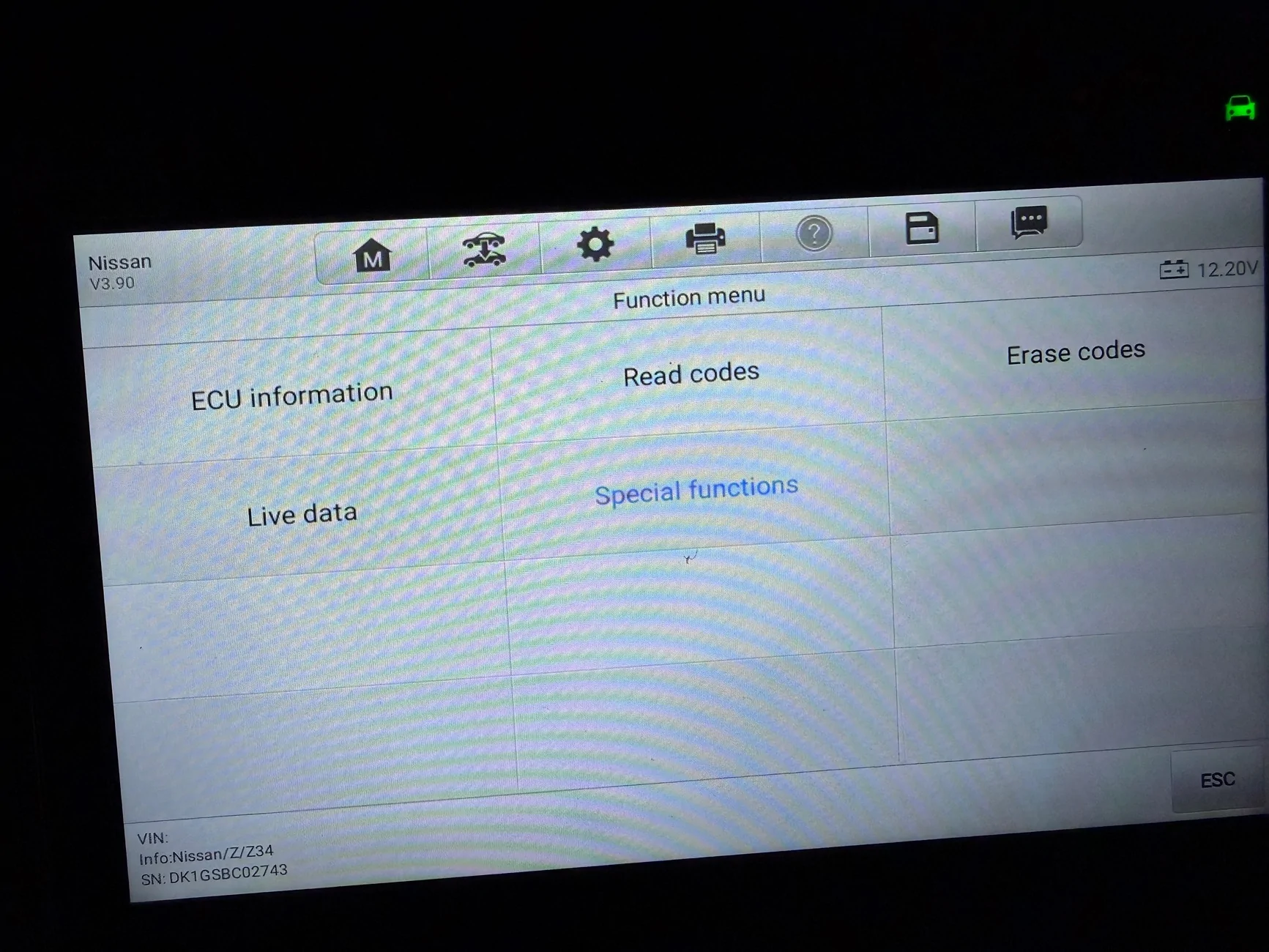

Just made this video to show how to get to the settings after you’ve connected an Autel scanner to your Z:
