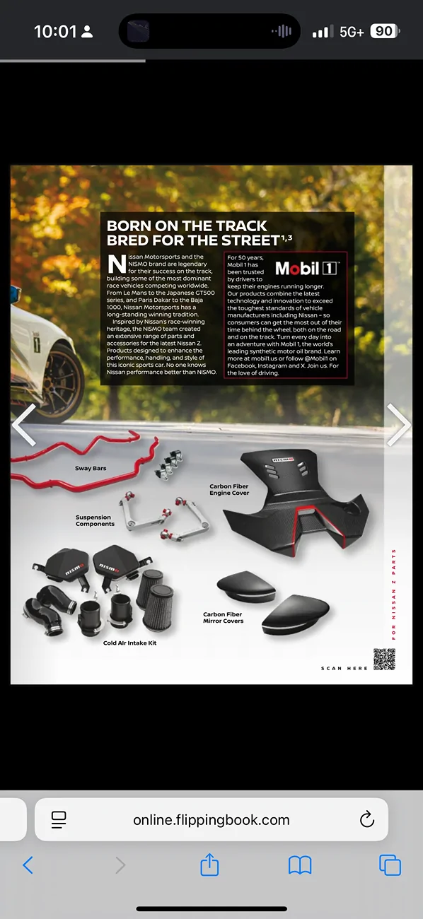

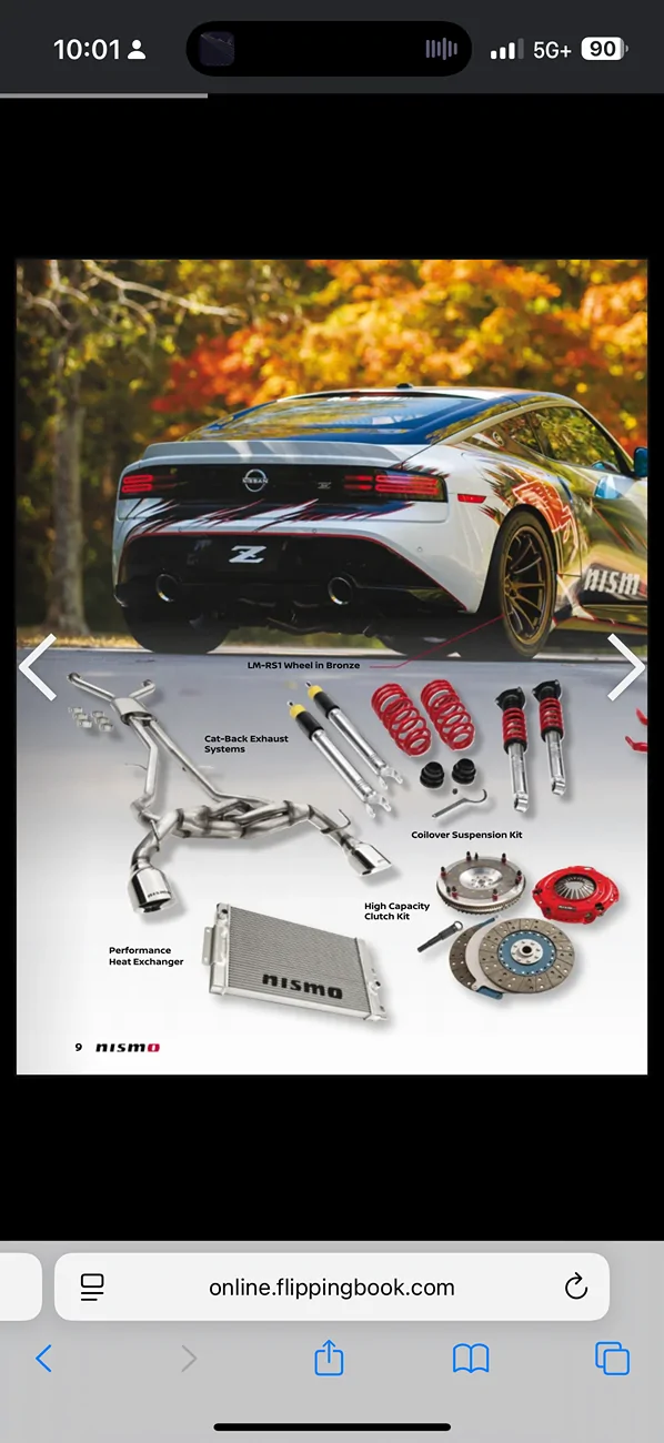

Well nismo is just the racing brand of parts, we all know not even the nismo model doesn’t have any nismo parts 😬.
It’s all about the upsell on extra parts, which I’m curious because im
Wondering if anyone’s bought the entire nismo catalog for the Z 🤣🤣

Bought Cat Back Exhaust, Cold air intake, Clutch, Heat exchanger and Stillen Sway Bars. The NiSMO ones were breaking.
