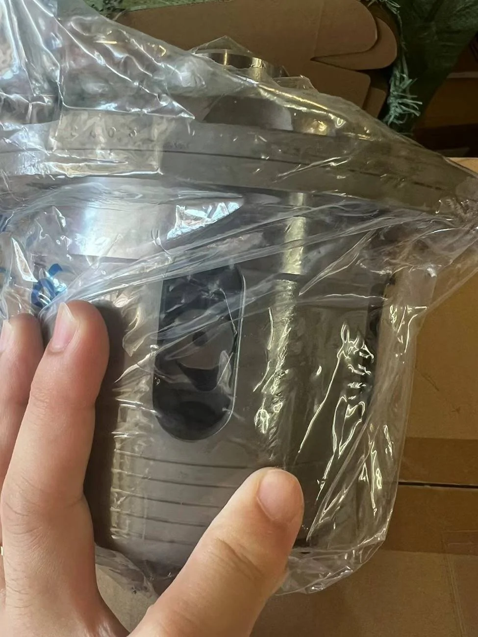

Got Cusco diff installed right after first track day. Well, first half track day, brake gone after 6 corners. By the way performance trim. 1500 AUD lsd and 4800AUD labor with some other basic upgrades.
