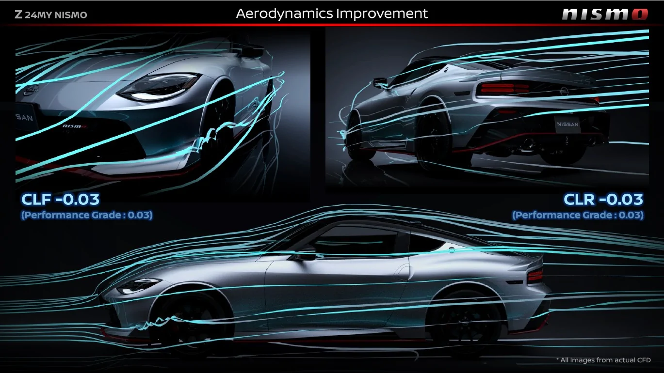

Are there any websites or forums where I can find the aerodynamic specs for the RZ34? I'd like to learn how to improve the RZ34's aerodynamics.

thanks! What about the performance
The performance numbers are listed in the smaller print in under it for comparison
Fun fact at speeds above 120ish the performance actually generates a tiny bit of lift
I know that,the front and rear bumpers on the Nismo version feature a number of airflow management designs to reduce lift. Thank you very much.

The sport model without a rear spoiler and front under chin spoiler is limited to a lower speed than the performance for safety
Nismo also has different(better) under car air management and an extra flat panel that covers the front aluminum subframe behind the revised front undertray.
Thank you very much. Are there any pictures or links? I'd like to put together a kit for my Performance Z to improve its aerodynamics. I noticed that the Z aiming for a 58‑second lap time at Tsukuba Circuit only used the Nismo front bumper(without any other Nismo body parts), so I'm wondering if I should follow the same modification approach.

Sarah-N-Tuned does a goos job showing it in her video:
At that timestamp you can see the better front undertray, the rear undercover the sport/performance lacks, the wheel well diffusers unique to the Nismo, as well as the brake cooling air deflectors attached to the front sway bar. All are underbody aero features unique to the Nismo.
