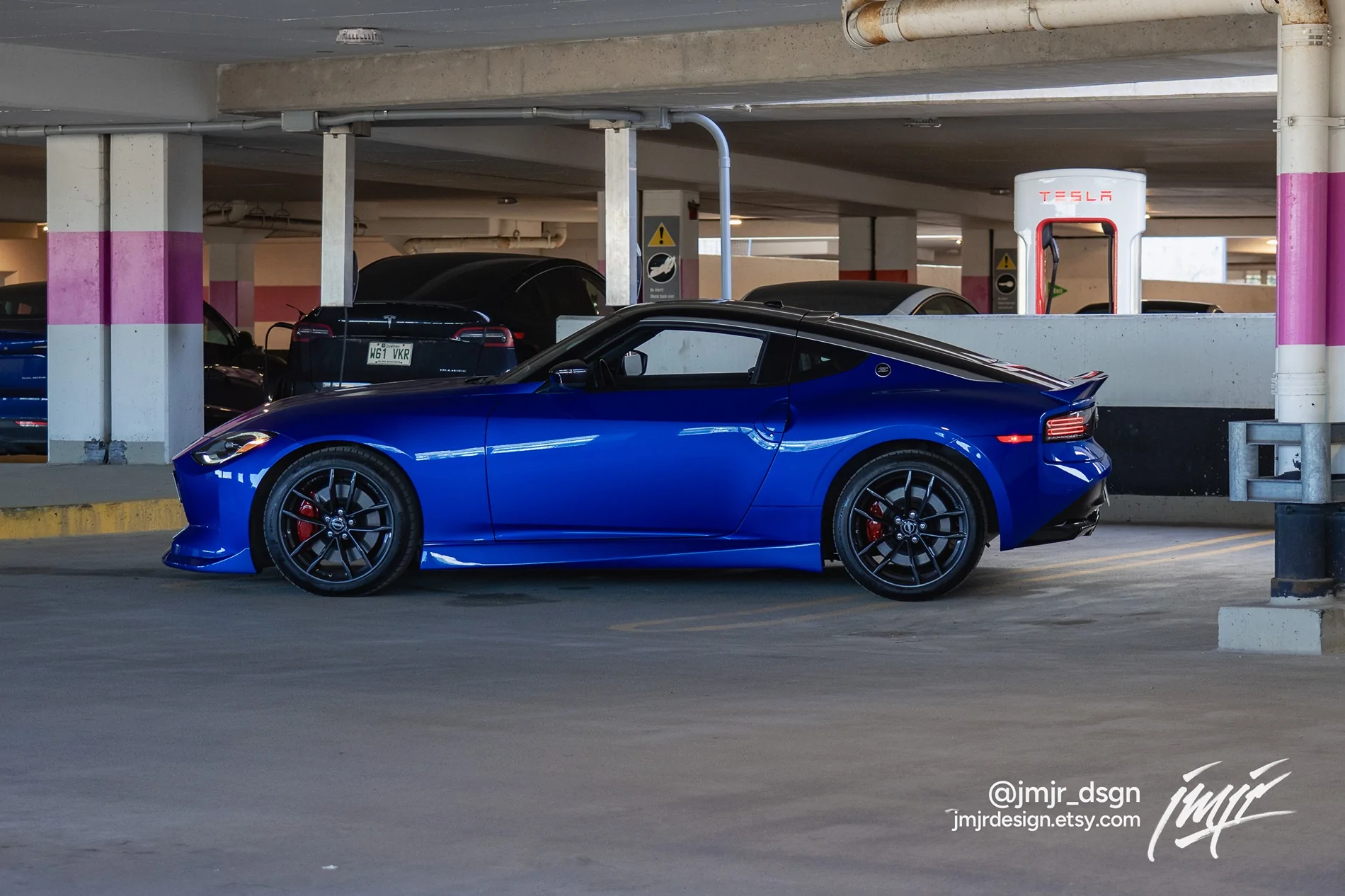

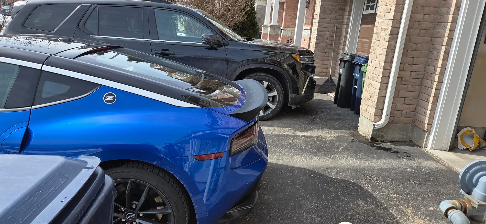

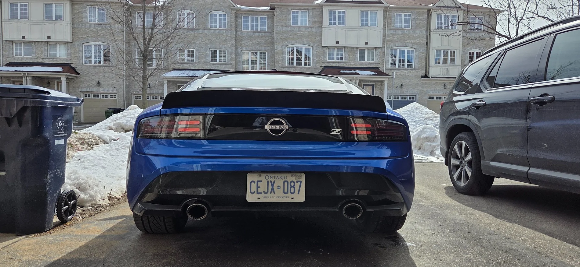

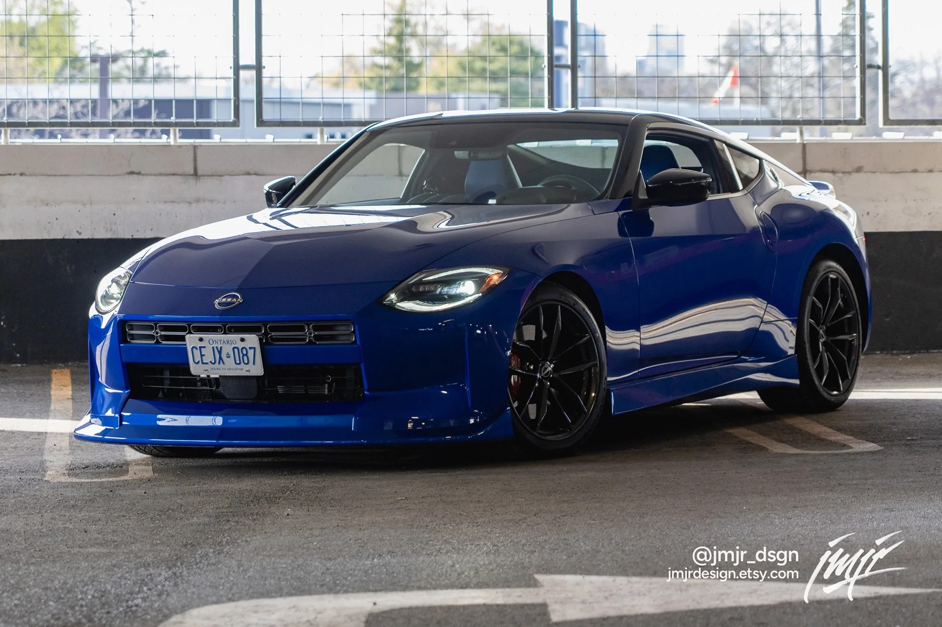

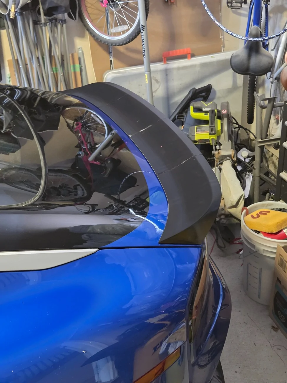

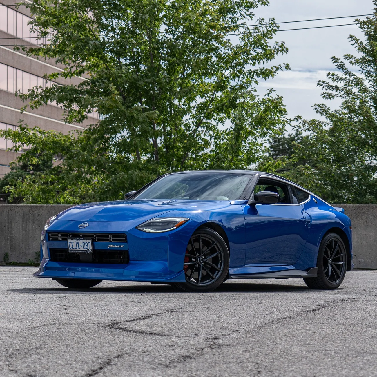

Almost done with my ducktail, which has a lot more rake to it than traditional ducktails. I'm trying to maintain the smooth curves / crisp edge design language from the Z so it looks more cohesive. This one's an easy print and I've speed tested it up to 100mph, there was just some light fitment tweaking. I'll release final files once I reprint the final, likely within a week or two along with the front lip, which has been performing great.

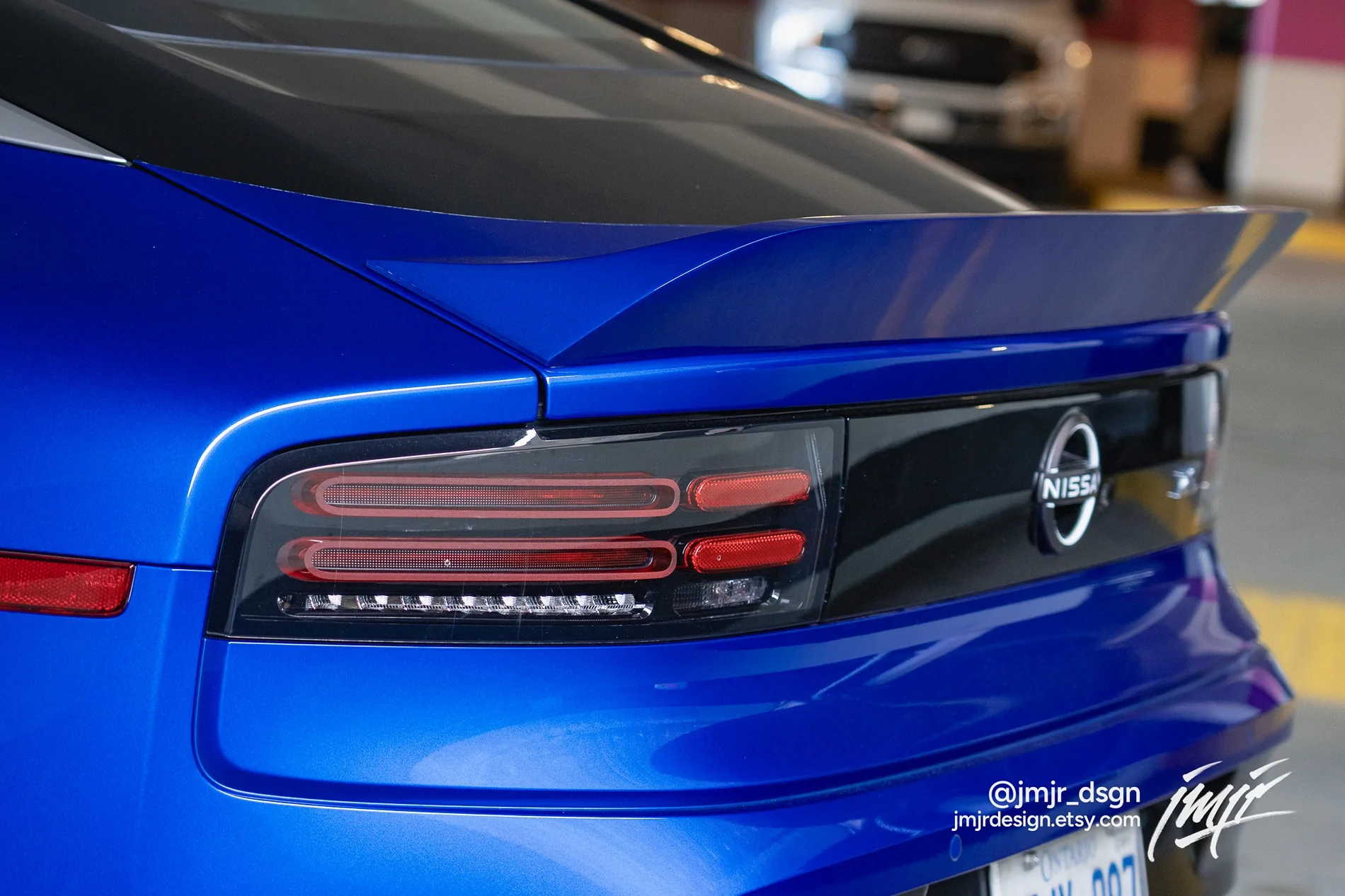

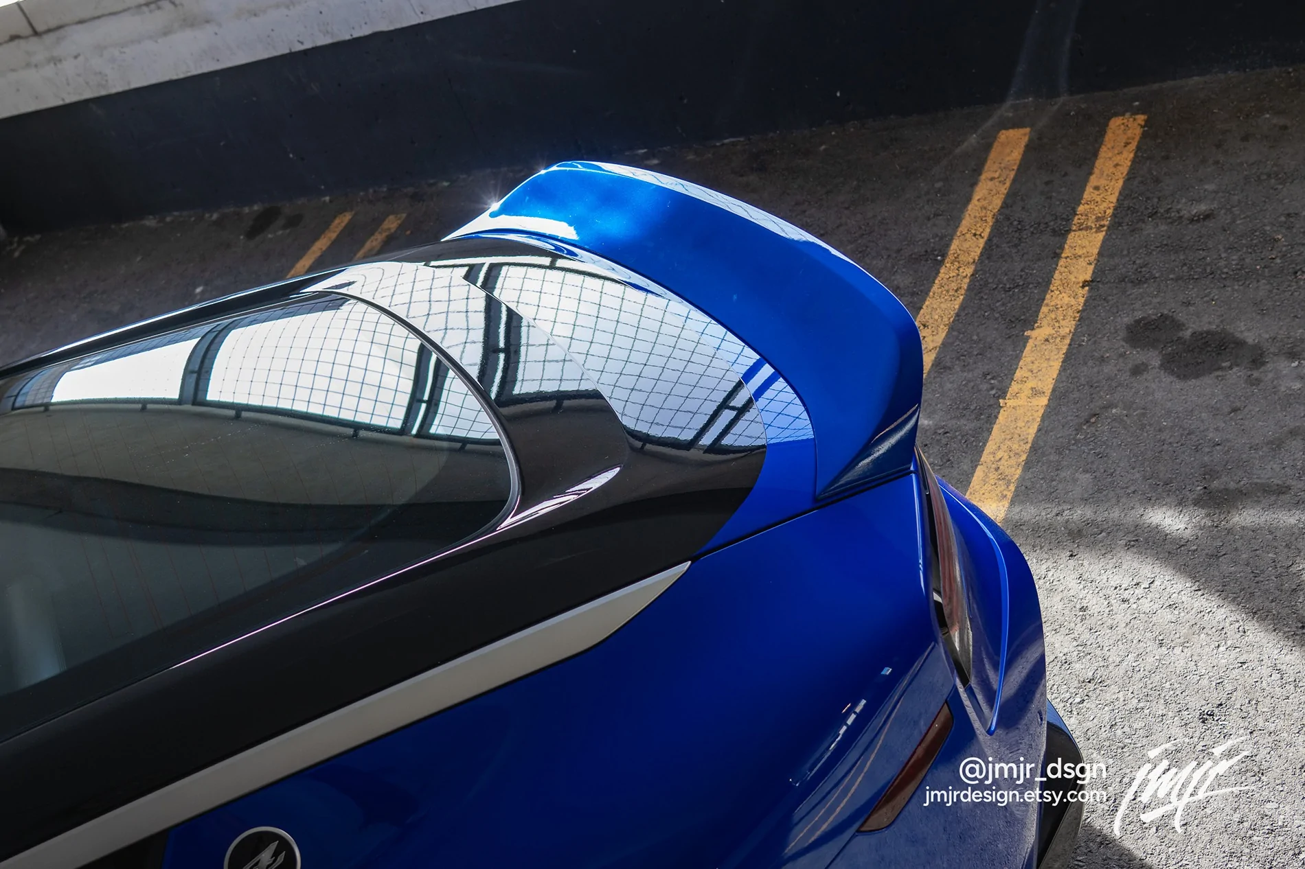

just circling back on this since I'm more or less finished with the 3D-Z project, had the bodyshop colour match the printed parts perfectly and installed over the weekend-

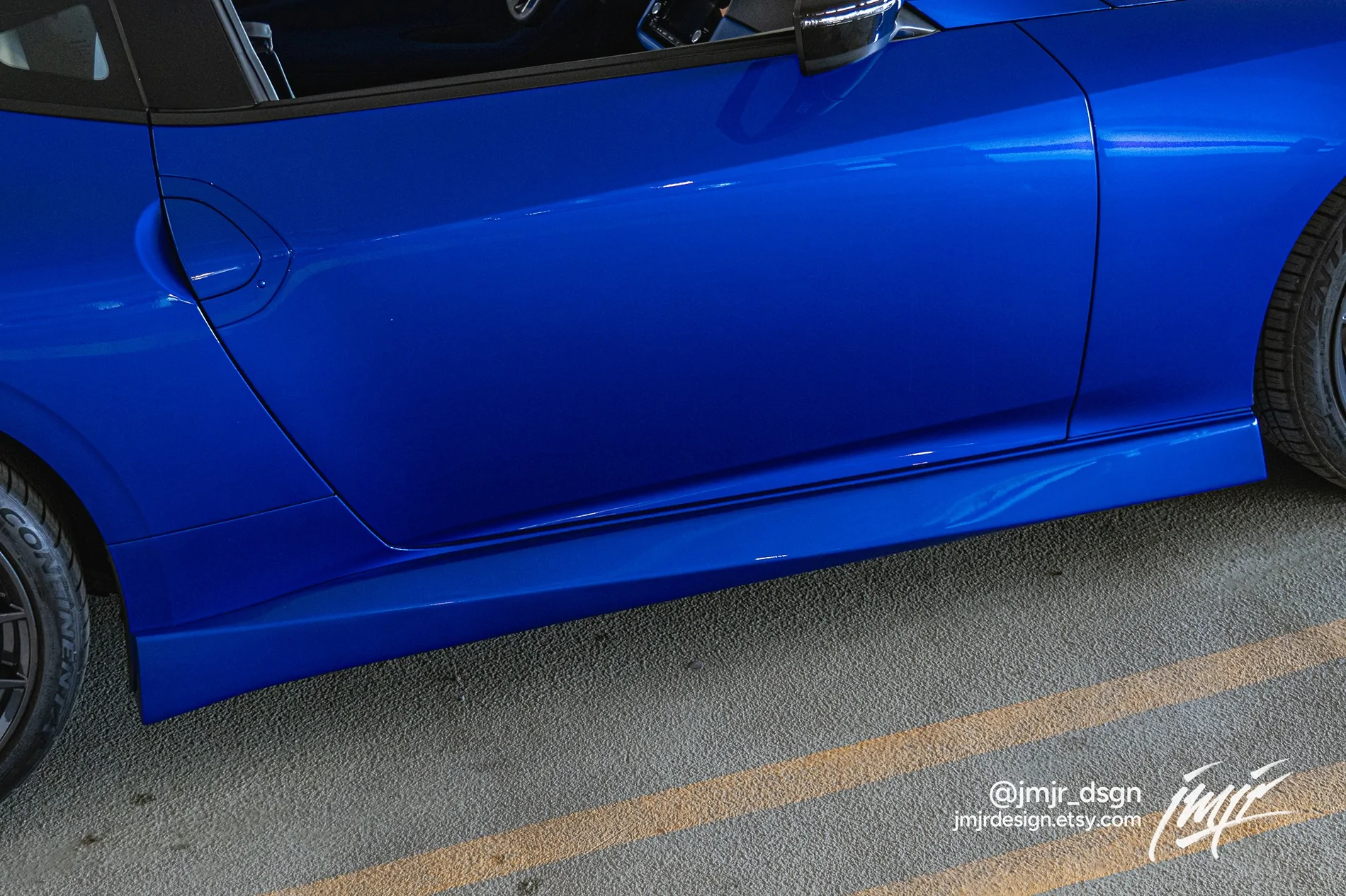

The lip and spoiler are available to download as well, the sideskirts are still in beta... :D

that turned out amazing.
any schematics or info on how you mounted everything?

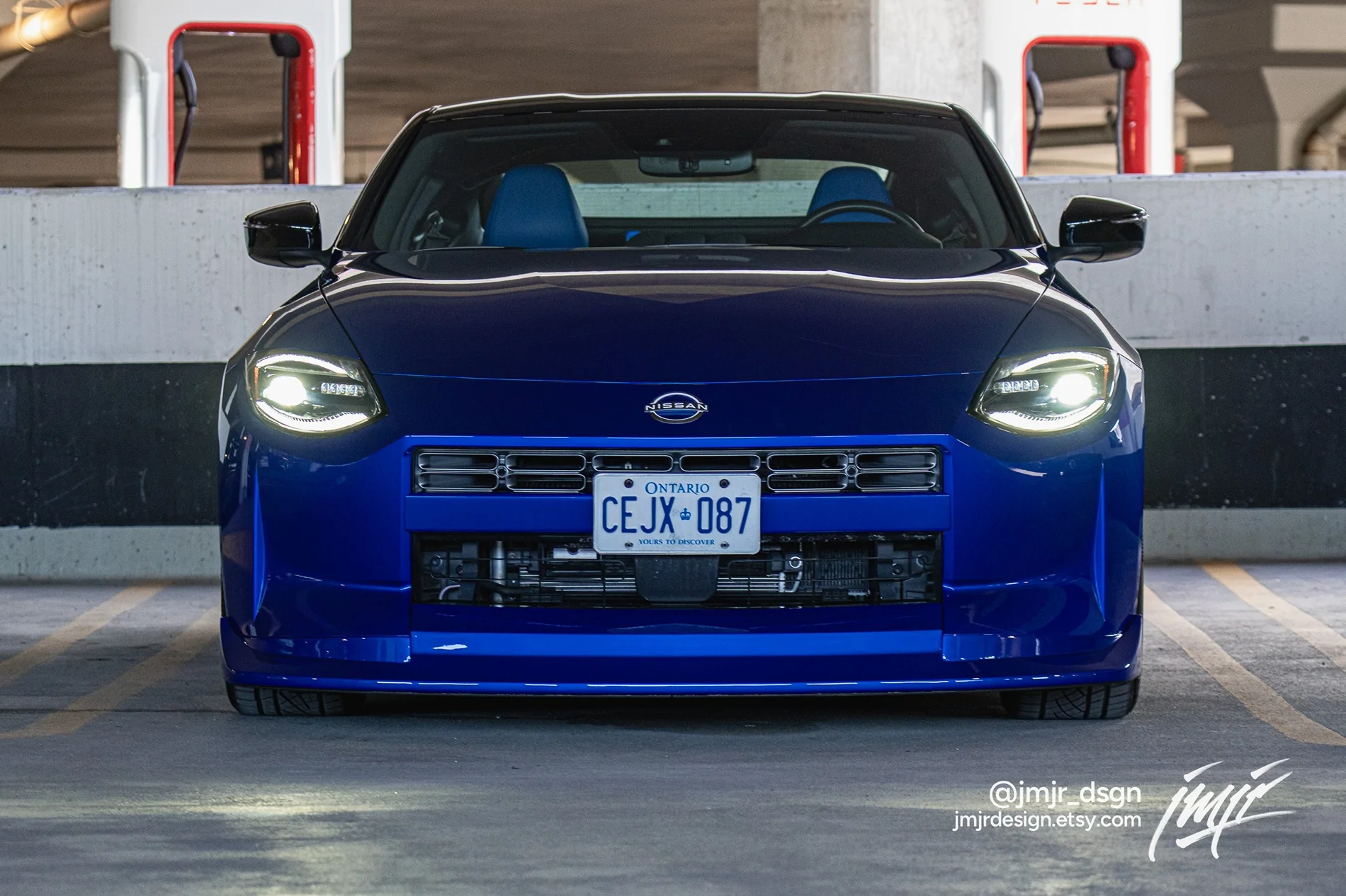

The front lip is pretty standard front lip, top goes in the mouth, little bit of 3m tape as it wraps around front of bumper and then a few screws. Rear spoiler is 3m tape and screws in the factory performance spoiler holes but can just be run with 3m tape.
Front bar is a mount system that's hidden.
