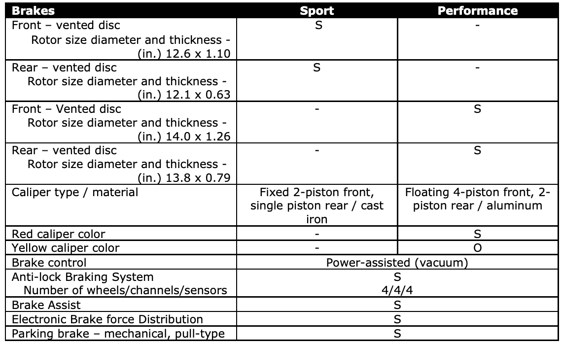

It's all in the offical spec sheet.
No Brembos, both trims get Akebonos.
Sport:
Fixed 2-piston front (320mm), single piston rear (307mm) / cast iron.
Performance:
Floating 4-piston front (355mm), 2- piston rear (350mm) / aluminum.

You guys need to refer to the Nissan Spec Sheet and not internet speculation.

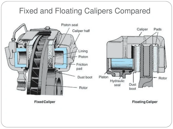

The Nissan spec sheet must be using the terminology "fixed" and "floating" to mean the opposite of what everyone else understands it to mean... Otherwise you're telling me the big 4-piston brakes are using a sliding caliper like the type used on your mom's Buick? And the base model gets the "good" fixed calipers with opposed pistons? See diagram below for proper usage.
For that matter, you can't have a "fixed" caliper with only one piston (as described for the rear on Sport), so I think whoever made that spec sheet doesn't know what they're doing.
Perhaps floating disc rotors not calipers?
