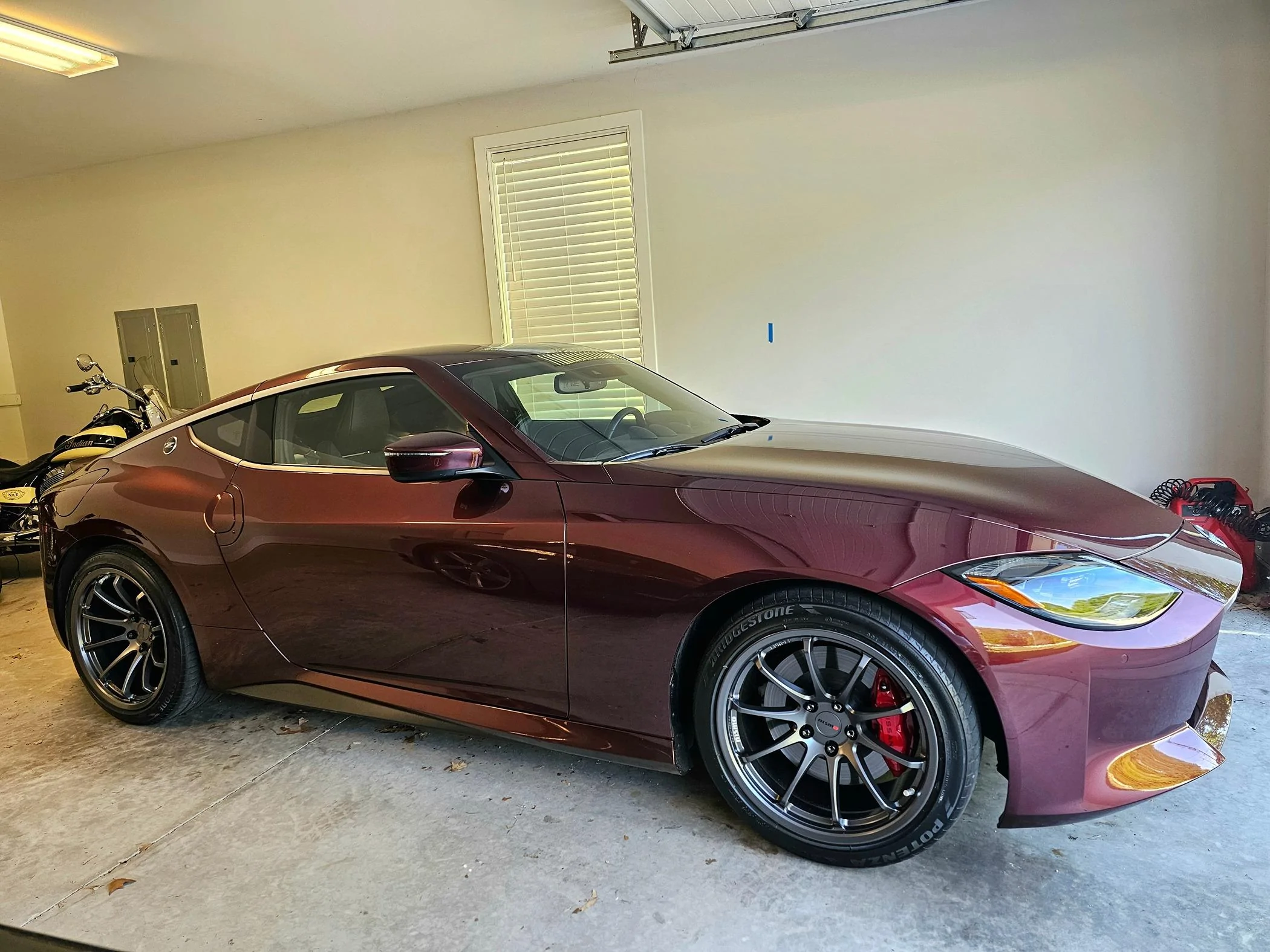

There's a bunch a video's out there on choosing different wheel sizes, Goggle will be your friend on that. The most common is 19's. But I have seen few folks running 20's, which can get tricky if you're adding width. I went 19 x 10.5 +12 offset rears and 19 x 9.5 +22 offset fronts on my previous Z.

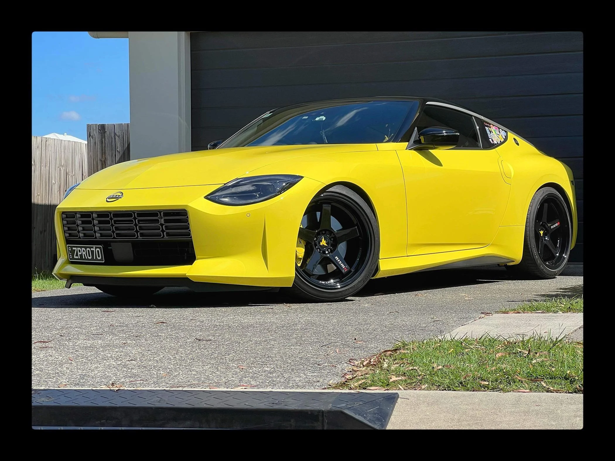

You need to consider offset when deciding what wheels will fit over the callipers (there are calculators online to compare with your stocks). I added squared 19x10.5 +15 on all sides. The fronts poke out slightly but I’m still enjoying the look and have managed to stretch on the stock tyres for now.

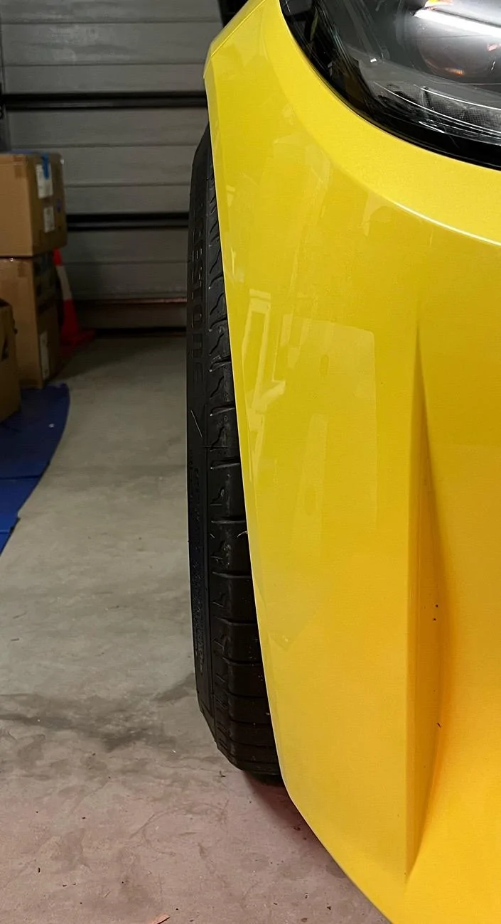

Good day Sir! Do you have a pic showing how much the 10.5" +15 pokes out up front? and if I might ask, do you know your camber specs?

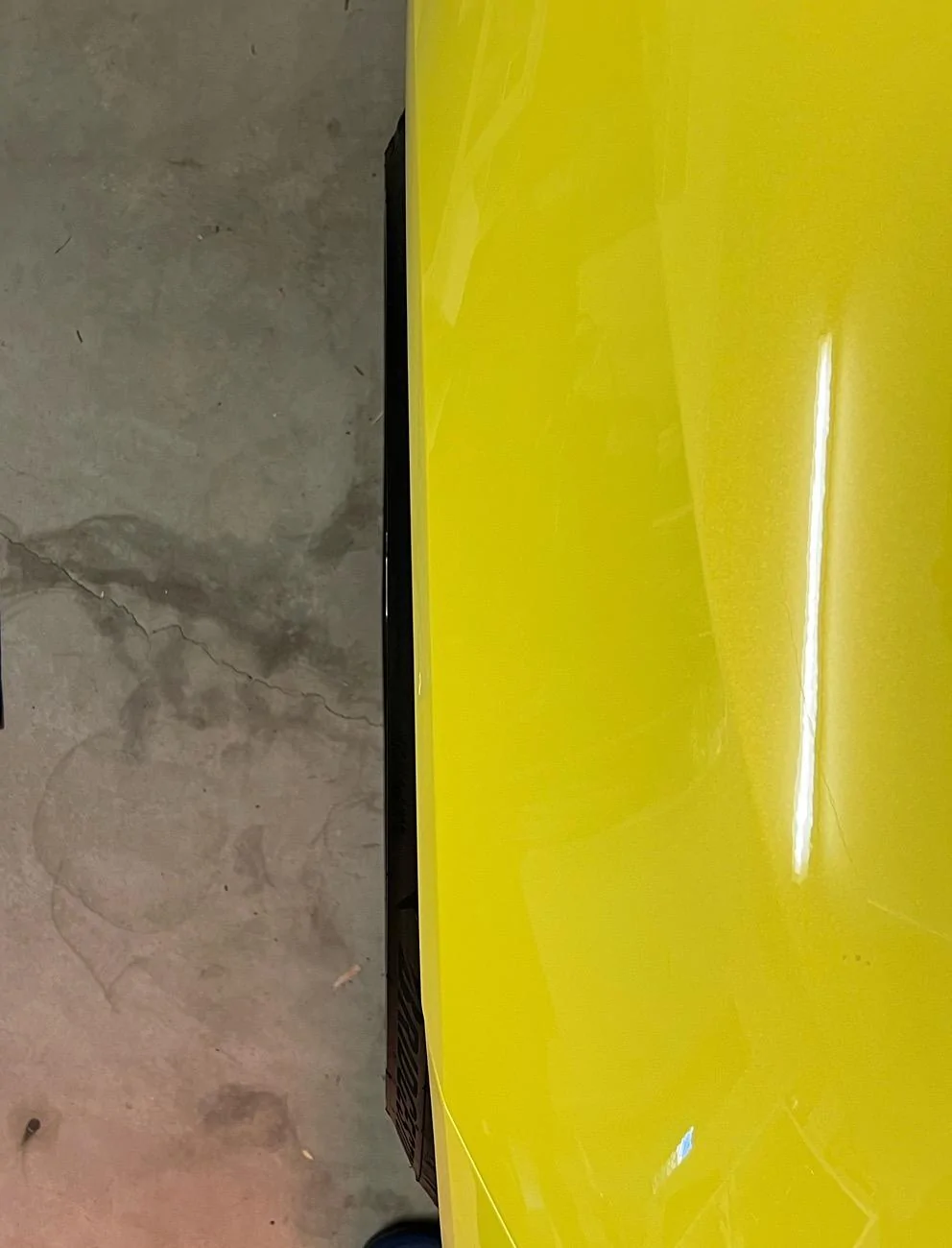

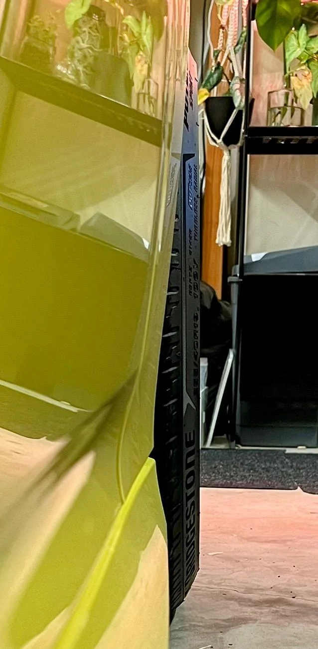

Hey mate,
In the middle of a house move so these are the best I can do, sorry. Camber is negative and about 0.1 degrees.
Amazing. More than enough! Thank you good Sir!! So. By the looks of it, if one were to run like 2-2.5* negative camber, it should probably clear!? 🤔 maybe?! Hopefully 😁
