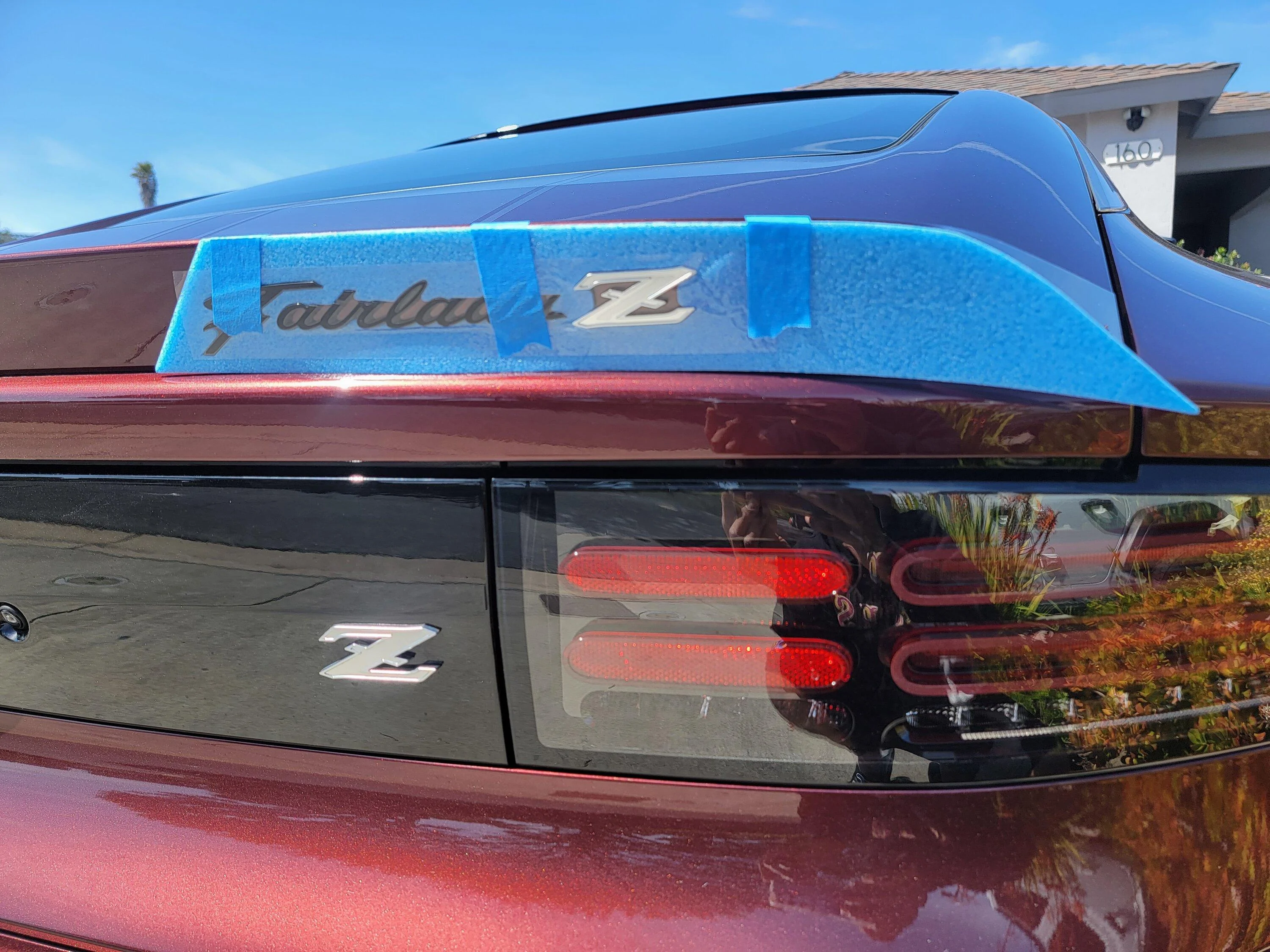

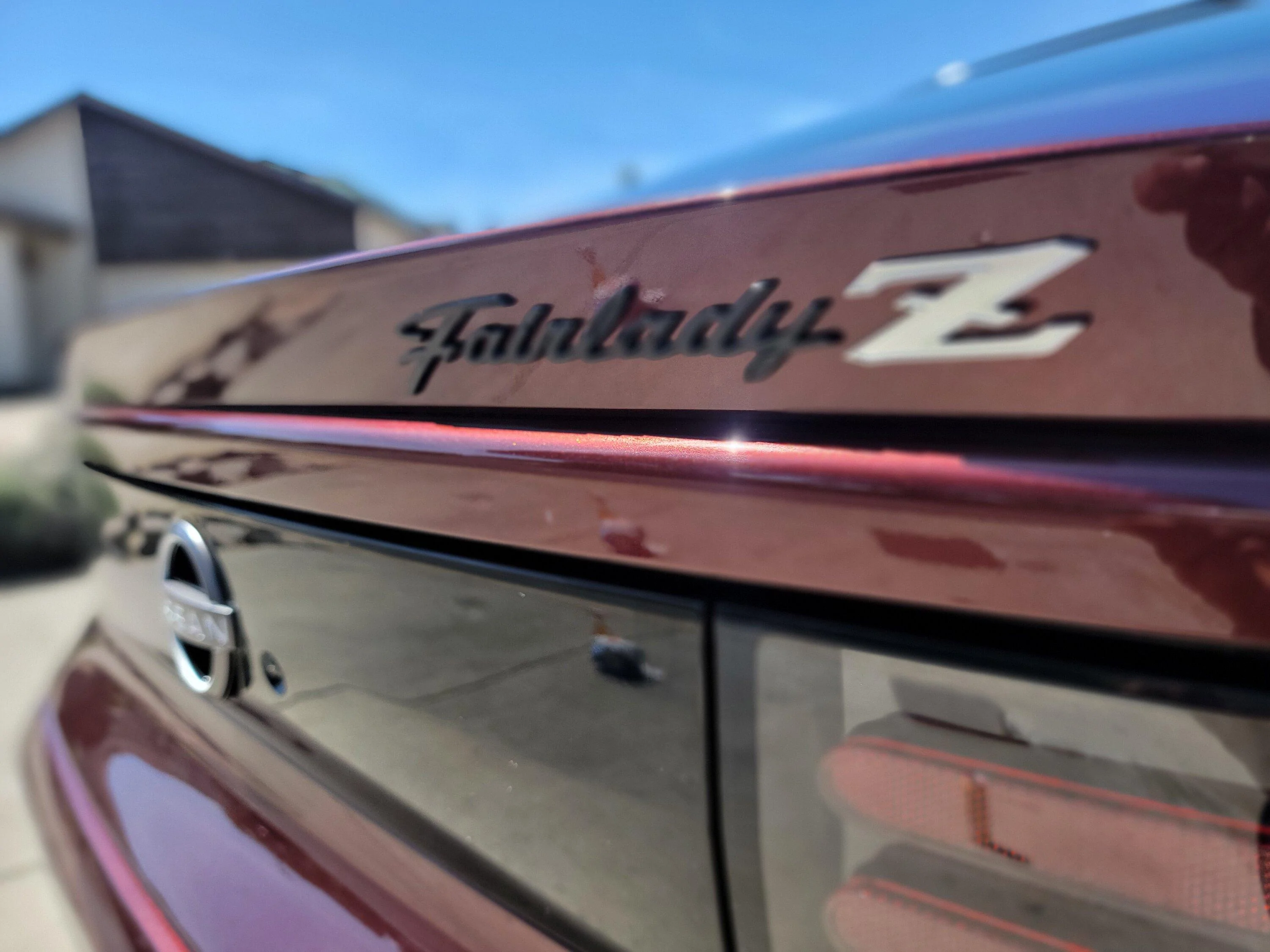

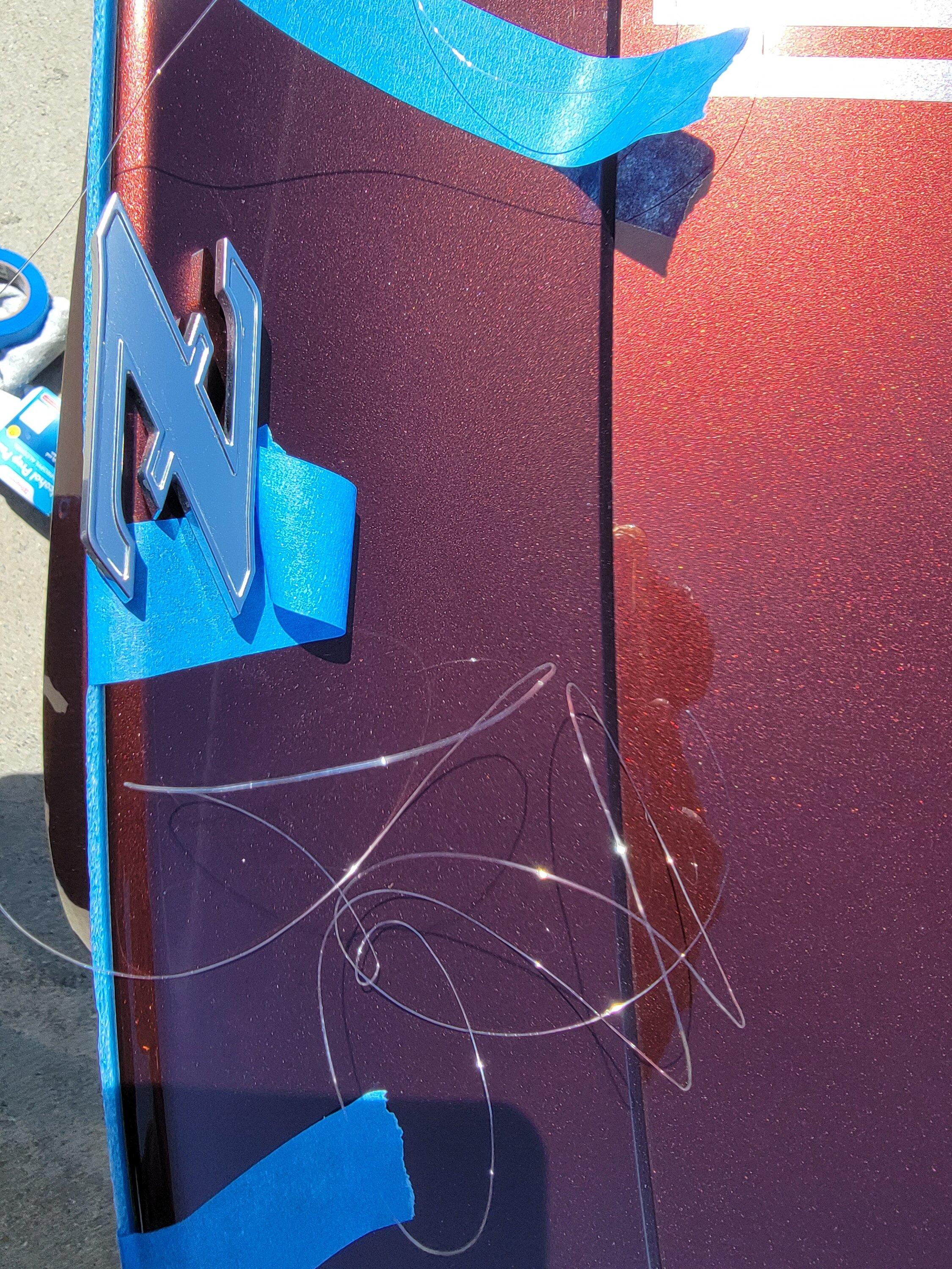

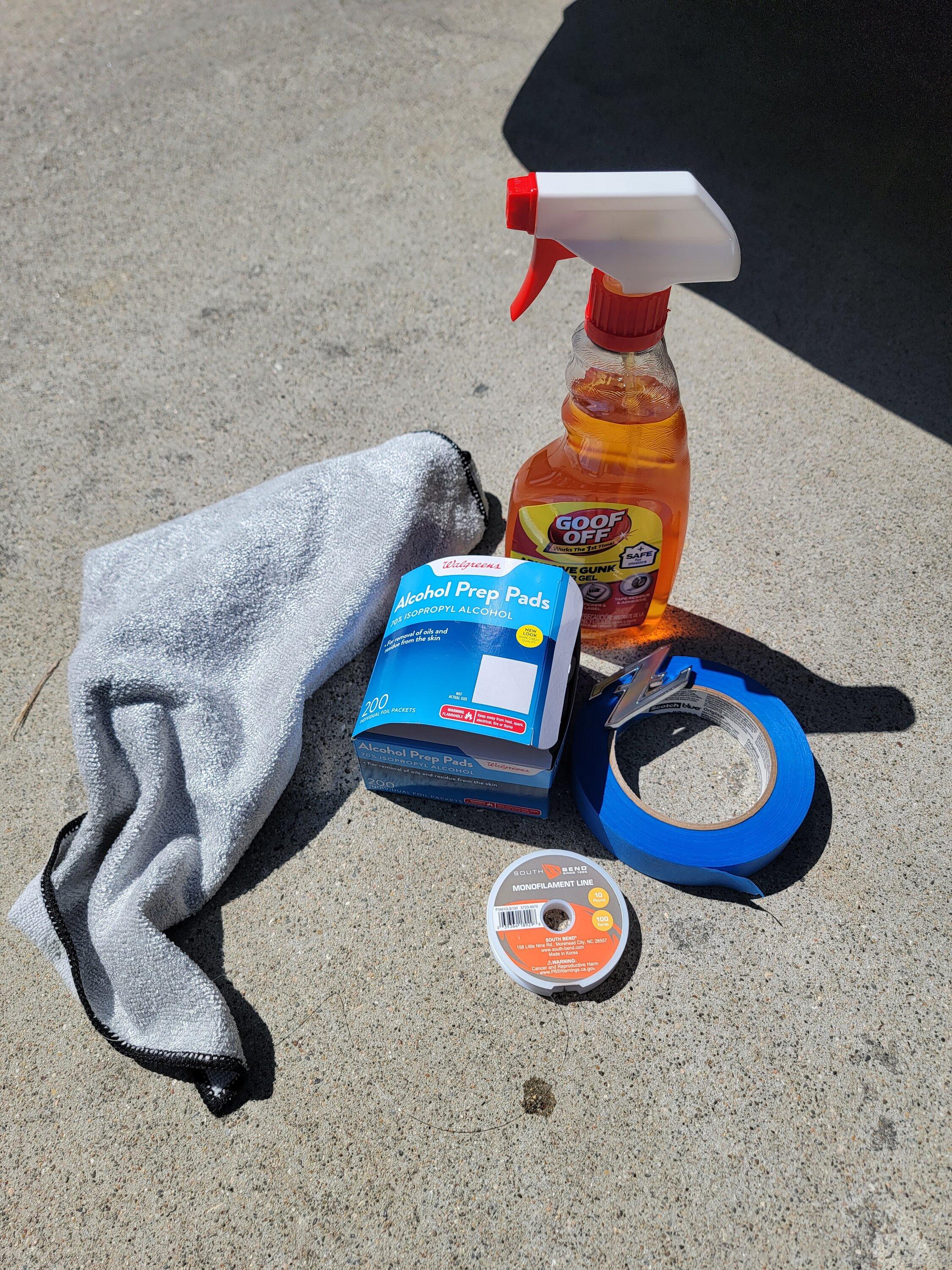

Finally got around to doing this. Took about 15 minutes. The adhesive on the Fairlady Z badge is really good. Removing the usdm Z badge was a cinch. A little fishing wire and a bit of goo gone and it was off without a trace. It's pretty sunny out so I didn't need a heat gun. All in all, the new badge is beautiful. I didn't think the black would go well with Rosewood Metallic but man was I wrong ???

I used a leveler to make sure the Z was flush with the ground. The fairlady part is intentionally not straight. The usdm Z came off super easily. What color did you get? Can't wait to see it.
