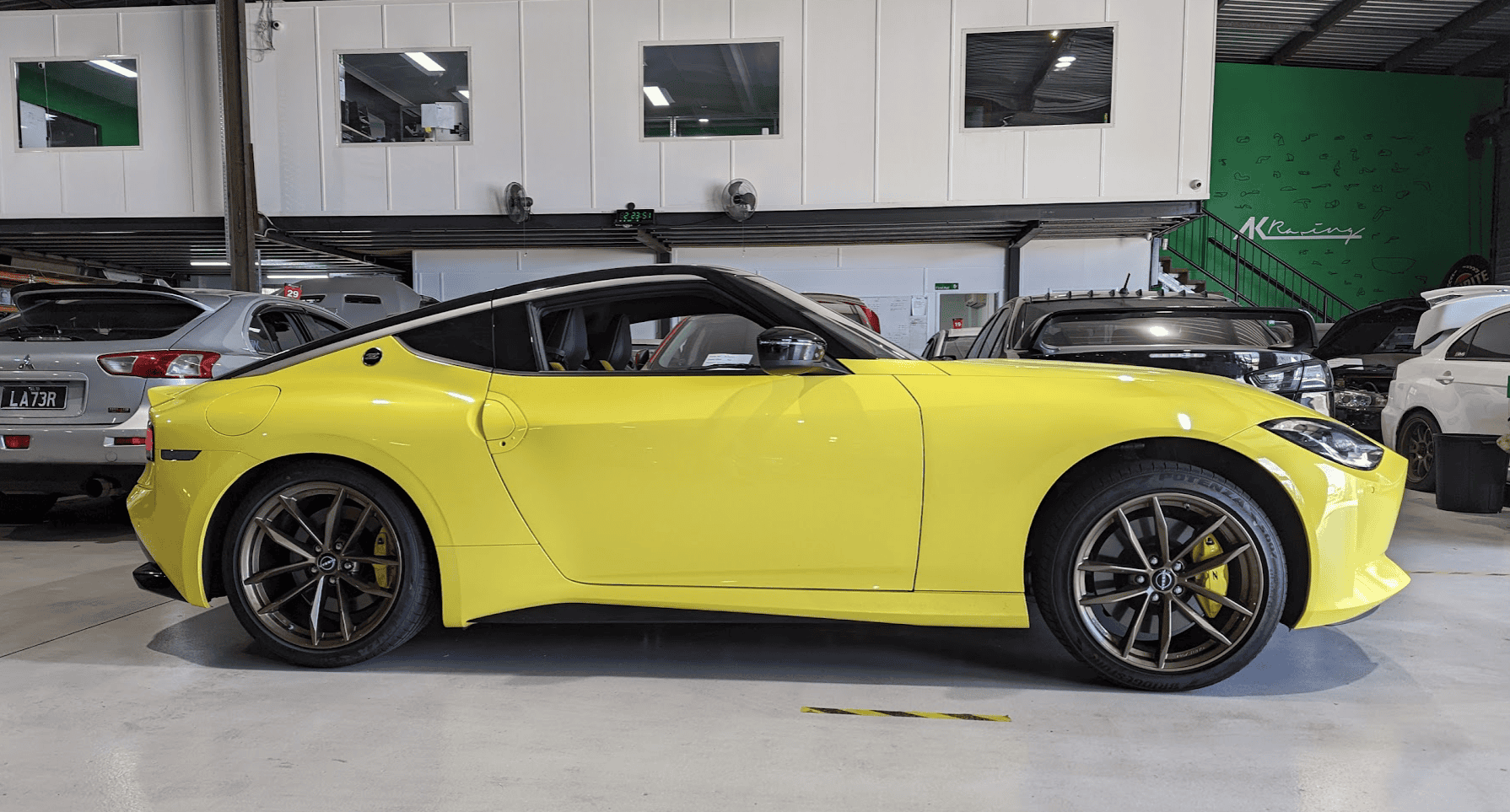

Anyone interested in what it might look like lowered - below pic shows 1" drop in the rear, and 0.5" lift in the front (air cups).
Seriously... don't try to lower without air cups... the black lips scrapes on ev.ry.thing.
OEM Rays fit perfect with 1" drop. Would recommend 15-20mm spacer to fill out the guards a bit. Illegal here :(

Stock wheels look dope AF slammed... just wish they were 3" bigger

I don’t like the slammed look but want to lower it. Maybe 1 inch in both front and rear?
The rear end in that shot is 1" lower than stock for reference.
Here is another shot of it with 1" drop (coilovers) with stock rims and street legal stance.
