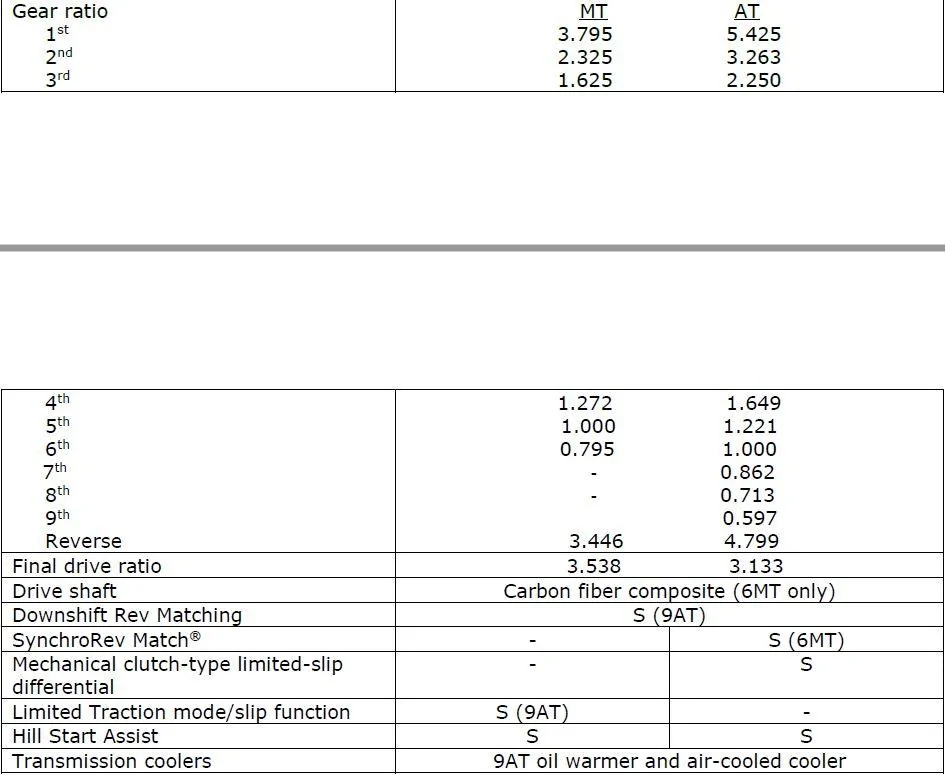

She got the final drive ratio incorrect, the 3.133 is for the 9 spd auto, the manual has 3.538 rear end gearing.
Do you think "final drive" is really the differential ratio? In that case, I did the following calculations, to estimate the engine rpm at 70 mph:
AUTOMATIC:
70 mph * 0.597 (top trans gear) * 3.133 (diff gear) * 336 / 26.6 (P275/35R19 tire) = 1,654 rpm
MANUAL:
70 mph * 0.795 (top trans gear) * 3.538 (diff gear) * 336 / 26.6 (P275/35R19 tire) = 2,487 rpm
Looks like there is a significant difference in highway cruising rpm, when comparing the automatic to the manual equipped Z.

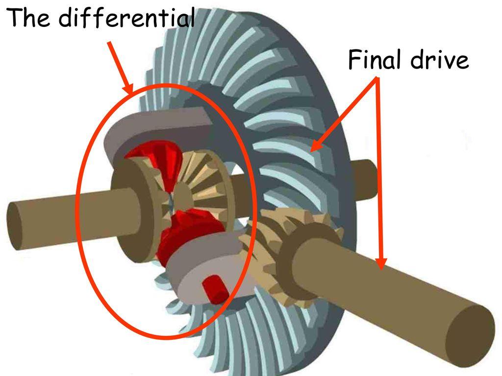

ive seen where people comment or questioned this over the years...is there a straight answer? no pun intended
