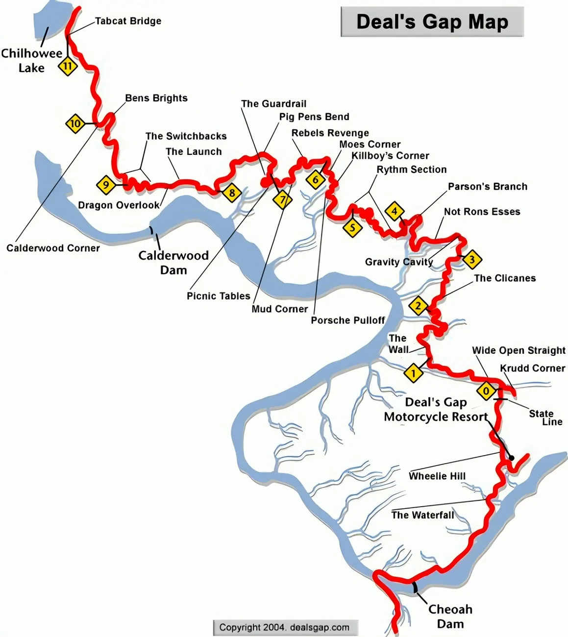

Most riders are in 2nd to 3rd gear through the twisties. I would imagine it'd be similar in a car run. Granted I've never been, but have watched videos & reviewed maps. AT switches back to auto mode without continuous input. MT would be easier, esp for a non-track driver.
The Tail is a different animal, several lives lost, many baggers in the ditches over the years
