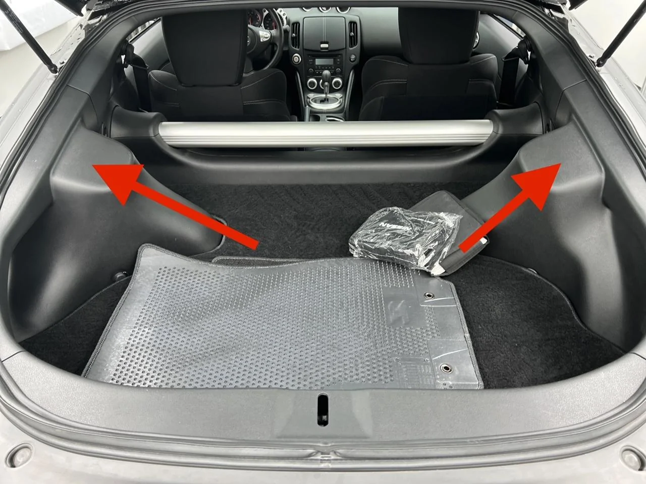

The knobs will be located under the shock tower humps in the back. These are large trim pieces, look like a pita to remove.

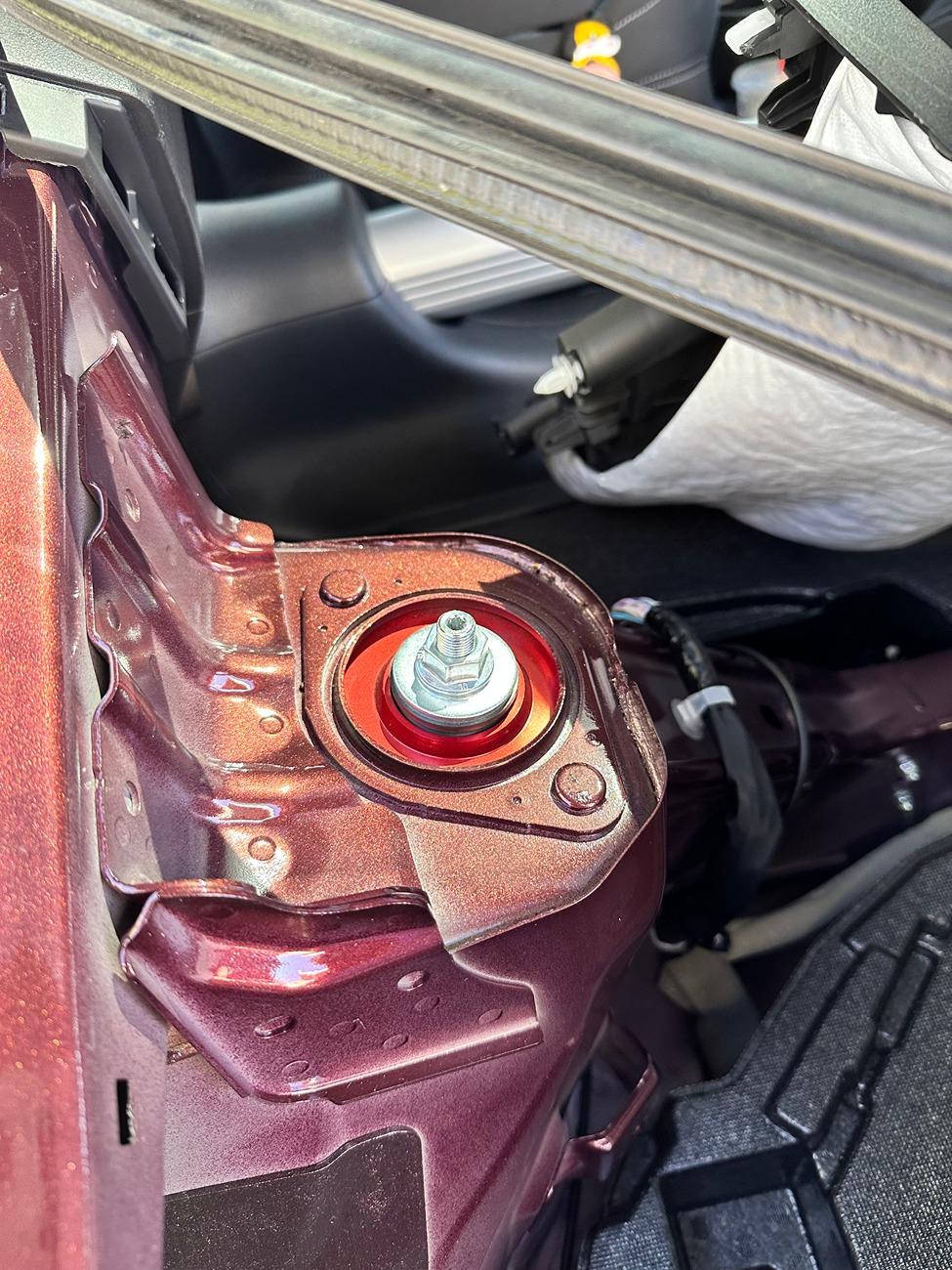

Finally I got time to check this out. I tried to remove the plastic piece and exposure the shock tower top. It doesn't look like a knob that I can manually turn :crackup::crackup::crackup: I feel that the knob actually is under the tower, which I'll need to jack the car up and remove the tire lol
