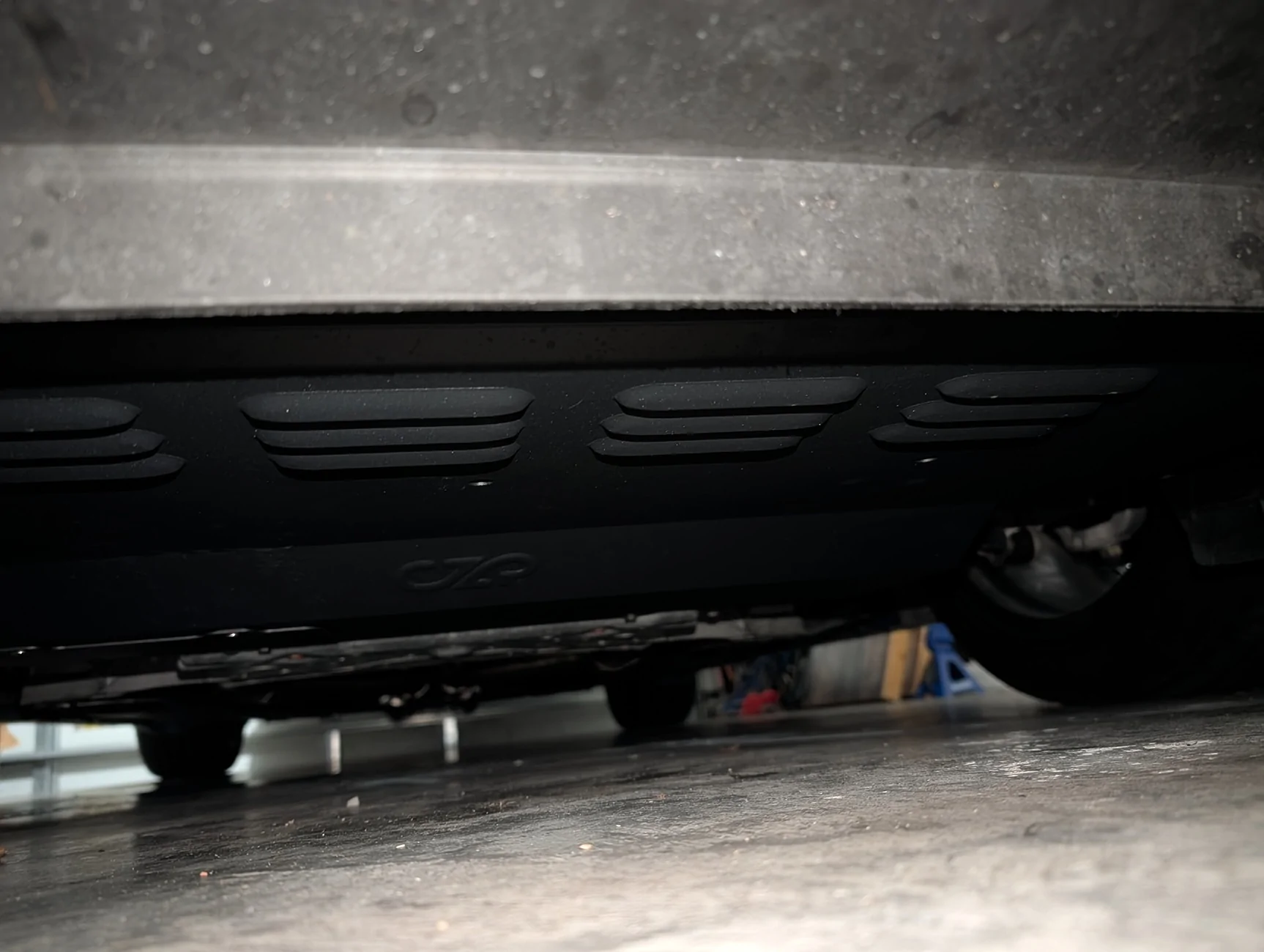

The vents are angled back so never have had leaves stuck in it. Added photo, don't think they are that low. My exhaust hangs lower than I wanted and is my low point not the shroud
