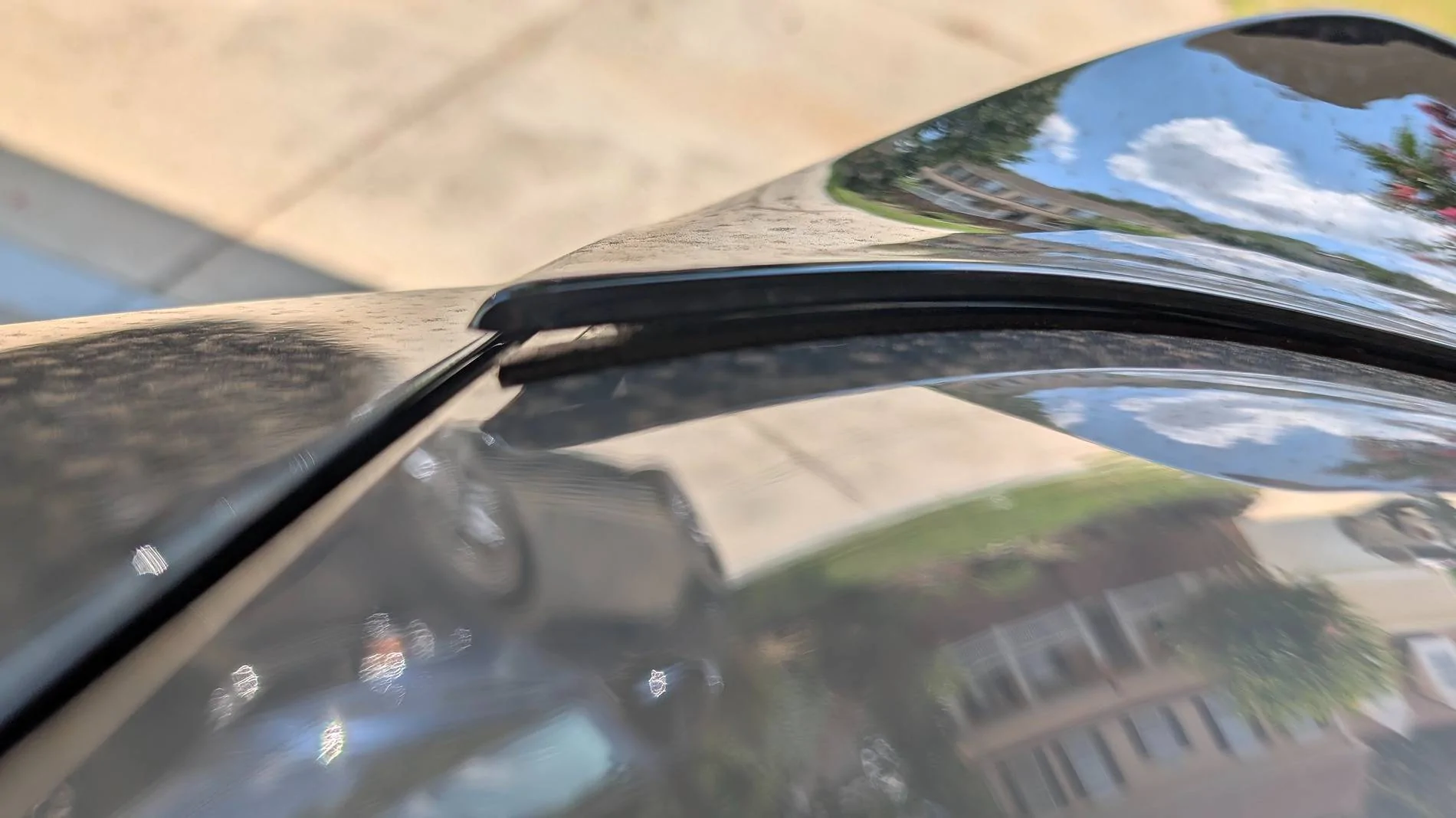

Since it's already lifting, try using a hair dryer or heat gun and see if it just lifts off entirely. Or else you may try to use some fishing wire as well to separate the tape from the paint.
As this is only a few months old, I would imagine it will come off pretty easily.
Good suggestion! Thank you!
  • Like
Reactions: C89
raceheart
Sep 28, 2024
57
122
New Jersey
Make sure you pull up and sideways on the fishing line. Do not rub on your paint or you will scratch it. Ask me how I know.
If you are in SC do it in the sun on a hot day this summer. The hotter the day, the easier it will come off.
Also clean off the old sticky areas good. I use acetone. Many use goof off. Get rid of your old tape and go to home depot and buy this.
https://www.homedepot.com/p/Scotch-...ed-Extreme-Mounting-Tape-414-LONGDC/205507375
I have used this for years and nothing ever came loose. The tape they probably gave you is cheap Chinese knock-offs.
Also clean off the old areas good. I use acetone. Many use goof off. Get rid of your old tape and go to home depot and buy this.
I have used this for years and nothing ever came loose. The tape they probably gave you in cheap Chinese knock-offs.
This is awesome, you are awesome. I will do just that. Thank you!! I used some kinda cleaner on my GT-R paint and ended up with a weird discoloration but I am assuming acetone doesn't do that? I will try goof off / goo gone and if no luck probably try acetone

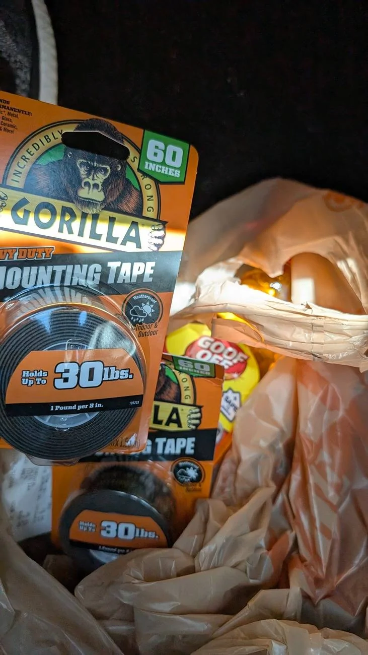

I ended up grabbing the gorilla tape instead because it said weatherproof vs the other one saying weather resistant. It also had a wider temperature range (I think) listed on the packaging that goes up to 240*F so it sounded better to me.
Plus that woman that went viral who used gorilla glue on her head made me rofl so I just had to support the company

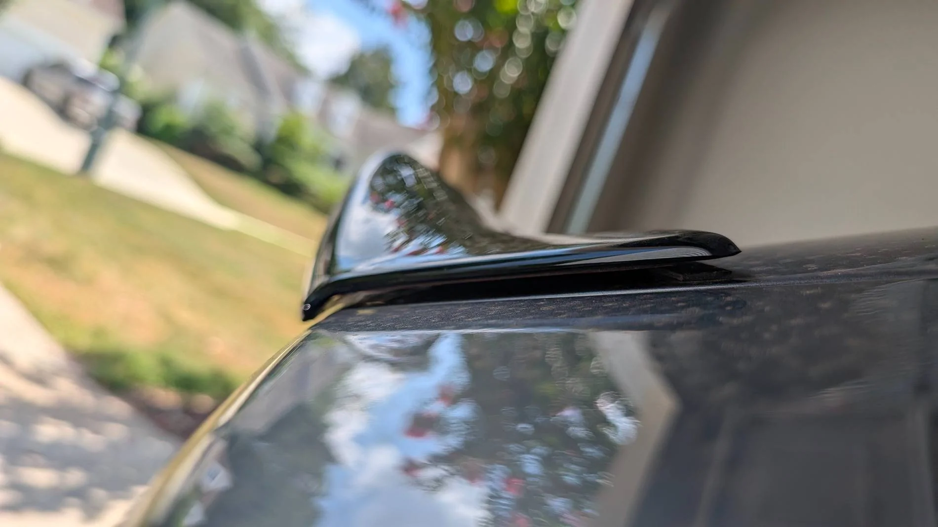

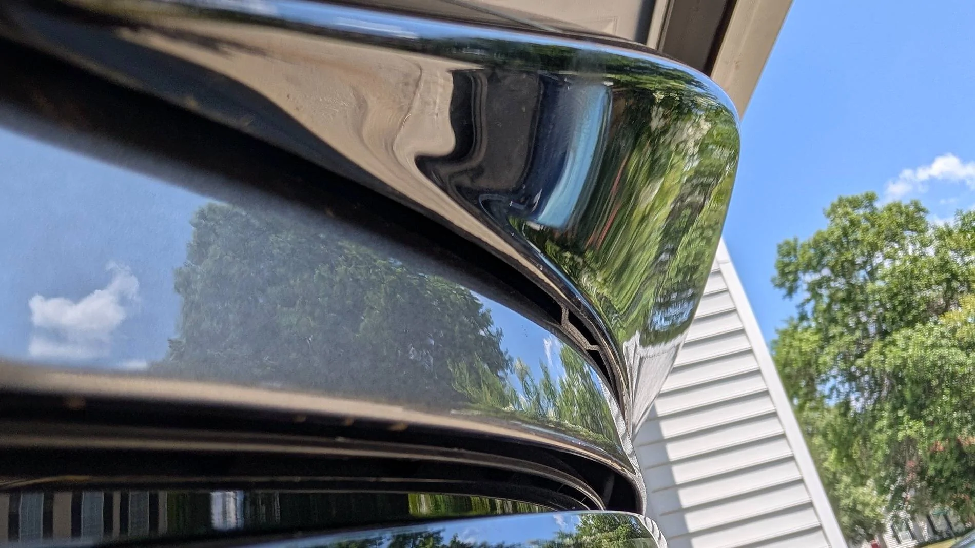

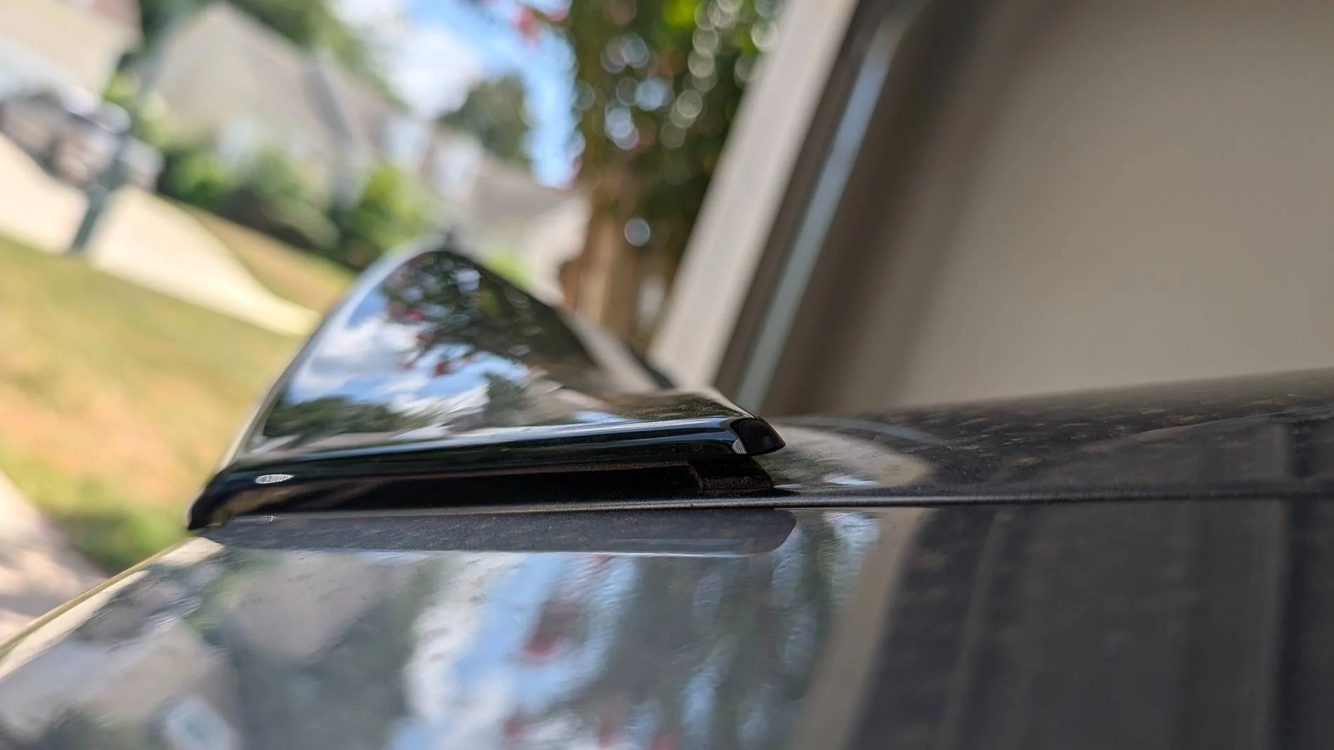

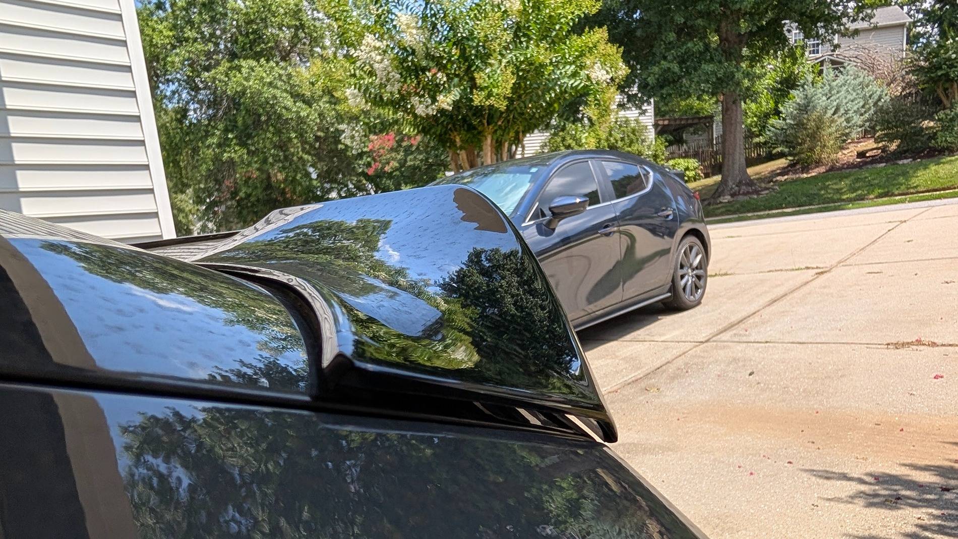

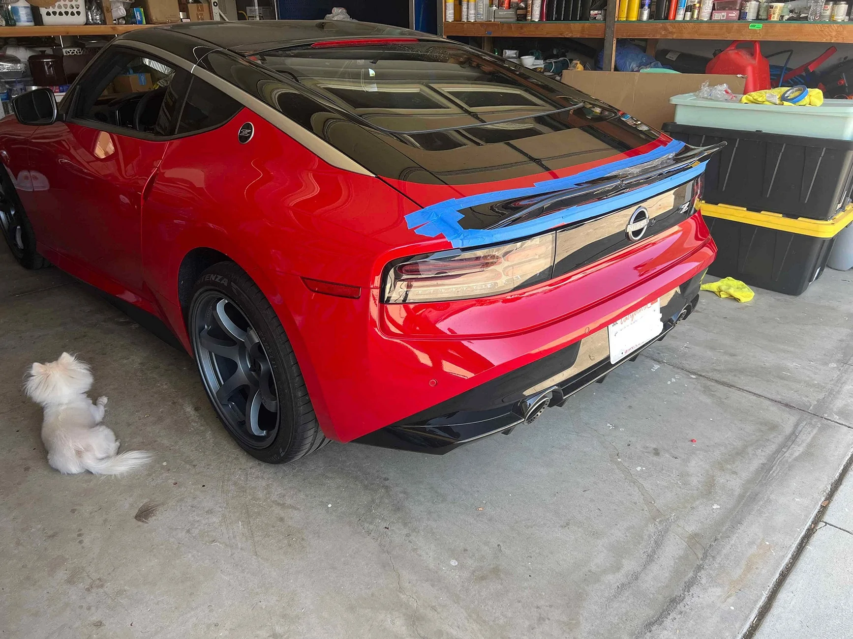

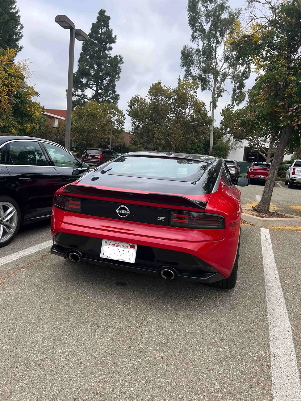

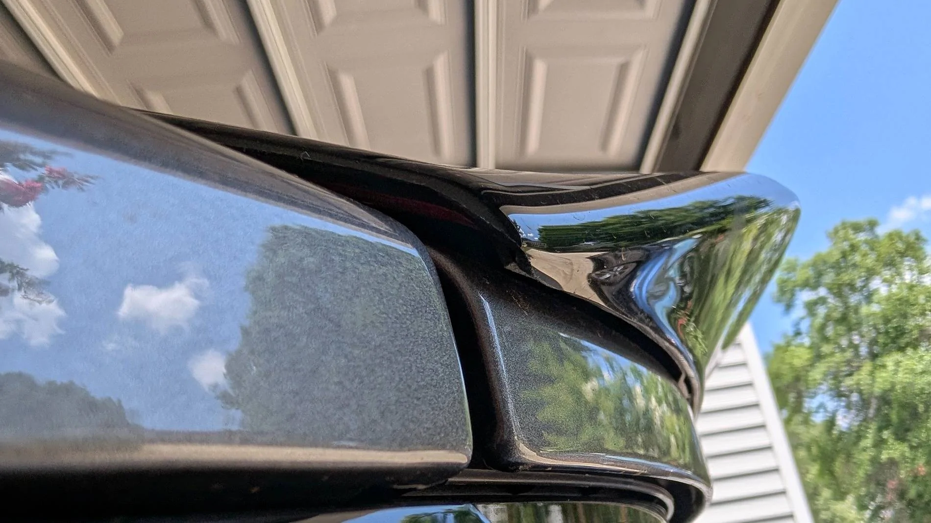

Here's some more pictures. I took them in the garage so it's kind of hard to see. Can take more tomorrow outside if needed. It looks WAY worse in the sun

Since its lifted, I don't think its that bad to remove. I removed the spoiler from the Miata and it did have scratches. I ended up reinstalling the spoiler and sold the car.
Btw, I have installed and removed several spoilers.

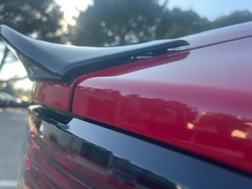

Add another one to the list. The passenger side corner of mine is lifting up after about 3 months. Professionally installed, cleaned with alcohol prior, adhesive promoter, etc. Definitely will not be buying Z1 branded products again.
Once it gets bad enough, I’ll replace it with a different spoiler that hopefully covers any marks it leaves behind.
