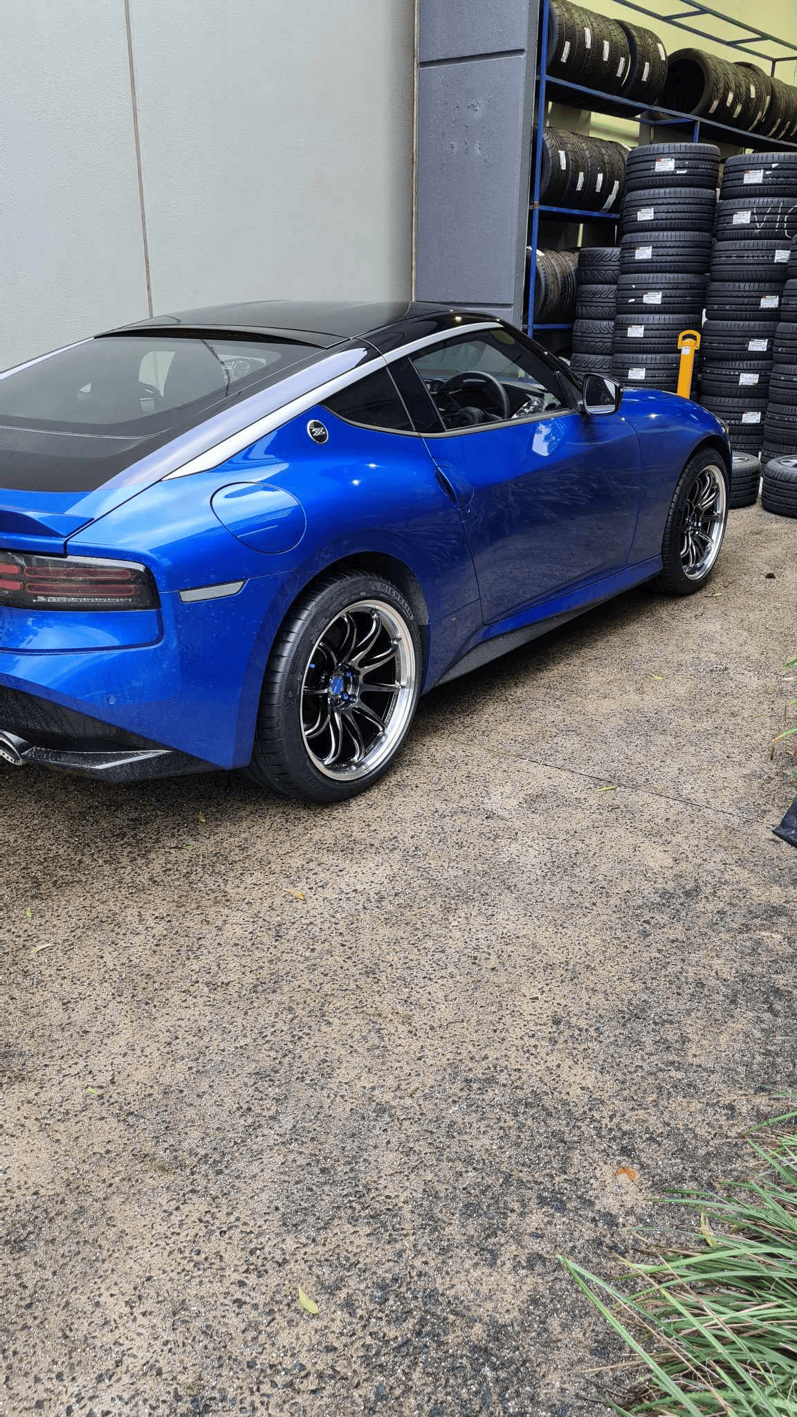

Had mine fitted this afternoon!
Question; what PSI did you put in them, and did you have any issue with your TPM after install? My PSI reading won't come up at all now, warning light just blinks for a minute then stays on. Thinking i've gotta take it back and get it calibrated.
Did you swap over the old sensors or get new ones? If you got new ones you'll definitely need to have them calibrated/ synced.

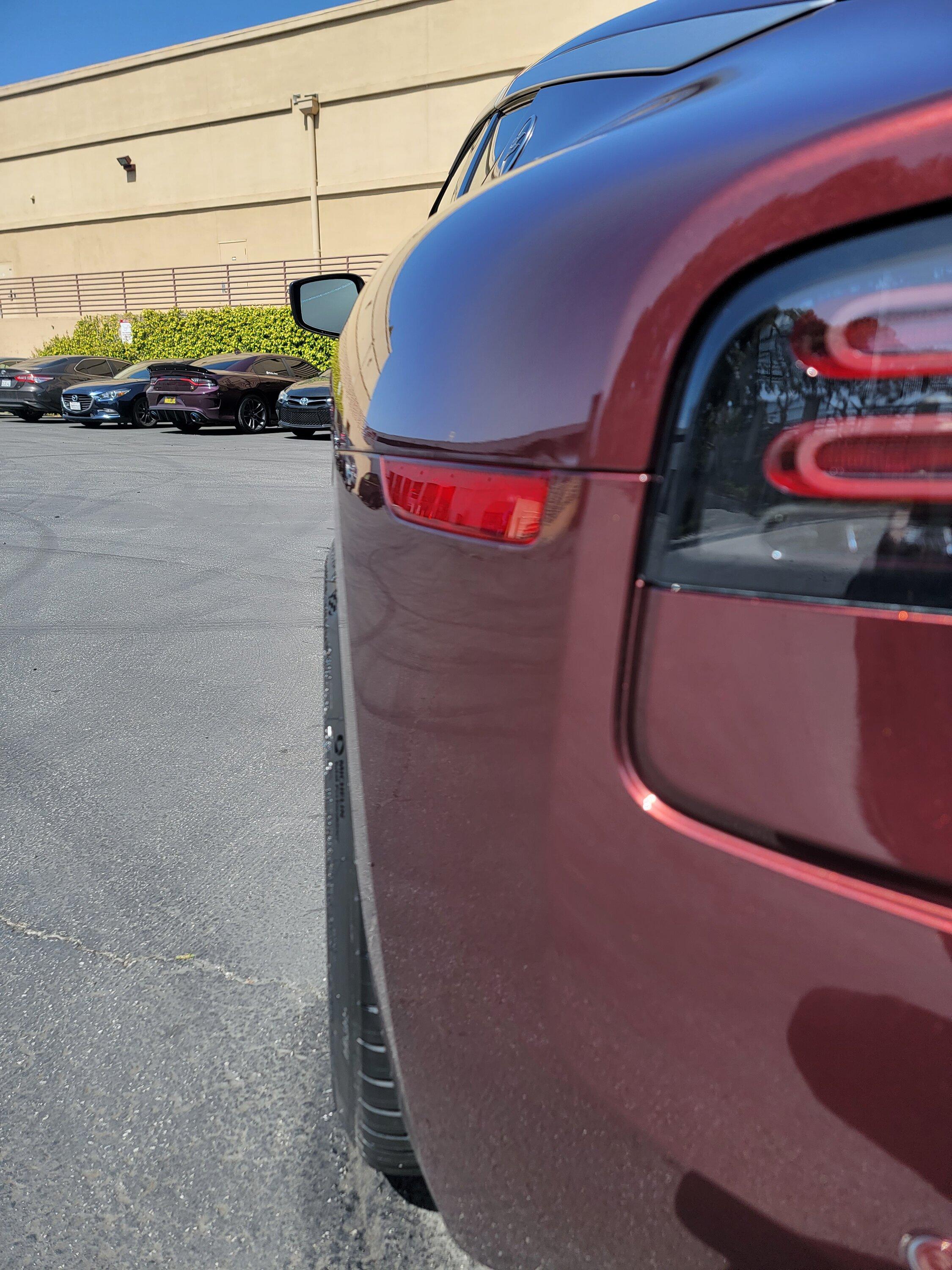

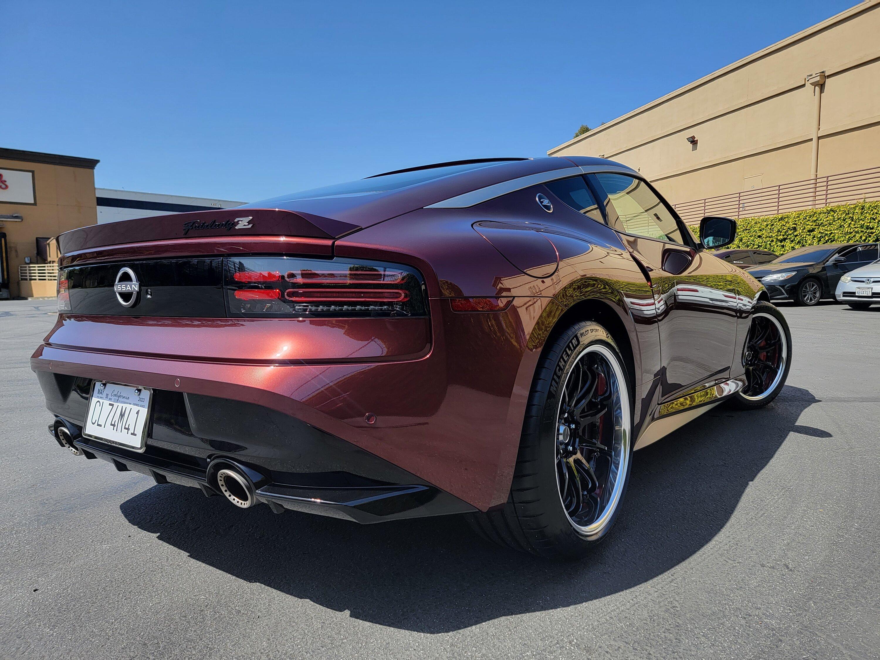

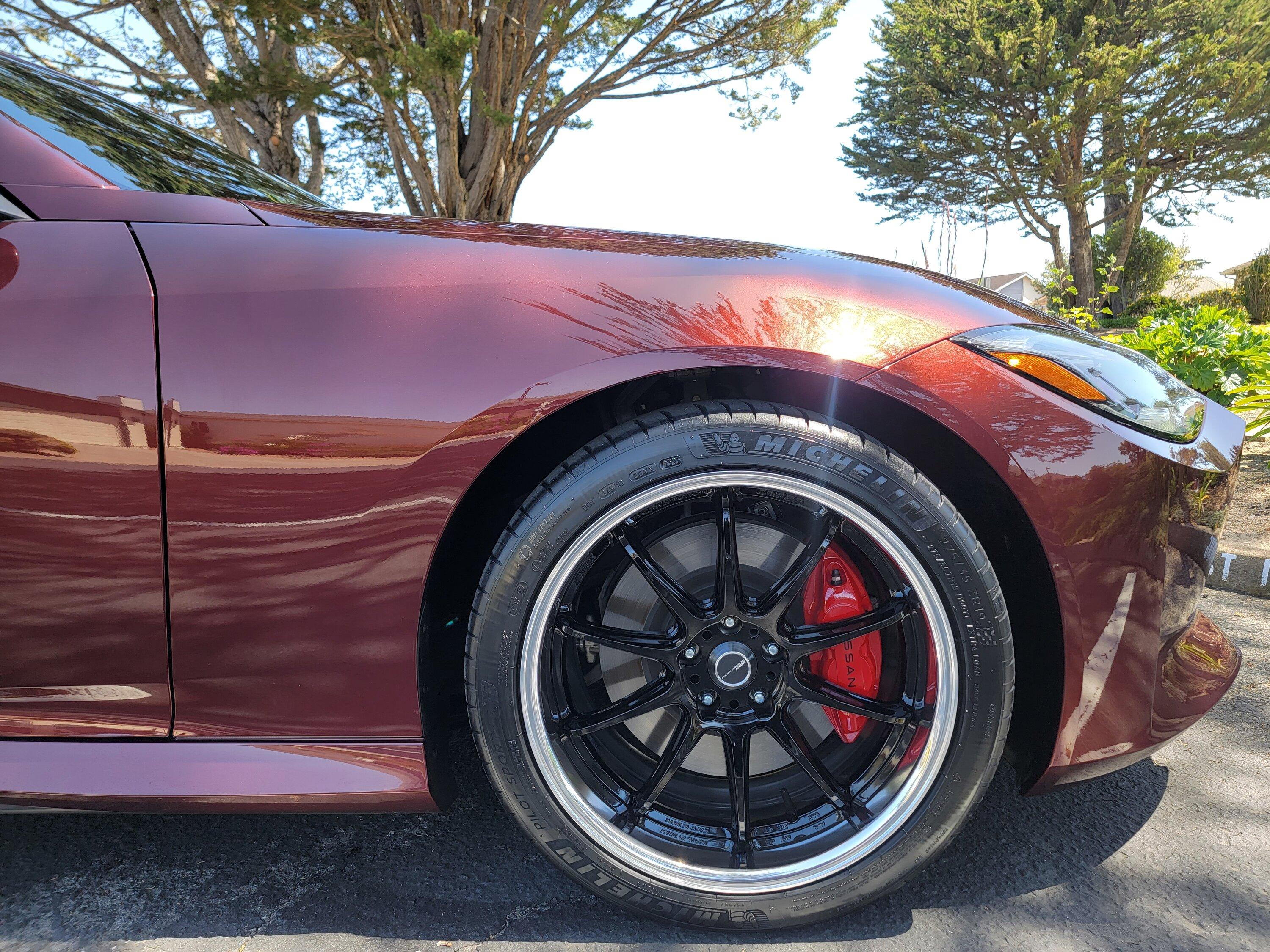

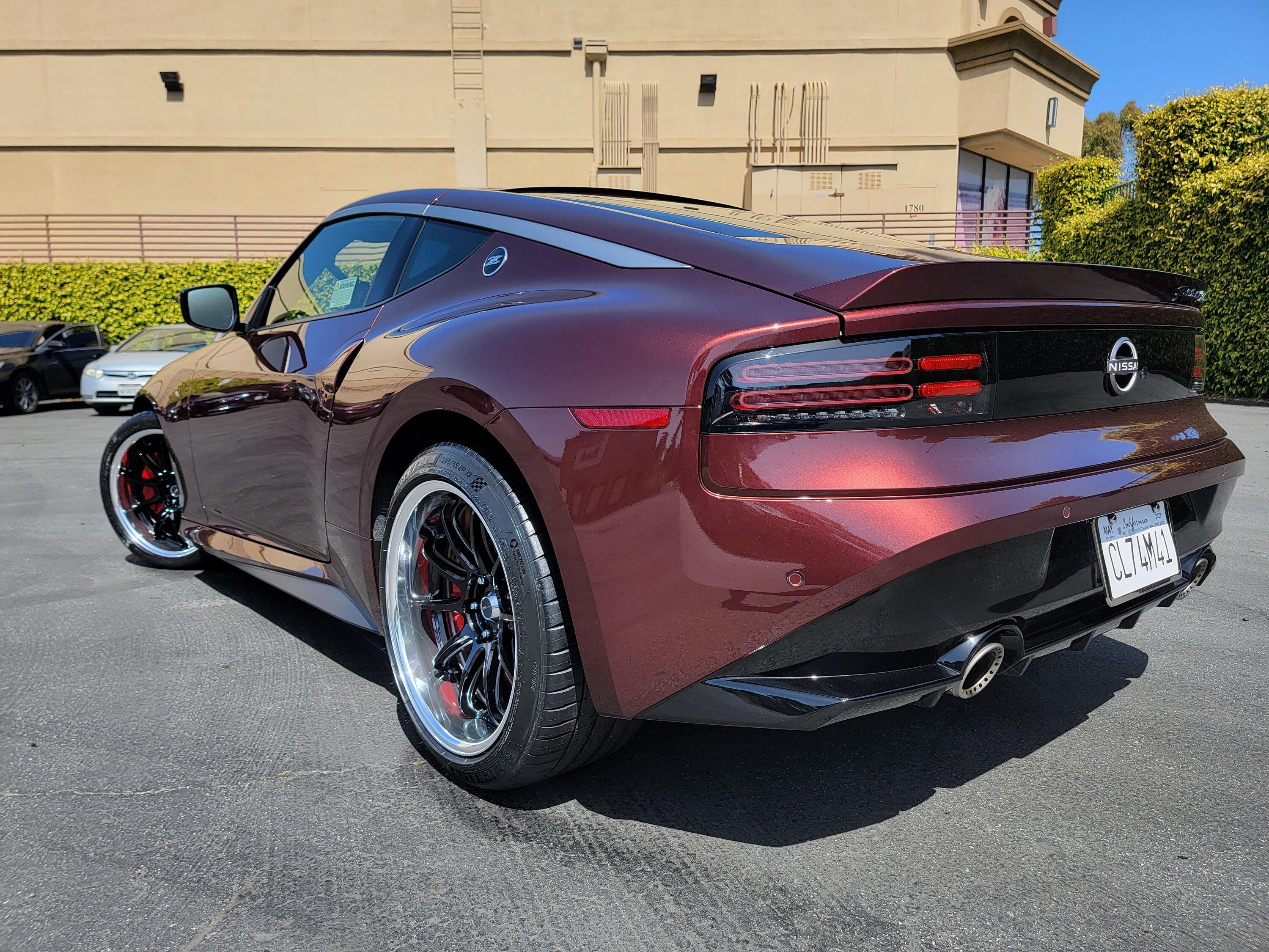

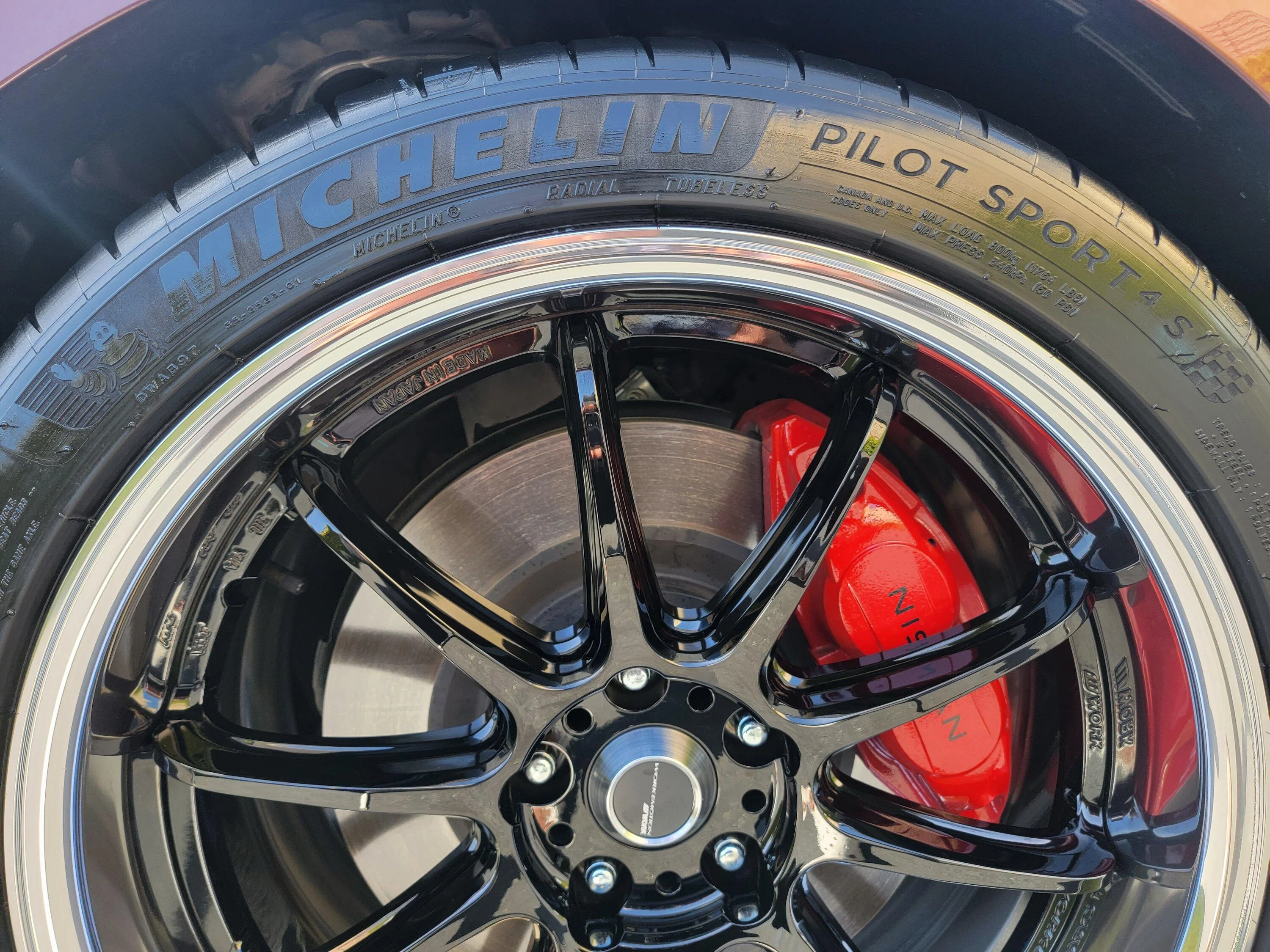

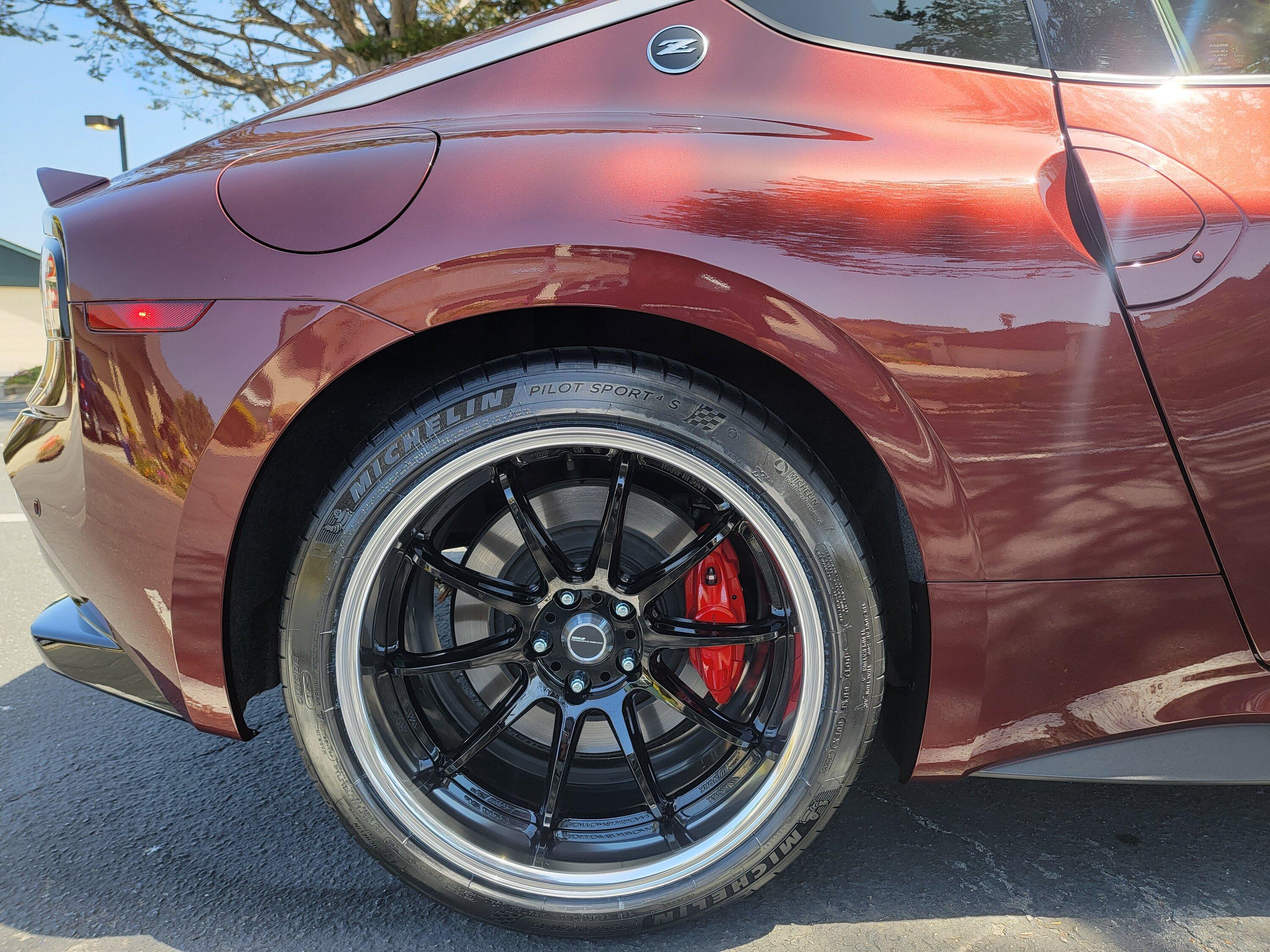

-Work Emotion Zr10 19x9.5+12 front 19x11+16 rear
-Michelin Pilot Sport 4 S 275/35 ZR19 (100Y) front 295/35 ZR19 (104Y) rear
The biggest complaint I've seen on the 2023 Nissan Z is the OEM tires. In comparison, the PS4S is night and day!! Super quiet!! Hook way better and substantially less tire spin. Almost TOO smooth. Highly recommend!!
I did go a bit aggressive and they poke out a tiny bit, so when I get them lowered this week, I will have to adjust the camber front and rear
What camber settings did you end up going with ?

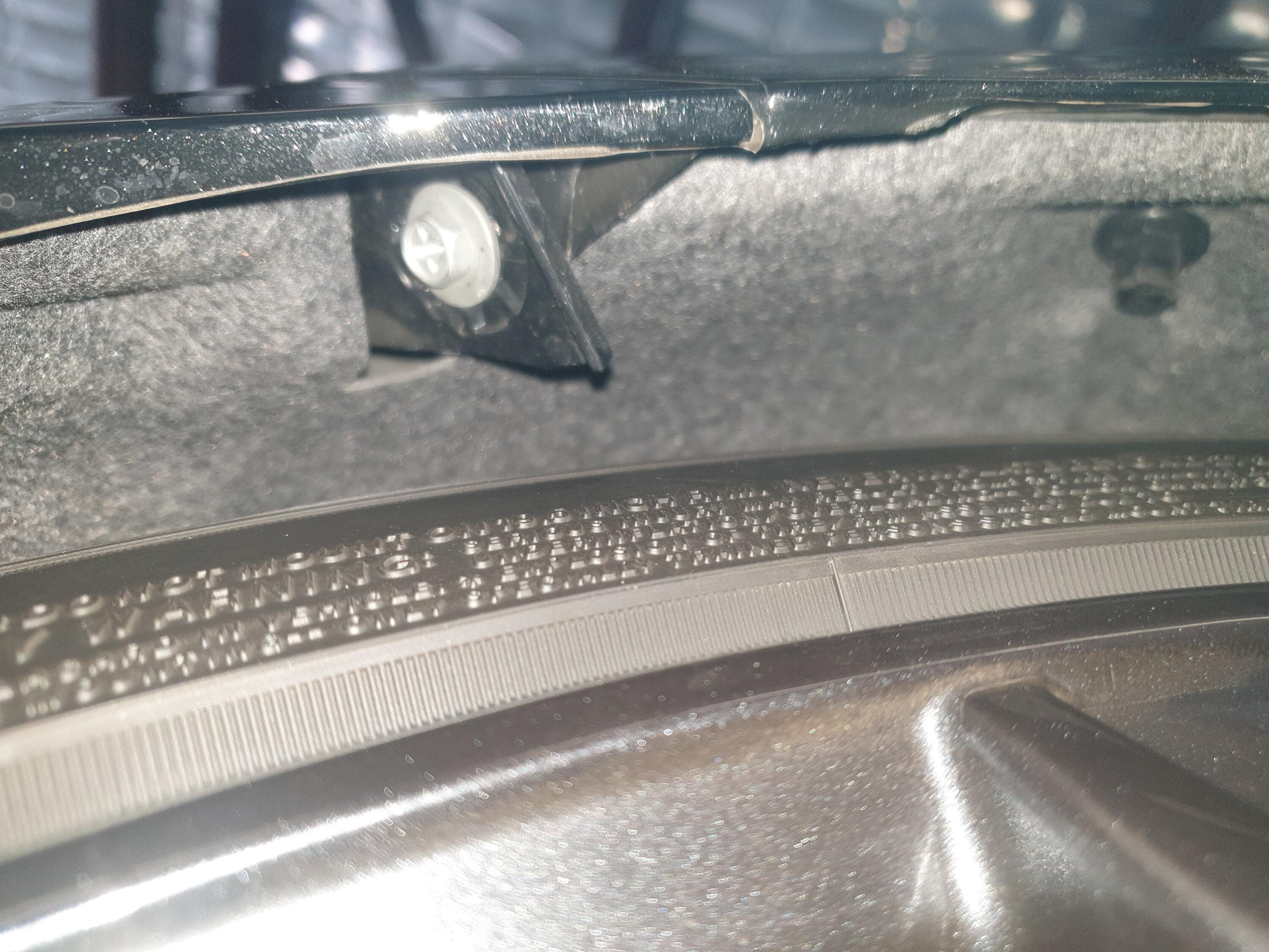

Did you have to trim this clip in the rear wheel wells? Looks like it would rub the tyres on full compression

Where are you guys getting these wheels from, looking for something similar with polish lip but not black. Any info will be appreciated.

Looks great!
Did you try OEM center caps or do you know if they would fit?

For my set up my rear tires are very slightly stretched, so I will be waiting for the Michelin Pilot 5 S tires to be released and I'll go 315/40. But these will do until then.
Your sizes are crazy. Congrats! I'm about to buy the same wheels (TODAY) and I'm looking at the PS4S for the front I'm looking at 265/40/19 is the 40 too much? I maybe asking the wrong person lol

FYI - the 40 or 35 is the side wall aspect or what is commonly called the "profile" so a 265/40 is 40% of the 265 width a 35 by definition gives you a lower profile . Going 275 fronts and 305's rear (my choice) is pretty common and the car wheel wells handle NP (if not lowered). OP lowered profile on fronts from OE's 40 (a little more wall when cornering.
