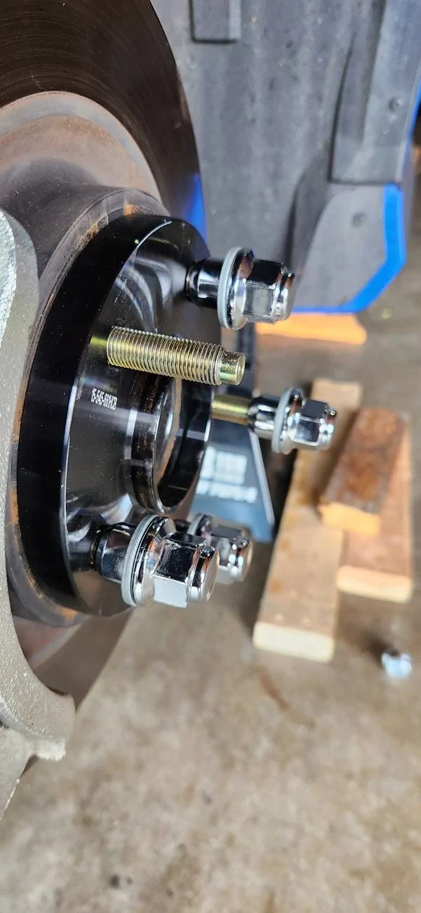

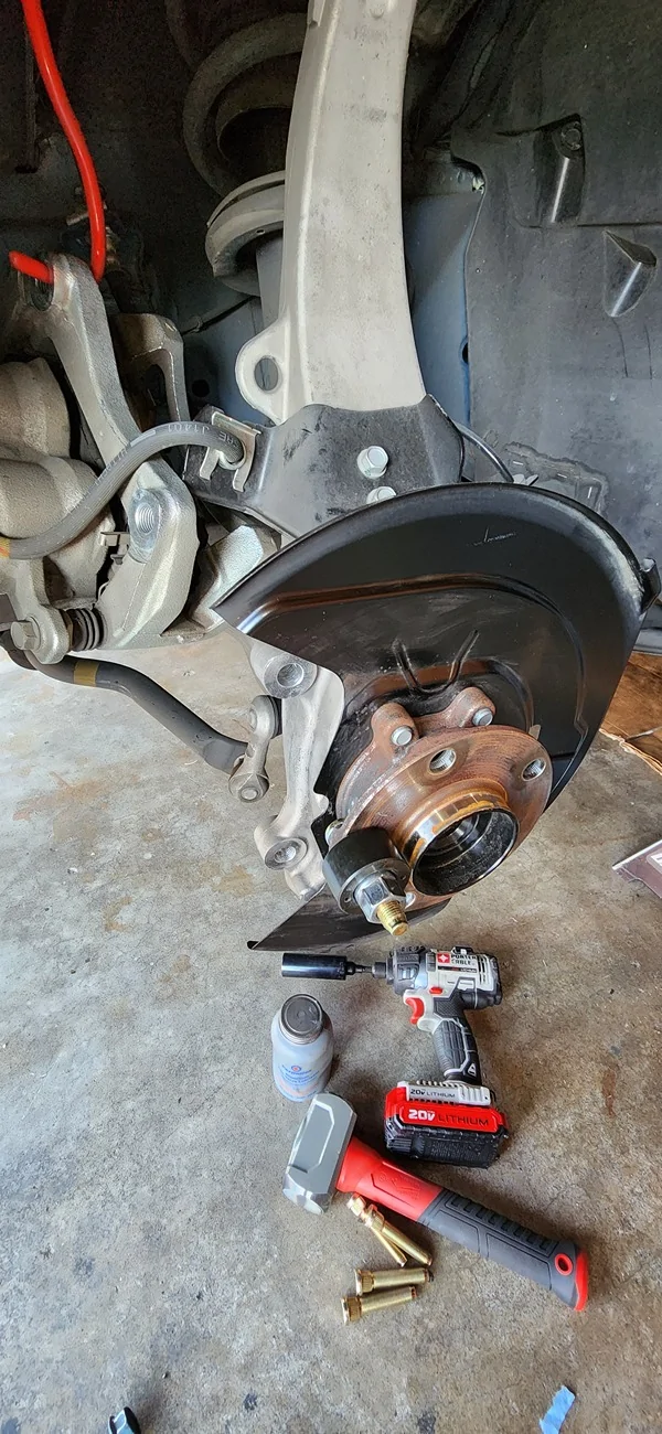

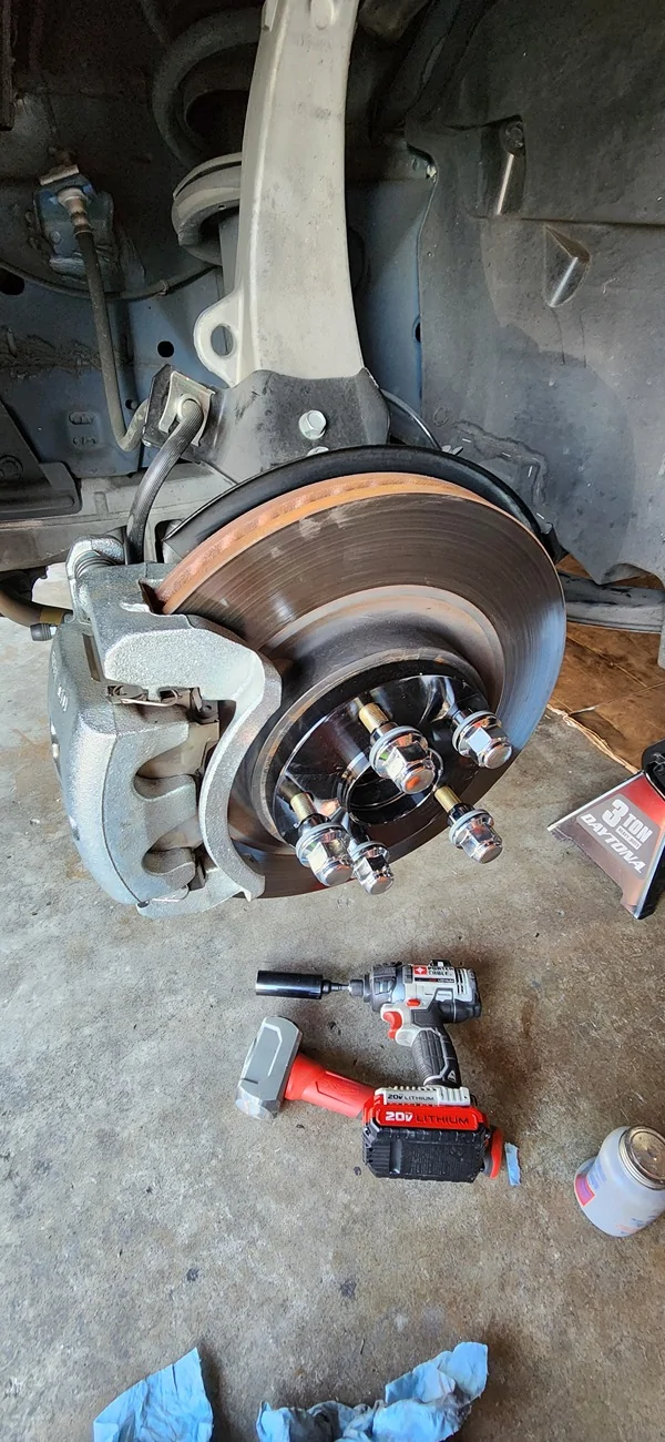

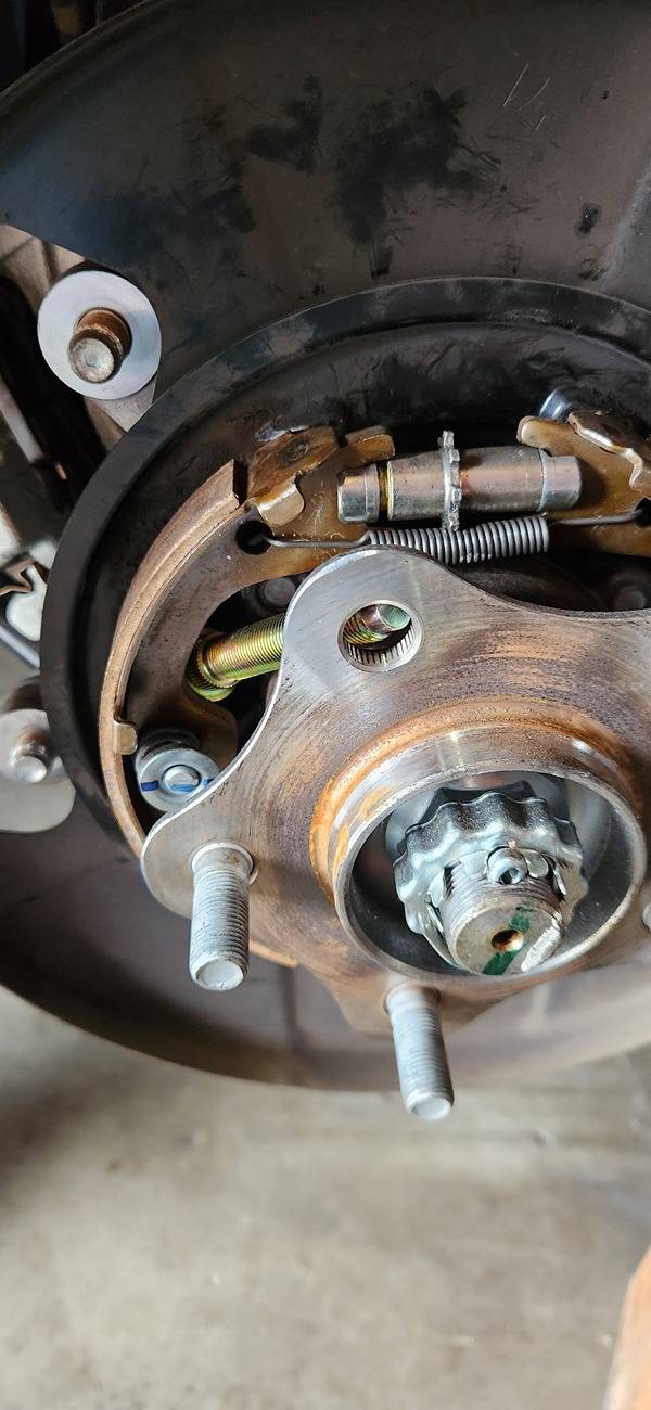

I was going to have a good day with a buddy installing extended studs today. Rears said, not today ?

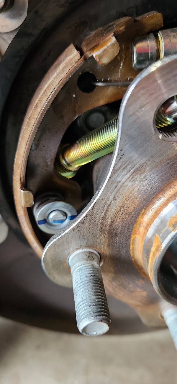

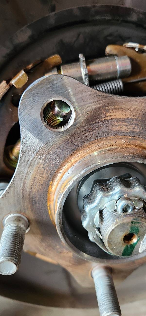

The dust shield being in the way didnt give enough wiggle room for 60mm studs to clear. Time to shave off 5mm for clearance
Fronts were the smoothest. Stock lugnuts will fit with 15mm spacers without bottoming out

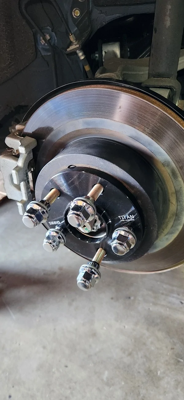

Finally got everything back together. The 60mm extended studs wouldnt fit the rear without removing the hub. I ended up ordering 50mm extended studs. They fit without taking apart the Ebrake or removing the hub

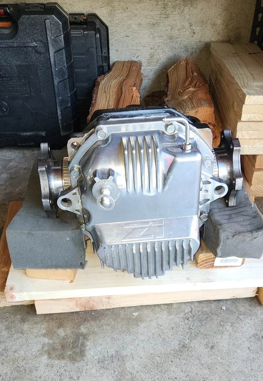

Thanks to @Mugzilla, the rear diff showed up in one piece. Now to find time to get it installed with the help of a friend. This pumpkin weighs 100 freaking lbs 😡
I have lifted BMW E46 M3 LSD diffs and they dont weigh this much.
