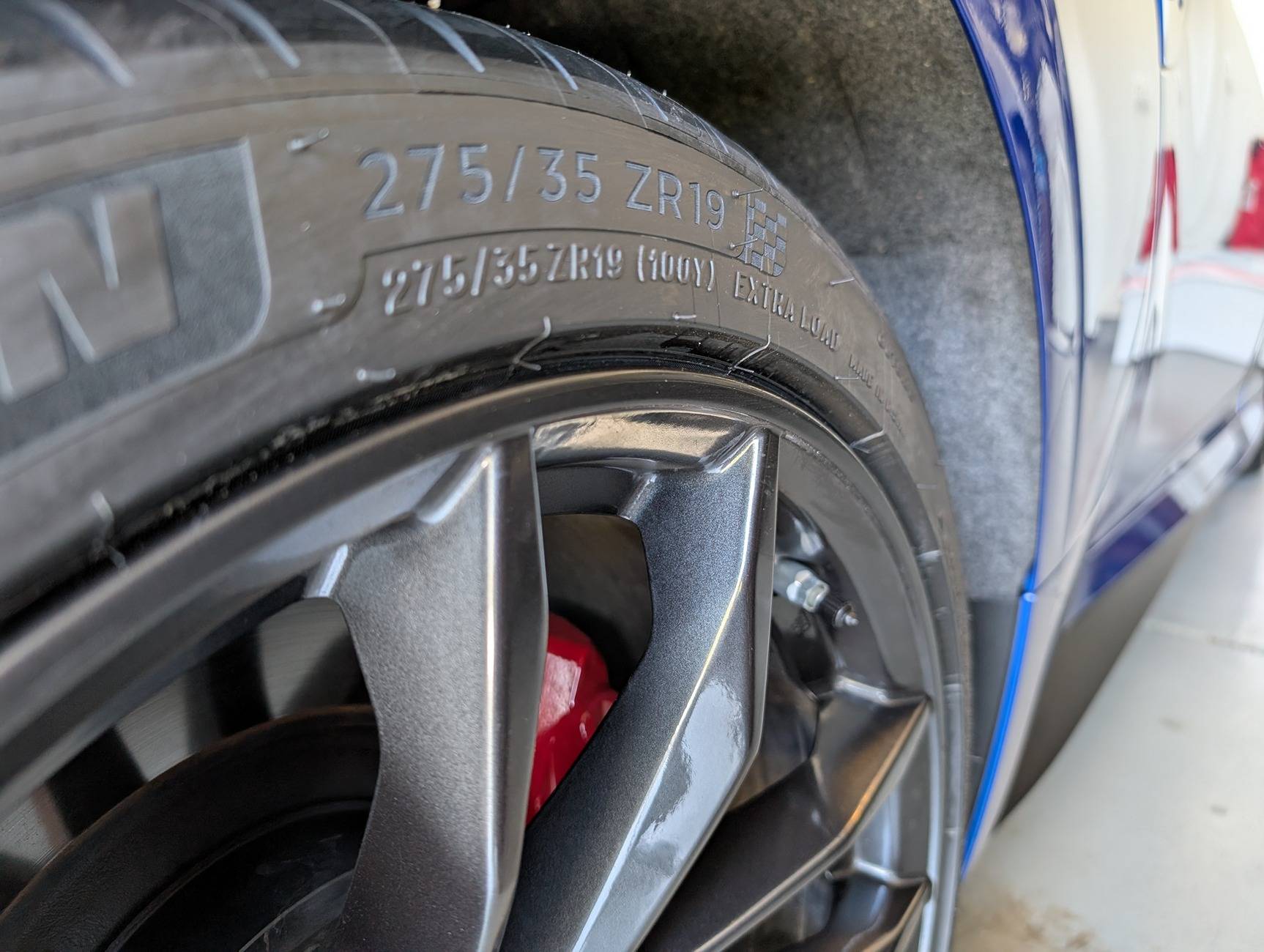

Wow that looks stretched you could easily put a 295 on there.
Maybe next set.
It's actually not as stretched as it looks in the photo, I think the wide-angle lens distorted it a bit.

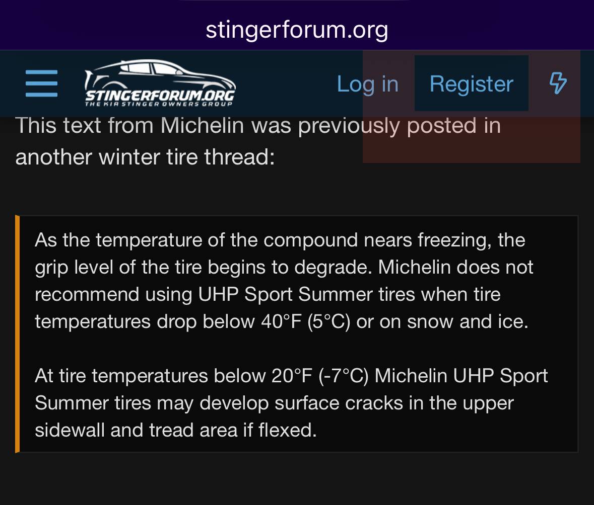

I recommend any driver of PS4 tires who drives below the temp cutoff on the summer version to get A/S. You will be very happy. However if you track your car, or have public roads that you safely max the tires out, I’d run the Non-A/S.
I can’t find Michelin’s stated specs, but while looking caught the below photo in a Stinger forum. This supports my understanding as well. I would not trust other brands to state a 20 F figure that low, be careful. I also think when they say don’t operate under 40 F, that 50 F is for your family driving your car, and 40 F is for the one who knows the car well.
My temp observation on the summer tires is that at 55 F on cold tires you either need to warm them up or be careful. At 45 F on cold tires your traction is so lost that I was able to spin the tires and do a 90 onto a main road from a stop to be quicker. lol! Total death trap. At 32 F I think you’ve damaged the tire, but Michelin may really say it’s 20 F. (FWIW I drove mine down to 0 F in snow and ice, but I have 36 years experience. I would never recommend that to anyone at all actually, but the tires will come through uncracked. Damaged? Probably. I didn’t push it.
I had to give my 1st GR86 100-mile summers with my 2nd GR86 to the dealer when I traded it in on my Z because of guilt that the summers I drove all winter in the 2nd one would kill someone. It’s serious stuff.
