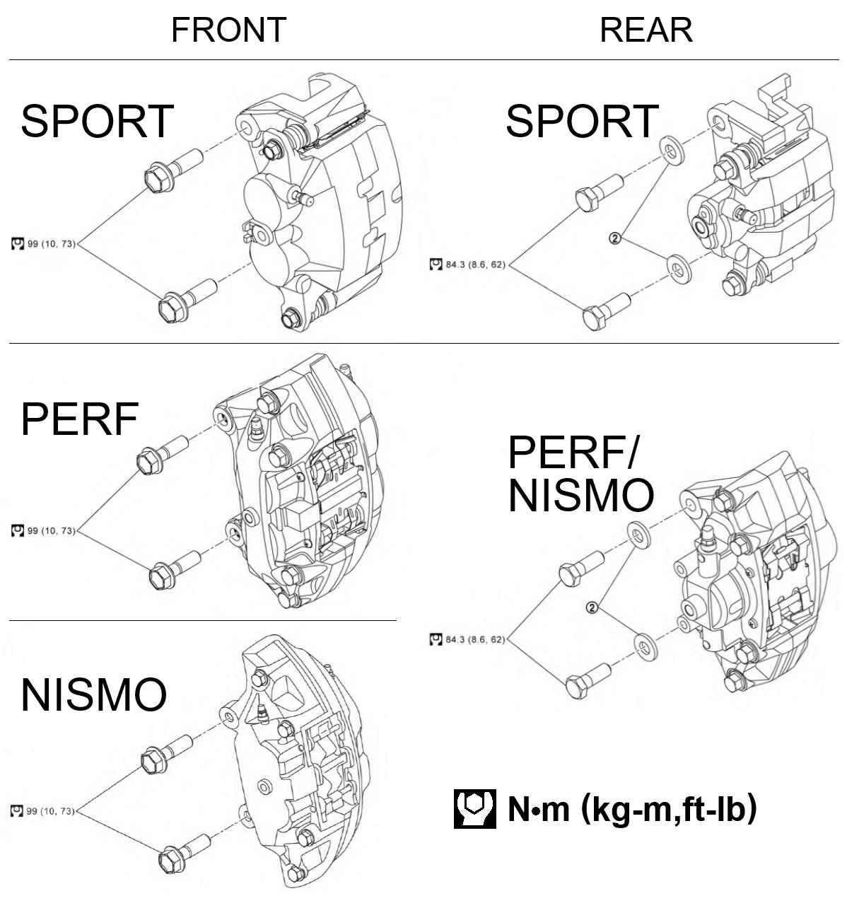

What are the torque specs for the front and rear brake calipers (performance)?

Thanks!
hmm, maybe the service manual I have is missing this. Could you post yours?

It was in one of the two files here, and OF COURSE I dug through the one that didn't have it first.
I wrote down 90, 110 and 118 as page numbers. Check one of those, and if it isn't what's on my image above switch to the other file.
Both files are sort of odd. They don't seem like full organized service manuals. And they're definitely not indexed. More like compilations of chunks of the service manual. Still great to have.

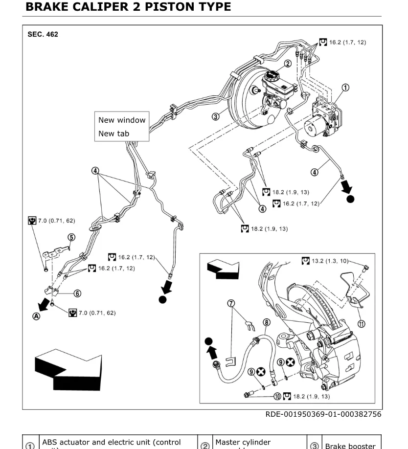

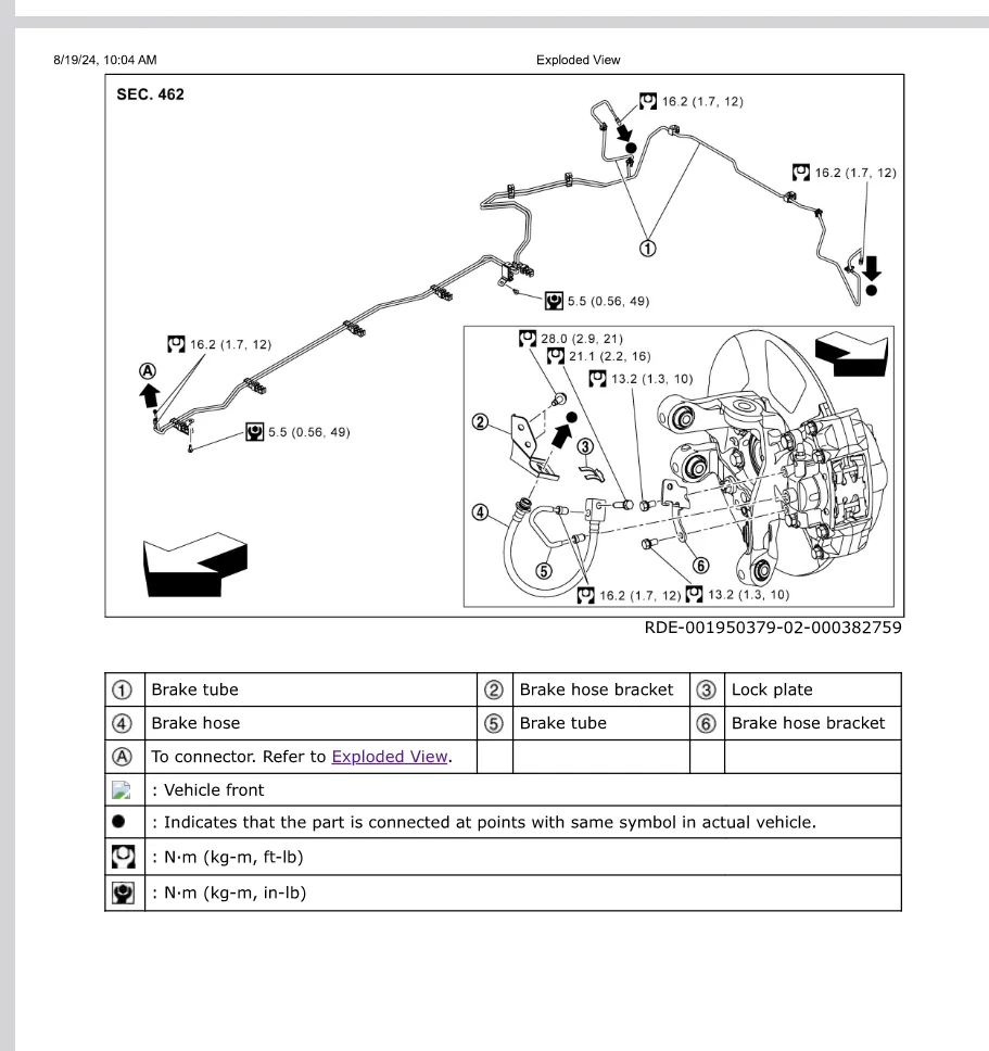

I might genuinely be retarded then. I can't find the page with the images you posted in the service manual.
I only see these views for the brakes (both front and rear)
