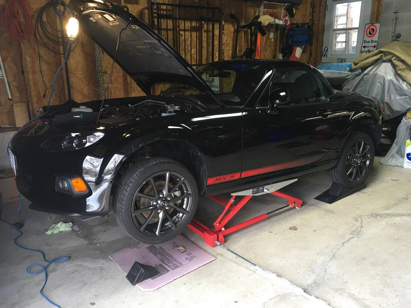

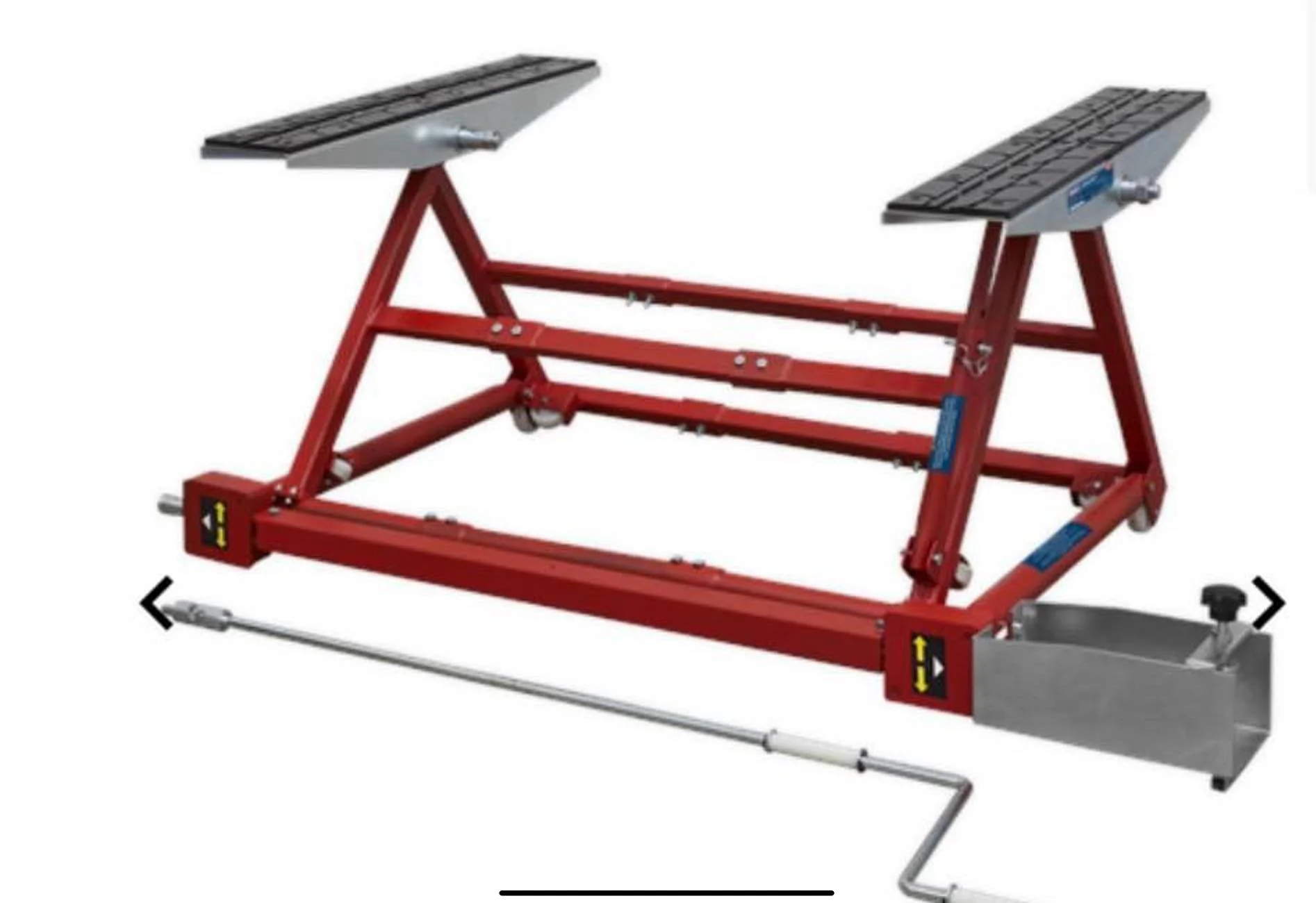

I use tilt lift and use a piece of rectangular steel tube (2”x1”)covered with a rubber strip that runs along the length of the pinch weld. Need the steel to act as a spacer since the pinch weld gets buried below some plastic along the length of the “rocker panel” area. No issues…no damage to the pinch weld as the weight of the car is distributed evenly as opposed to a small area as in with jack stands.
I like that setup a lot.

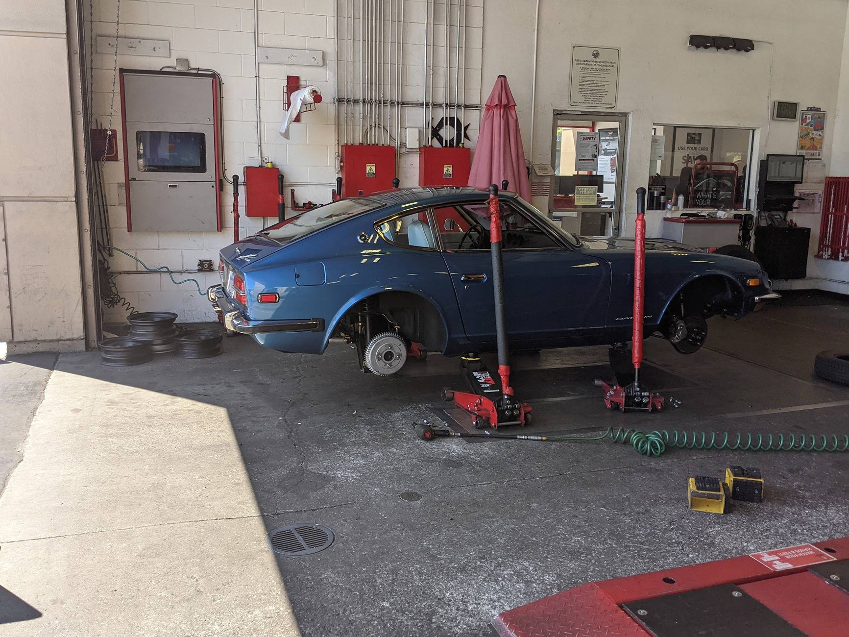

I bought some "hocky pucks" with a slot for pinch welds and gave them to the tire shop when I changed the wheels. This is how they lifted the Z.
