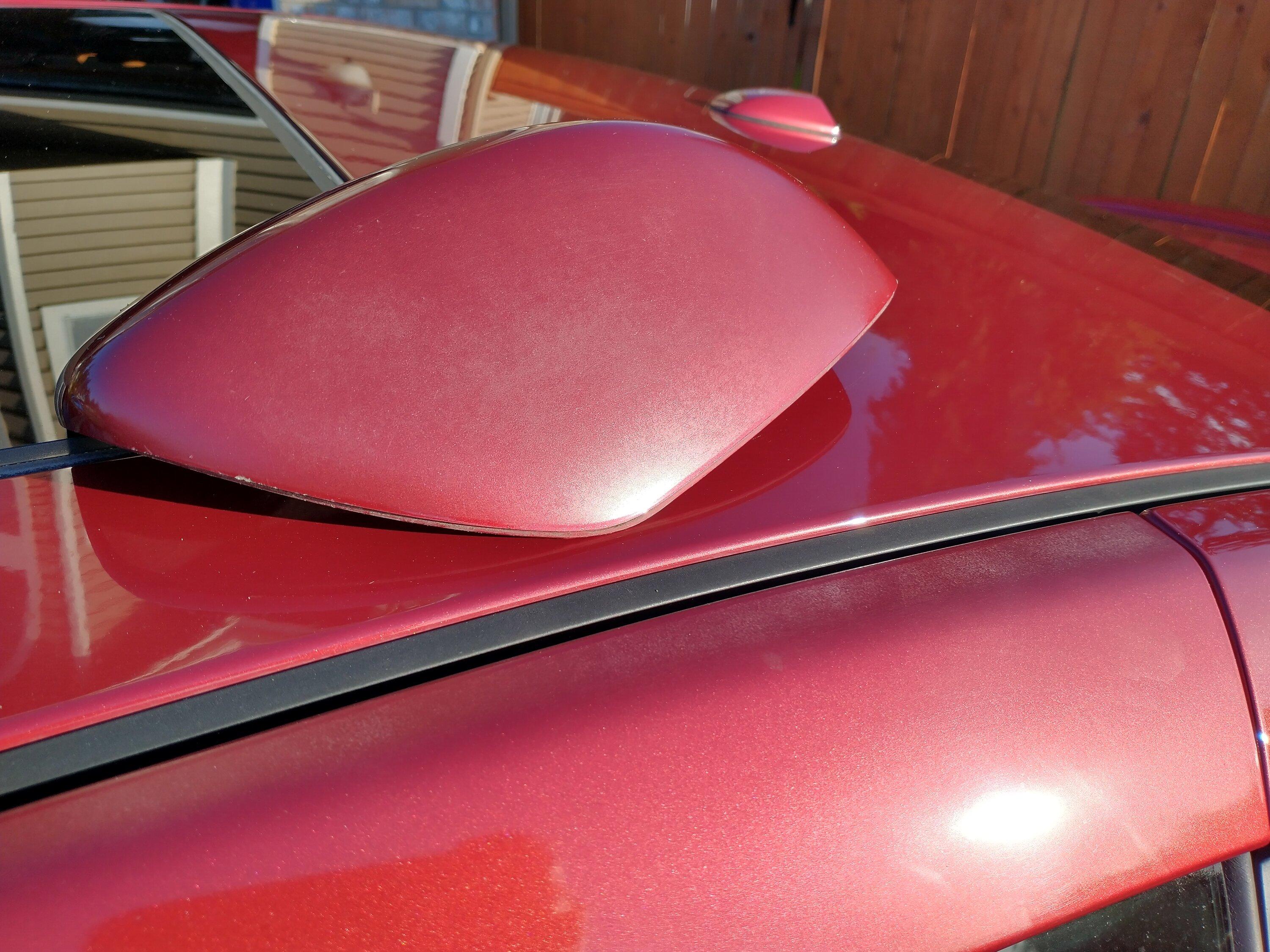

The paint is absolute shit. I'm sending it to the body shop to get parts repainted that the paint just wore off of:
Our 2003 Acura TL with 3x the mileage has no paint issues like this.
Apparently, paint issues and Nissan are a very common problem.

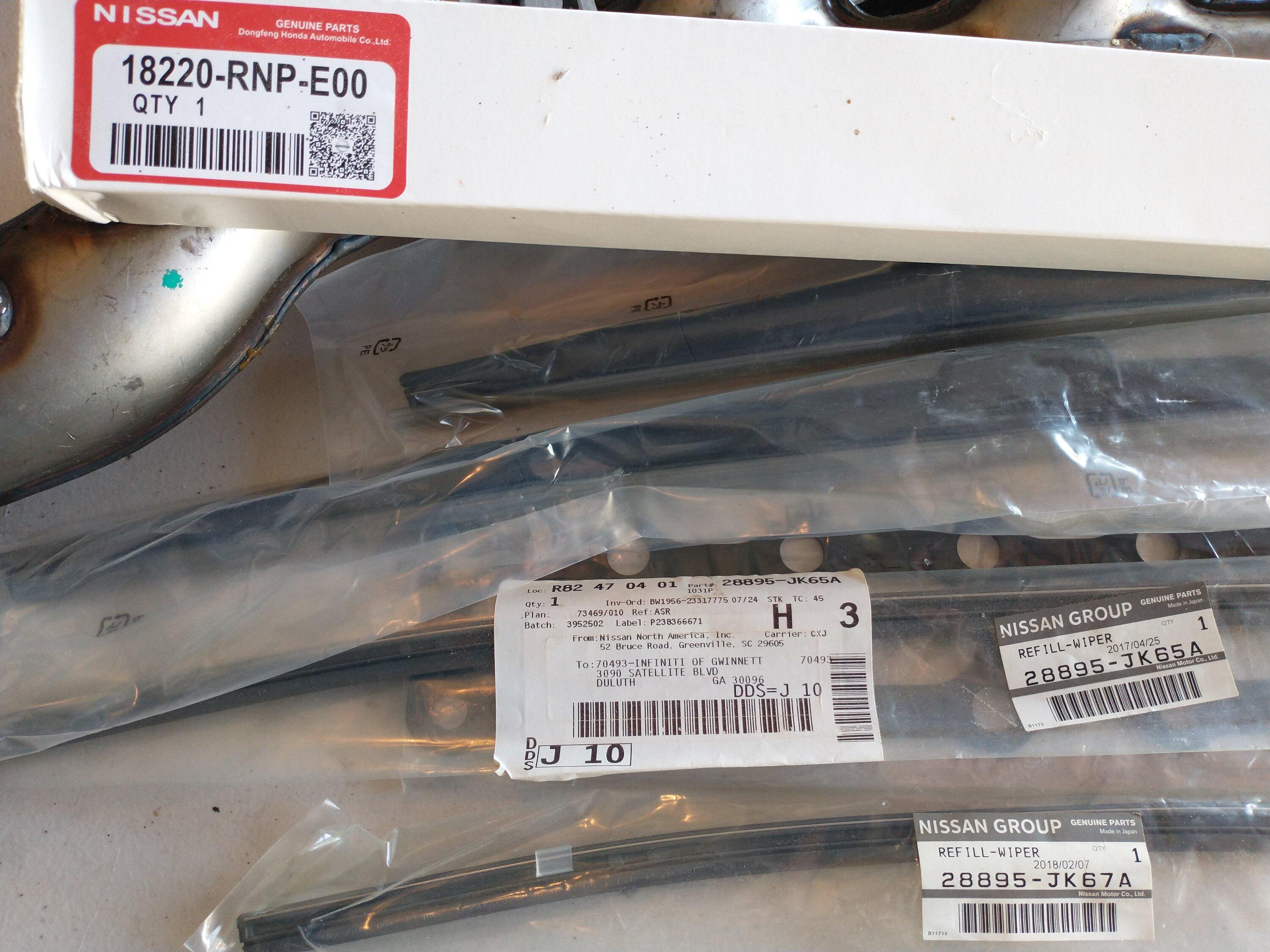

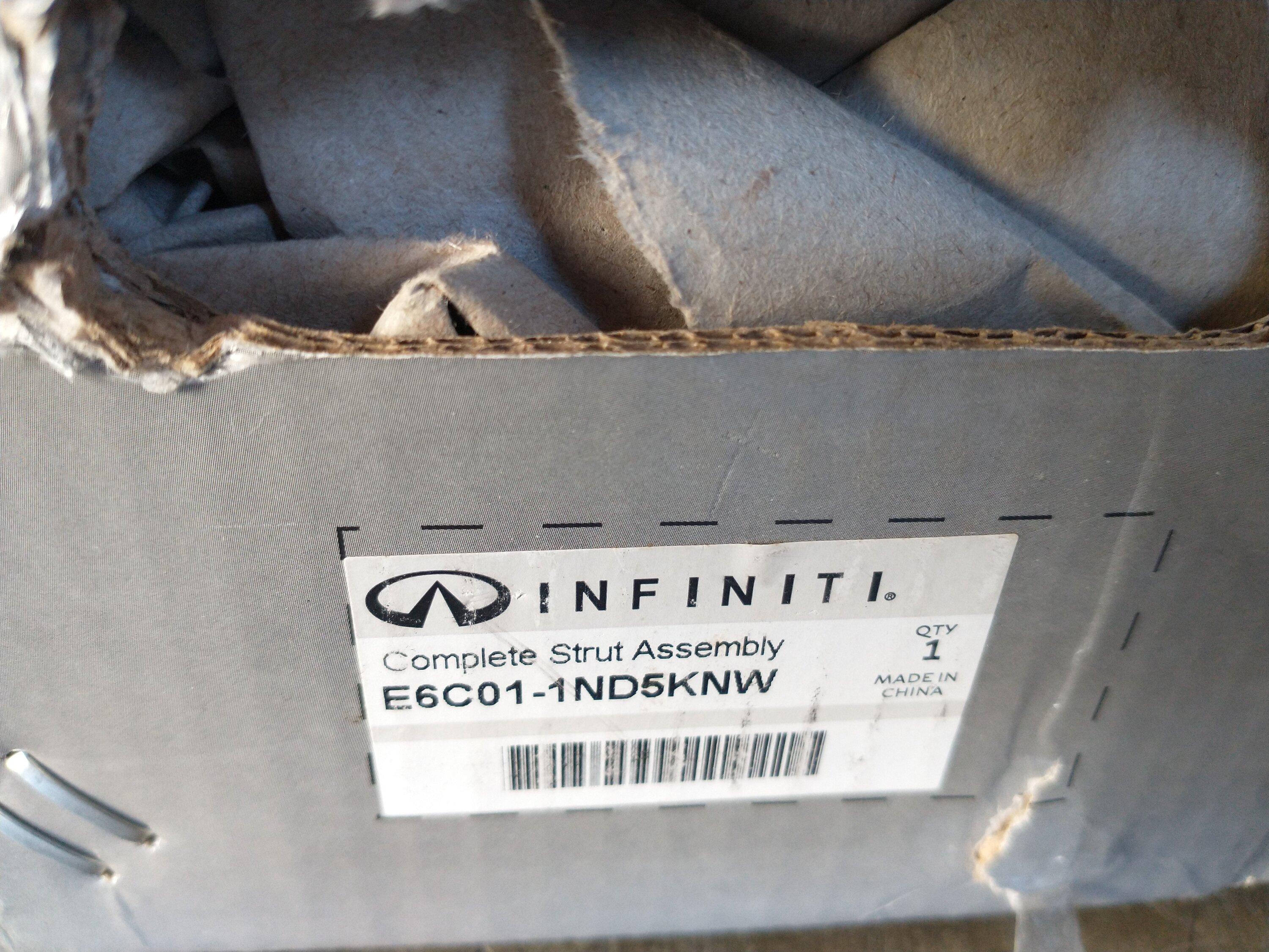

Lately, Nissan obsoleted the Japan wiper blades, the oil filters are Chinese, and my new OEM struts are from China too....
Chinese parts on a subpar car asking for premium money?
The previously Japanese made wipers that Nissan obsoleted, if you want OEM wipers, they now come from DongFeng Nissan China:

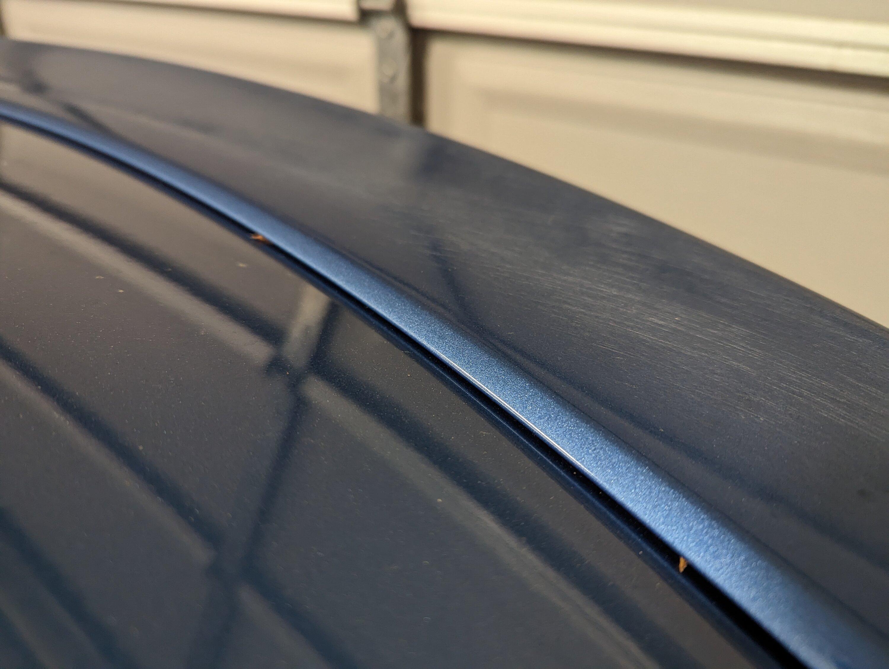

I guess I've had better luck with my 2012 G37S. Although, I must say that the rear spoiler on my car has some clear coat issues. I suspect this was a dealer installed option since it has a third brake light, and I also have a disconnected third brake light in the rear window. Otherwise, my G37S has been pretty good. I'm going to miss it. I'm hoping the Z will help me drown my sorrows.

What part is this? I recognize most of the stuff in this photo except the thing on the roof. Is it a rear-view mirror cover?
But yeah, looks like some significant fading there.

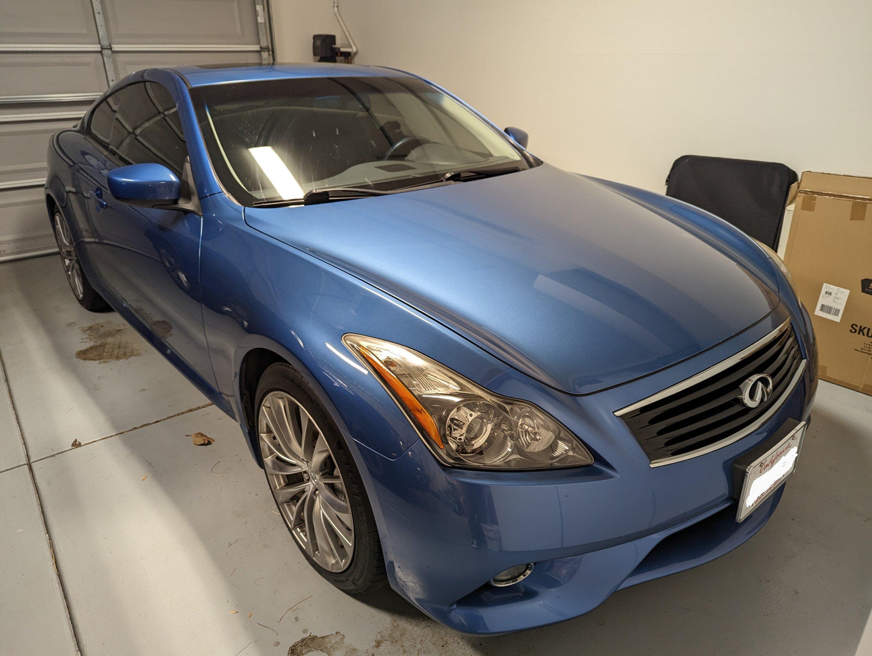

Here's my 12-year old rear spoiler.
The rest of the car looks great.
Could this be a "red" issue? Red often has problems with UV light washing it out. But maybe Nissan is worse than others with red.

It's the mirror cap. I popped them off because the body shop was complaining that if the clips broke, the bill would go way up. So, I am having the rear bumper, both mirror caps and the 2 a-pillar caps re-painted.
I also have a 16 y/o Nissan Titan. Supposedly, the Titans had garbage paint too. Mine has lived every day of it's 16 years outside, never washed more than 3x/yr and only waxed once. The paint is basically perfect, but other Titan (and Frontier/Pathfinder) owners have had bad issues.
Weird thing, is my Q60 is treated way better than the Titan, waxed every year... and the paint issues persist. This is the SECOND time I've had to deal with the mirror caps.....first time I replaced them, this time I'm having a body shop repaint them. Why the issue only affects plastic parts stumps me too.....

If they use the good clear coat w/ high VOC, it can protect the paint regardless of color. The problem w/ waterborne paint is the control of humidity during spraying and curing. Humidity in air line (to feed the spray gun) can screw the high VOC paint up, just as well as the environment (w/o humidity control) can screw up the curing process for waterborne paint.
During rain season (in Houston) between June and November, it's not the best idea to have the car painted unless the spraying booth have curing lights and the space is air conditioned to control humidity.

gez us is that a mirror cap or an old piece of leather lol . first thing that popped into my head

I dropped the car off at the body shop yesterday, my service rep used to work at a Nissan shop, he said that the clear coat is debonding from the base coat. Pretty common on Nissans. Then he pointed to the spoiler on my Q60 and said "that'll be next"
Probably. Yours is two years newer than mine, so the timing works out.
I used to work someplace where I parked in a parking garage, and (of course) I garage it at home, so most of its life has been out of the sun. At my recent jobs, I park outside, so a lot more UV exposure.
