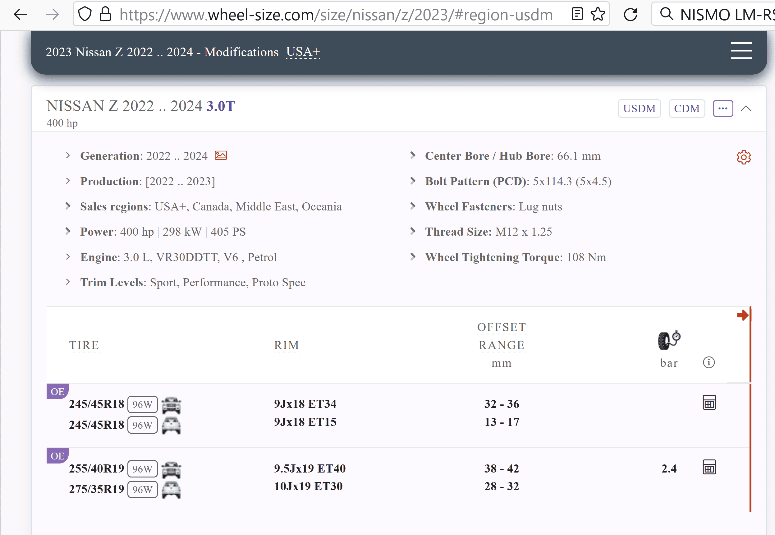

It's 80 ft-lb. Someone (?MCN1SMO) posted this a while ago in a discussion about offsets.

I have mine torqued at 108Nm
