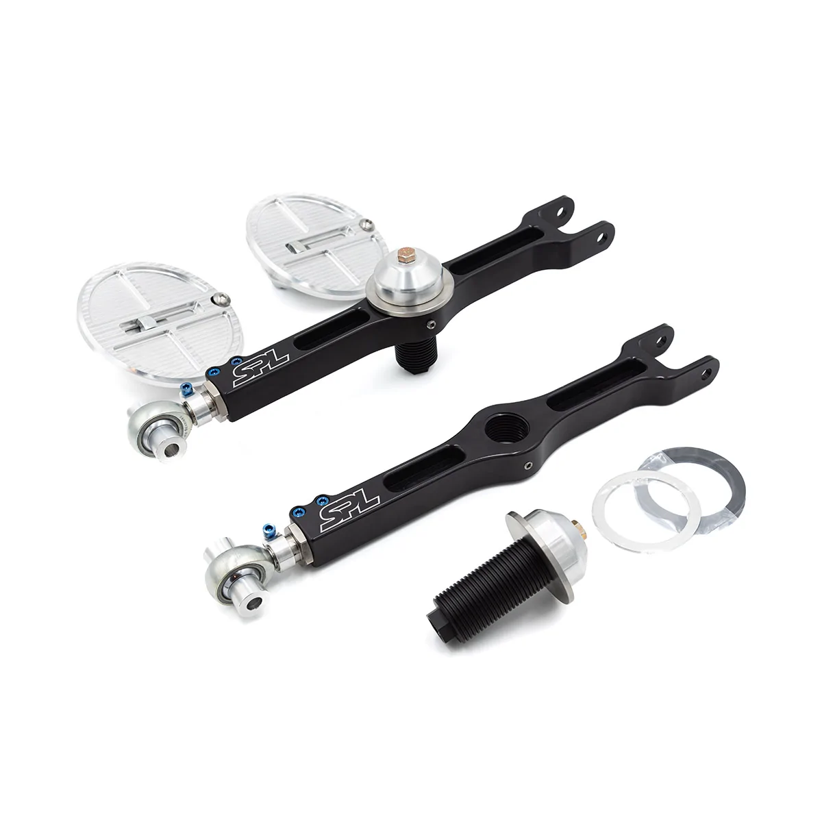

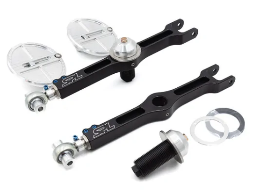

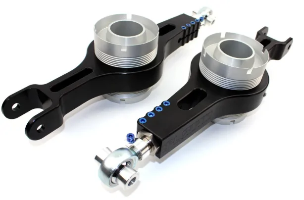

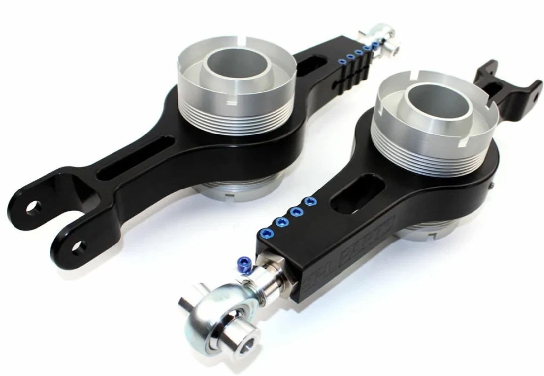

Reached out to Z1 about these as the images on their site for the SPL and NISMO-branded versions are the Version2. Version3 is the skinnier version without the big bucket can, and are lighter.
They said if you order the SPL you'll get the V3. It's possible that others may still have in-house stock on the V2, so if you're shopping anywhere other than SPL or Z1 and have a preference you should ask (SPL only lists the V3 now).
The NISMO-branded buckets are undetermined, per Z1. They said they are "much harder to get" and don't know if it would be V2 or V3. They didn't say, but it's possible they don't make the NISMO in the V3 variant, idk. Looks like they discontinued the billet traction arms, so the NISMO buckets could end up going that same route.
Not sure how it works on the inside, but it appears the bucket is held in place by a set screw or two. Don't like set screws jammed into threads, especially aluminum threads that thread through an aluminum arm (V2). Not sure what the threaded portion of the perch is made out of on the V3 (perches are stainless) but the arm is still aluminum. Seems like it would be OK if they're set once and never move.

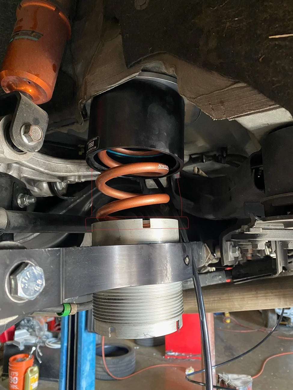

I found an old pic to demonstrate what I was talking about regarding the effect of their new design
This is my rear air cup setup at an intermediate stage:
Stanceparts Air Cup, mounted over a Swift 6 inch, 10kg spring, on an SPL Midlink v2
The lip of that spring bucket is raised, ostensibly to secure the spring. That upper edge, on compression, was at risk of hitting the bottom edge of the air cup. As no one else had run this setup before, neither SPL nor my shop could be sure how it would work out. In addition, Stanceparts said the thickness of their cup was about 1 inch, which was well within the adjustment range of the SPL bucket . . . but it turns out neither were true.
The Stanceparts cup was thicker than expected and we ran out of adjustment downward on the spring bucket, so my ride height ended up being raised by about an inch. For some that is not a problem, but I am running top of tire to fender lip, maybe a little tuck, so I had to adjust.
I ended up going down to an Eibach 4 inch, 600 lb (10.7 kg/mm) spring, which was sufficient to get me back to my original height. We also trimmed part of the bucket lip for clearance. So far, no issues on street or track.
Because the bucket has an internal raised plug that the spring goes around, the lip is kind of superfluous. Their new design omits the "bucket" design entirely in favor of that threaded, conical perch.
I myself contacted them about swapping over to the new design, since it would provide extra clearance.
I highly recommend getting air cups in front, as it solves the ride height issue many have complained about; but after all the work I had to do to get the rears to work, I recommended against the rears. With the new design, some of that is cut out, but I think it is more cost effective to just get the fronts anyways.
