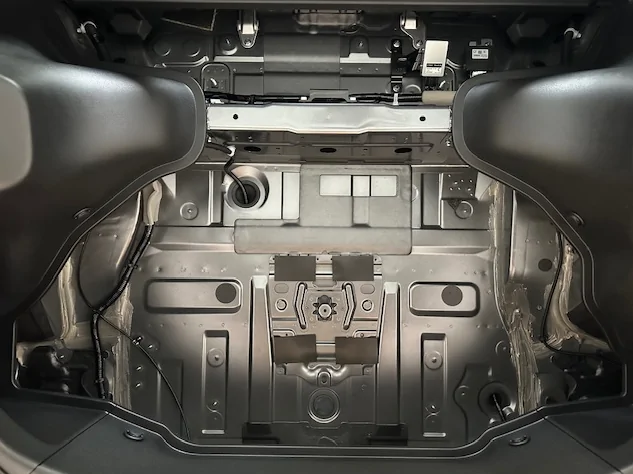

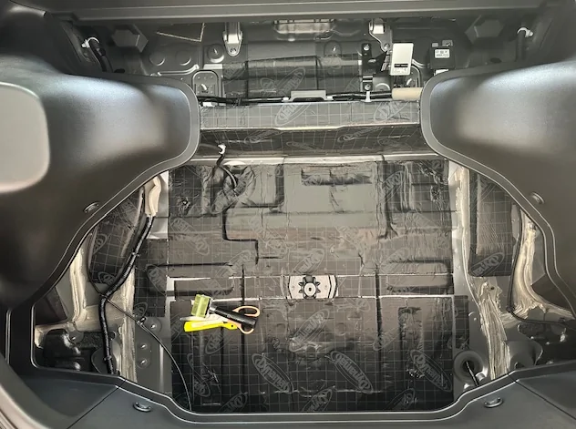

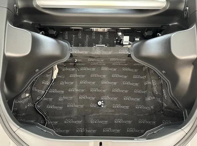

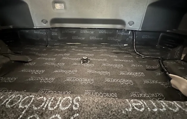

Reiterating what's already been said, at least just getting the hatch area done is a huge improvement and only ~2 hours of work. I went with a single layer of Dynamat, followed by two layers of CCF. Road and exhaust noise from the rear was drastically reduced and my audio system sounds better due to less interference in the mids and low-mids. I would definitely recommend it!
Before:
Dynamat on most of the large, flat surfaces:
After two layers of CCF. I was just able to get the factory foam bits to fit back in the hatch after this. You have to be careful not to add too much deadening or you won't be able to get the foam to go back in where it has to fit between the floor and the plastic trim:
Make sure to get good coverage of the back side as well, but don't cover the air vents!
