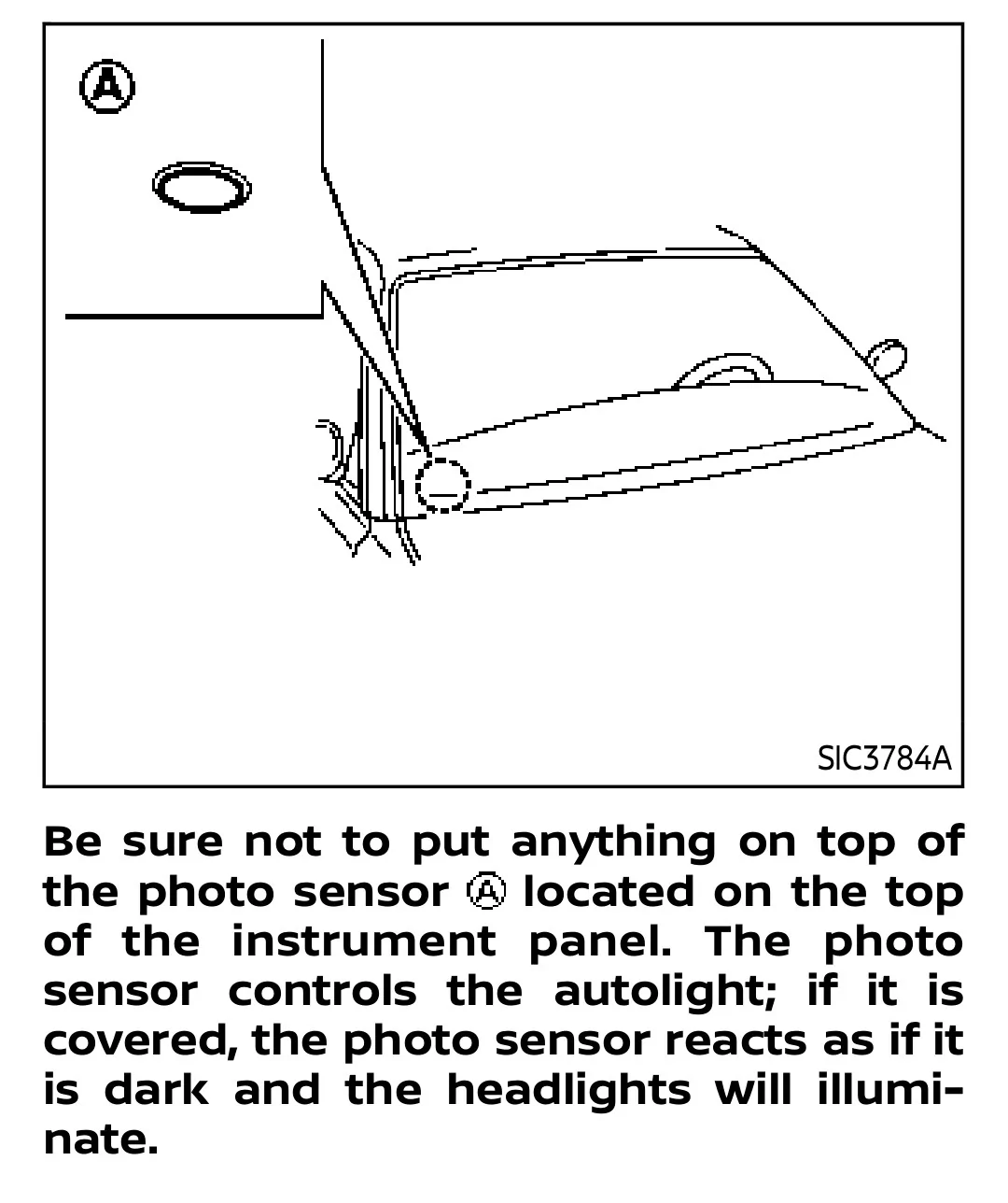

Surprisingly difficult finding a picture to show the sensor.
Little round insert, top side of the dash, passenger end of the windshield defrost vent recess.
64
1,637
1,966
The amazingly crappy picture from the owner's manual doesn't help much.
